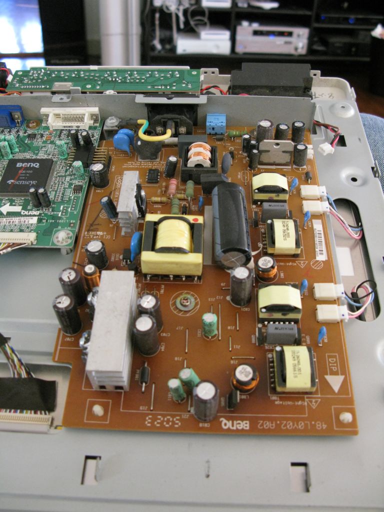

    I have an old BenQ FP71E which started playing up about a year ago - if turned off, when trying to turn it on the on light would come on, but then when you would expect the 'splash screen' there would be no display, a high pitched noise would sound and the 'on' light would go out. If I tried to turn it on a few more times (and/or left it in the sun) it would eventually start. I found myself leaving the monitor on for a month at a time! and then eventually splashed out on a new 24".
    So now... for a bit of fun, I thought I might crack it open and see if it is fixable. This is my first look in to the world of recapping - but it is something that interests me. I have a few ADSL modem/routers about which also might benefit from this.
    Does this sort of behavior sound like bad caps on the power supply?

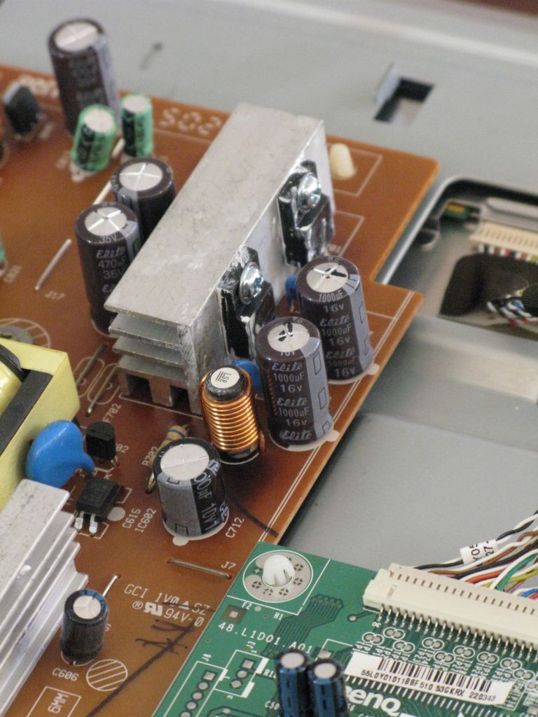

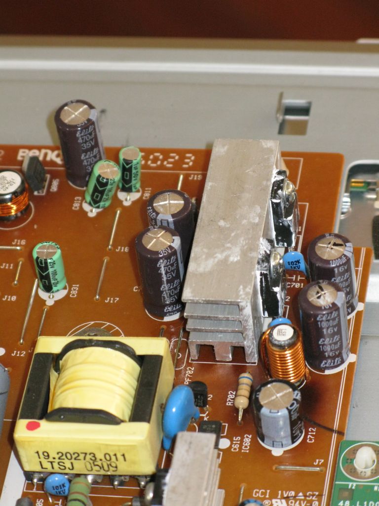

    I've taken a few pics of the board - the purple 'elite' caps appear to be a bit bulgey on the top and I have noticed the board looks like it has gotten a little warm near here. Maybe replacing these caps is a good place to start?
    Any pointers in the right direction for this fix up project would be greatly appreciated.
    High pitched noise sometimes indicates caps going bad as they vent.
    Replace all Elite caps around that heat sink. All 4 are definitely bloated.
    Most here will recommend that you replace ALL the caps on the board due to age, usage, and to get a better brand of caps like Rubycon, Panasonic, or United Chemicon.
    Also, for Benqs (you can search here for their numerous problems), you will have to test the C5707 transistors, FU9024, picofuse, and resolder all the transformer joints.

      Those 2 1000uF/16V sure looked domed!
      One of the 470uF/35V also looked domed. So replace them all.
      Please post your location so if you need help to locate repalcement caps.
      Personally, I prefer Panasonic FMs from Digikey.
