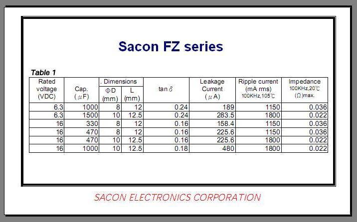

                  Re: Replacing caps on acer x241w learning experience...
                  Here.
                  I had to do it by screen shot because BCN can't handle a PDF of any reasonable size.
