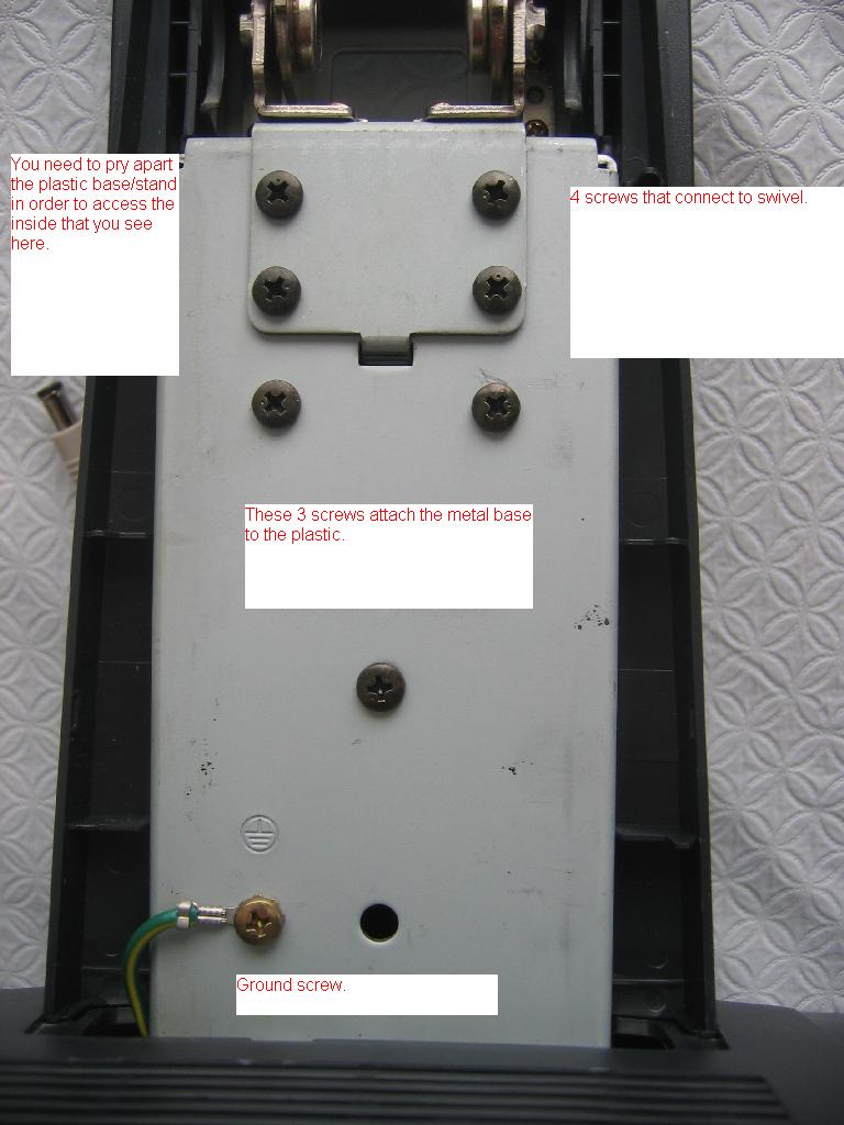

    Case history. Hope it helps someone.
    Hansol H711
    - made in Jan 2003
    - LCD panel by Samsung
    - power supply is built into base/stand (DC 12V, 3.35A)
    Symptoms
    - no power on
    - no LED light

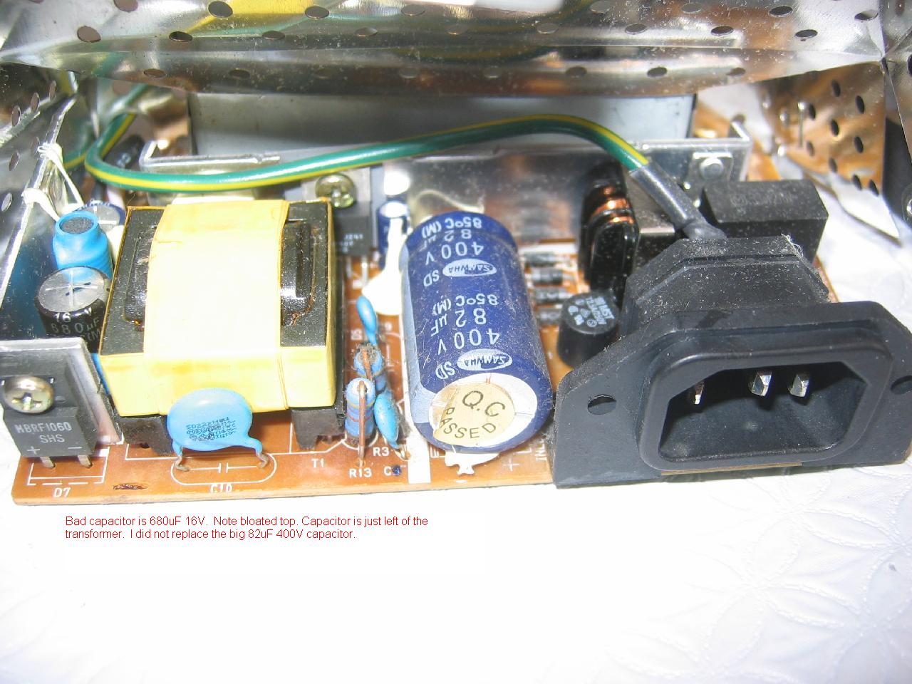

    Component Replaced
    - 680uF 16V capacitor in power supply base/stand (see pic)
    Comments
    - taking apart base/stand is a bit of a pain, must separate plastic stand to get access to screws (see pic)
    - power supply part is protected by aluminum shield which is welded shut (see pic)
    - only 2 screws to take apart flat panel, easy to pry apart afterwards
    - no plug and play support in Windows XP

    Re: Hansol H711
    Your typed message under the picture didnt come out right. However, the 680 uF cap looks bulged a little and check the black (round) fuse right next to the main power connector (F1 on the solder side).
