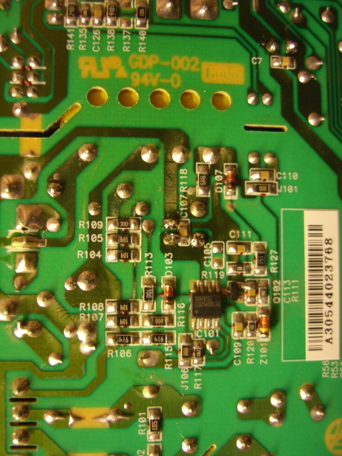

                      • UserName666
                        • Aug 2010
                        • 76
                        #31
                        Re: Daytek F19AH
                        OK that schematic is throwing me on a real loop here. From what I can understand/find...
                        Things to check:
                        -R8. If it's too high a resistance, Q2 shuts off early.
                        ***Don't know where to look for R8
                        -U1, pin 8. Do you see pulses there at about the same rate you saw them across the 10uF cap?
                        ***Sort of. Fluctuates between .3?? - 0 - .4?? then it will fall to 0 for a few seconds then do that over again on a constant cycle.
                        Pos - pin 8
                        Neg - pin 1
                        -D4 and R12. If either are open, U1 won't get run power.
                        ***The 2 diodes on my board test as:
                        Out of circuit, no live power, DMM on diode setting:
                        Near transformer = 0 reverse leads .498v
                        Near filter cap = 0 reverse leads .493v
                        Not sure where to look for R12(PDF). I saw it going to pin 7 on the pdf so I traced back pin 7 on my board. Since the schematic shows the diode, cap and resistor near each other, is resistor R12(PDF) what I circled in Blue??
                        10uf 63v cap circled in orange
                        Diode circled in Yellow
                        Pin 7 is pink.
                        -T1 pins 4-5. If there is no continuity, U1 won't get run power.
                        ***There is continuity between both places with the red lines.
                        -The voltage on U1, pin 2.
                        ***This one is giving really jumpy readings between .035v and 1.4v
                        I also checked the voltage coming into the chip (per page 1 diagram of PDF) and its fluctuating between 15 ~ 19 volts at pin 3.
                        Neg - pin 1
                        Pos - pin 3
                        The 2nd picture is to view the board without my circle marks.
                        • PlainBill
                          • Feb 2009
                          • 7034
                          #32
                          Re: Daytek F19AH
                          It's rough. This would be a lot easier if we had the schematic of the monitor.
                          Things to check:
                          PDF R8 would be the green resistor standing on end on the top side of the board. It's between the blue ceramic cap at the lead end of the large cap and the heat sink for the power FET and the diode bridge.
                          Pos - pin 8
                          Neg - pin 1
                          Excellent. The IC is trying to drive the FET, then shutting down when Vdd drops too low. Once the 10uF cap charges up to 16 volts it tries again.
                          PDF D4 is on top of the board next to the 10uF cap. Yes, you circled it in yellow.
                          Pin 7 is pink.
                          PDF R12 is board R118. 6.8 ohms, I think.
                          Good.
                          This one is a potential 'smoking gun', subject to other readings. Internally there is a pull-up resistor to 6V (generated internally). That should be at 6 volts until the opto-isolator pulls it low. It looks like the trace from pin 2 runs under IC101, C109, R120, Z101, across the board, under J101 then to pin 4 of IC102 (the opto-isolator). What is the voltage across pins 1 and 2 of IC102?
                          Neg - pin 1
                          Pos - pin 3
                          That makes sense.
                          That is much appreciated. You've done a heck of a job. Things I've mentioned above:
                          Check R118 on the board- should be 6.8 ohms.
                          Check the voltage across pins 1 and 2 of IC102
                          Check the resistance of R8 (pdf)
                          And for something new, I'm trying to establish the link between IC101 pin 8 and the power FET (Q2 pdf). On your picture it appears the upper pin is connected to a jumper which runs across the board to a point between R109 and the orange circle. The trace then runs down to R113, and from the other side of R113 under D103. Please verify this, and identify any other connections.
                          PlainBill
                          • UserName666
                            • Aug 2010
                            • 76
                            #33
                            Re: Daytek F19AH
                            One thing I should have mentioned right of the top is this monitor was used in a poorly ventilated cabinet and all of the sudden just went out and you could faintly smell burnt electronics. The poorly ventilated cabinet makes me think this was an overheat issue.
                            Alright...
                            R118 (In circuit - no live power) = 7.0 ohms
                            Across IC102 pins 1/2 (In circuit using live power) = Fluctuations between 1.1v and 2.5v
                            R8 (Big green resistor R112 on board - out of circuit - no live power) 00.7 ohms
                            **00.7ohms????? Ive never done an LCD monitor but even to me that seem not right lol
