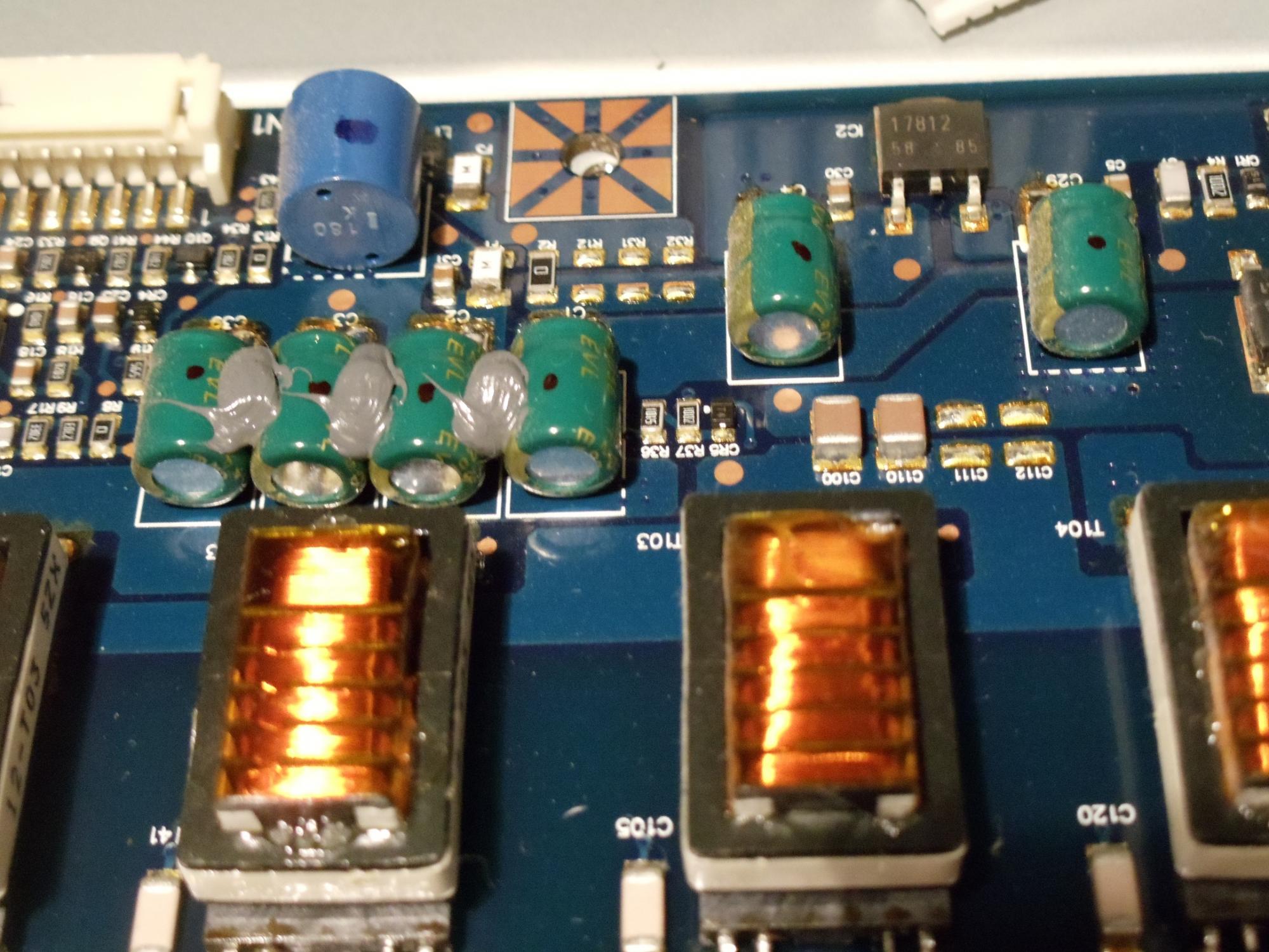

    Yes, that cap does look scorched. Opened it in pic program and brightened it up.
    Although the scorched cap would indicate another problem, the main course of action with these is to replace the 10 inverter board caps first. They are/can be non-bloat fails. With luck, they didn't take out the FETs.
    Don't get any fancier than the originals, spec wise. In other words, if PW or FC are close, use them. Don't go to an FM or KZE quality just because they are better specs. You'll may end up with the same problem or creating a new one. That chip seems to be -very- picky (sensitive). I'd like to find a way to "fool" it long enough to get good readings.
    Toast

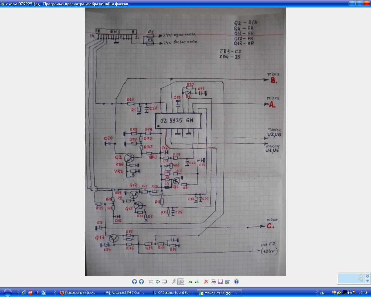

            Ah-ha. From other threads, OZ9925GN.
            I've requested datasheet from 02 Micro.
            Someone is selling them on eBay. I've asked them if they have a sheet.

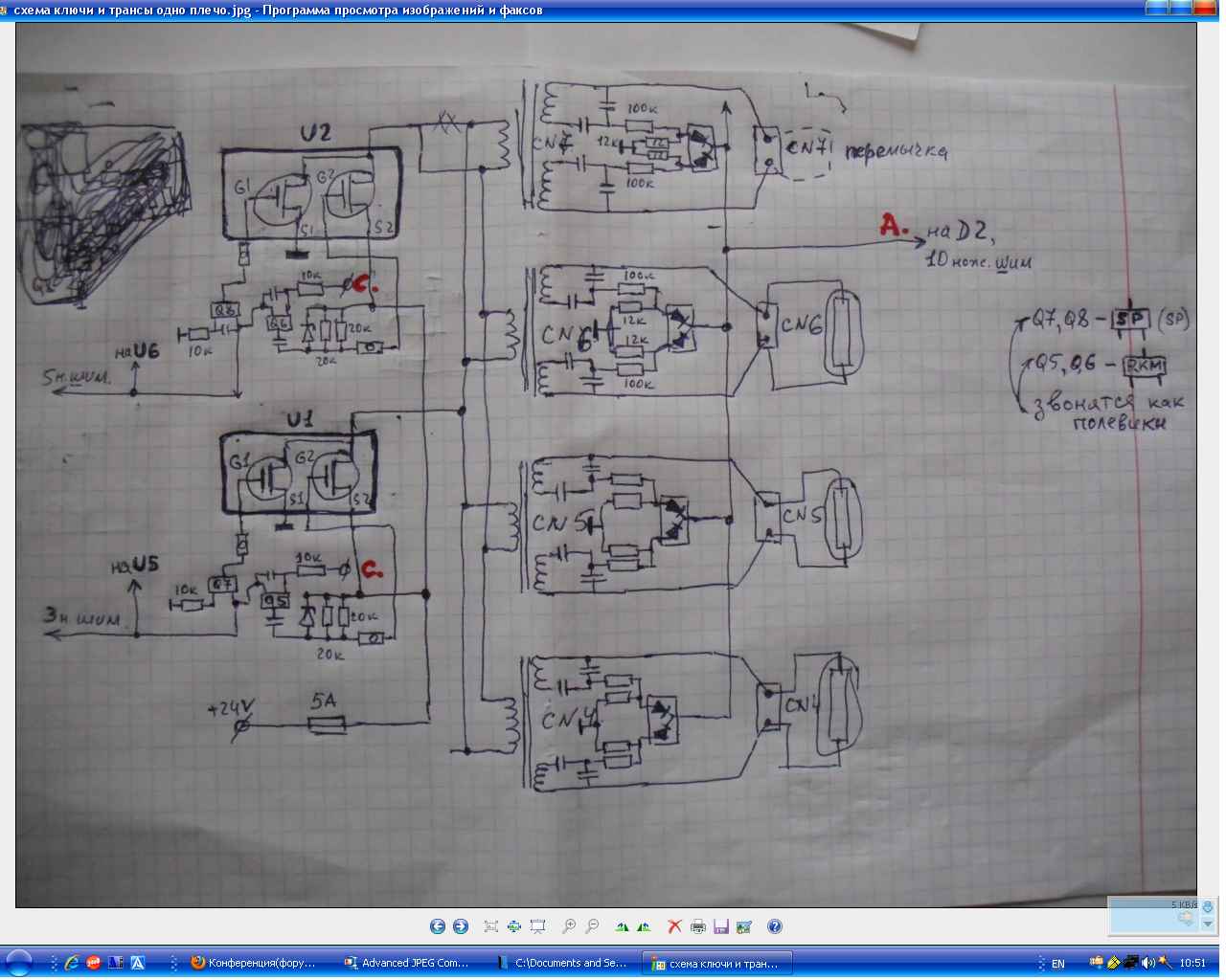

            Found attached hand drawn circuit diagrams (not the same monitor) from a Russian site. Diagram of chip and circuitry around it.
            Also found an old catalog with this chip in it. Extracted the page and posted it here as a single PDF.

                              One set of caps on the inverter board is darker than the other set. They started the same color. Heat degrades the plastic and changes the color. Heat also degrades the insides. There's no vent on the top so look for the bungs to be pushed out.

                                severach's observation is why we always ask for pictures of your particular board. When people post "my board is identical to so and so", I just starting rolling my eyes.
