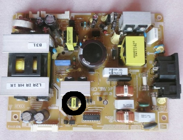

                            Does anyone know the specs on this small transformer on a BN44-0195A.
                            The one on my board is fried. (see attached)
