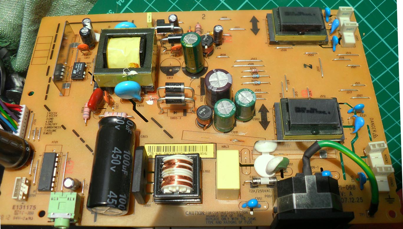

    Hi, I have two monitors with PSU problems and I was wondering if anyone had any ideas on what could be wrong with them before I replace all the capacitors.
    The blueh monitor works for a few minuites before cutting out. The monitor has to be left for a while before it will work again (cool down?). The voltages are OK until the screen cuts out, at which point the 5v rail drops to 4.6. Runnning the monitor off an external 5v PSU solves the problem.
    The board has ILPI-068 written on it.

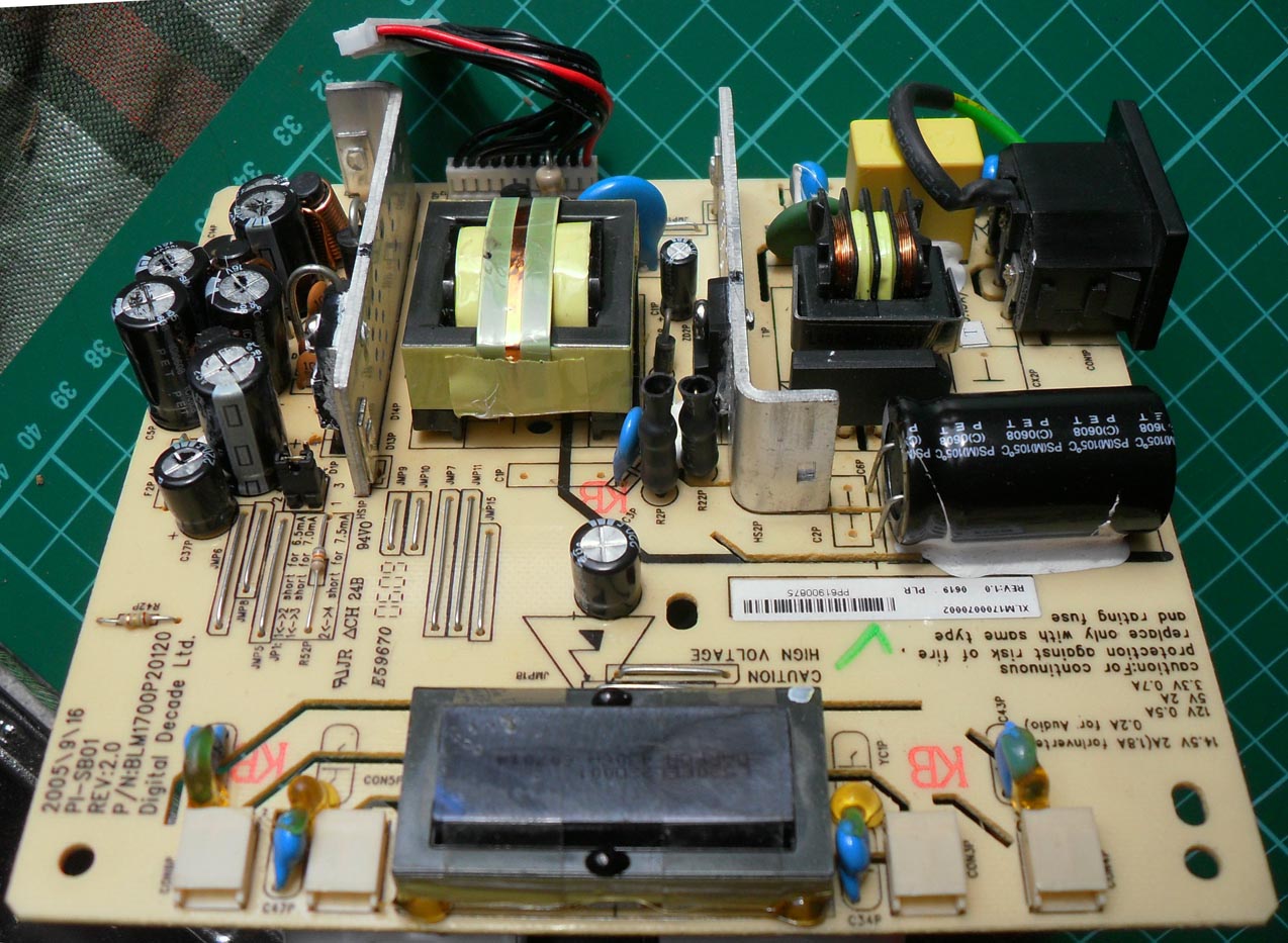

    The other monitor doesn't turn on (not even the LED). I left the monitor at work so I haven't tested it loaded but unloaded it has approxamately the correct voltages, but produces (on 14.5v rail) 13.5v for one sec, 14v for one sec, 14.5v for one sec, and then drops back to 13.5v. This could just be due to being unloaded though.
    The bord is a Digital Decode Ltd. PI-SB01

    Digital Decade LTD?
    They manufacture the PSU boards in the "AMW" monitors I've repaired. Always been bad caps.

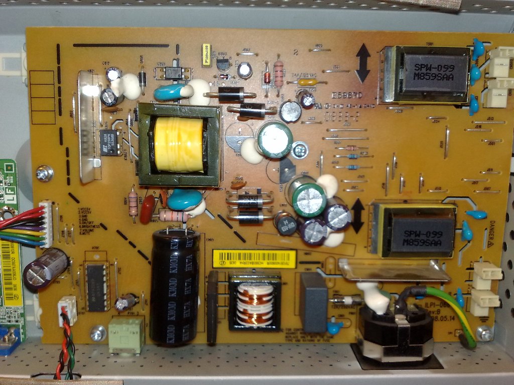

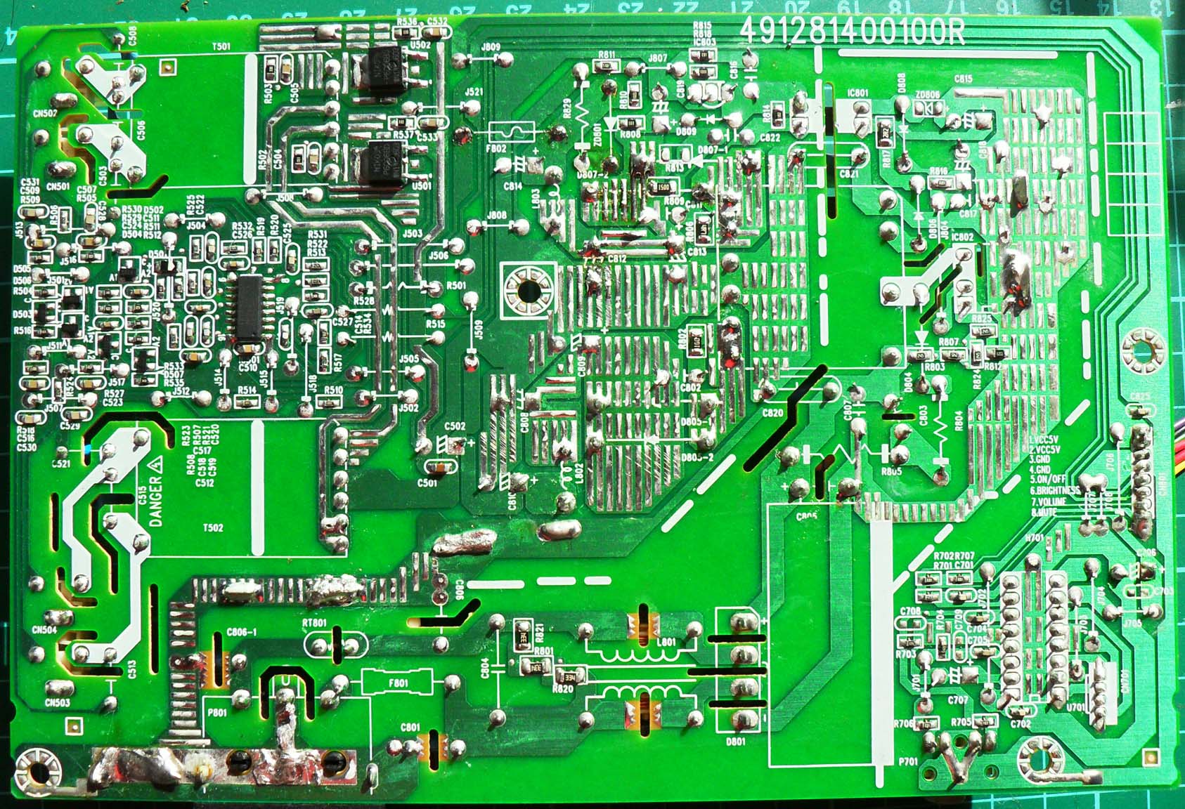

              Here are the images of power supplies. The slightly burnt resistor on the Hyundai board (top center) is where I discovered how the feedback from the 15 or so volts from the backlight works. It has a zenner and a resistor designed to pull up the 5v if the 15v gets too high. I was running the 5v off a bench supply so the resistor got quite warm quite fast. That section still works though.
              Also I have started changing caps on the Hyundai board on the 5v rail. I've put in a Nippon Chemi Con (large, left hand side) and a Sanyo (near burnt resistor). It hasn't made any difference though.
              Bottom of Hyundai
              Top of Hyundai
              Bottom of AMW
              Top of AMW

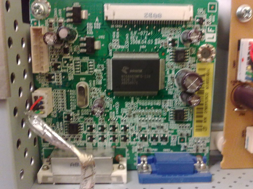

                                  As required I have posted hyundai monitor fotos. Hope this helps

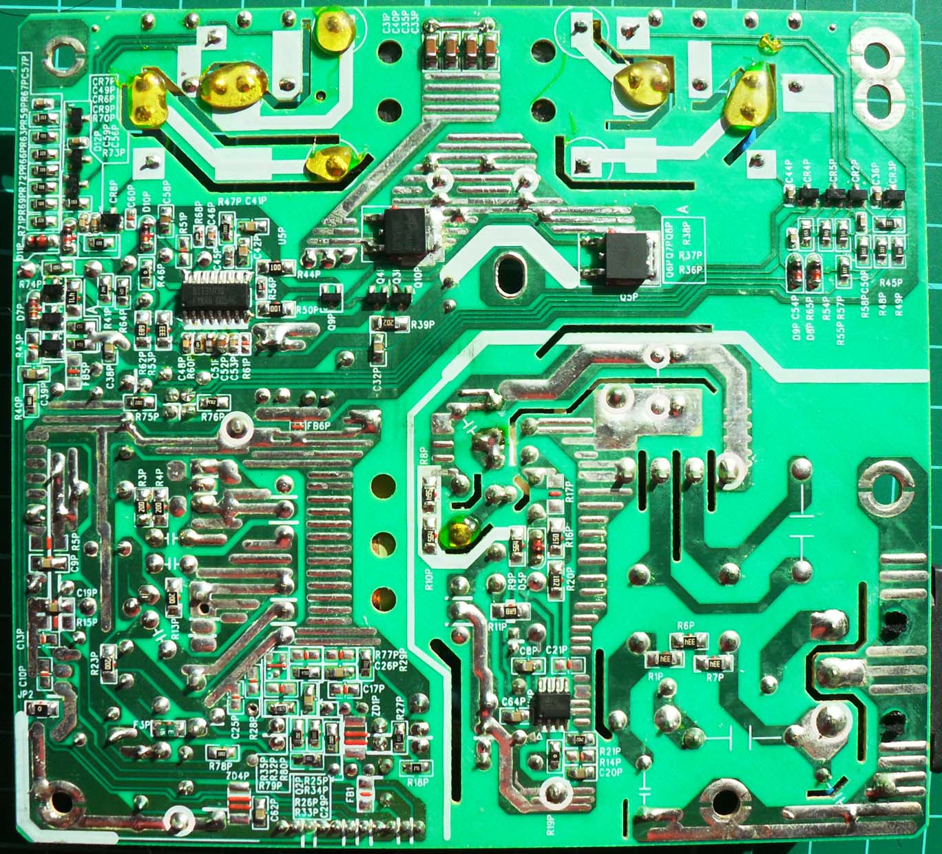

                                    Try to place the camera on something stable, the photos are blurry. We're also going to need some pics of the solder side of the board.
                                    A working TV? How boring!
                                      Re: 2 dead monitors, blueh h94w and amw x1700ds
                                      I'll try again to do it and amount the board from the chassi to take pics on solder side. do you see something strange from these?

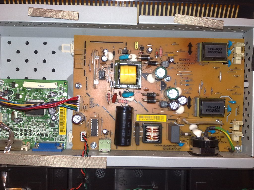

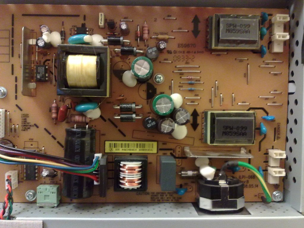

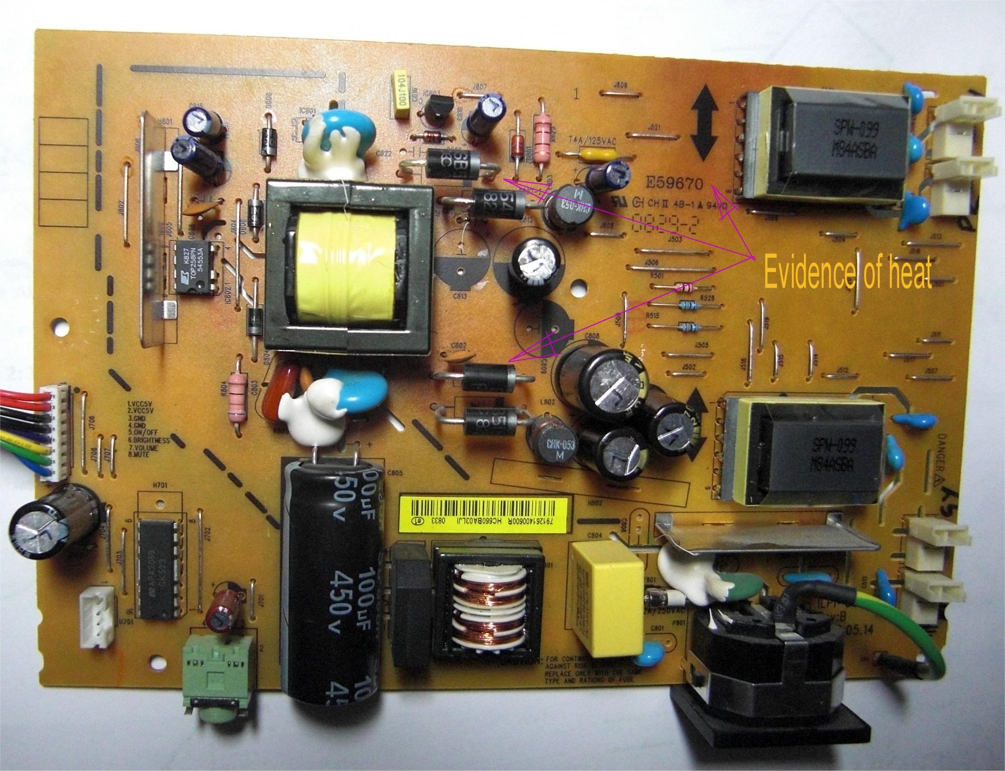

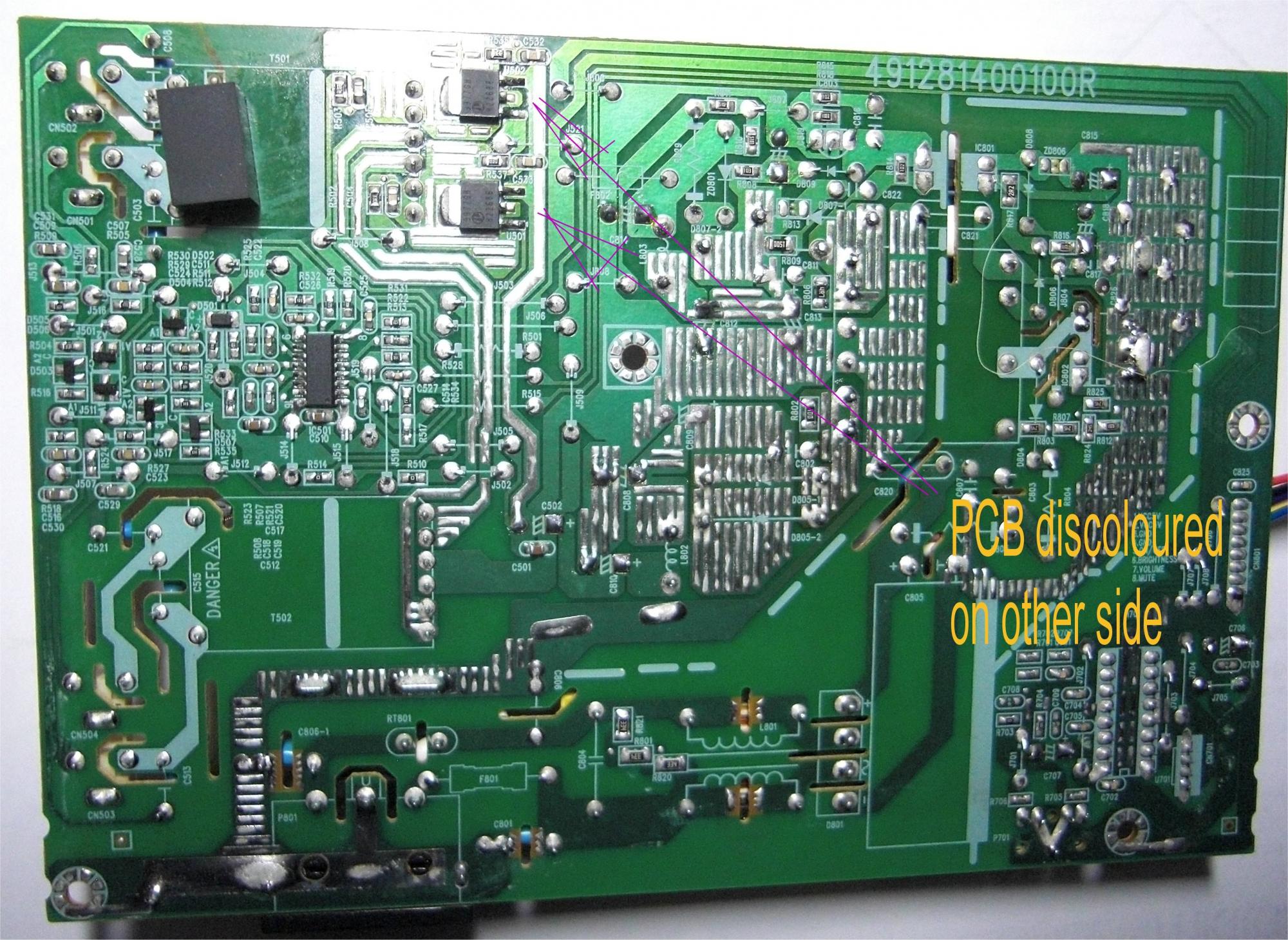

                                        I have been working on the Hyundai Blueh board.
                                        My symptoms are that the screen operates fine for ten minutes, then flickers and i lose the backlight, after a while presumably whilst something cools down a bit comes back on but flickers and goes out again over and again.
                                        I examined the board and no caps were showing signs of stress but changed them all for good quality low esr anyway. No improvement whatsoever.
                                        i do notice though that the pcb itself has signs of heat around the schotty's an near the top left invertor transformer.
                                        I attach photo of front and rear and notice that on rear there are a pair of fets with a tell tale heat colouring on the pcb front side.
                                        Has anyone else had similar problems to this, my money is on a dodgy coil winding, but perhaps the fets?.. Any suggestions greatly appeciated.
                                        Cheers Stagdriver
                                        Hope the images uploaed ok
