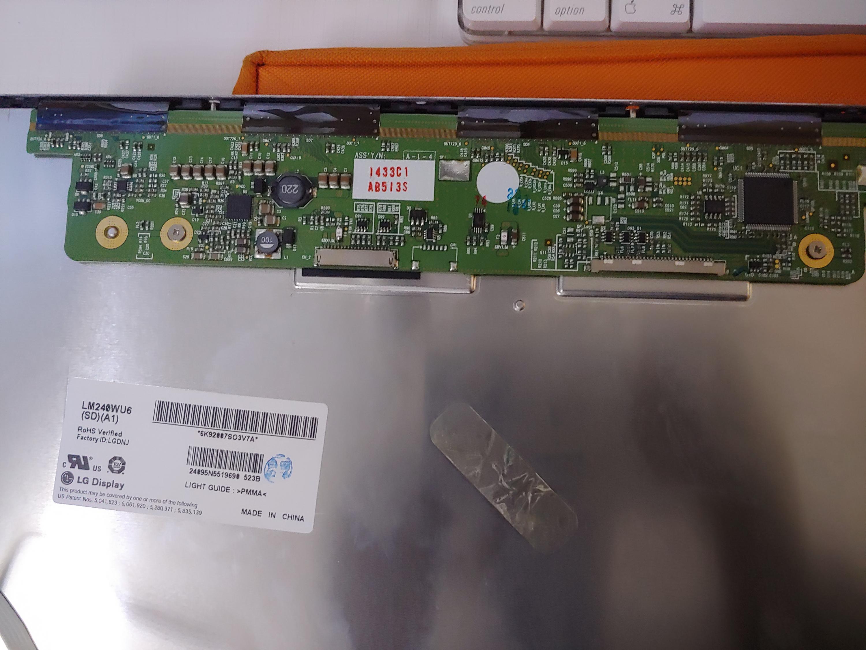

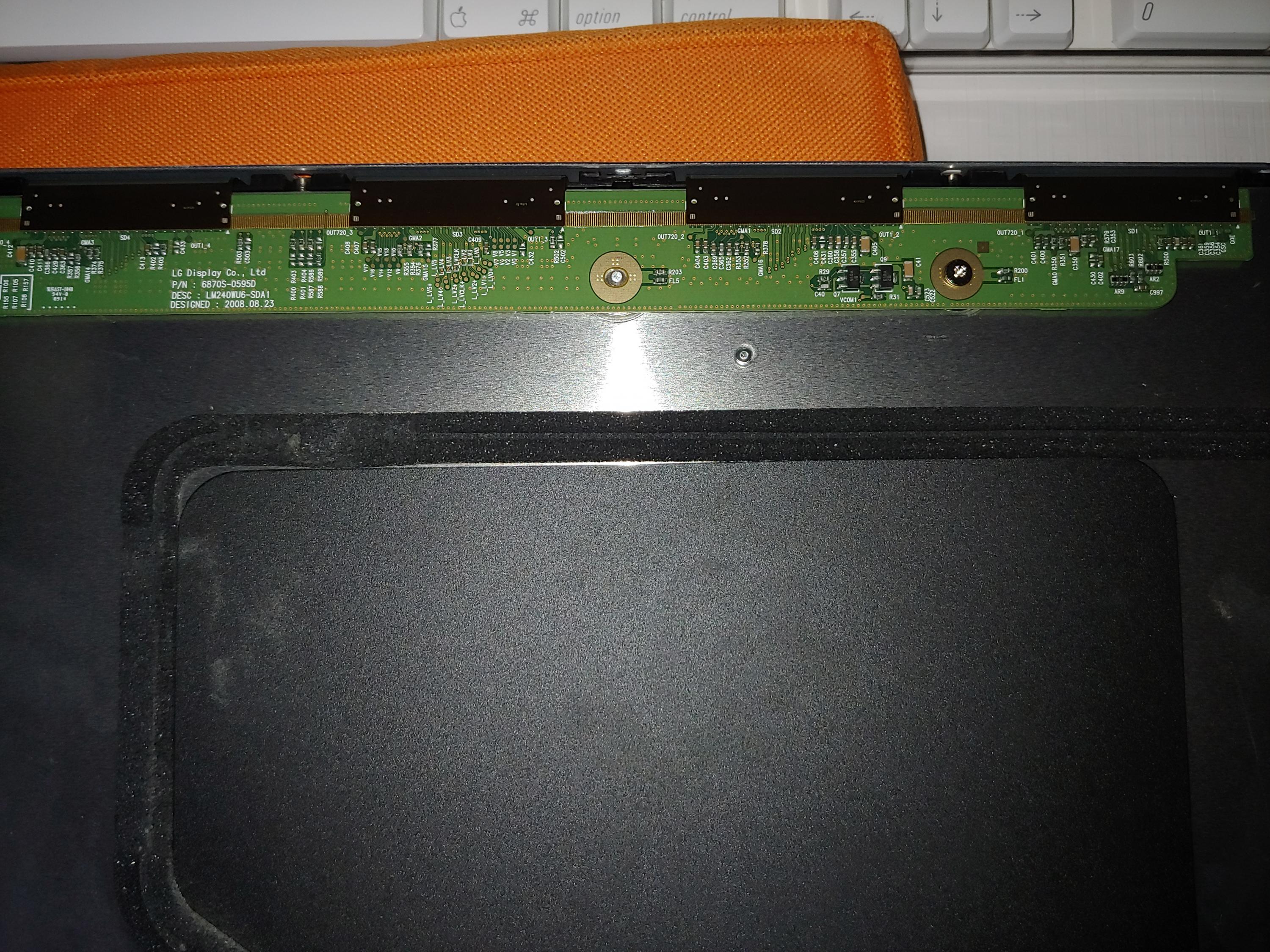

    I have this Apple cinema 24 inch A1267 that randomly stop working. I opened it up and noticed the the fan was not spinning when there is AC power. I disconnected the lvds cable feeding the matrix board and the logic board and the fan started spinning and all voltages at the test points on the logic board are available. The moment I connect the 20 pins lvds cable to the matrix board which is located in the LCD panel, all voltages at the test points goes to 0volts. Seem that the 11.88 volts is somehow shorted. Any help will be appreciated.

          The mating board on the backside of the display is the 't-con' board (I think it stands for timing controller board).
          They are usually dirt cheap and have seen them new for about $10-$12 on Aliexpress. Had some good dialog with a reseller of such boards and associated display test tools but will need to do some digging.
          We also have repaired the boards in the past by simply replacing each and every polarized capacitor (tantalums) onboard. After replacing about 5-10 caps (Arrow) - the display worked like new.
          In a quick review of your t-con board, do not see polarized caps onboard but rather non-polarized ceramics. Usually ceramics are work horses.
          You can do some testing as follows:
          1) power down the board
          2) meter in resistance mode
          3) black probe on meter to ground on this t-con board (shield is ok)
          4) red lead on each cap you can find on the board. One side should report close to 0 ohms = that will be the ground side. Otherside should not be so close to 0 ohms.
          Report any oddity you see in the resistance review.
          Any burn / cracks marks on the chips ?
          Also, you can use diode mode on meter and then confirm each 'Dx' = diodes are ok on the board.

              I went through the measuring of the capacitors with reference to ground (shield of the panel) I did not see any oddity in resistance except one capacitor that reads OL on one side and 0.00volt on the other side.
              What is weird is that when I connect the 30 pins connector to the t-con board, the Apple Cinema display fan spins without issue and all voltages on the test points on the logic board are all accurate with respect to the apple cinema display technician guide.
              It seems that the moment I connect the 20 pins lvds cable, all voltages on the test points drops to nearly 0volts. The fan stops spinning and I heard a noise that something is overloading the circuit. When the 20 pins cable is removed, the fan starts spinning and all voltages on the test point on the logic board are available and accurate.
              So do you guys think it's in the T con board.
              @ Dumah Brazorf. I do not have a bench power supply for this test. Is there another way I can do this?

                    I changed the 20 pins lvds cable and the monitor is working fine.
