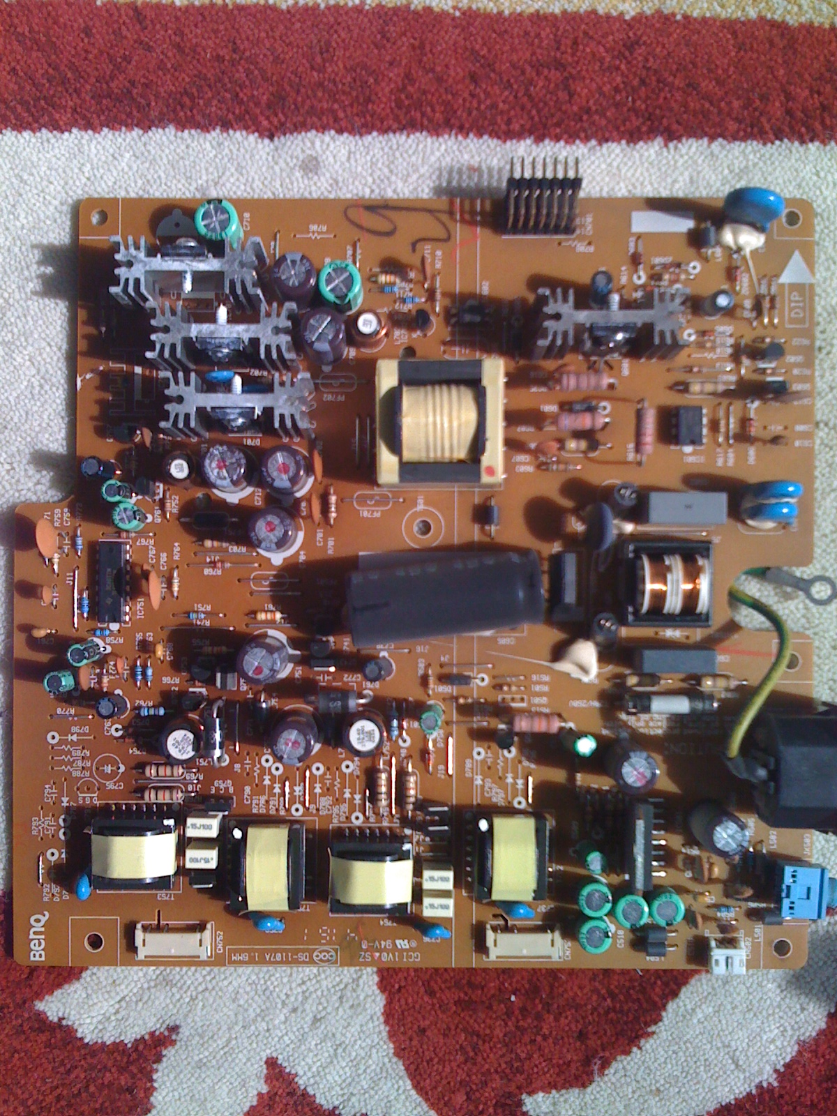

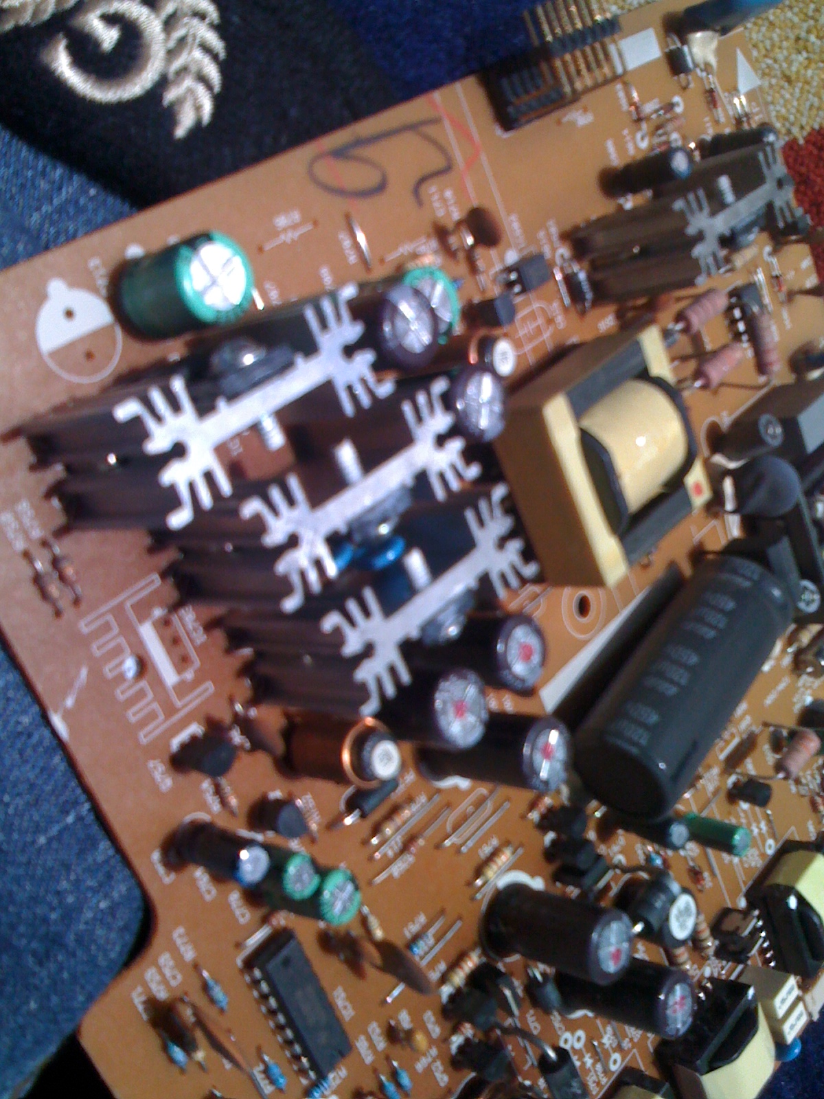

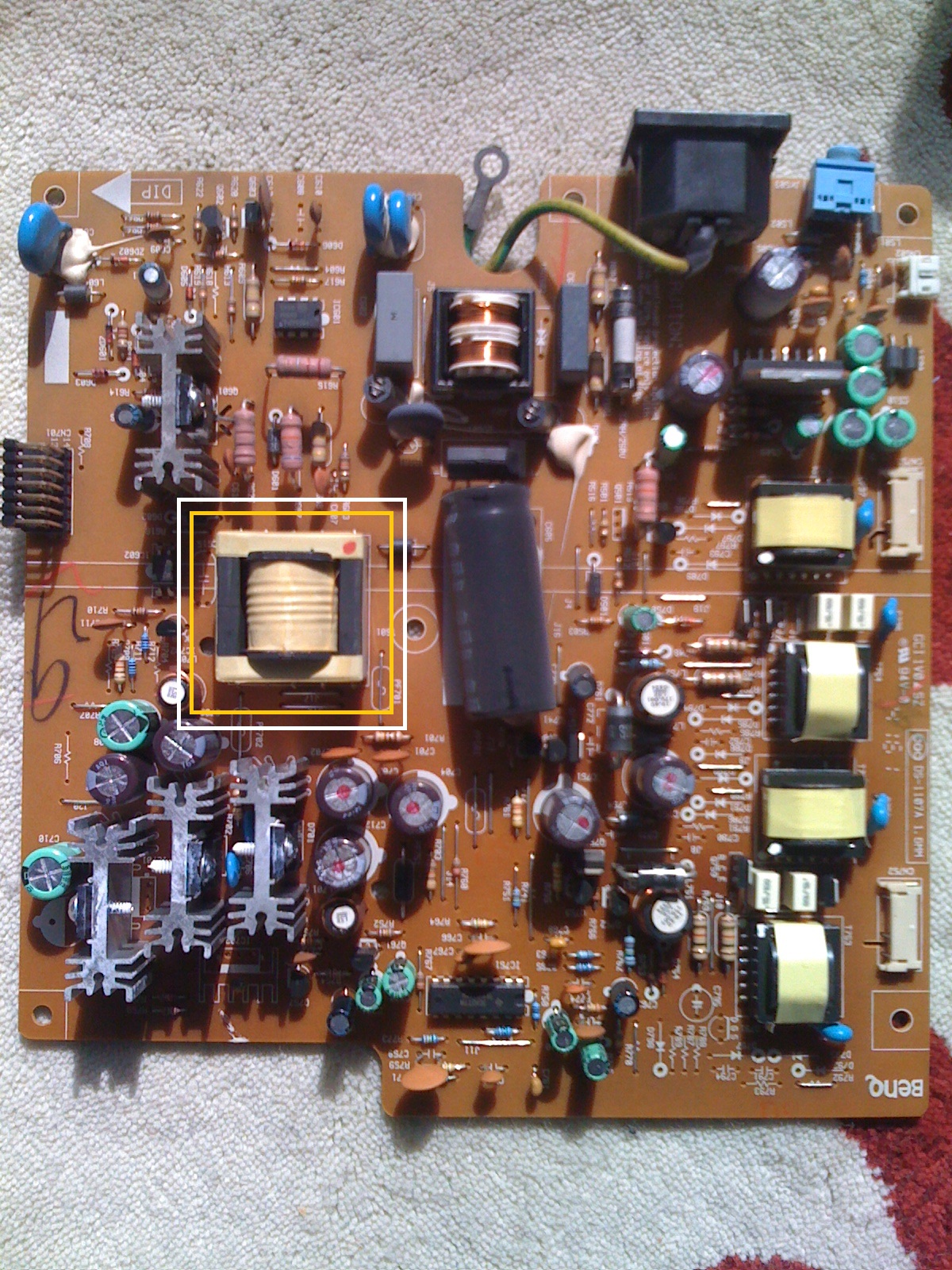

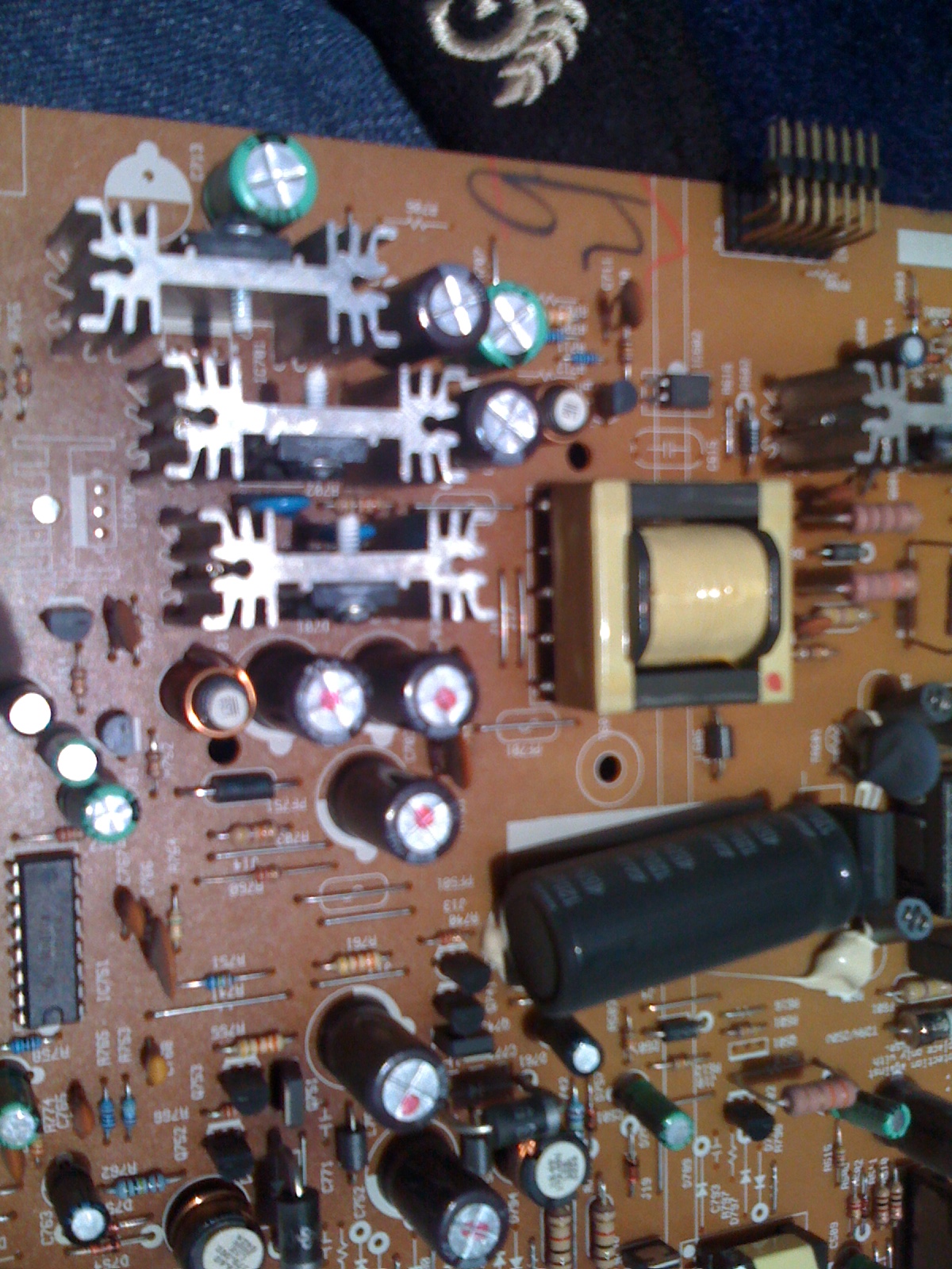

fp767 loud sizzle sound when get signal??
  • murcielagotr
    • 8
    fp767 loud sizzle sound when get signal??
    im newbie here, and im not experienced a lot at electronic, i googled and find this cool forum
    my monitor still living for now but im sure its giving a warning signal to me. yesterday i started my computer and after vga signal came my benq monitor start to sizzle continous and very loud, its sounds like little sparks jumps from edge to edge inside monitor case, so i scared and shutdown. Also i noticed when screen goes dark (loating at windows) noise is very low..
    restart to understand whats going on, monitors working correctly but sick noise never stops and when powerdown from its button noise is very low but when it shows someting its very loud and scarry, so i opened monitor's case
    after removing plastic and metal case i run it to see where is this sound coming and voila: big transformer ( sticker says :19.20273.011 LTSJ), there are 4 small of them but they dont produce sound.
    i look carefully to capacitor's top to see any defect, all seems ok to me..
    what can be the defect part??
    any suggestions???
    if i can find a good camera i will take a macro picture...
  • smason
    • 1652
    Re: fp767 loud sizzle sound when get signal??
    Have you looked at the solder joints on the bottom of the transformer? (assuming it's on the board)
    36 Monitors, 3 TVs, 4 Laptops, 1 motherboard, 1 Printer, 1 iMac, 2 hard drive docks and one IP Phone repaired so far....
    • murcielagotr
      • 8
      Re: fp767 loud sizzle sound when get signal??
      Originally posted by smason
      Have you looked at the solder joints on the bottom of the transformer? (assuming it's on the board)
      yes i applied a little heat to see solder in joints change to liquid and leave to cooldown, but i dont have solder, do i need to add solder too??
      • murcielagotr
        • 8
        Re: fp767 loud sizzle sound when get signal??
        Originally posted by murcielagotr
        yes i applied a little heat to see solder in joints change to liquid and leave to cooldown, but i dont have solder, do i need to add solder too??
        there is no change after applying heat to transistors solder joints
        and here is the pictures of board. Any suggestions??
        • PlainBill
          • Feb 2009
          • 7034
          Re: fp767 loud sizzle sound when get signal??
          Originally posted by murcielagotr
          there is no change after applying heat to transistors solder joints
          and here is the pictures of board. Any suggestions??
          1. What is the history of this monitor? It looks like some caps are original and some may have been changed.
          2. There are two possibilities - some physical change may have occurred in the transformer (in which case the noise may be annoying but is probably not harmful); or some electrical change has occurred on the board or on the logic board.
          3. By your description of the noise, it is load related. That certainly suggests an electrical change - most likely a cap failing.
          4. What is the brand and series of the light green caps? The black caps with the red dot on top?
          PlainBill
          • murcielagotr
            • 8
            Re: fp767 loud sizzle sound when get signal??
            1- im using monitor since 2005 without any problem. it doesnt see service before.(i hope i didnt buy a refurbished item from store)
            4- light green caps brand lelon or pelon, 1000uf 10v(a423 m), 33uf 50v a414m, 1uf 50v 419 m,
            black caps brand elite, and yes there are red dots on i dunno why: 470uf 35v - c 0424
            3- is this transformer can be found easily? it have 10 legs..???
            • murcielagotr
              • 8
              Re: fp767 loud sizzle sound when get signal??
              ok i went crazy with sound and removed the big transformer, i saw a little black plastic melt on its 5 legs 1 side of it. but it wast a big deal, plastic doesnt lose its shape but its surface there are tiny tiny bubles...
              is it possible the over heat of transformer, melts its copper inside to make annoying sound?
              if faulty part is transformer anyone know how to find spare part?? i mean whats voltage, current etc.. 4 transformer???
              • PlainBill
                • Feb 2009
                • 7034
                Re: fp767 loud sizzle sound when get signal??
                Originally posted by murcielagotr
                1- im using monitor since 2005 without any problem. it doesnt see service before.(i hope i didnt buy a refurbished item from store)
                4- light green caps brand lelon or pelon, 1000uf 10v(a423 m), 33uf 50v a414m, 1uf 50v 419 m,
                black caps brand elite, and yes there are red dots on i dunno why: 470uf 35v - c 0424
                3- is this transformer can be found easily? it have 10 legs..???
                I see two possible approaches.
                1. Neither Lelon nor Elite caps are noted for their quality. When a cap bulges, it is certain that it is bad. However, caps can fail without any obvious sign. Replacing all the electrolytic caps in the power supply and inverter sections would cost under $10 if you are in the USA.
                2. Benq supplies monitors to Dell. Other than the audio amplifier, that board looks exactly like power supply / inverter for a Dell E172FPb or E173FPb. The odds are very good that the transformer from a defunct Dell board would be an exact replacement.
                Personally, I would replace the caps first, but that's your choice.
                PlainBill
                Last edited by PlainBill; 03-01-2010, 10:10 AM.
                • murcielagotr
                  • 8
                  Re: fp767 loud sizzle sound when get signal??
                  thx for answer
                  i will try replace caps, i need to search local dealers first....
                  by the way, what happens if i use my monitor during finding caps??
                  • PlainBill
                    • Feb 2009
                    • 7034
                    Re: fp767 loud sizzle sound when get signal??
                    Originally posted by murcielagotr
                    thx for answer
                    i will try replace caps, i need to search local dealers first....
                    by the way, what happens if i use my monitor during finding caps??
                    Don't try to buy replacement caps from just any source. You need special low-ESR caps. Note this list for recommended brands and series of caps. Here is a list of vendors in various countries. For the USA, I recommend Digikey and their First Class Mail shipping option.
                    As far as using the monitor - if you must, you must. Stop if you feel the noise is going to drive you insane.
                    PlainBill
                    • murcielagotr
                      • 8
                      Re: fp767 loud sizzle sound when get signal??
                      thx a lot
                      • murcielagotr
                        • 8
                        Re: fp767 loud sizzle sound when get signal??
                        i dont give up and try to use it again and get mad cos of sound.
                        And again i try to check components. This time leak was visible. I m sure it wasnt like this last time.
                        Problem was biggest cap ( 450v 120μf 18mm diameter, 48mm height) i replaced it and VOILA
                        its now super silient
                        @plainbill
                        i cant find quality caps you mentioned in my city, also finding 120μf 450v from any firm was very hard. they recommend me 400v 120μf but i didnt want to buy.
                        i checked 12 store and found 1 (it was elite like old one) thx for your help.
                        its strange that 1 cap have problem and cos of it transformer generate to much buzz.
                        • PlainBill
                          • Feb 2009
                          • 7034
                          Re: fp767 loud sizzle sound when get signal??
                          Originally posted by murcielagotr
                          i dont give up and try to use it again and get mad cos of sound.
                          And again i try to check components. This time leak was visible. I m sure it wasnt like this last time.
                          Problem was biggest cap ( 450v 120μf 18mm diameter, 48mm height) i replaced it and VOILA
                          its now super silient
                          @plainbill
                          i cant find quality caps you mentioned in my city, also finding 120μf 450v from any firm was very hard. they recommend me 400v 120μf but i didnt want to buy.
                          i checked 12 store and found 1 (it was elite like old one) thx for your help.
                          its strange that 1 cap have problem and cos of it transformer generate to much buzz.
                          Congratulations for fixing the monitor.
                          The transformer noise is not surprising. Because the 'mains filter cap' cap was bad, the input voltage to the power FET varied greatly. That meant that at times the SMPS transformer primary had to handle much higher current.
                          PlainBill
                          • aidanmo
                            Philips 43PUS7506/12 - Loud blown out sound
                            by aidanmo
                            I've got a really strange issue with the speakers on my Philips 43PUS7506/12. It makes this awful loud buzzing now. It happened after it was attempted to be wall mounted - I think the back got squeezed and something broke.
                            I thought maybe the speakers got damaged, so I replaced them - no dice.
                            • Using the internal speakers, it always happens.
                            • Using the headphone jack, it never happens.
                            • Using the digital/optical out with a soundbar - it happens after about 2h/movie runtime - it's never as drastic, it just pops in and out, but I didn't want it to damage the sound bar
                            02-28-2025, 03:13 PM
                          • ChaosLegionnaire
                            what i went through dealing with my mobo with dead onboard sound!
                            by ChaosLegionnaire
                            so i took out one of my spare gigabyte ep35-ds3r mobos from storage for use to do some cpu, ram and video card testing of stuff i bought from ebay and got for free from momaka. he bought 50 e8400 cpus for cheap from ebay some years ago and i decided to help him relieve him of some of his supply since he had waaaay too many!! what did we say about hoarding too much stuff and depriving others of them?! *cough* socialism *cough* lol!
                            i had to blow some dust off the board and heatsinks with the datavac as i didnt clean it up before putting it in storage. after finishing...
                            09-13-2022, 09:02 AM
                          • AstutePauciloquent
                            Requesting Help For GA-970A-DS3 rev. 1.0, No Post code, no RSMRST# signal
                            by AstutePauciloquent
                            Hi everyone, over the past few months i have taken a deep dive into motherboard diagnostics and I love the challenge. Currently im trying to learn all about the signals that travel around the motherboard, such as frequencies, enable signals High and Low logic states etc. And i have been learning to read and using the Schematics for this board that i requested here on Badcaps forum, from a few months ago, this is such a great place for these.
                            I’ve been working on a GA-970A-DS3 (rev. 1.0) that does not post. This motherboard has been my main learning board. I would like share...
                            11-23-2023, 11:02 PM
                          • eduaqa
                            Amplifier - bad sound when loud sound on bass
                            by eduaqa
                            I'n trying to fix a M&S SYSTEM DMC-1which have following problem:
                            I'm using FM station to do this fix, I works perfect if volume below around 8 or if bass is set to zero, the sound can go to 20 without problem, but if I set bass to maximum and try to go over 10 the sound comes distorted ... I saw a video on YouTube the person saying about the main capacitors on the power portion, but I disconnect the main transformer and inject direct to the capacitors PINs my bench power supply -23v 0v +23v, but still distorted so I think the problem is not the capacitor neither the transformer...
                            08-06-2022, 11:28 AM
                          • Christos Tsiligiannis
                            Marian Trace Alpha sound card repair help
                            by Christos Tsiligiannis
                            Hello to the forum.
                            My name is Christos, I am new to the forum here and i am posting from Greece.
                            So i have this old German sound card from Marian, called Trace Alpha. To be exact i have 2 of them and i use them professionally for my small FM radio station here. The first one works like a charm, but the second one does not work at all.
                            To be more specific in the same exact pc with windows 7 (i even tried 32bit) the one works while the other doesn't.
                            So i tried asking for a schematic from the company and they would not give me one. Instead they...
                            11-18-2024, 05:26 AM
