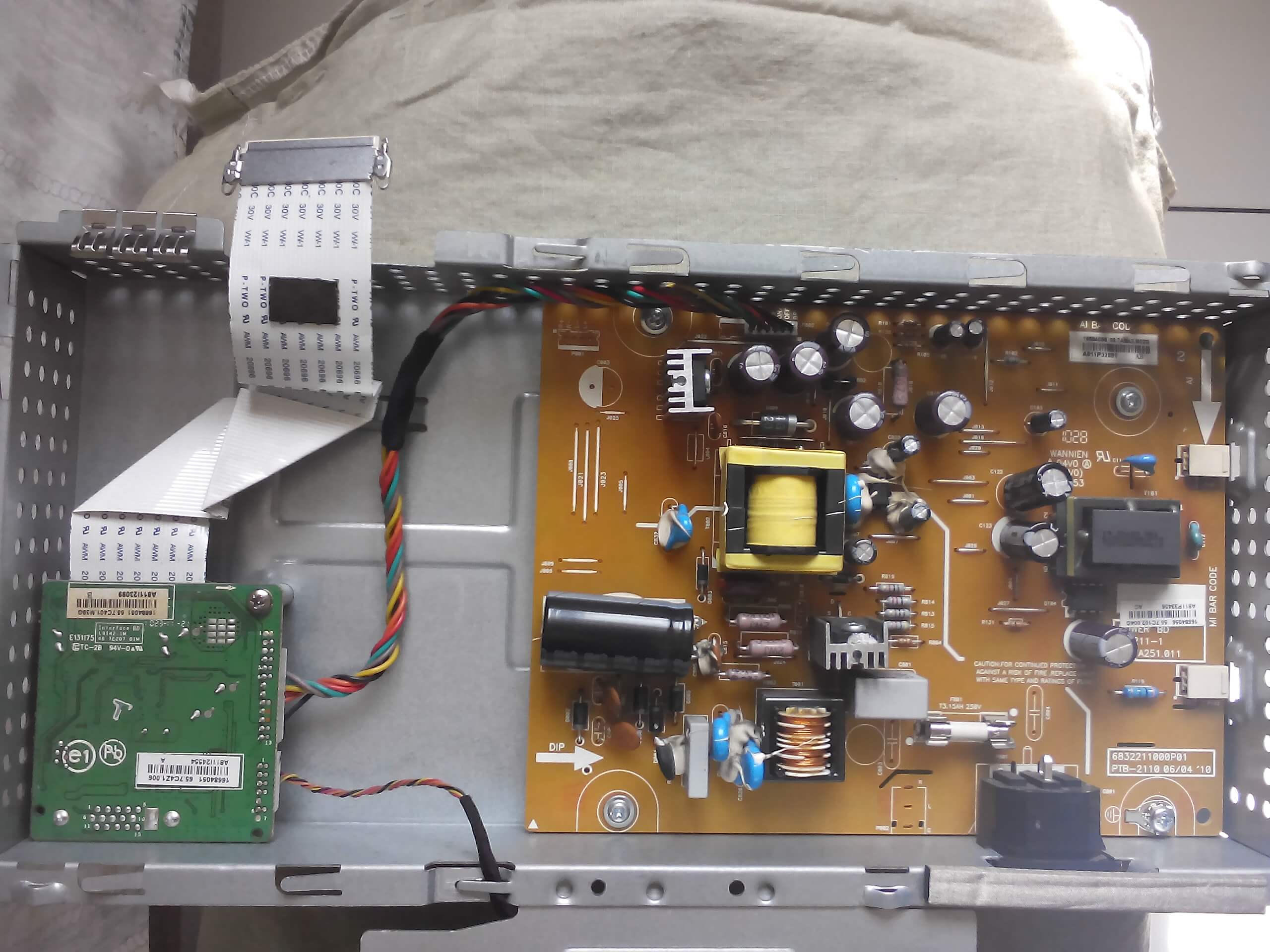

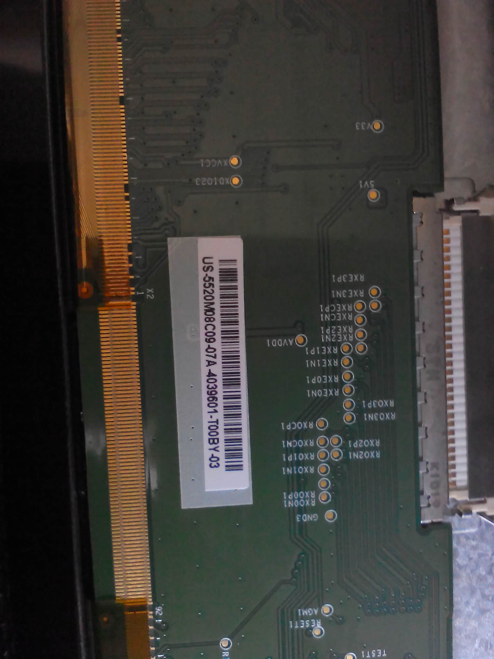

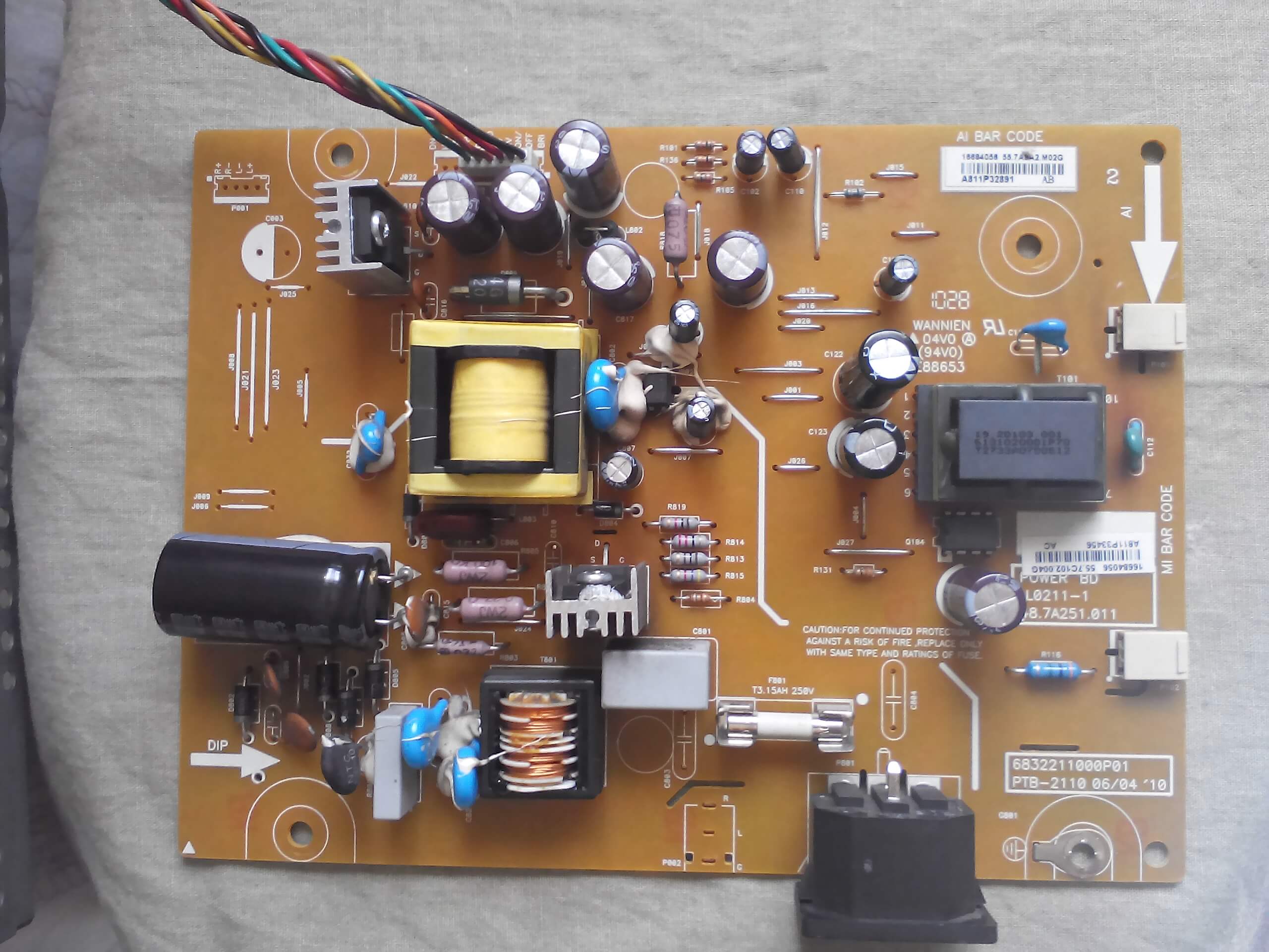

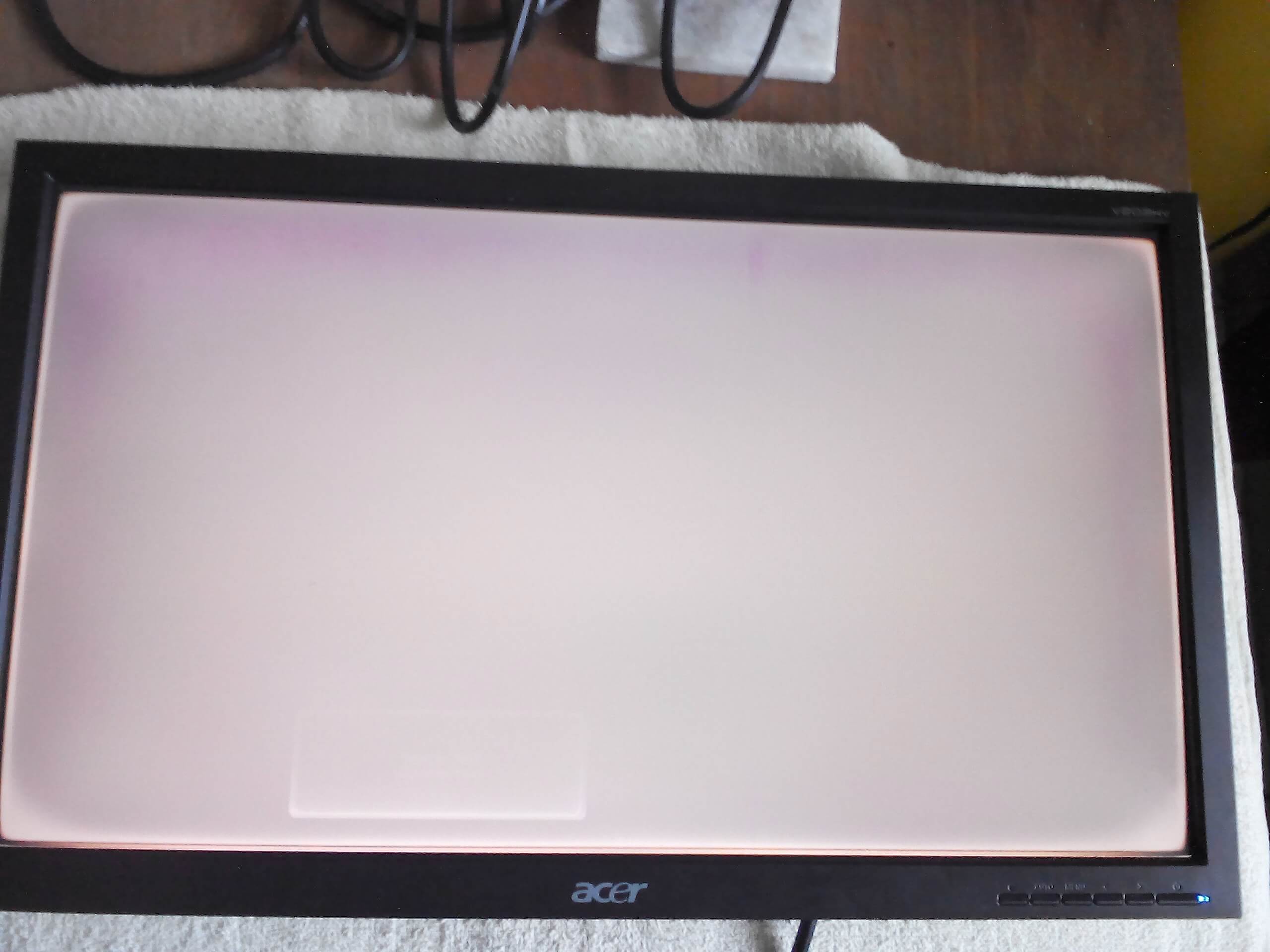

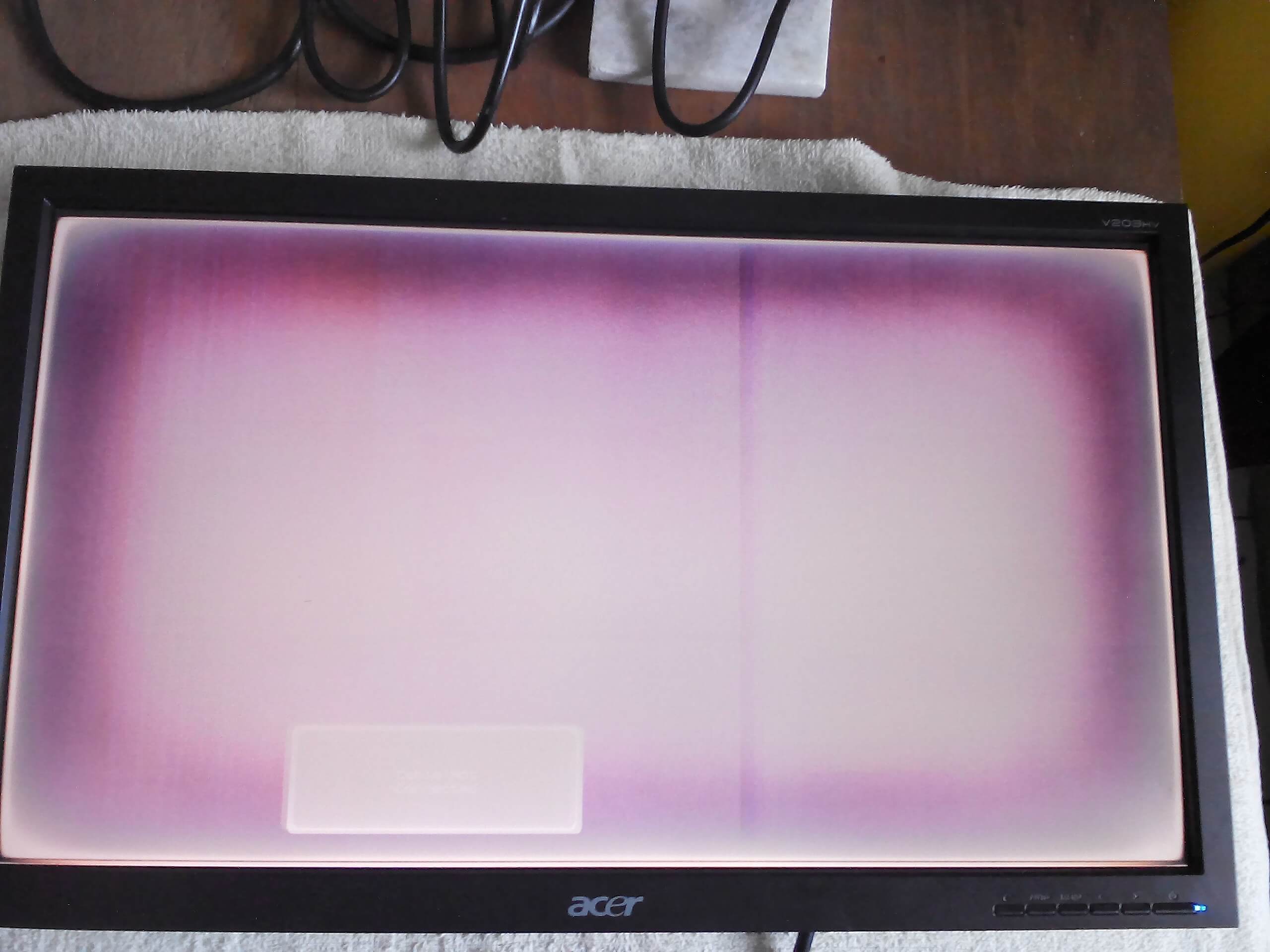

    Hi forum friends,

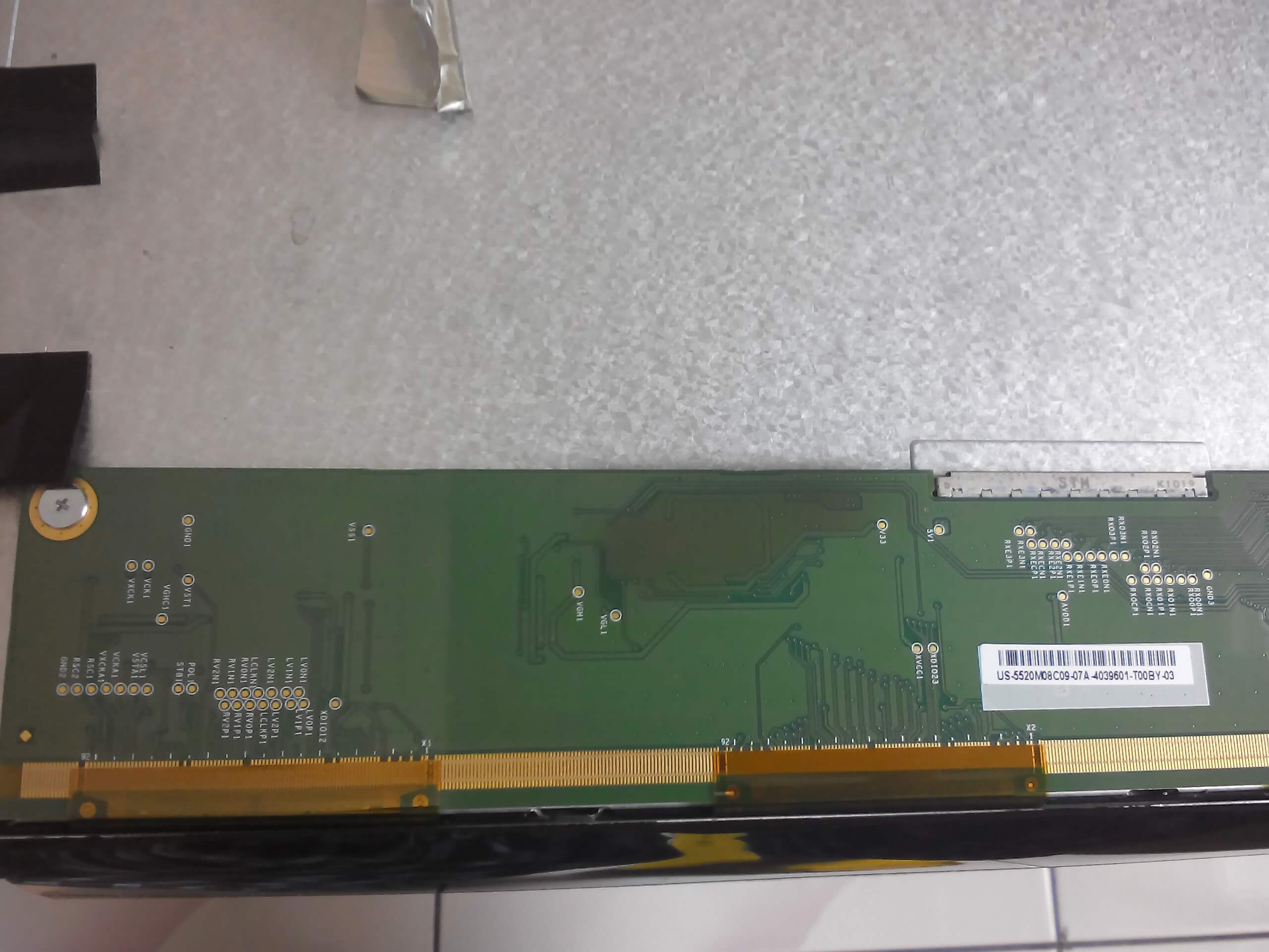

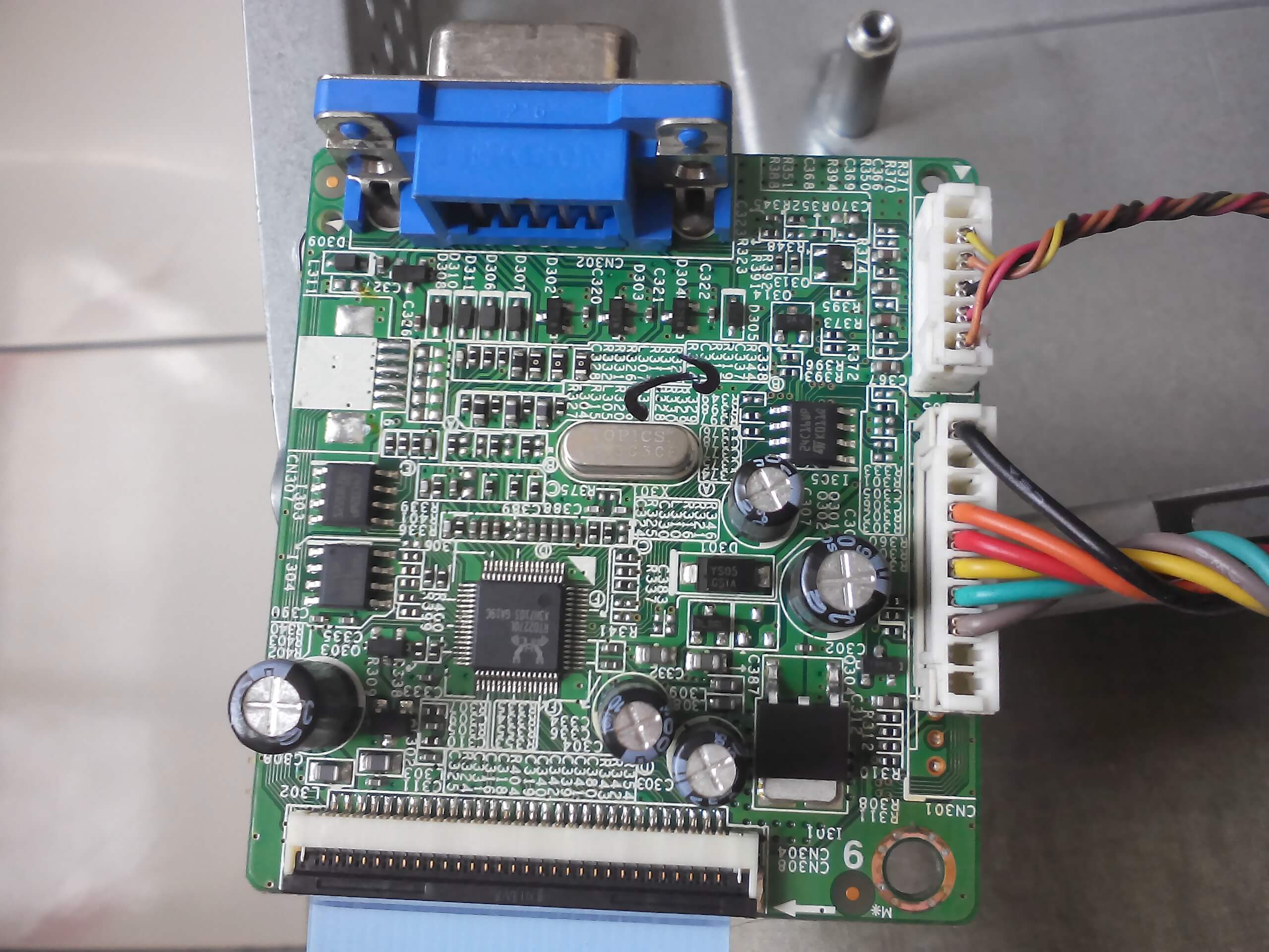

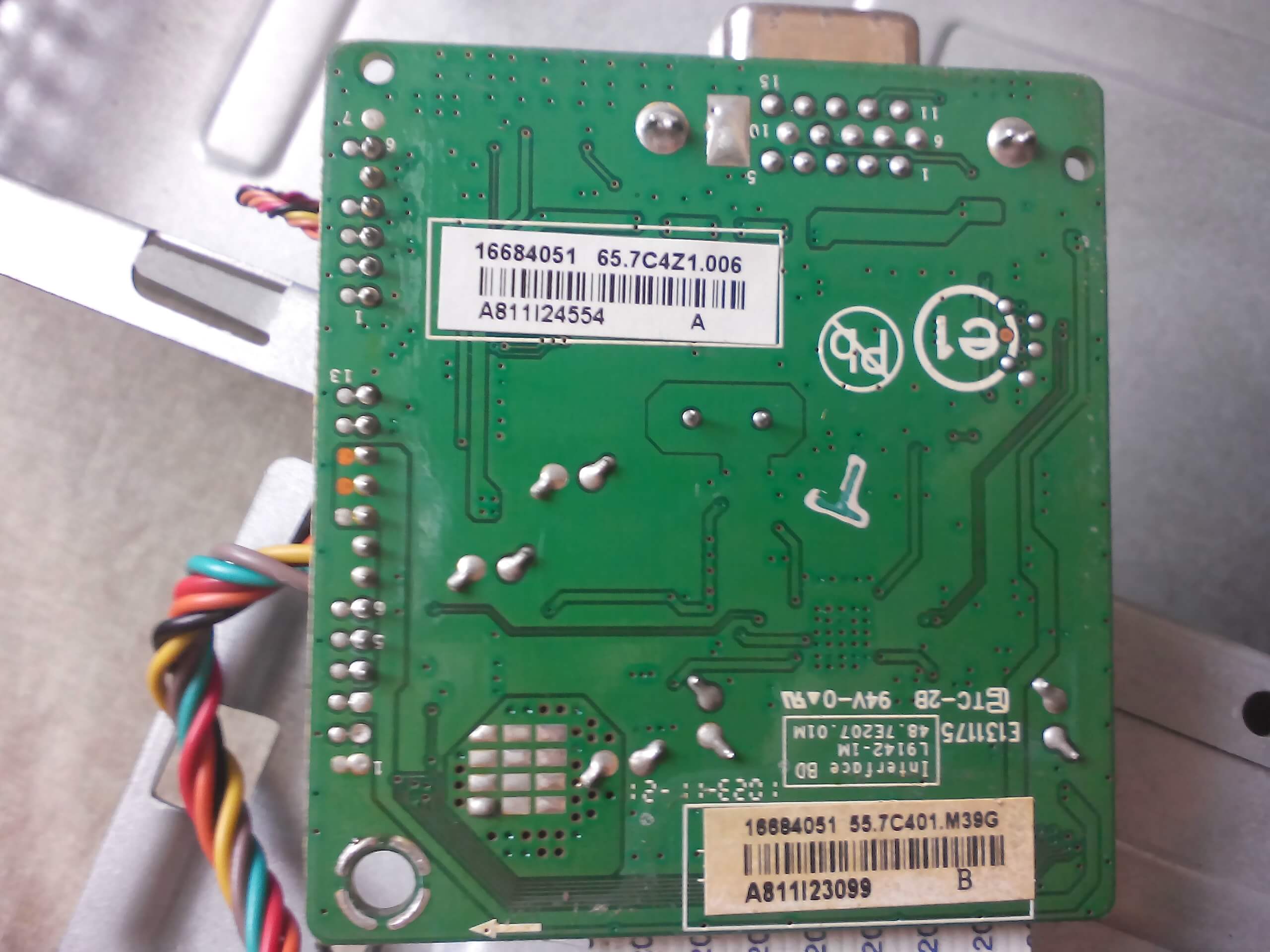

    This Acer v203HV lcd monitor has been working normal for more than 5 years until yesterday. When i switched on, the normal Acer logo appears but after less than 1 minute, the display turns pink hue( image 090232),shortly it becomes white (image 090246). So i opened up the monitor case, checked the main board and scalar board (image 091912).
    Nothing burned, no cold solder, the fuse and diode all checked good, even capacitors with low esr 0.00 off the board.

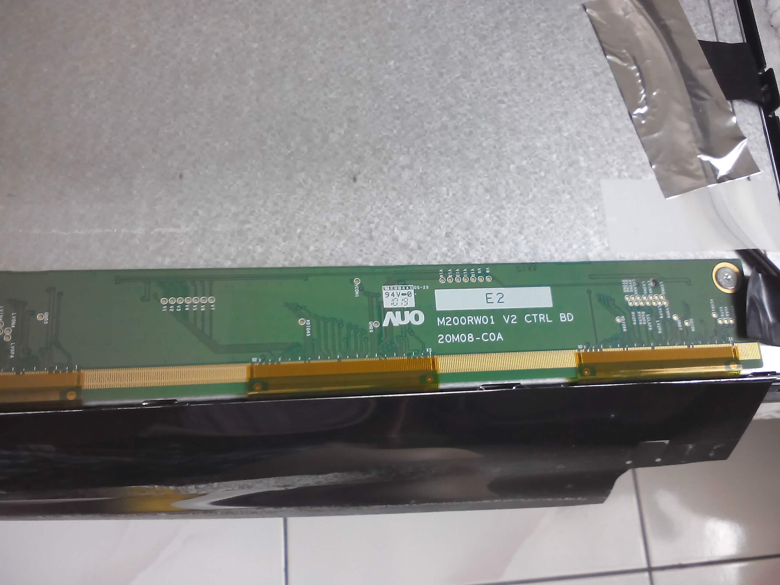

    Also checked the tcon board, and found nothing peculiar. Has anyone experienced this before or has any suggestion on what to check next? Kindly offer your help to save this monitor. Thank you in advance.

    Re: Acer v203HV turns pink to white display
    Hi!
    How many volts on the board t-con at the point 5V1 ?

        Got 5vdc at the point 5V1 on the tcon board.
        Appreciate your help to diagnose this monitor . Hopefully it will return to its full working condition from your step by step instruction.
          Measure the voltage t-con board at all points marked V ( for example VGH, V33 and rest). Make a table.

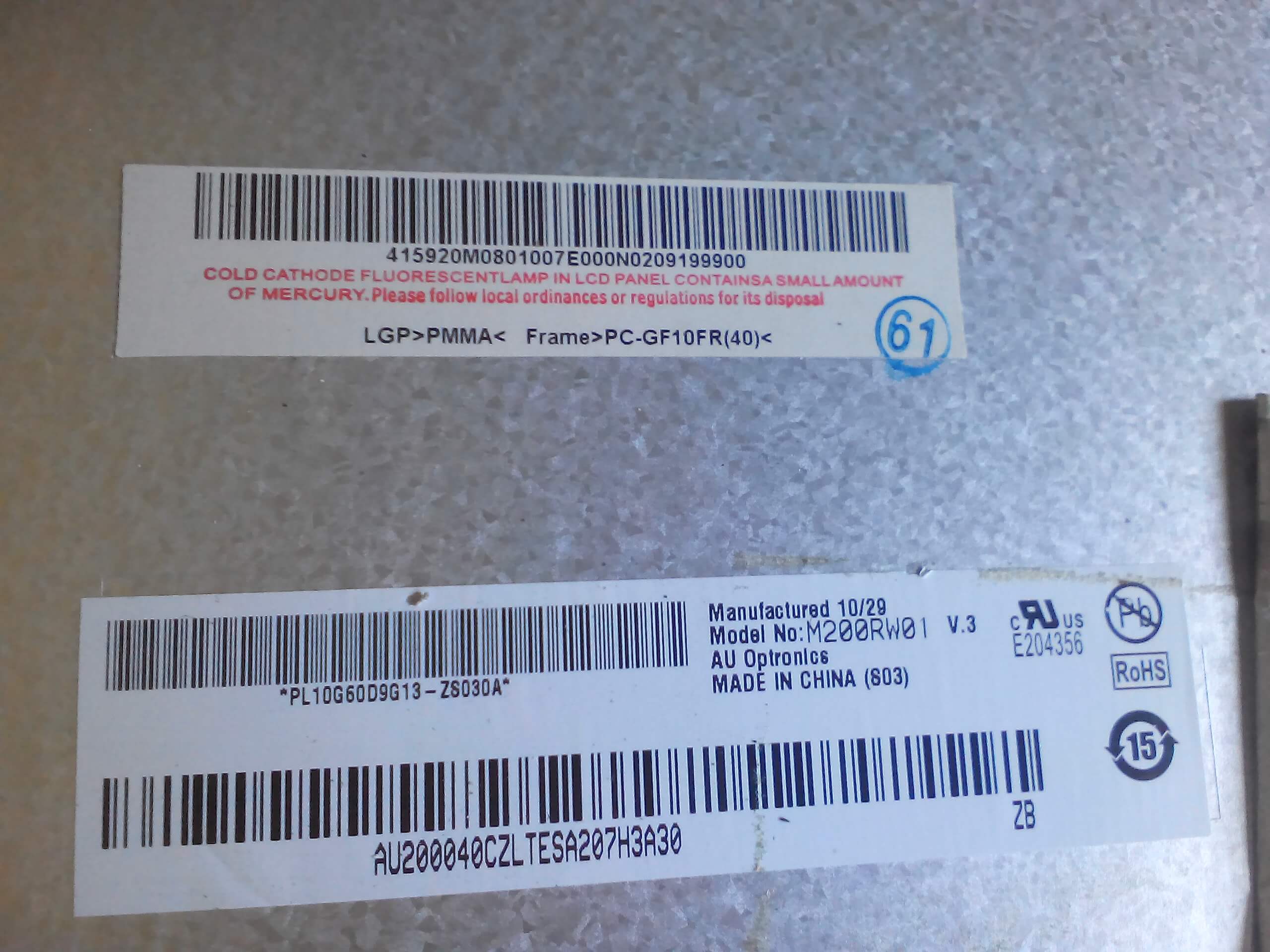

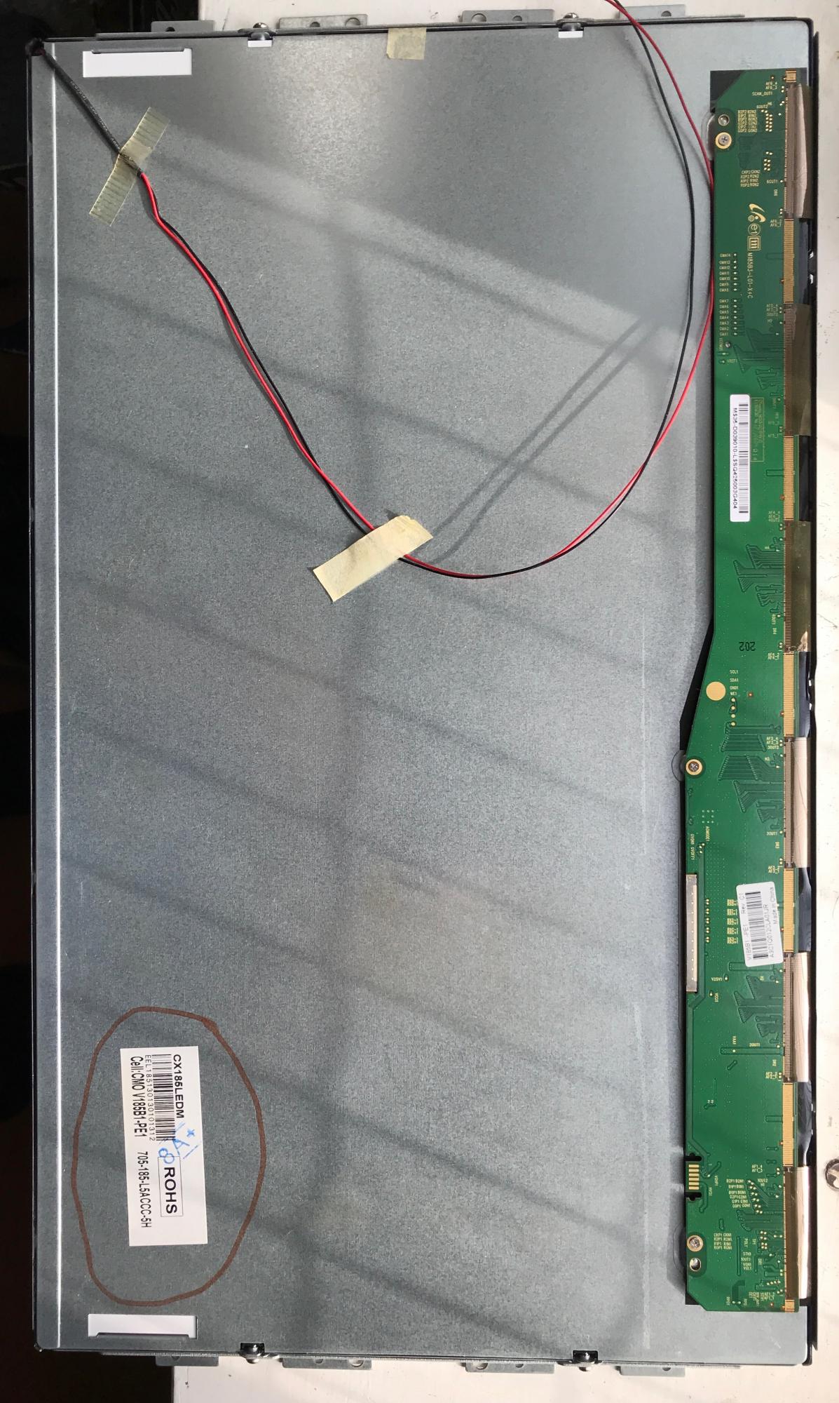

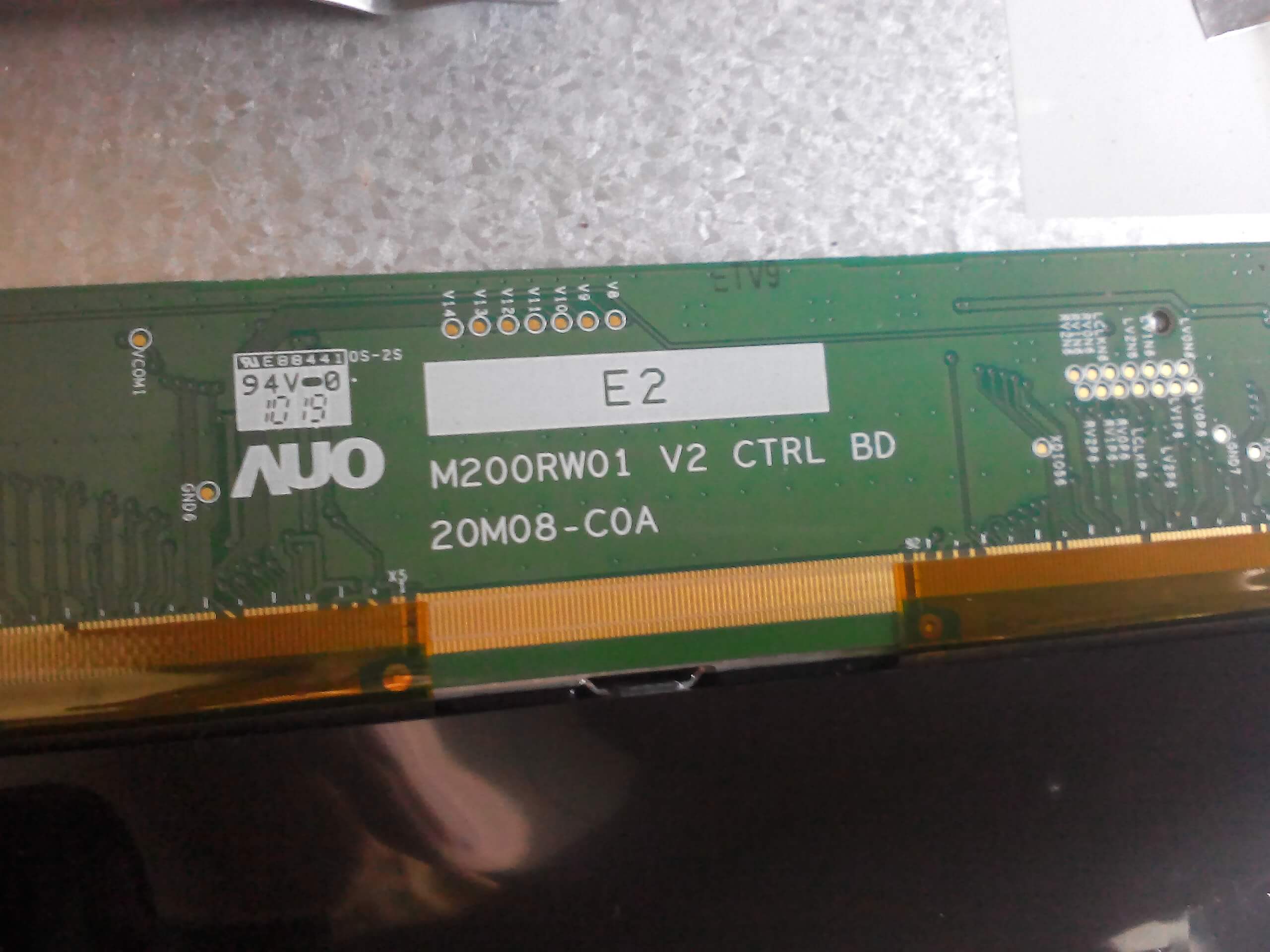

              Add a photo of the matrix sticker (model type)
              • mikey5791
                • Dec 2014
                • 521
                • Malaysia
                Attached a photo of the matrix sticker (img 093038) and display model (img 093112).
                Kindly request if you need any other photo for reference.
                  In the red circle for example
                  • mikey5791
                    • Dec 2014
                    • 521
                    • Malaysia
                    Attached the matrix sticker (display sticker). Sorry i misunderstood your request.
                    Appreciate your patience to guide me.

                        • kiwin
                          • May 2021
                          • 11
                          • Russia
                          The problem sounds like a faulty matrix board. Perhaps some element under voltage is changing its parameters, I would check the elements on the board by heating or cooling locally. You may be able to find a faulty one.
