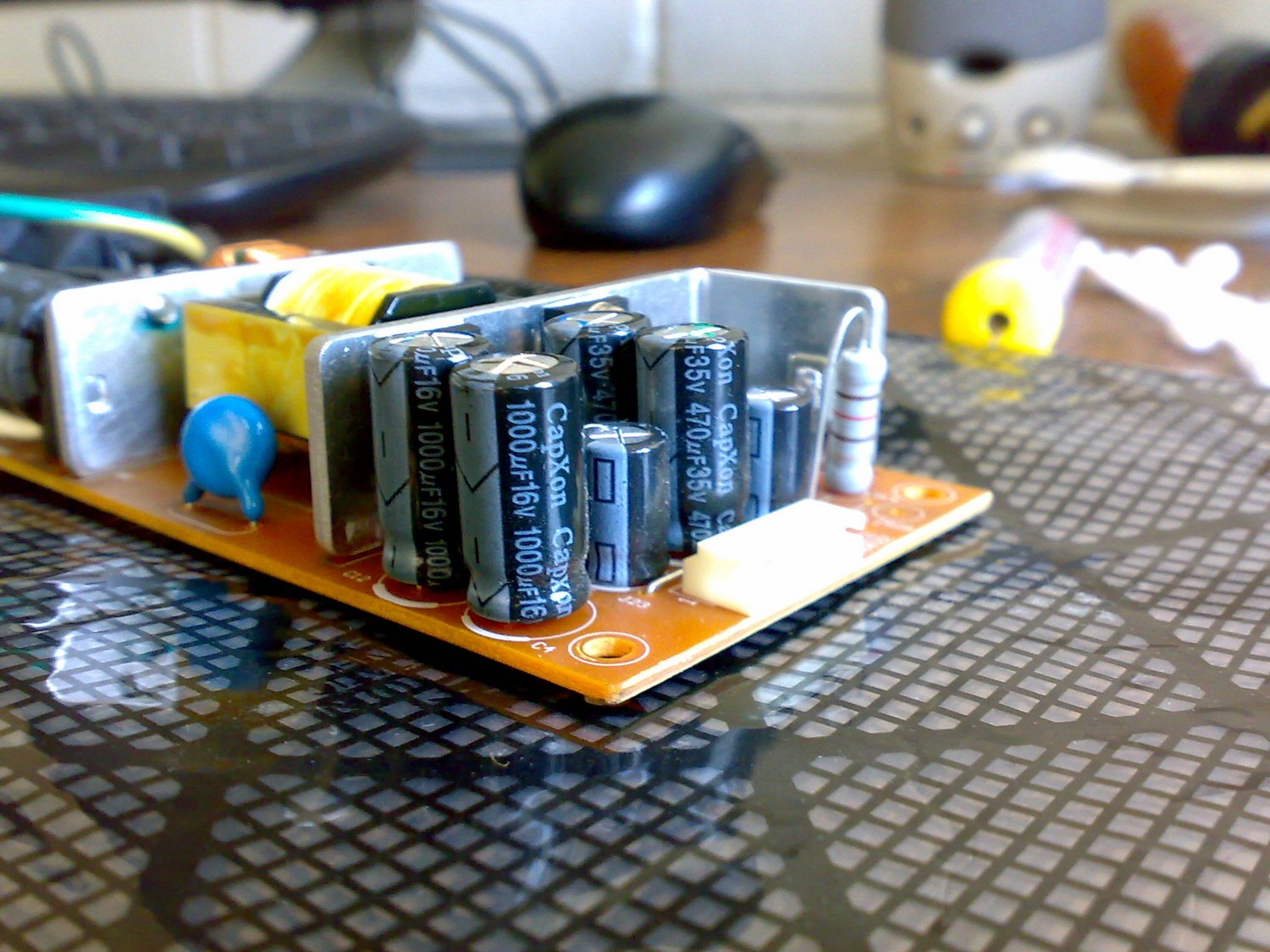

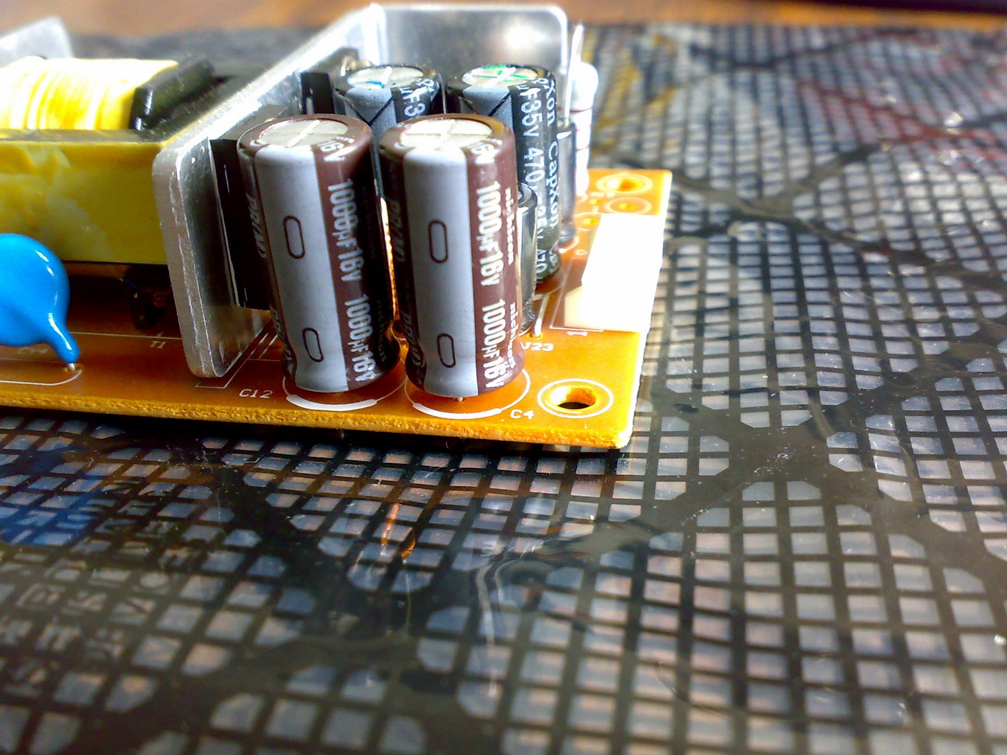

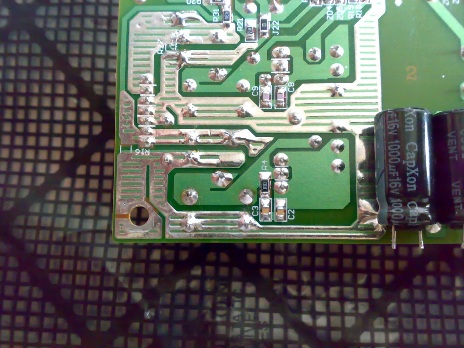

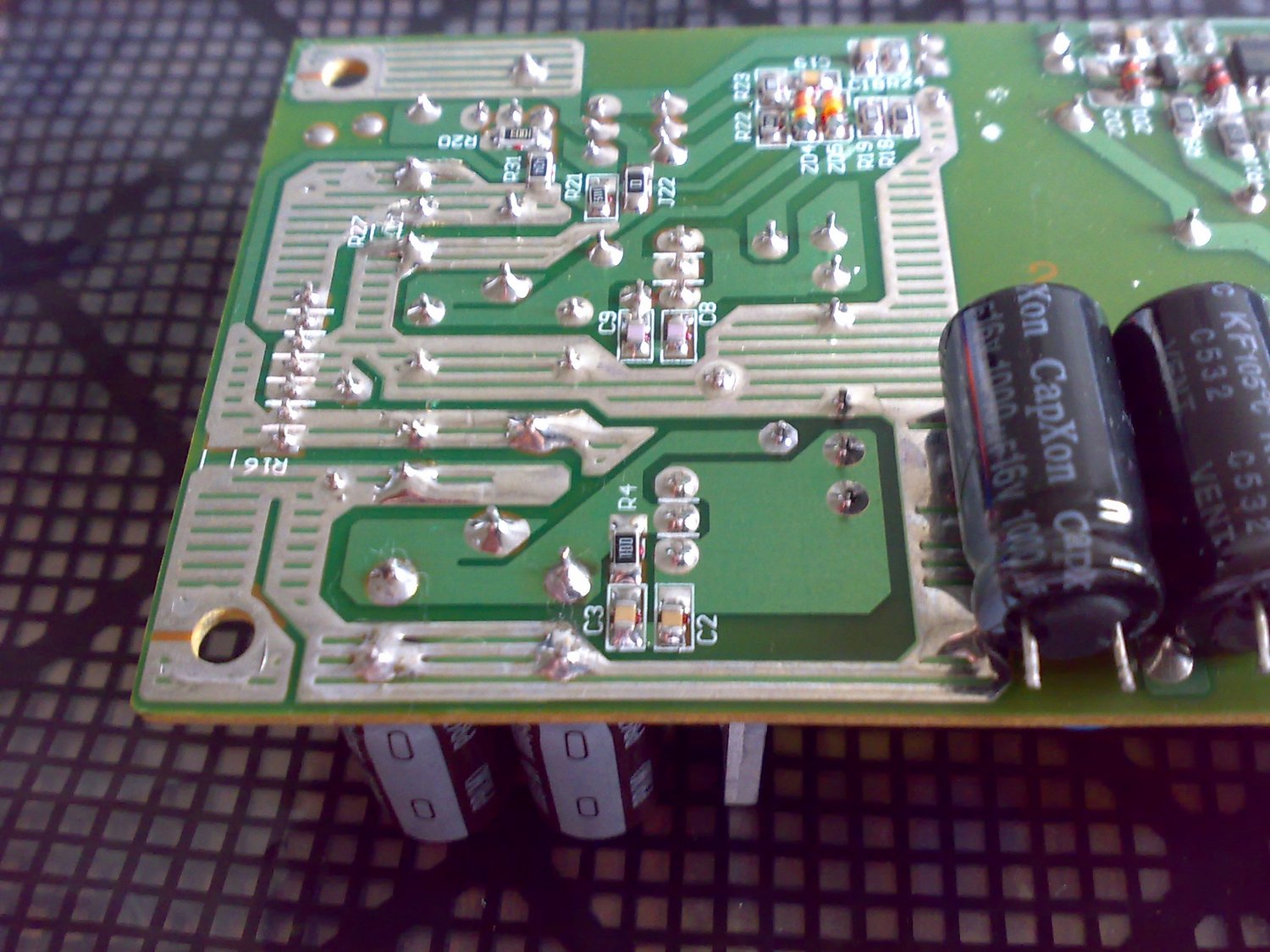

    Recapping Viewsonic VP930b
    My Viewsonic vp930b didn't want to turn on, it had been abandoned like 5 months. Today i recap the psu, and voila! it works!!!! Not bad for the first time recapping, just recaped 2 blowed 1000uf 16v Capxon, i will recap all when i have some good brand caps.

    Good job. Just put nice good caps in there and it will work as it should
