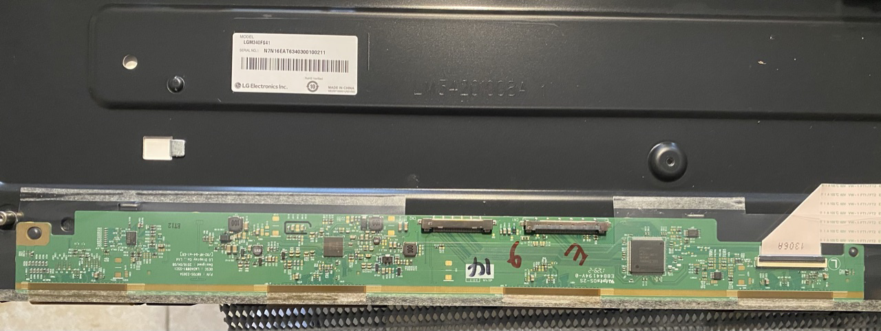

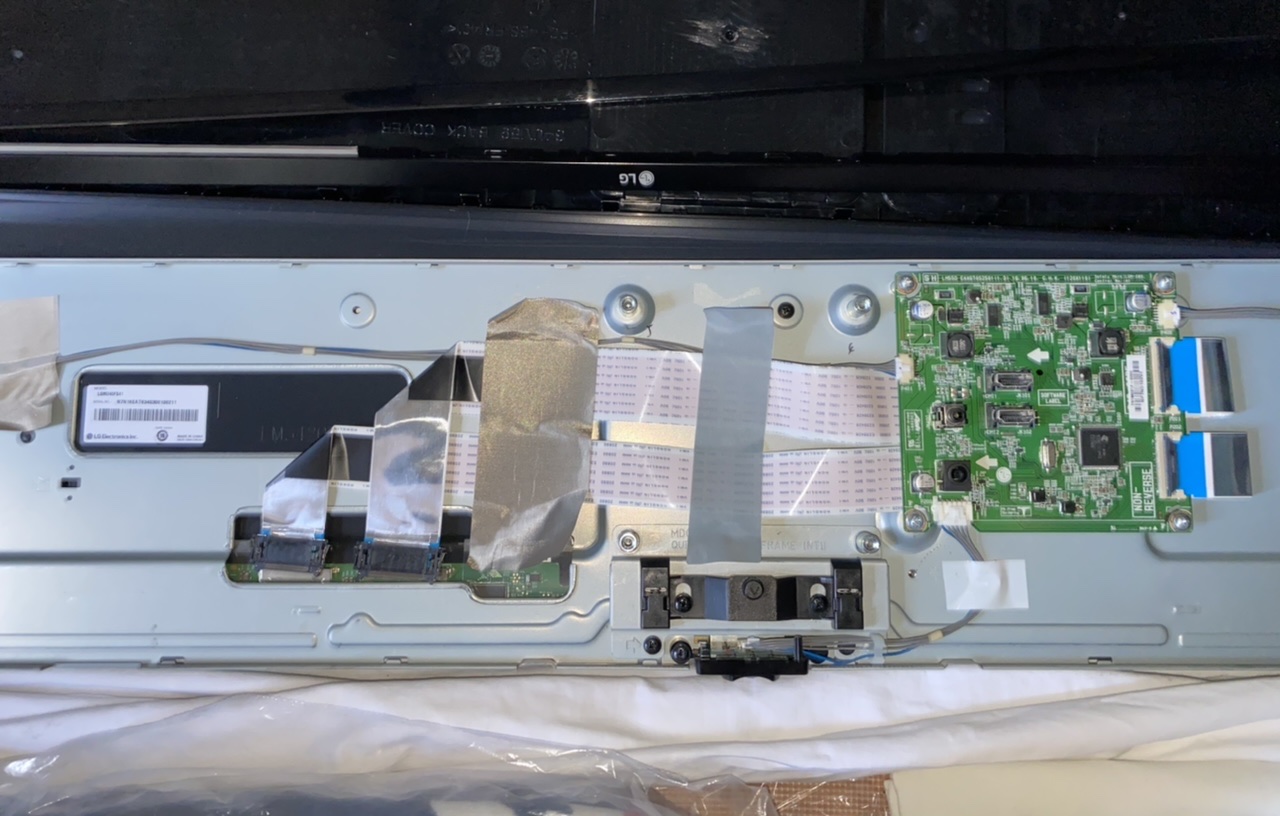

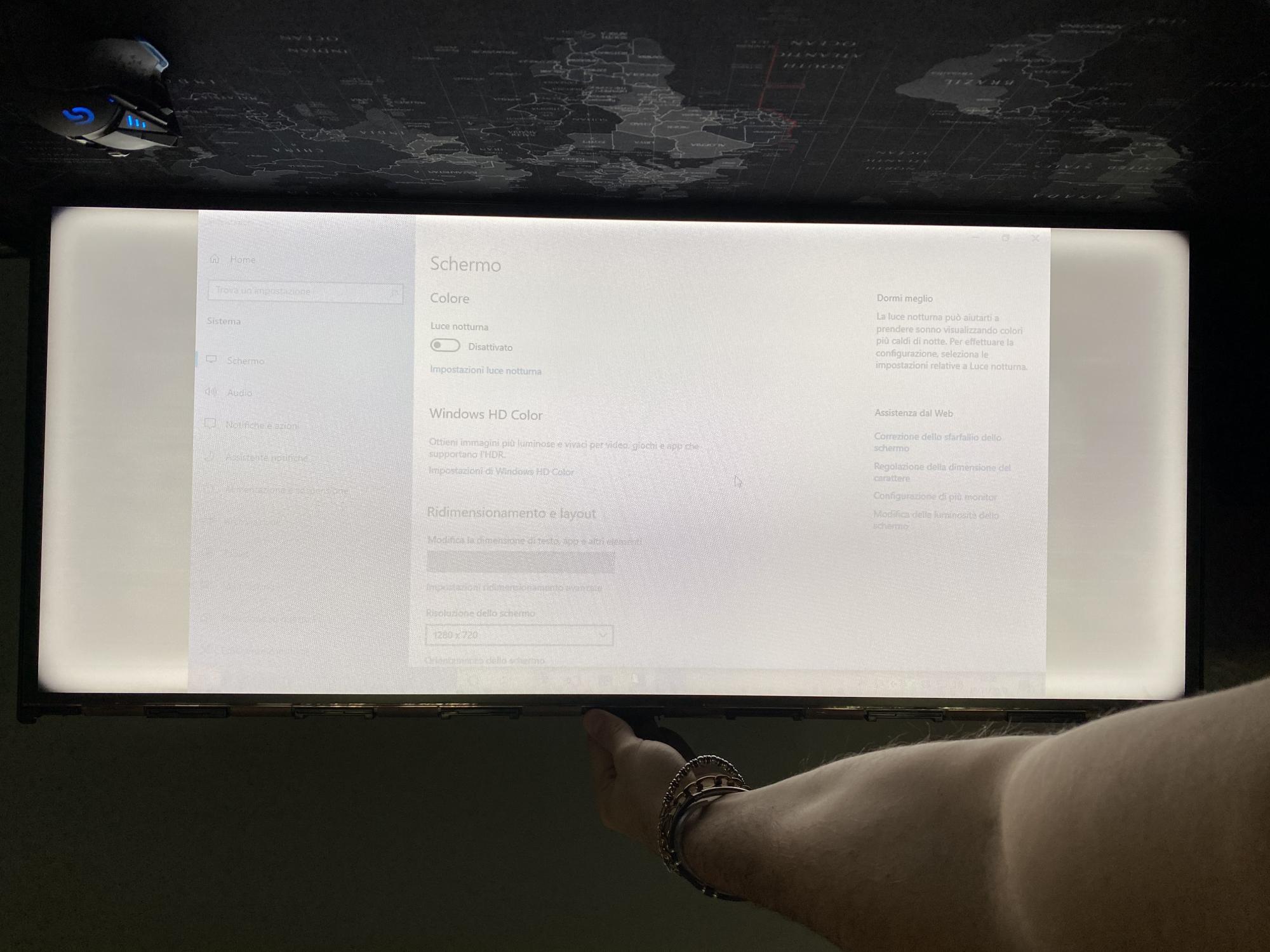

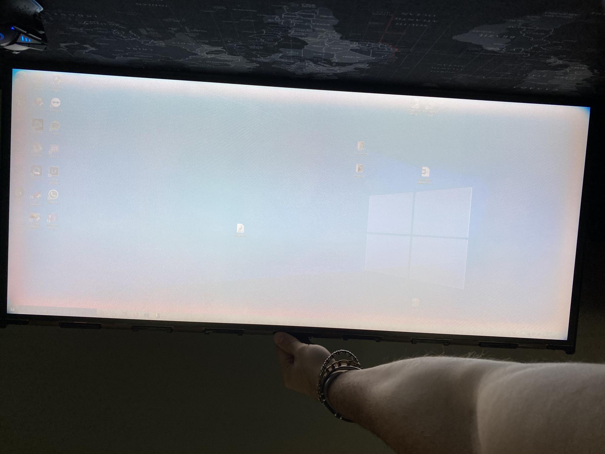

    Hello everyone and thanks in advance for the support!

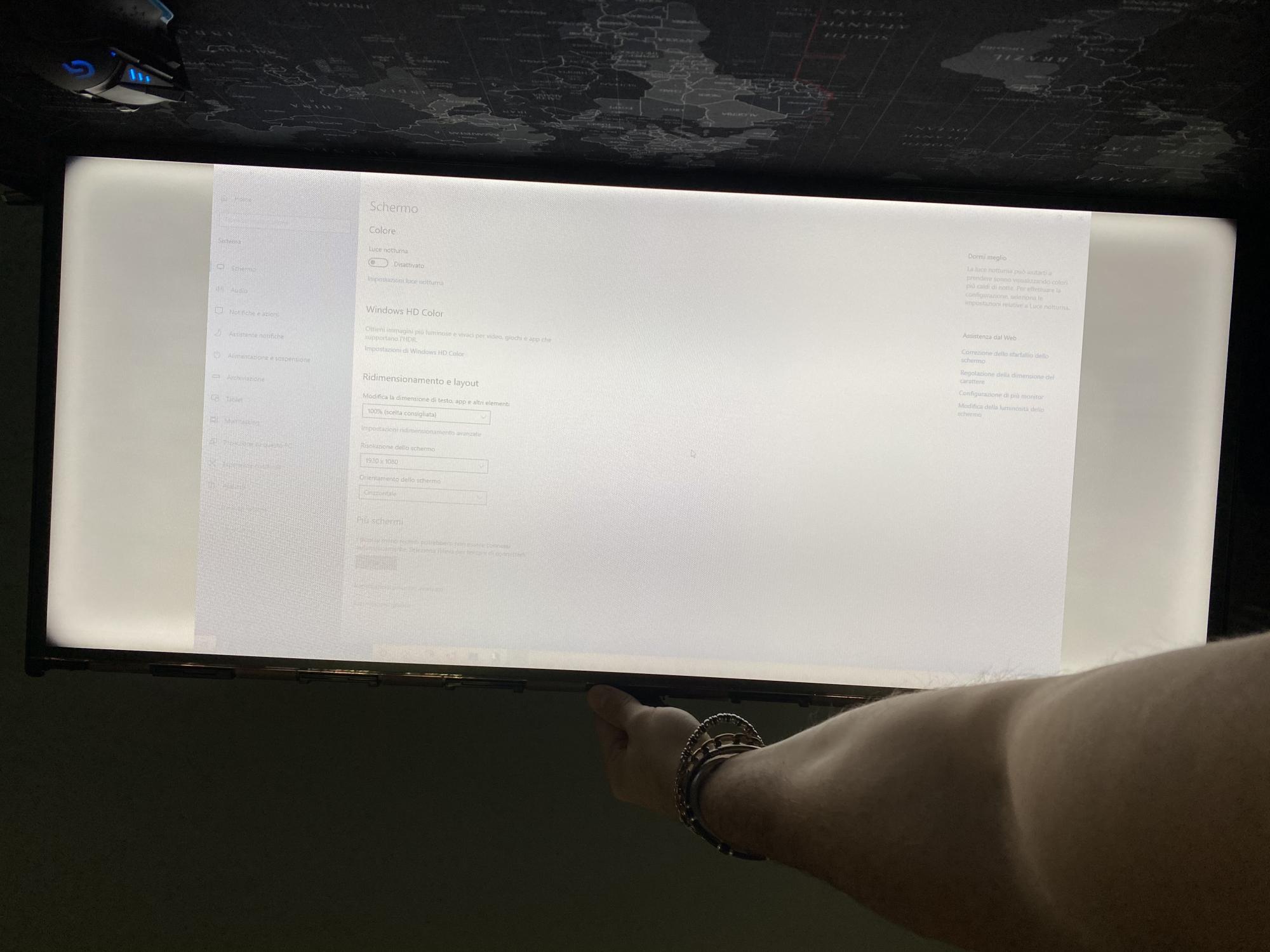

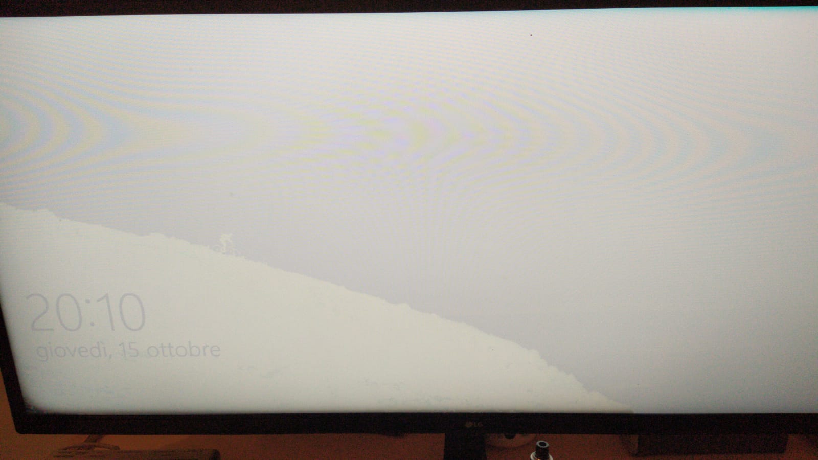

    I have an LG 34UM59 that has a white “washed out” image defect (see last picture).
    I was in a hurry and ordered already the mainboard to try the replacement (hoping that the fault is there...)
    But I have a question.. I disassembled all the monitor and found the tcon board ( which in my case is divided in two segments, linked by a flat cable).On the first segment there are some chips similar to the A15 you spoke about and which I found on various threads on internet. But they all have different names from A15.. if the new mainboard won't fix the problem, what chip do you think is responsible for the white image fault? I attached the photos of the board and the chip..
    Oh and.. I tested alle the VGL,VGH,VCOM voltages on the tcon board, none of them is 0v..
    Thank you very much in advance!!!

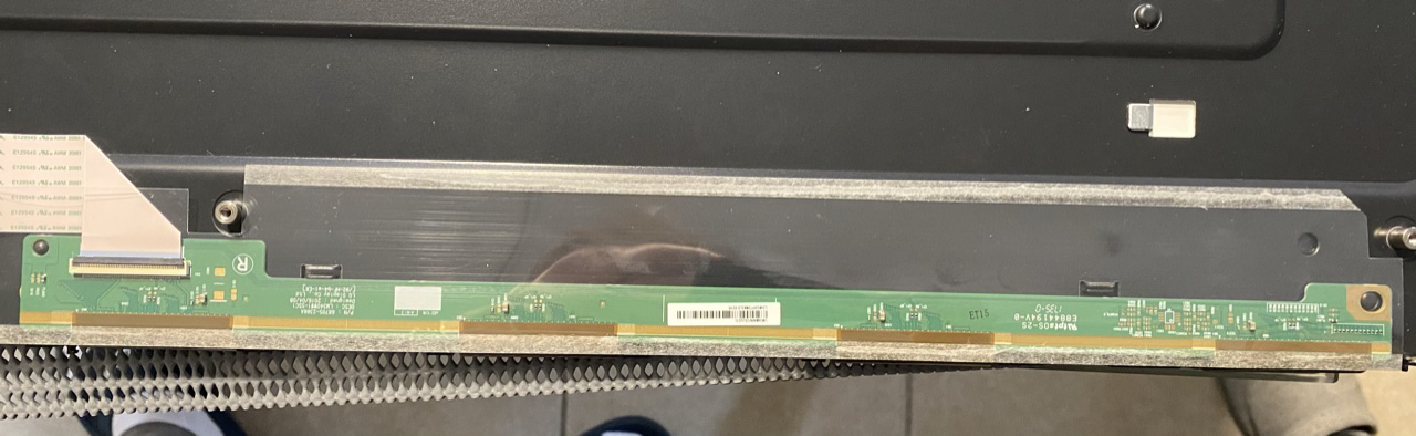

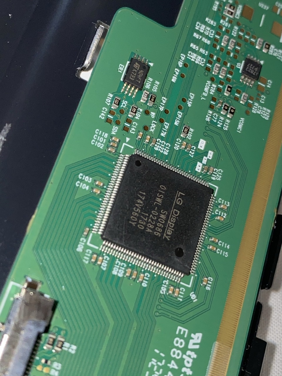

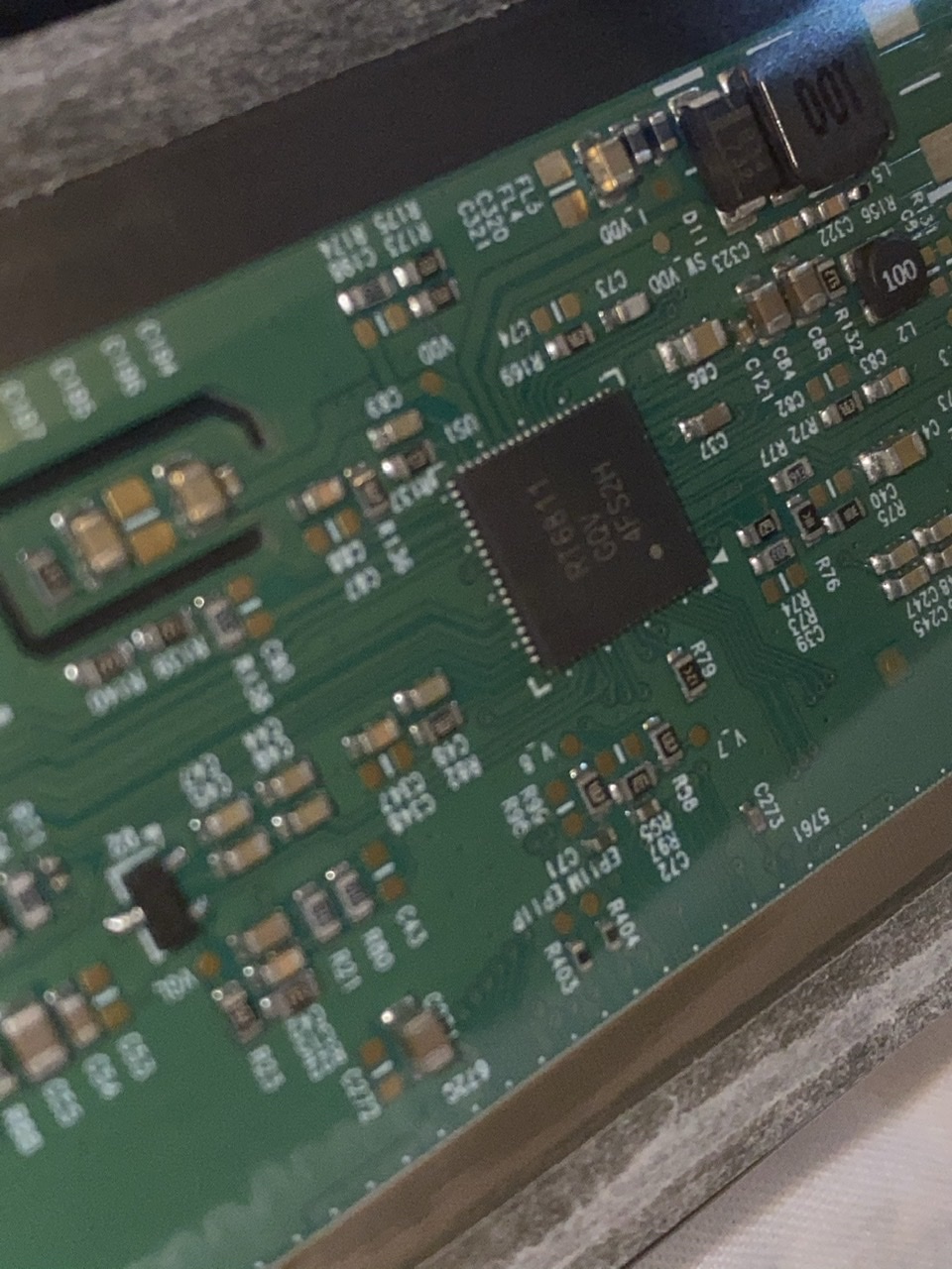

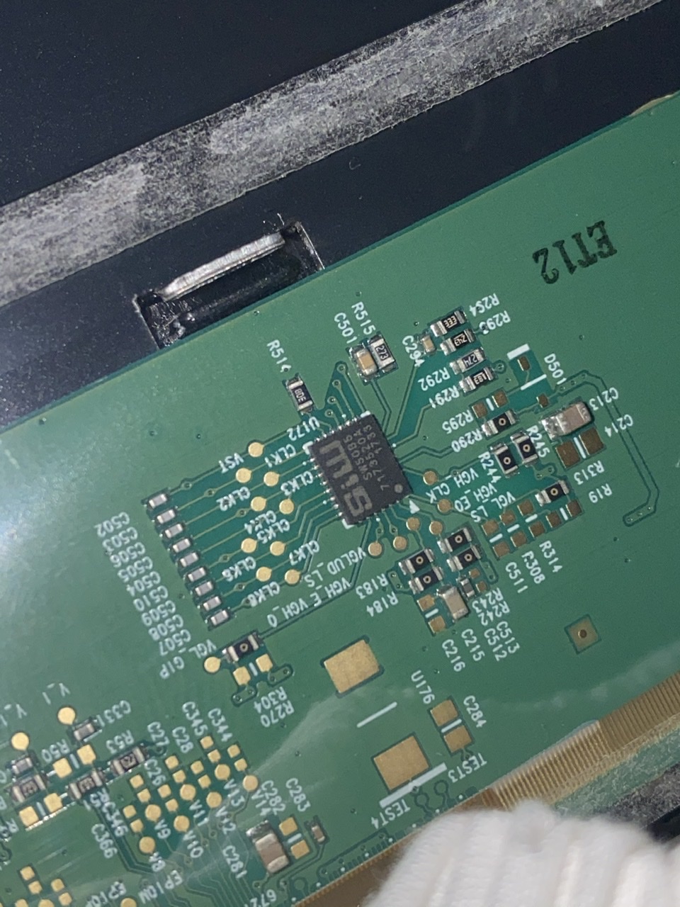

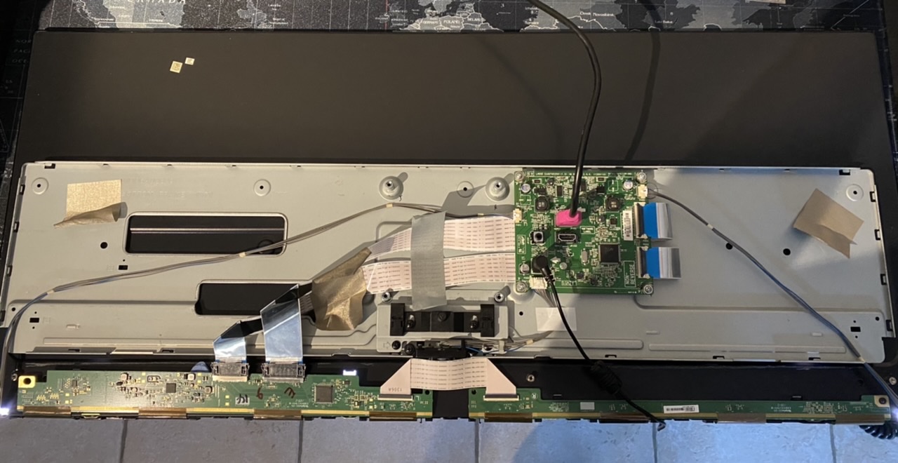

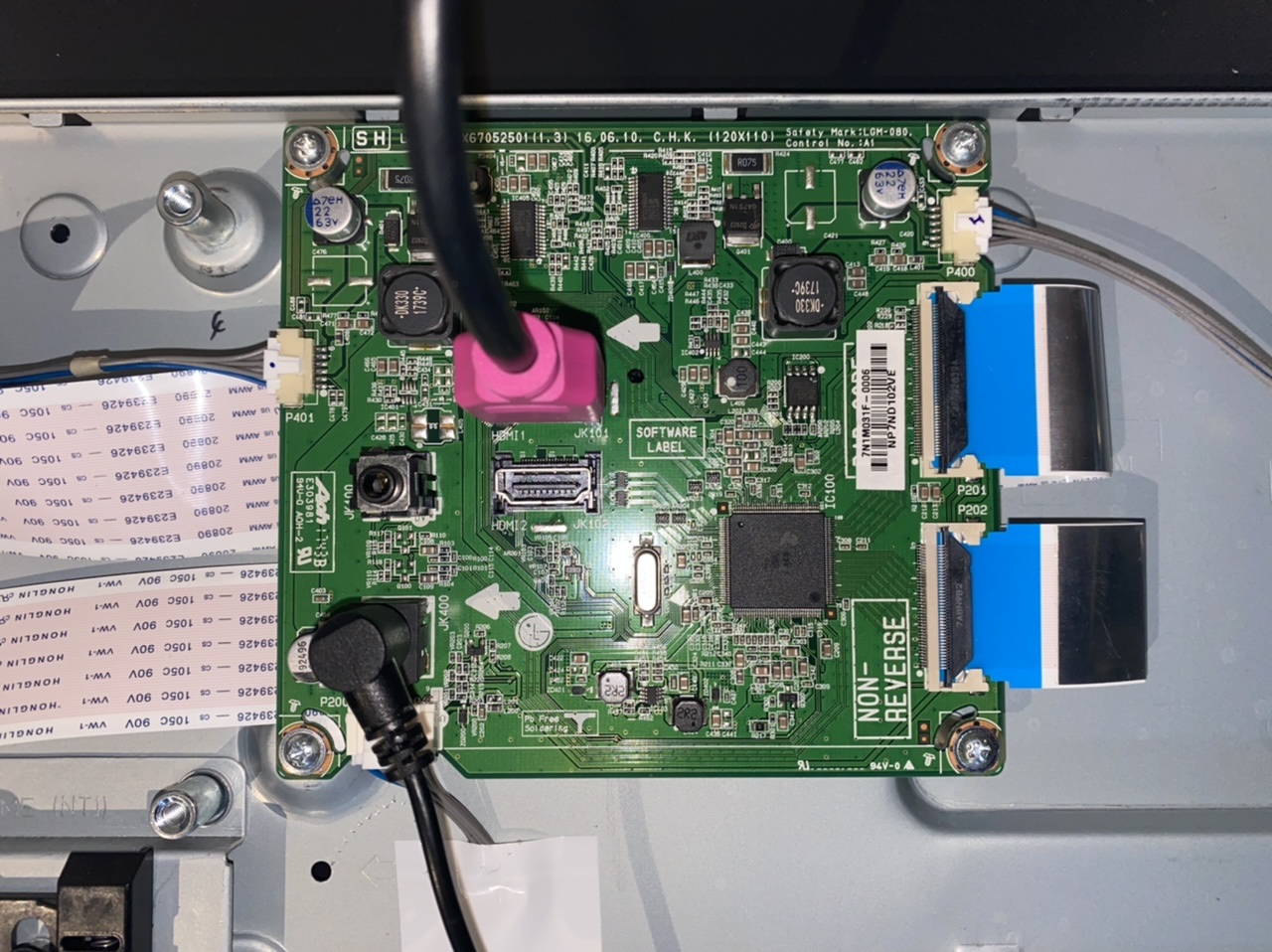

    In the photos you'll find:
    1-mainboard and its 2 flat cables going down to the 1st tcon
    2-tcon board (1st segment)
    3-tcon board (2nd segment, linked to the 1st by the flex cable)
    4/5/6- some particular chips that may help us troubleshooting
    7-image defect

      Thanks for the reply.
      The big problem is that the two tcon boards have 4 flat cables each and this cables going to the display panel are DIRECTLY soldered to the tcon and the panel...
      In fact I can’t detach them because I won’t be able to resolder them..maybe the only way is to find the integrated chip which is giving problems

        connect this LG Monitor to PC and change the resolution of the pc each time... show us the result with photos over here and don't forget to write on each photo which Resolution it was.

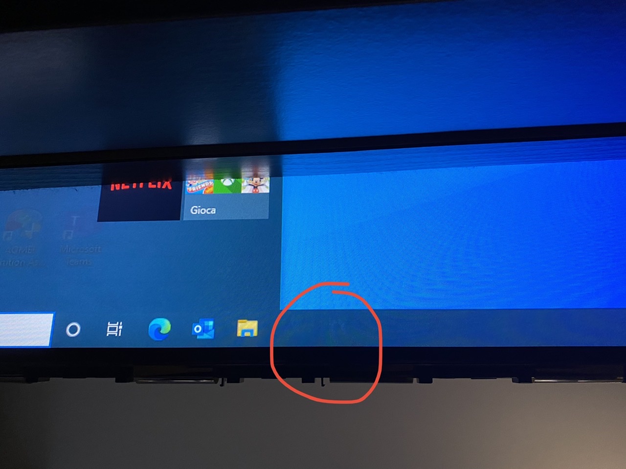

          Here I am!
          These are the 3 photos:
          -2560x1080
          -1920x1080
          -1280x720

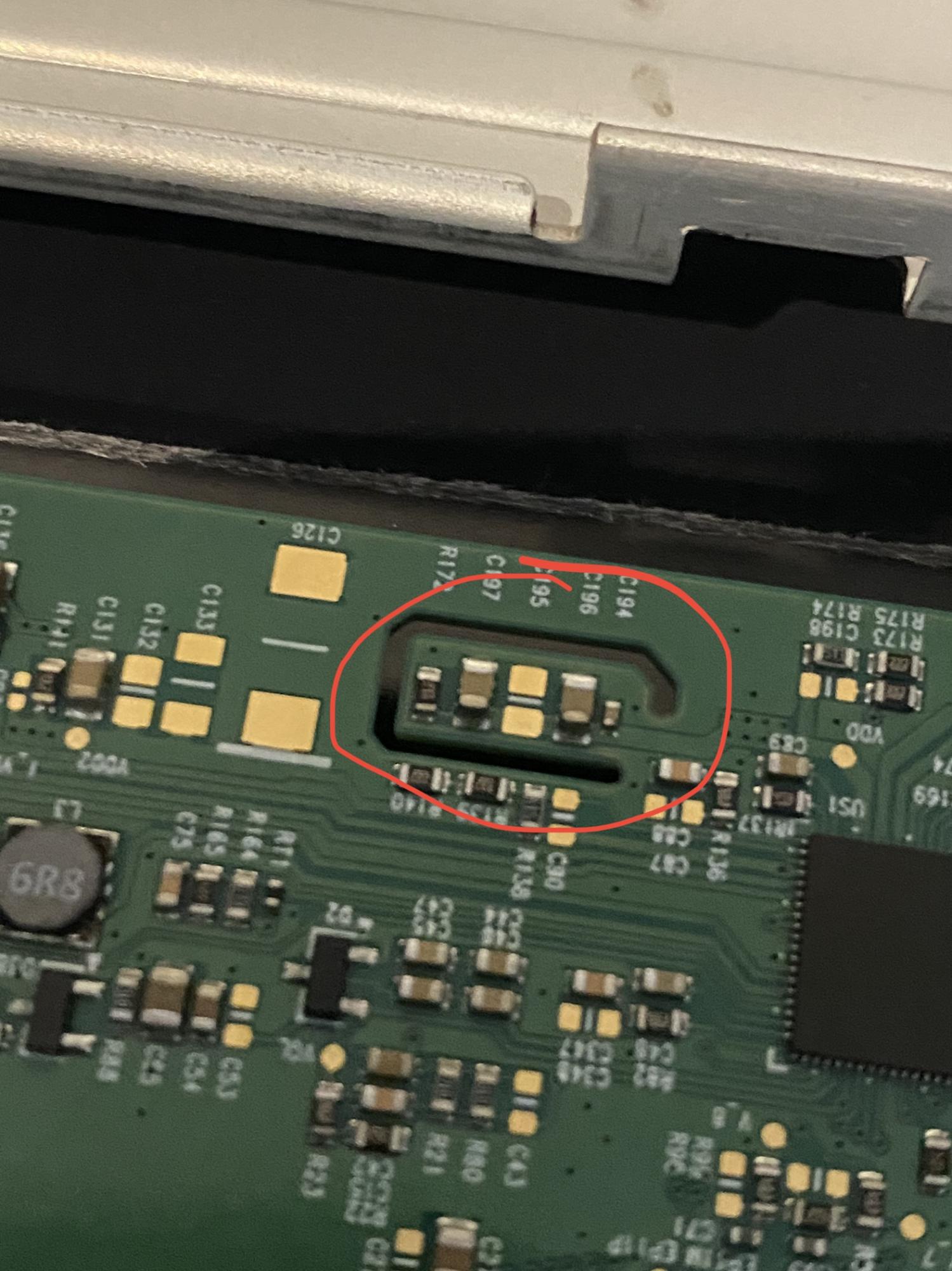

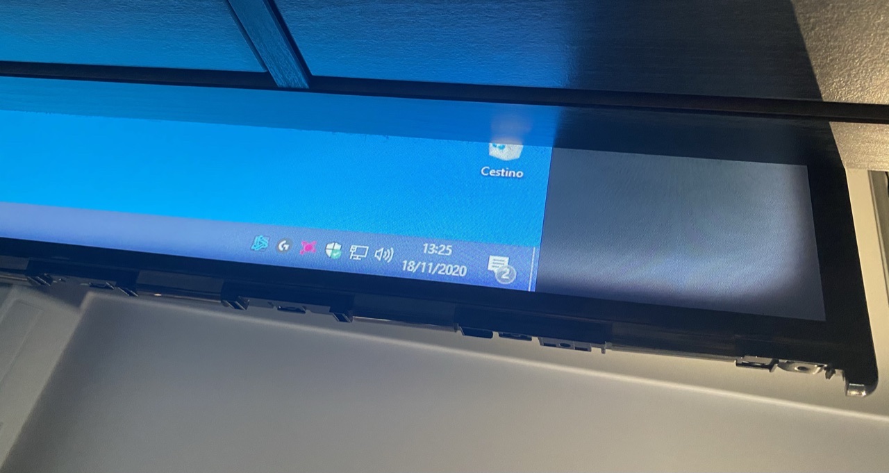

          Then I noticed a thing! That area circled in red is emitting a strange noise like a light whistle.
          When I touch with my finger that noise change tone and the screen shows images better (I mean with less white shadow on it)
          Any suggestions?
          THANKS A LOT!

            Another thing: the more the monitor stays ON, the more the picture becomes better and the shadow become less white ( obviously it stays there...) (see picture attached)

                the spark light you saw on T-CON related on some one disassembly the panel before.. and chassis ( screws ) connection still missing.

                    I attached a photo of the mainboard (which is also the power board I think)
                    Sorry but I didn't understand.. so I have to heat the mainboard or the tcon?
                    And..what do you mean with the last phrase? Thanks a lot

                        Mainboard and powerboard are usually 2 separate boards, can you go ahead and post good straight on pics. of all the boards and one of the whole back as to see how they are all connected?

                          the area you show us at the panel t-con. its High freq discharge circuit, they are not defect ( you can see they make cut at boards to have distance from other parts. noise can be heard at any High freq Circuit. if the panel was taken apart before and not all designed screws in place it will make noise.

                            Attached there is the entire situation photo.
                            I am the only one that has disassembled this monitor, it was pretty perfect and the hooks of the chassis and the screws were all perfect...
                            So I have to test all the capacitors right? Or the resistors? And only in that high freq area?
                            Finally, are you sure that applying a lot of heat on the motherboard doesn't make any more damage?
                            Thank you guys.

                                  I have an update. The monitor is ON from about 1.5h now. And it is seeing quite good. There’s still a little bit of that white shadow and some image ghost from previous pictures on the screen(circled in red).. can this info help us to troubleshoot the problem?

                                        Occhia this is a Monitor so you are in the wrong section. Usually that defect is due to a bad gamma chip, in your case is the leftmost bigger one that probably is also a pmic, since it get better with time so you must try a reflow of it, or a resodering. Is it a job for you? If not an assistance center can help you.
