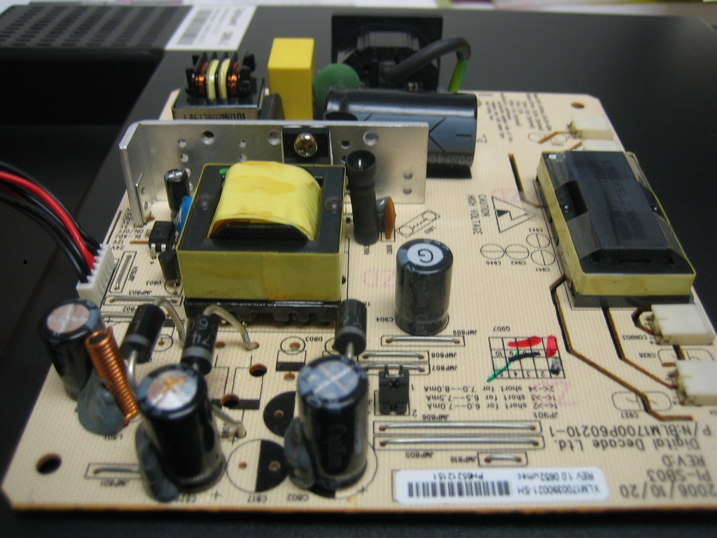

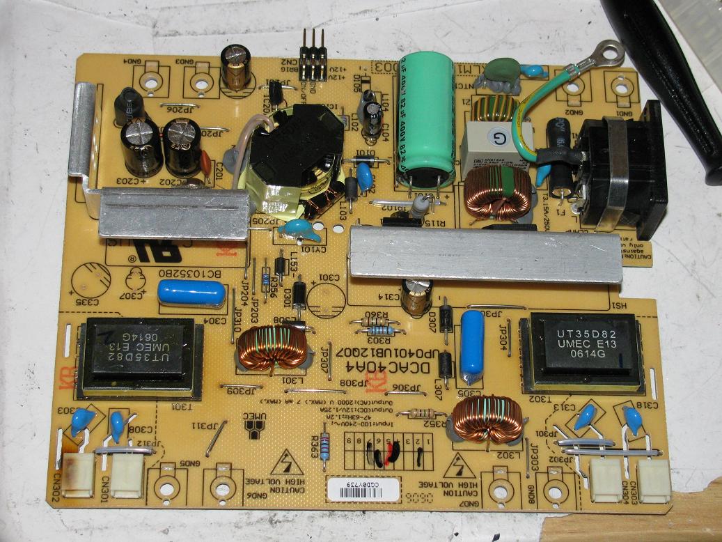

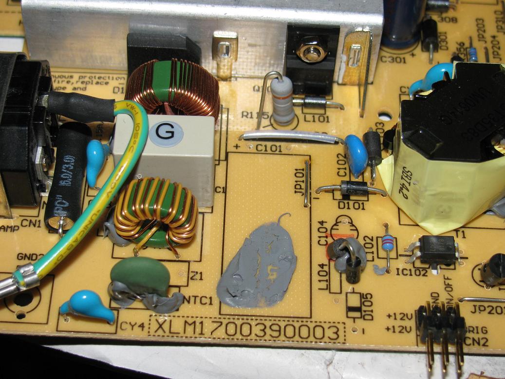

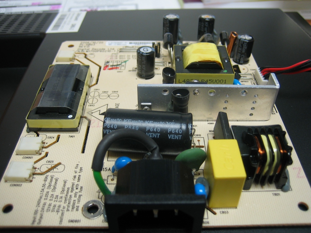

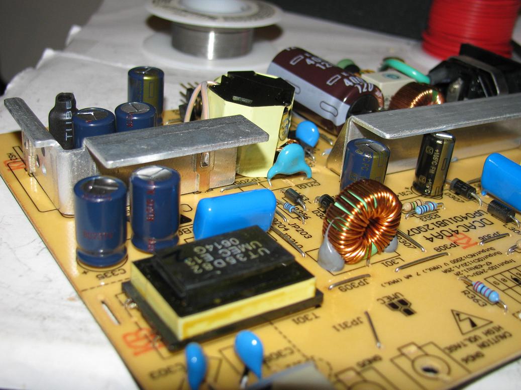

I have a pair of Optiquest Q9 (Actually Q9B-2, I think the B means refurbished). Both purchased in the same time frame (from CDW), both died after 13 to 16 months of very light use.
When I pulled the power (inverter?) board from both of these units, I see the same thing, a single leaky CapXon capacitor. I'm fairly certain the fuse is blown, also. The board is labeled as follows:
2006/10/20
PI-SB03
REV
Digital Decade Ltd.
P/N: BLM1700P60210
Input:
100-240 Vac @ 60 Hz
Output:
24Vdc, 0.05A (optional)
5Vdc, 2.5A
-8Vdc, 0.1A (optional)
Caution: For continous protection against risk of fire replace only with same type and rating fuse.

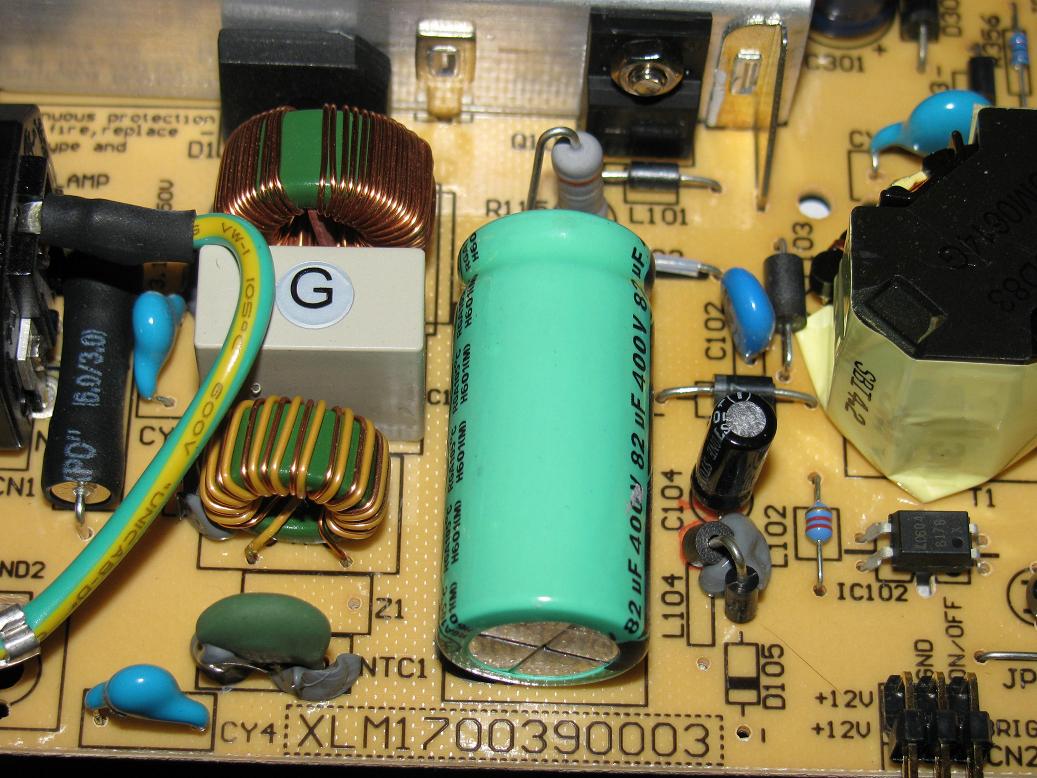

Seems to be a T 3.15A/250V black/radial type fuse with the word bel in the center.

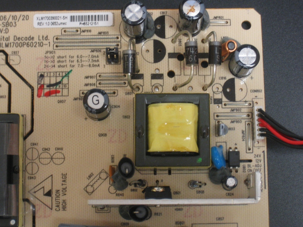

I have a list of all the CapXon capacitors on the board (all are KF 105C date code P640 = 2006, Week 40):
_100uF 400V C809 ~18mm x 35mm (will leave alone)
__10uF _50V C824 _~5mm x 10mm
_220uF _50V C904 ~10mm x 15mm (G sticker on Vent)
_470uF _50V C804 ~10mm x 20mm
1000uF _16V C829 ~10mm x 19mm (leaking goo)
_680uF _16V C819 ~10mm x 15mm
Pics to follow.
