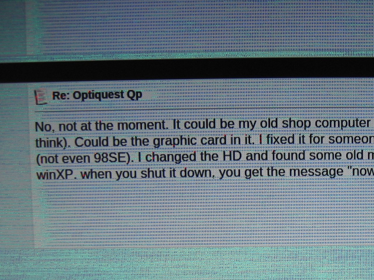

    So it has been a little over 4 years since I did this first capacitor repair.
    It has been working fine until a couple of days ago when I got these lines all across the screen. See picture. (Note to people asking for help, I shot this handheld at 1AM with no sunlight and a 1/15 shutter speed using macro mode, but as you can see, it is clearly in focus and legible.)
    Switching form 60Hz to 75Hz made the problem go away for a day, but then eventually the lines came back at 75Hz.
    I took it apart and was prepared to change out the voltage regulator and/or the Capxon caps on the main board. After some tests, I found voltage regulator to be within specifications and all voltages were steady and stable. While I don't have a scope or ESR meter, I did take some VAC measurements on the main board to see if there as a significant amount, but I didn't see any.
    Rather than recap the entire main board, I decided to reseat all the connectors. Volia, the monitor is working and the lines are gone.
    I decided not to recap the main board due to cost even though I like this monitor. I also decided to leave my original crappy soldering job intact, as-is, to see how long it would last.
    Notes:
    On my power board, it outputs a single 12VDC rail. Since most people leave their monitor plugged into the AC outlet, the 12V is on all the time even if their monitor is turned off. The crappy Capxon capacitors on the 12V rail simply bloat and die after a while. The originals in mine lasted about 4 years or around 35,000 hours. They probably died well before that but since I'm not the original owner, I can't verify when problems starting happening.
    The Rubycon's I used for replacements 4 years ago are still nice and flat and output a solid 12.24V.
    PS. All my computer stuff is connected to a power bar and once I'm done, I turn off the power bar thus removing all standby voltages.
