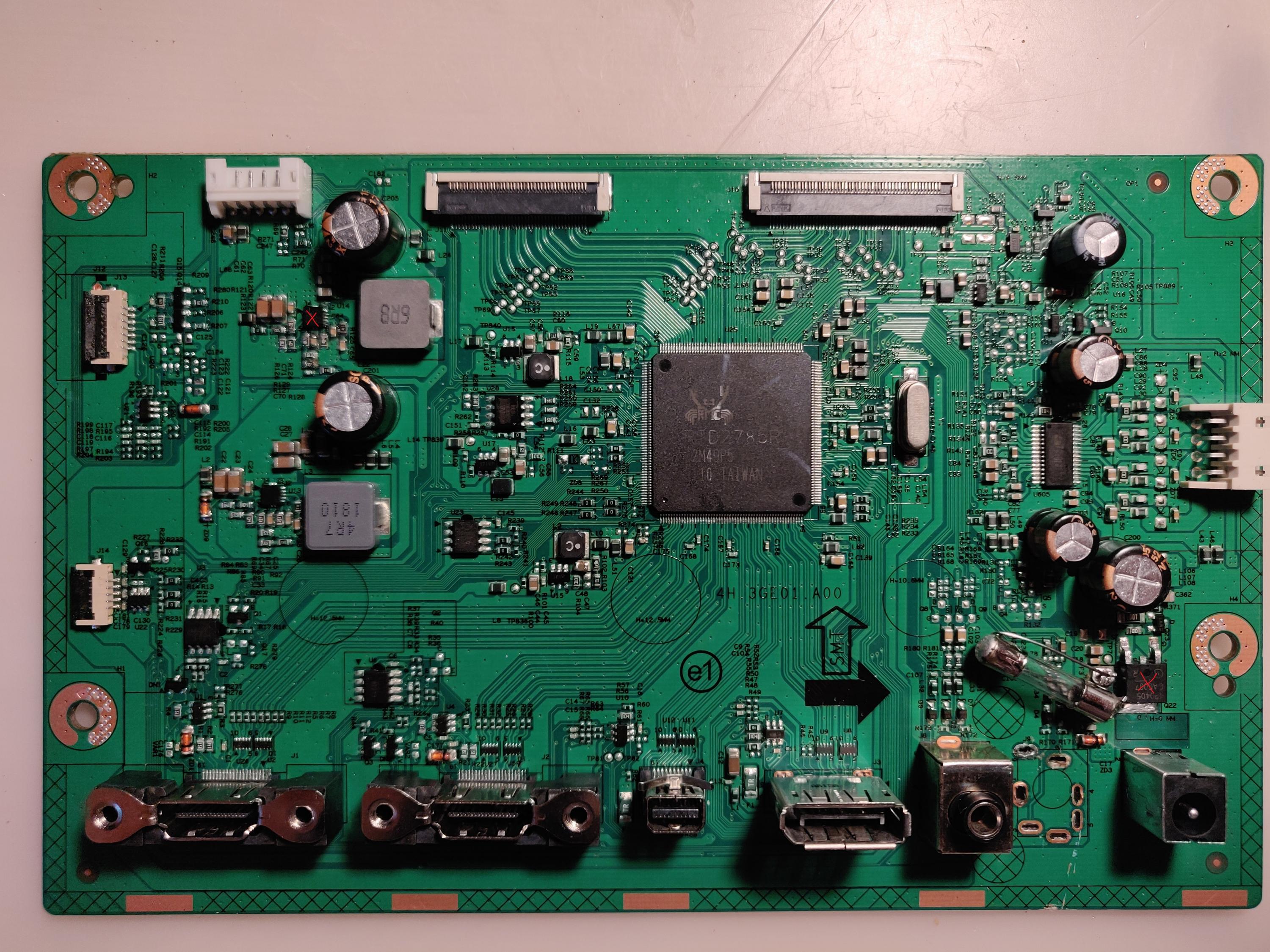

    I've got in my hands a desktop monitor with no power syndrome - BenQ EW3270ZL.
    Quick check-up:
    -Blown 5A fuse (F3), replaced it temporary with standard tube fuse
    -Shorted transistor AP6679GH (Q22), replaced it with IPD90P04P4-05
    -Shorted MP2229 (U12), replaced it with a new one.
    Board gets 19V, but still I can't power it up; aand this big IC "RTD2785R" is getting warm a bit.
    So - is there any rescue possible for this board?
    Thanks!
