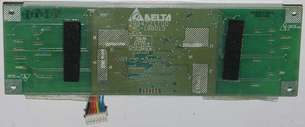

          Attached are the pictures of the board where the fuse failed after a day.
          I will re-solder and replace the fuse.

          • EGuevarae
            • Nov 2008
            • 1336
            Re: VP201b with bad inverter
            Originally posted by discsox
            Thanks for replying.
            If it's a bad driver it might be difficult to pin-point. If you have a replacement board that might be very helpful.
            I will post back as soon as I have some more news.
            Thanks again!!!
            Marcello
            Will look the parts box. I'll let you know if I have a working one that you can use.

                Just wanted to give an update.
                Replacing the original SMD fuses with "resistor type fuses" from digikey.com (FUSE PICO FAST 2A 125V AXIAL ) fixed the monitor for now.
                So I have 3 working monitors again which is great!!!

                    I un-soldered an original SMD fuse from the inverter of the second monitor. It may have been damaged slightly in that process. But this is just a guess.
                    Before I got the Pico Fuses I used regular fast acting fuses in a standard fuse holder for testing. Which works fine for just that purpose because it takes some time to order the Pico Fuses. I was not able to find them locally in any store.
                    What about the caps on the power supplies?
                    I did a visual inspection of the caps and there was no bulging or leaking. Also the output voltage was stable at 17.9V.
                    The monitor is currently not in use but it will be shortly (I had it running for about 24h initially without issues). I'll post back in case I have some issues.
