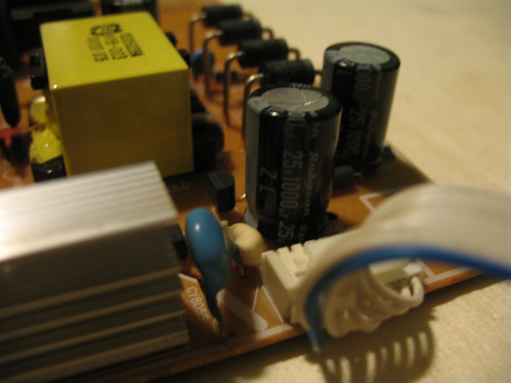

          Today I received the TRAFO so I finished the job, here some pics.
          Following your suggestions I replaced the caps with good Rubycon ZL for 1000uF 25V, Rubycon YXF for a small 47uF 25V. The only one I didn't replace was the input bulk capacitors because I have not such kind of caps but it should be no a problem AFAIK.
          The TRAFO has the marking code in black ink on black tape!!! It was hard to verify it was correct.
          Thanks again to Badcaps and all members, another good and fast job thanks to the infos posted here.
          Gianni
          New TRAFO with Ruby ZL
          Rubycon ZL
          Small Rubycon XYF
          Samsung is working again

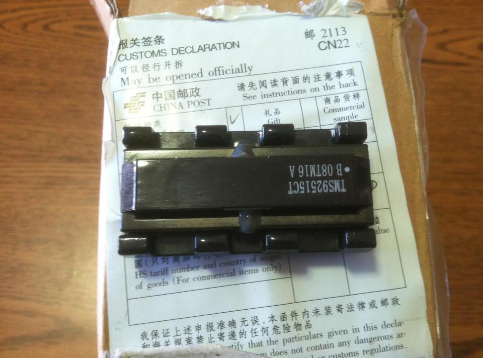

                                I ordered 1 transformer from an Ebay Seller in China...It arrived today, Desoldered the old transformer, put the new one in...WALA..... Monitor working again!
                                Total Cost for part including shipping from China....$5.60
                                Can someone please explain to me how they can ship to me via China Post and US mail for that price?

                                  Good job on the repair.
                                  I suspect the low cost isn't due to low postage prices (although it may be the case), but the cost of the transformer is really low. I recall seeing on a wholesale website that if you buy 100 transformers, they are less than $1 each.
                                  On Chinese websites, such as their equivalent of ebay, I believe the transformers are even cheaper, but since I can't read Mandarin, I can't be 100% sure.
                                  PS. North Amercian sellers charge $19.99 or $24.99 + $6 or $7 for shipping/handling for the same transformer. I suspect they get the parts from the same wholesaler.
