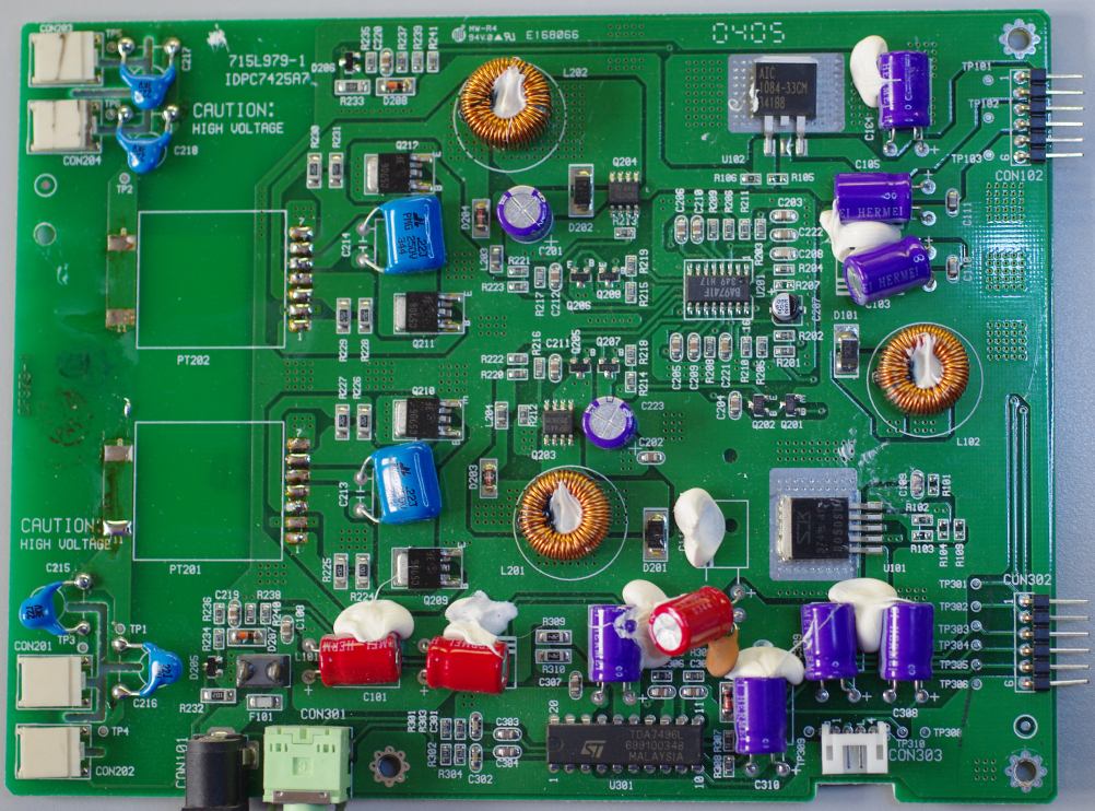

        I've marked up the picture of the bottom. Check the resistance from terminal A to B, C, and D The from C to D. Also, some of those solder joints don't look very good; touch them all up.
        I'd say you either have a bad solder joint, or a bad transformer.

          I pulled the transformer out and got the same readings, open circuit between D&C...

            Yeah, that's indicates an open secondary.

                      Sonofabitch... it's the transformer. This is unexpected. The PSU board is Suntronix model # SIP-U5F(M) FWIW. It's nice of Suntronix to have followed the Fairchild FAN7314 datasheet almost to the letter, even using the same component numbering as the application schematic. The AP4525GEH half-bridge MOSFET is fine, although the PCB is a bit discolored. The DC values of the XFMR are OK, primary zero, secondaries 1.2k. Even so, using 390k/1W resistors as dummy load for the CCFLs and an external 15V PSU the OLP gets triggered. The secondary connected to EY610 (eyelet in the PCB) puts out >1kV of AC voltage, the other one almost nothing. The two windings share the same core, so I was baffled.
                      Removing the transformer and feeding it 50 kHz from a tone generator confirmed the in-circuit findings. Since I'm blessed with a Wayne Kerr LCR meter I hooked it up. The EY610 secondary tests about 0.76 H//120k with a 150k load, the EY609 one 0.71 H//61k. Removing the load gives respectively 0.80 H and an <OVERLOAD> from the LCR tester. I suspect a short circuit in the sec. winding. Will put it in my oven to soften the glue to take the unit apart. OK, it's a completely uneconomical repair, but what the heck. It's a hobby anyway!

                          So I made one of the most geek-esque fixes in my thirty-year career of repairing electronicks. I swapped the offending transformer out with two (!) transformers liberated from a donor board. No idea where that came from, prolly from a monitor with a cracked panel or something:
                          According to the datasheet, the output transformers are symmetrical. The Suntronics board uses one transformer with two secondaries, one of which tested bad. The kludge I made uses transformers with a grounded side:
                          Note that the primaries are in anti-series to make the circuit sort of symmetric. I also had to make sure the secondaries didn't short out anything (the cold end is at the other side):
                          Anyway, the fix was successful on my workbench, but when I mounted it in the monitor it still gave the "two seconds picture" symptom. Hey, in any case it works! But now I have to figure out why it still goes off. I think it's the OTP that still gets triggered.

                                  Nice posts for the 2 second display problem for the Samsung 940BX LCD monitor. I have one that failed exactly as described here. A flashlight confirmed I can see messages from the monitor when the display goes black. Using your posted information helped greatly in my troubleshooting.
                                  After performing a good inspection under lighted magnification and checking some resistor values, I unsoldered, removed the transformer, TMS91429CT (thanks for the schems!!).
                                  The primary measured about .5 ohms with a multimeter. Since the isolated secondaries seemed to mirror the same CCFL bias circuit, I expected identical DC resistance values using my multimeter. One secondary measured 1200 ohms, the other 3200 ohms. The wires for the secondaries are very thin, and likely so if they need to produce 700 Vac (step up transformer). I don't have a commercial ringer to check for shorted turns (the resistance values given kind of point in that direction) in the secondaries. I made up a crude one with a Pulse generator, 220K resistor and an oscilloscope. Essentially I set the Pulse generator to 10ms rep rate 50us width at 8 Vp, terminated with a 50 ohm load resistor. The positive end of the pulse signal went in series into a 220K resistor, the other resistor end went to one of the transformer secondary winding terminals. The remaining transformer secondary terminal went to ground (return to the Pulse generator and Oscilloscope ground). I placed the Oscilloscope across the transformer secondary being energized by the pulse generator and measured waveforms for each secondary tested. The 3200 ohm winding exhibited a nice decay from the sudden pulse rise. The 1200 ohm winding was sharp, narrow and jagged coming away from the pulse rise. I surmised the 1200 ohm winding was shorted.
                                  This was probably over kill for condemning the transformer but I had the equipment available. It also has been 30 years since I performed a ring test on a transformer as described so forgive me if I did something in error.
