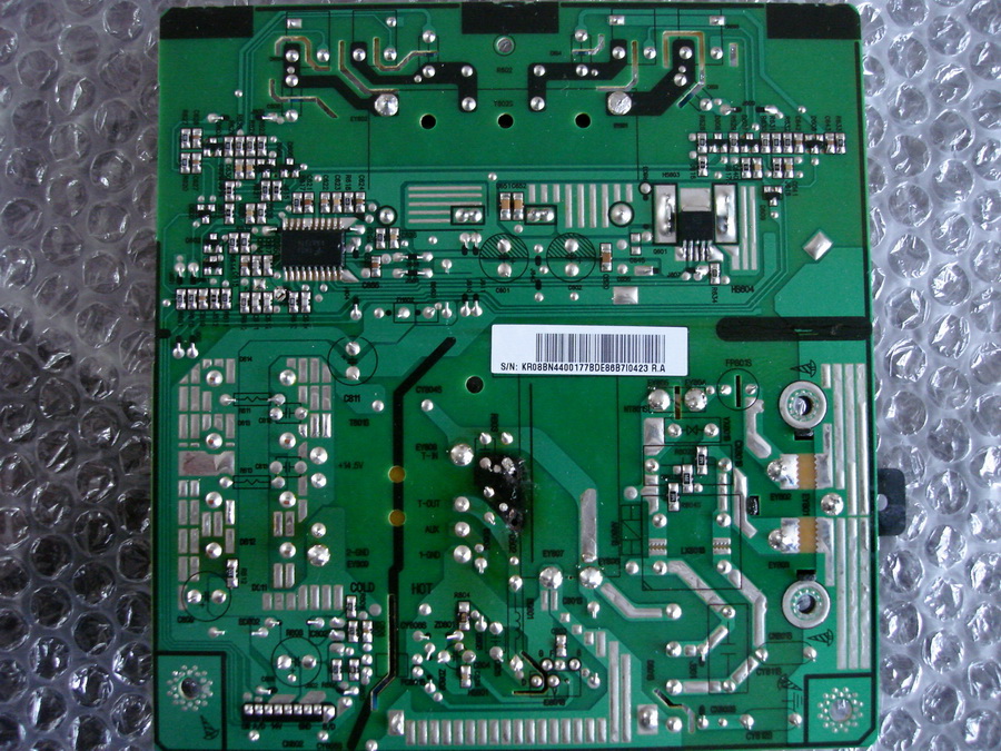

    Pic of the back of inverter board attached.

          Hey all....I isolated part of the problem..see attached pics
          Lamps are good...used substitutes One lamp output is bad..does not light lamp at all

              This is a classic example of the 'two seconds to black' problem. Yes, it takes 18 seconds, it still the same problem. The flashlight test is definitive.
              There are some discrepancies in your description. It appears this uses four CCFLs, ganged up in two connectors. In the picture of the top you seem to be indicating that one set is not working. Is this correct, or is only one CCFL of four not working?
              I've marked up the picture of the bottom. Check the resistance from terminal A to B, C, and D The from C to D. Also, some of those solder joints don't look very good; touch them all up.
              I'd say you either have a bad solder joint, or a bad transformer.

                  That confirms it. There are two independent secondaries A-B and C-D with a 6% difference in resistance. That doesn't sound good. Someone with more experience may chime in on the variation between windings, but to me that sounds like an indication something is wrong. I did a search on the transformer part number - TMS91429CT - there seems to be some indications that that transformer fails, causing this problem. Many of the sites aren't in English. One site is Fixya; someone seems to have them at 5 Euros each.

                                    Take a look at the picture (originally from hotdig) I have labeled. I'm not sure of the actual winding layout, so you will have to make a number of readings with the transformer out of the board. It's a simple progression:
                                    Measure from E to F, E to G, E to H, E to I, E to J
                                    Measure from F to G, F to H, F to I, F to J
                                    Measure from G to H, G to I, G to J
                                    Measure from H to I, H to J
                                    Measure from I to J
                                    Many of these readings may be greater than 1 Megohm - open. Others may be only a few ohms.
                                    A ring test requires either a ring tester, or an oscilloscope. If a sensible pattern appears for the primary windings I would suggest we work on investigating other possible causes.
                                    Whoops!!! I may have gotten ahead of myself. If the transformer is still in the board, don't do the above test yet. Note that I have marked up the picture of the bottom of the board. This is much quicker. Check for resistance from E to E', F-G to F-G', H-I to H-I', and J to J'. If I understand the circuit, all four of those readings will be very low - much less than 1 ohm.

                                      On one of the four boards I have removed, there is visible burning to what I think is either a thermal fuse or diode (?!) These boards are slightly different to the OP's but it is to the right of the large capacitor labelled "4" on the image in post#1. I intend to pull one from another board so I can read off the numbers and get a replacement. Figure the transformer on this one might be good so will try a swap.
                                      I will post pics later and also let you know the results from your advice.
                                      Thanks again!
                                        Re: Samsung Syncmaster 940BX backlight problem - Need help please.
                                        can't seem to edit my last post (time restriction perhaps as per FAQs!?) so here are some pictures of the burnt area of the above mentioned board...
                                        It looks as though the track is completely knackered, so could someone with more experience tell me where I can bridge a new diode* to? Correct section of schematic attached I believe.
                                        * I think it is a diode as opposed to a fuse as I said above, based on the symbol printed on the board, but does anyone know what type? I can't really see any characters on it other than '...M...' from another board and although I found a service manual for the 932MW (part of it attached) it doesn't seem to say which it is. D802 isn't listed in the part list! Am I missing the obvious?
                                        I'm about to take the transformer off the burnt board to stick it on to one of the others, here's hoping!
