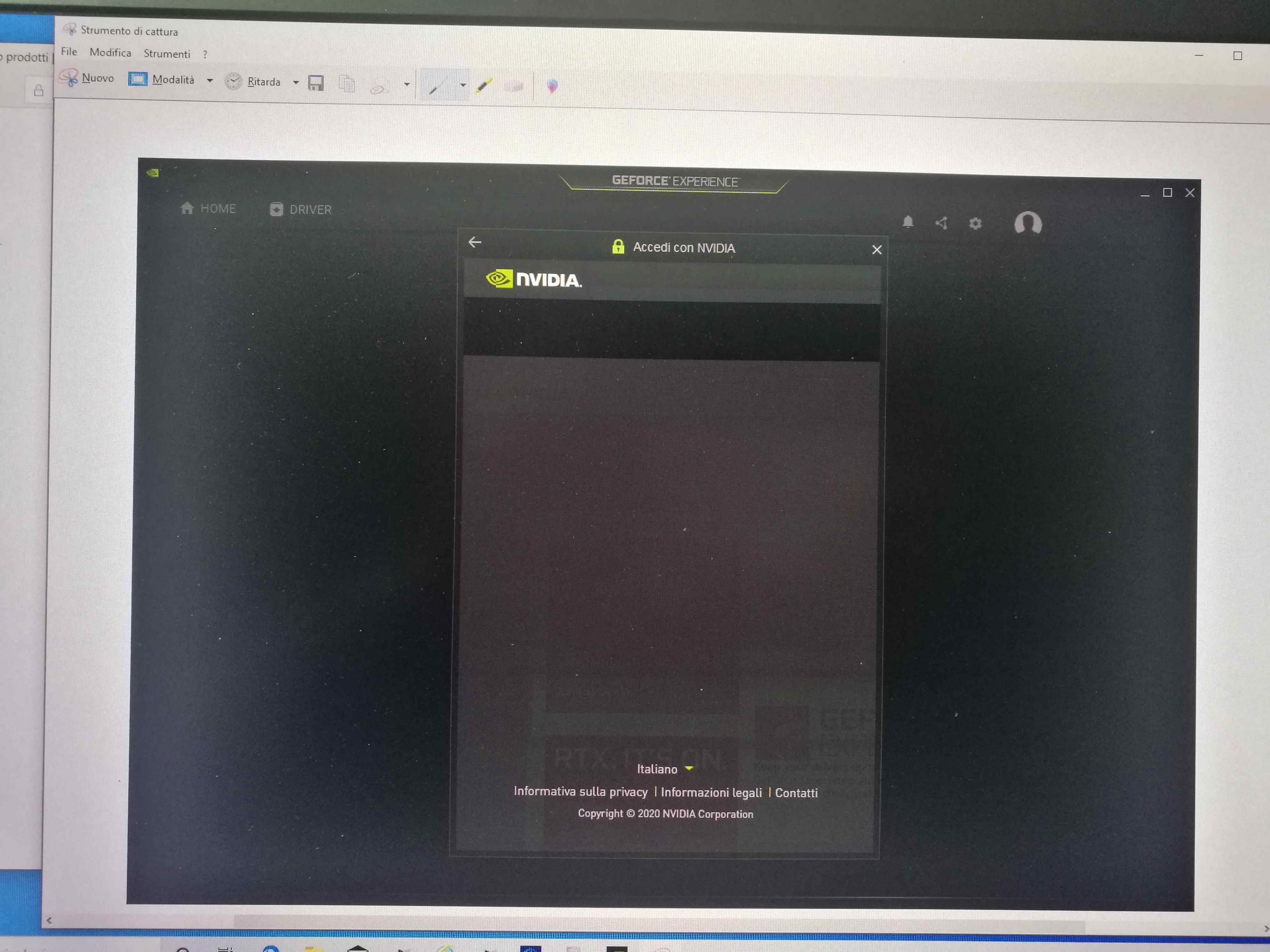

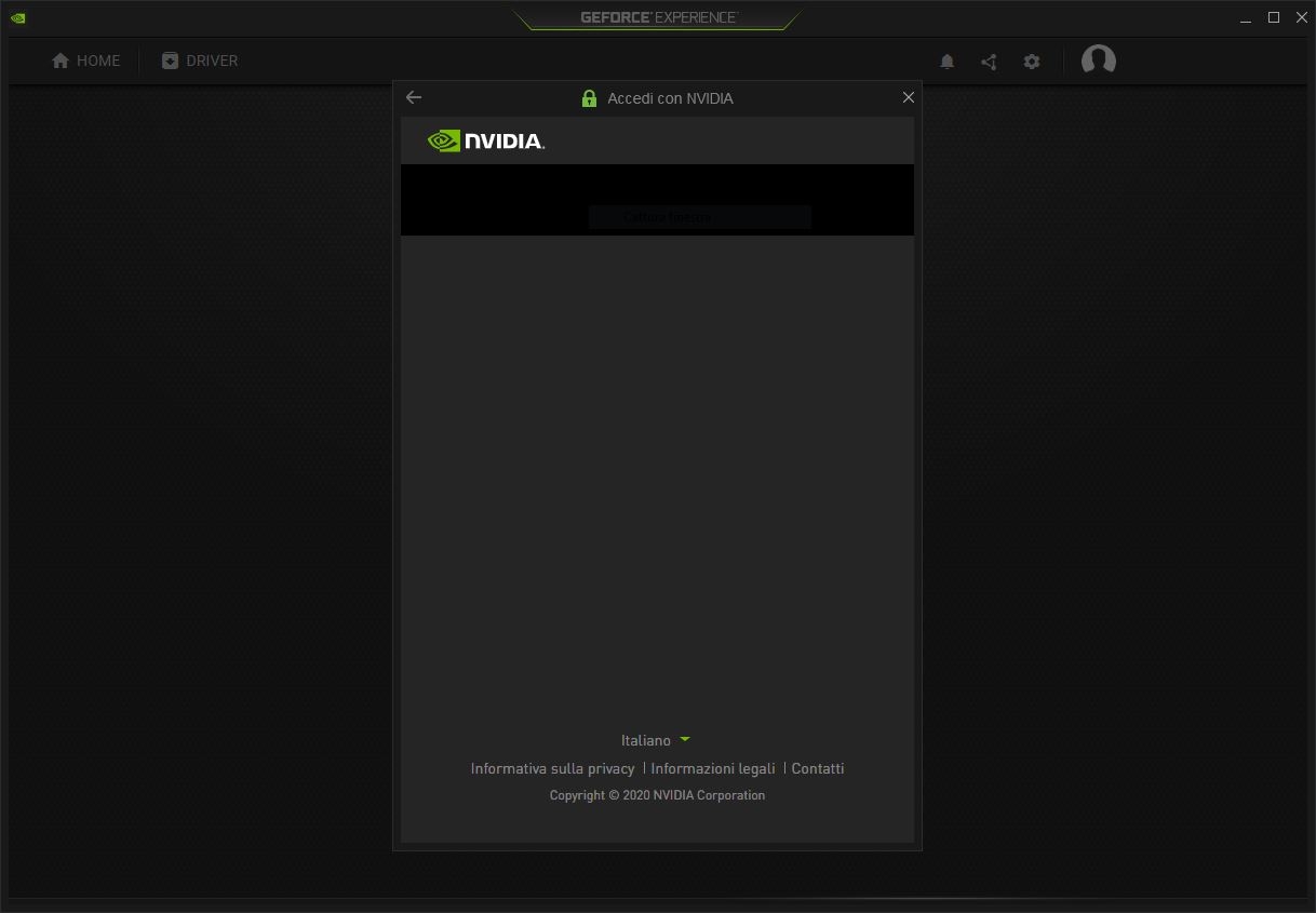

    IPS LCD image persistence
    The images remain in the background, I copied the same area of the screen in two different ways, the first image was created by copying the portion of the screen directly with the windows utility the second image was created with a mobile phone. As you can see, the image created with the windows utility does not show retention when viewed on other devices, this confirms (I think) that the problem concerns the screen and not the memory of the video card.

    Re: IPS LCD image persistence
    I am seeing an action movie with very fast images, and the effect of persistence is disappearing, strange because many sites recommend keeping the monitor spent for at least 12 hours.
      It seems to be normal operation for an ips display, Google "ips lcd image retention"
        I know what means image retention as image persistence as ghost, etc I read a lot of literature about this problem but there are conflicting opinions on whether it is an unsolvable problem that depends on the wear of the pixels or in some cases it could be solved (bas controller , etc)
        Also I see that the pixels are too visible individually and I don't know if this depend from the same cause.
