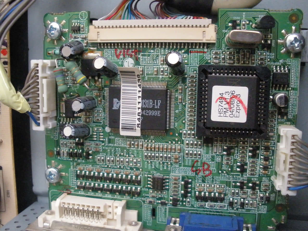

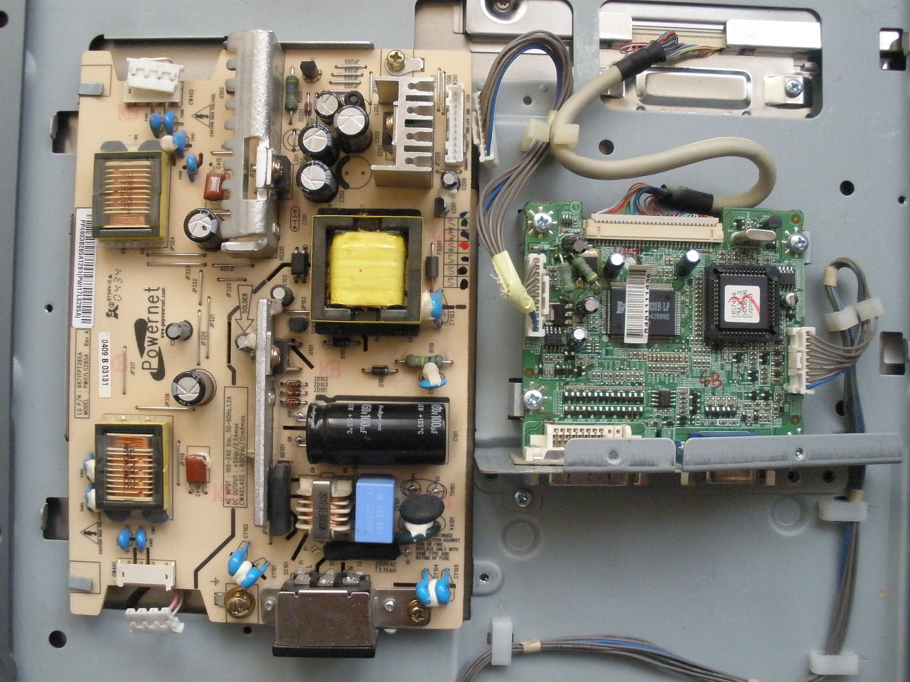

    Anyone have experience or help troubleshooting this 6 years old -Freecycled- 17" Sony SDM-HS74 LCD ?
    At first, when powered on, the symptons were: green power led on, raster with osd but only for 5 sec. or so, then shut off and led turns amber.
    Now, as you can see here, when powered on, this info
    is displayed and the green power led stays on continuous.

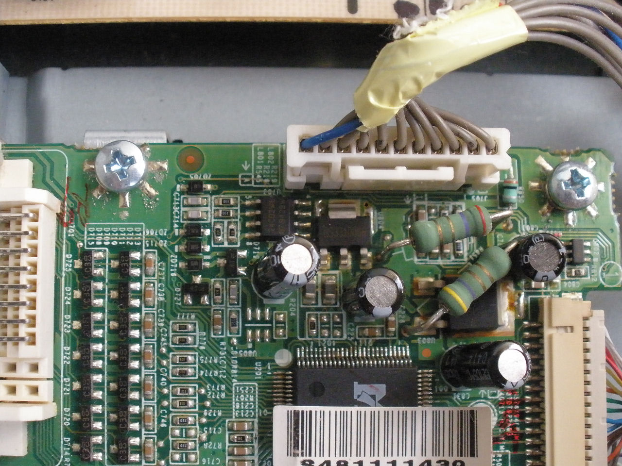

    The board is LG 6871TPT285A model PWI7LS285A rev.A
    The caps are: Rubycon long life high ripple YXG
    c202 470uF 25V
    c203 470uF 25V
    c205 1000uF 16V
    c315 470uF 25V
    c333 470uF 25V
    sorry, don't have a esr meter
    I found this http://sci.tech-archive.net/Archive/.../msg00036.html and I've the service manual.

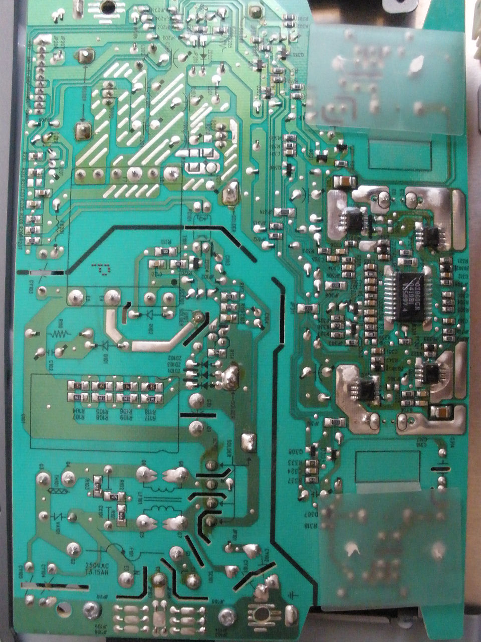

    tested power/inverter board conector pins with a dt9205b multimeter:
    13.78V at +13V
    4.95V at +5V
    could it be the microcontroller board ?

      Re: Sony SDM-HS74
      How did you removed your BACK COVER ASSEMBLY ? (my model is black part: 3809TKL085C)
      I broke, what seems to be, a clip at the top middle of my cover to completely remove it.

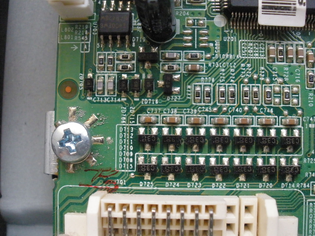

      The MST9131B LCD Controller (U201) POWER PINs
      VDDP(3.3V)and VDDC(2.5V) are all low (1V).
      Noticed small solder balls in the mainboard left side , could also have dry solder joints?!
      The electrolytic caps are: RJ4 ELNA 16V 100UF
