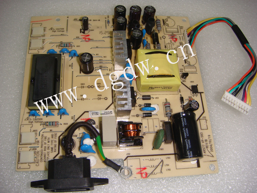

    acer AL1914 TFT (capacitor C0535)

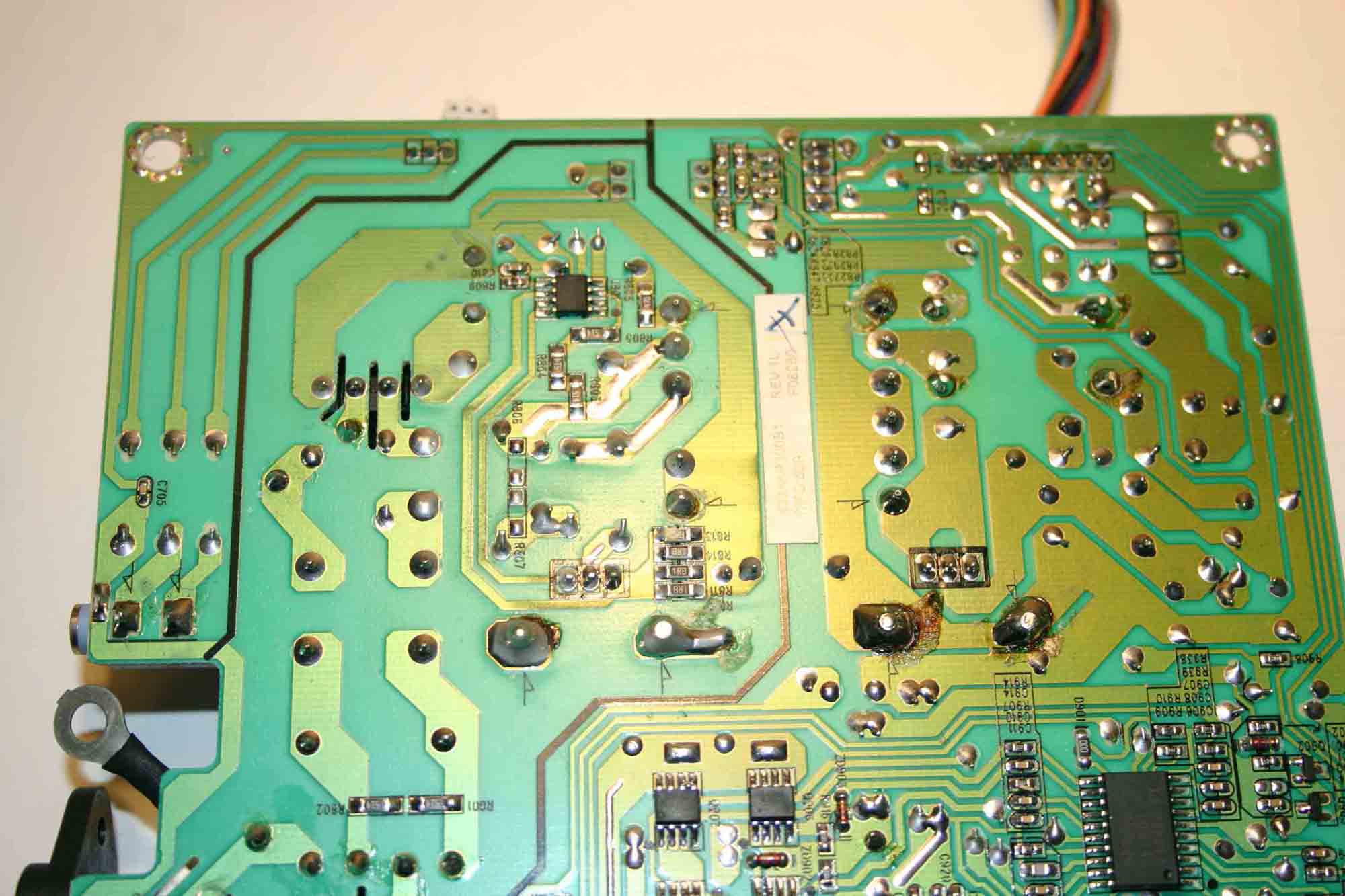

    Can anybody help?
    The capacitor C0535 from my monitor acer al1914 blow up after a powercut in my house.
    I am finding it hard to identifying the expecifications of the capacitor for me to be able to order it, and from where can i buy it.
    Here is a picture of the monitor power supply taken from a chines website.
    The one that blow up its the big black one on the right
    I apreciate the help
    thank you in advance

    Hello Carlos

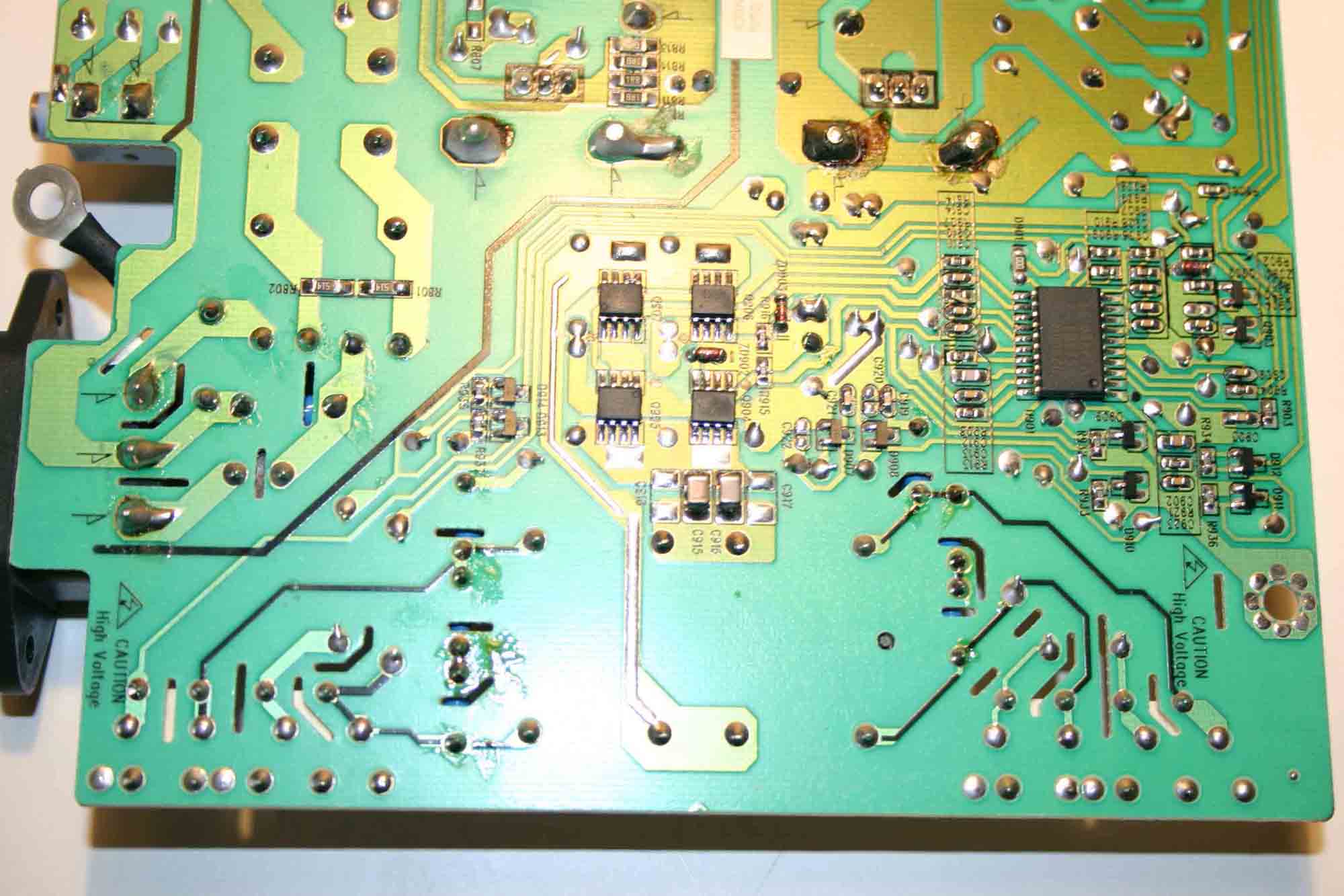

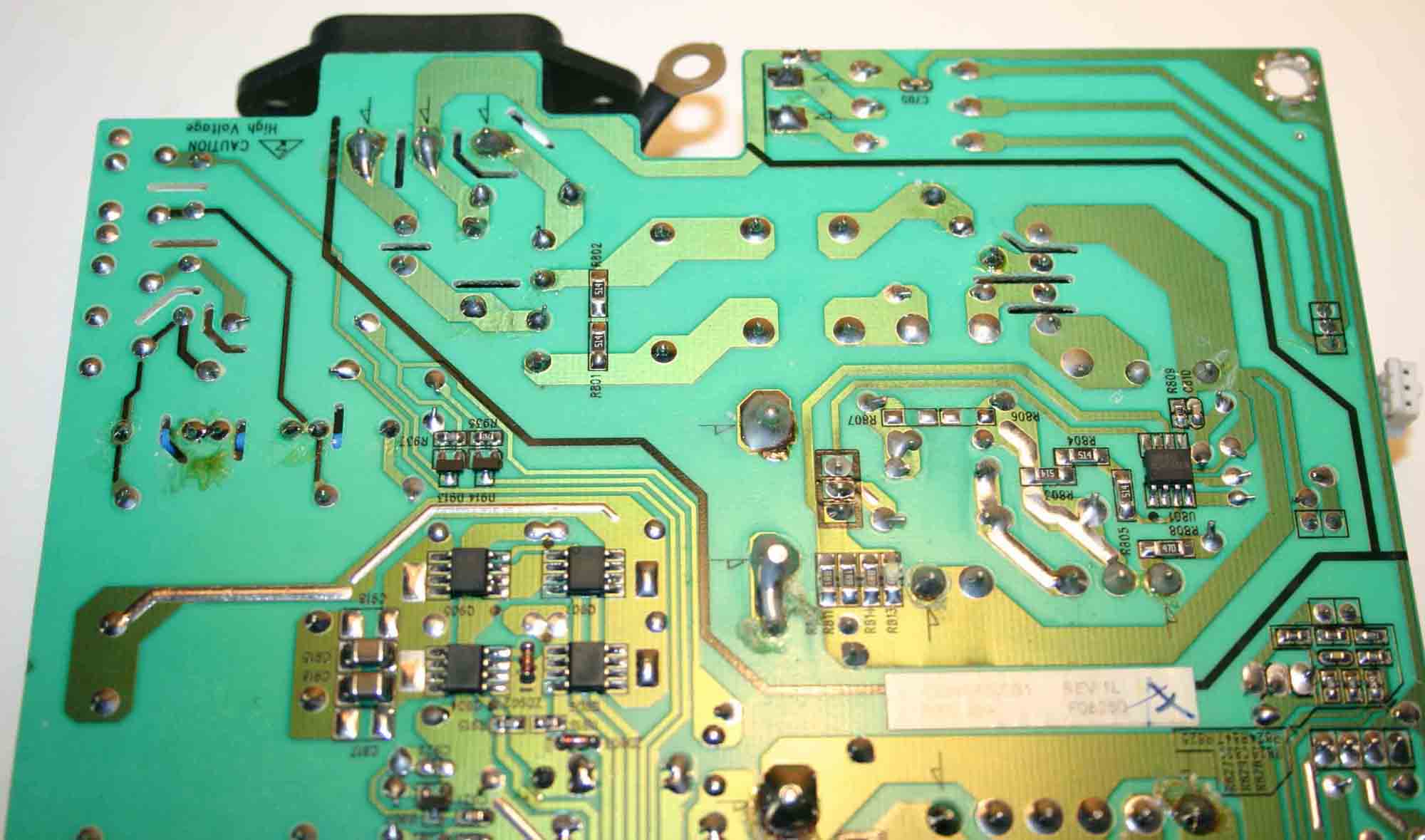

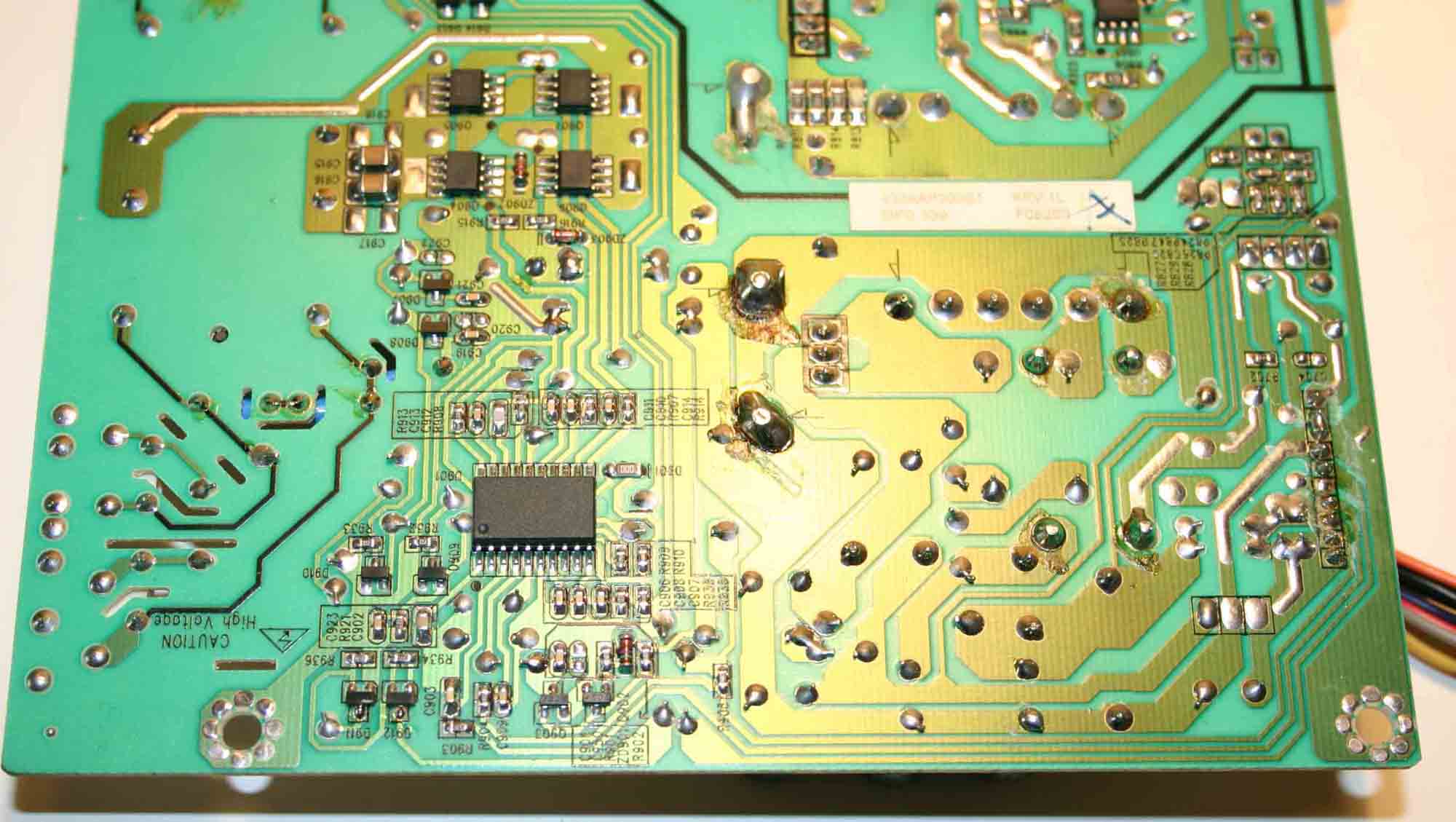

    Dont be to hasty with that capacitor, chances are there are a few more components that may have been taken out, eg mosfet or bridge rectifier and input fuse
    Pictures of top and bottom of your board will be needed to get the best help for you
    Maybe a kind MODERATOR will put this thread in the Monitor Forum where it will get better exposure and more help, please
    bob

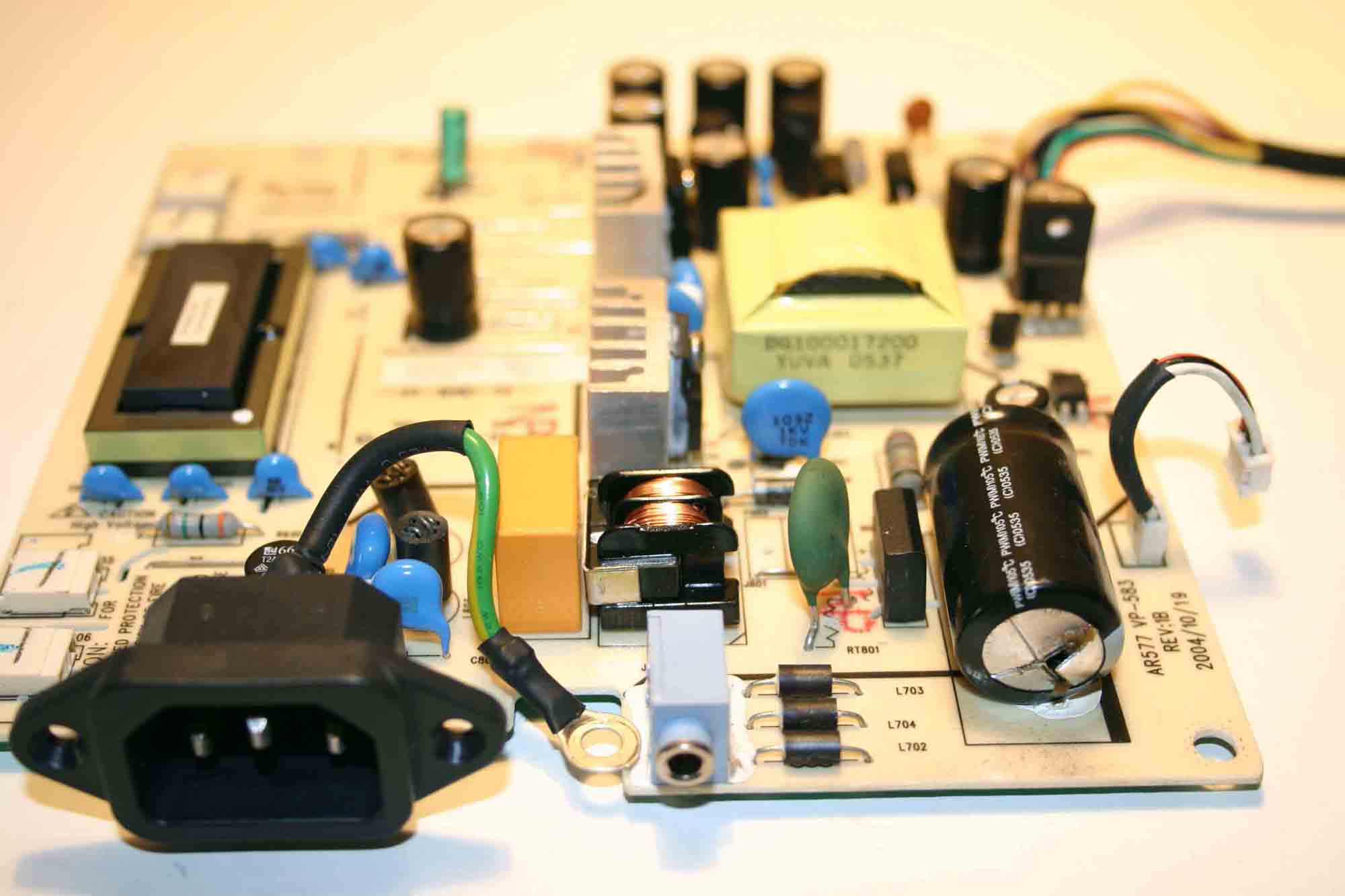

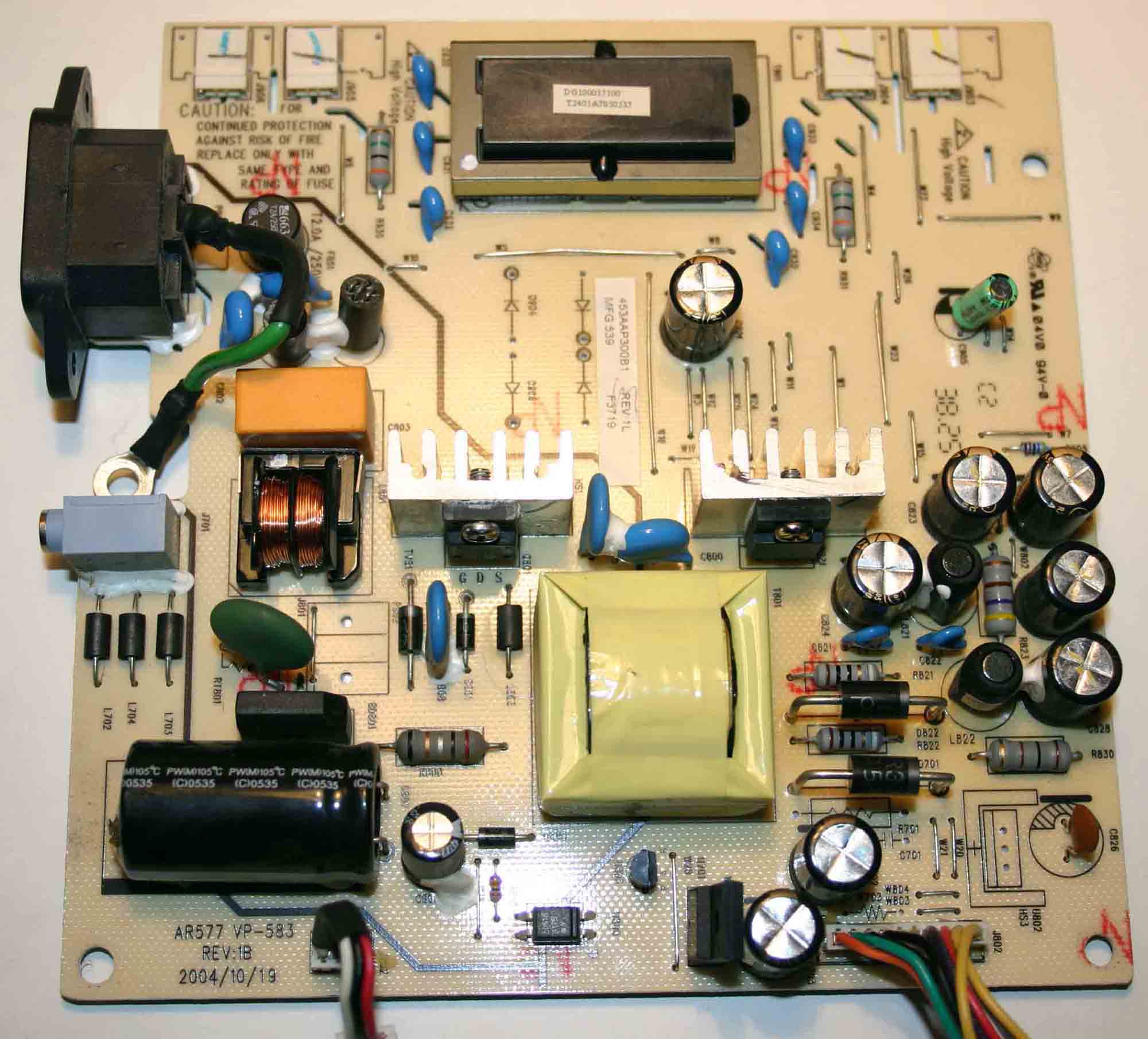

        Re: acer AL1914 TFT (capacitor C0535)

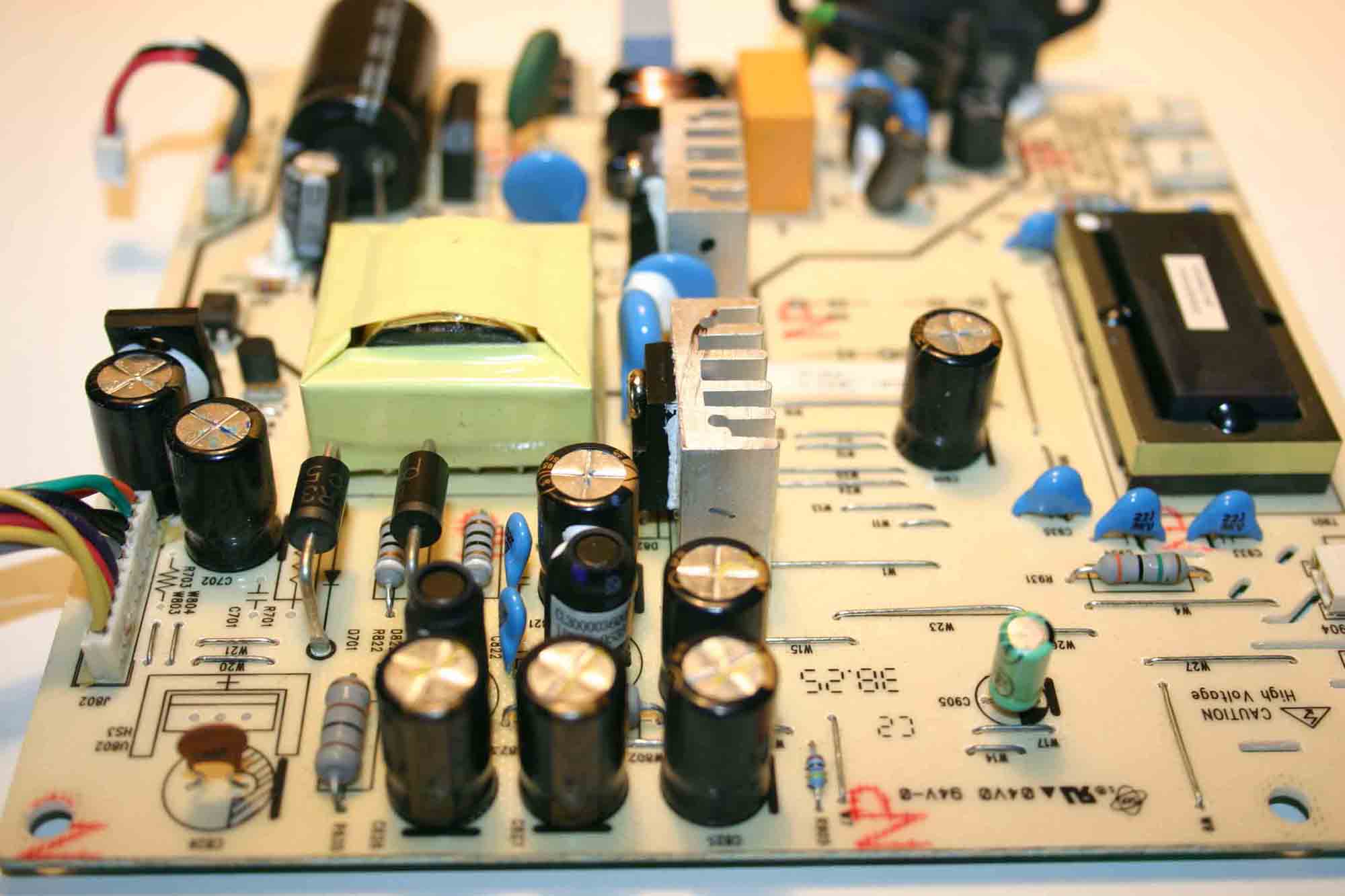

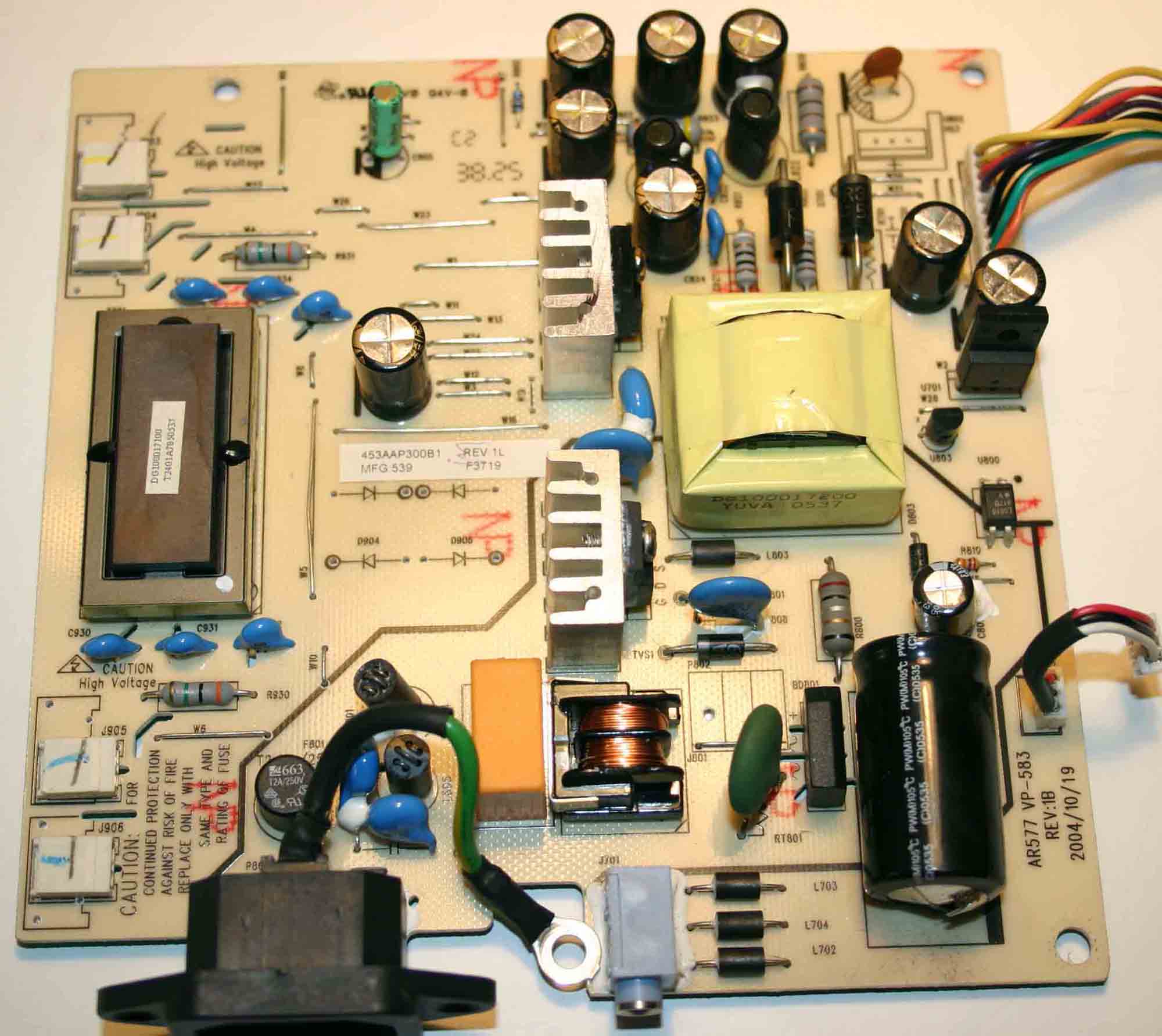

        Can anybody help?
        Here is a picture of the monitor power supply.
        Carlos Gomes

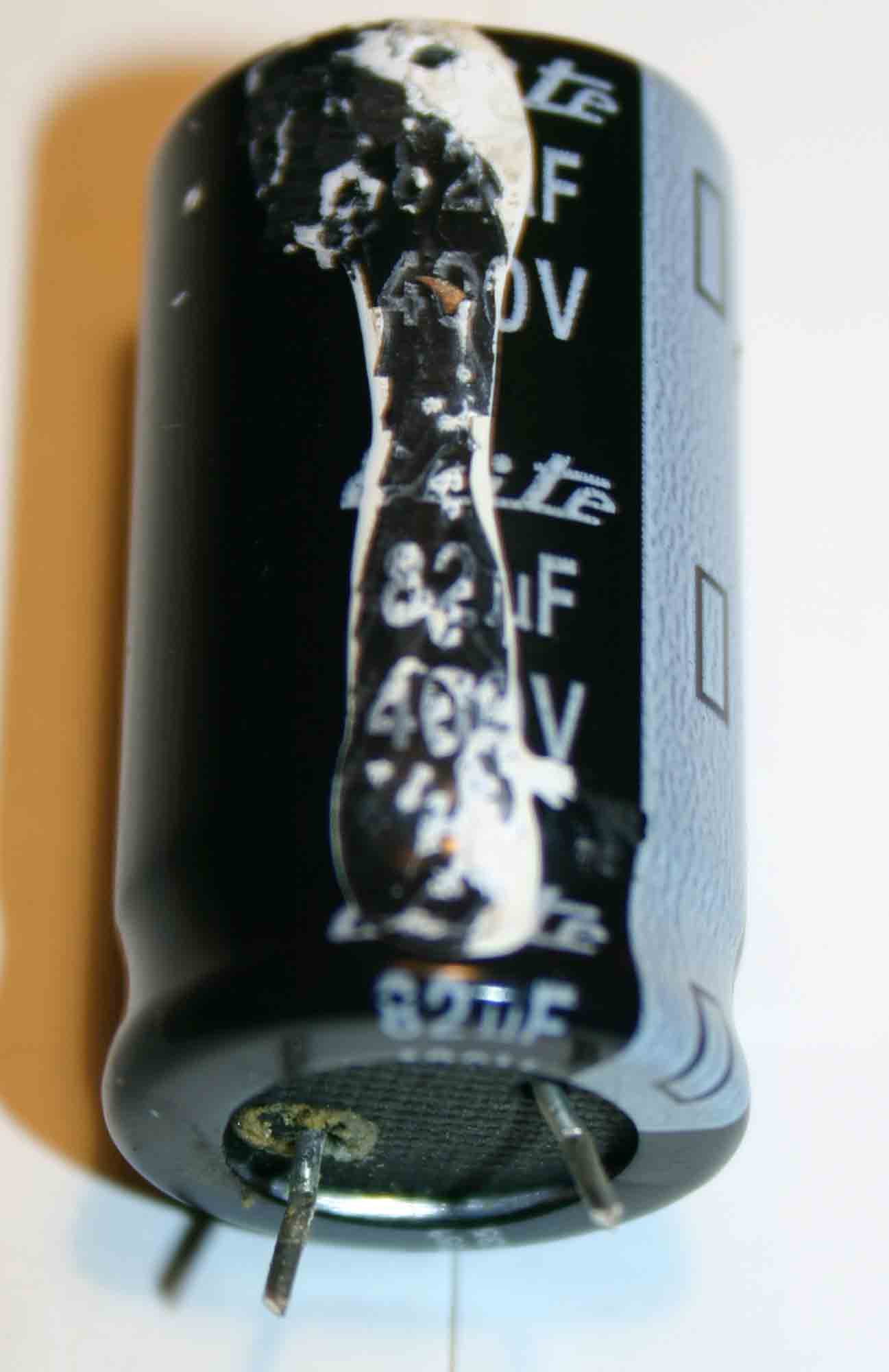

          When you said it blew, I thought you meant in bits and burned that you could not identify
          Just ease glue away from cap and stand it up, you will find the info you need on it, they are normaly a G/Purpose 100uf 400V

              Info on other side of cap is what you need

                I have had good look at pics and I dont see any thing out of the ordinary
                That cap rarely goes under normal circumstances but you may be lucky and find its only the cap thats gone
                Was the fuse gone???
                I suggest you check bridge rectifier and mosfet for shorts

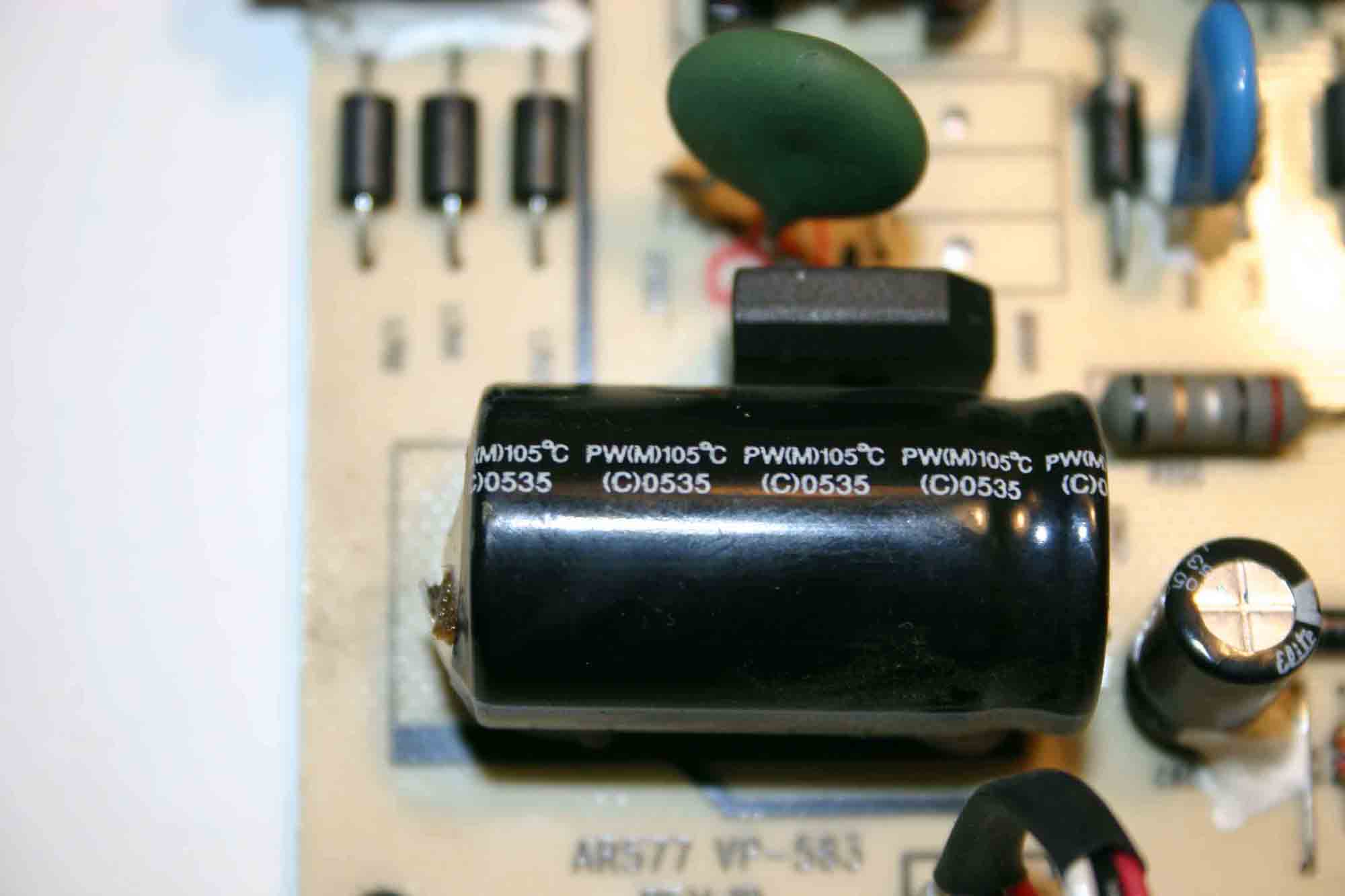

                  Hello Bobdee,
                  Here is a pic of the other side of the capacitor.
                  Thank you for all your help.

                    Im not good on replacment caps others in the forum are
                    Yours is Elite 82uf 400V 105C PW series (probably general purpose)
                    You can put a 100uf 400V 105C G/P in there for replacement you seem to have room
                    Can another member suggest a replacement cap please

                        Go for it. Not a big difference (18uf).

                          Ripple handling should be 500mA or better. Original PW is rated 500 or 520mA depending on diameter of can. 16 or 18 mm.
                          From digikey.com - both of these are 18mm diameter. Measure to be sure you have the clearance for them.
                          UCC KXG - 18 x 25mm, 610mA:
                          http://search.digikey.com/scripts/Dk...me=565-1468-ND
                          or
                          Panasonic EE - 18 x 31.5mm, rating @ 120Hz not given. Following the KXG example though, I would surmise about 650mA:
                          http://search.digikey.com/scripts/Dk...name=P13669-ND

                                From PM - Yes, you can use a 100uF there. Do you already have it? Is that why you continue to mention it?
                                The 2 I gave you above are the correct value and rating for the ripple current, according to the one that was there. If you choose to use a/the 100uF there, then let us know 1st its brand and series so we can verify its fitness for use here.
                                Measure the diameter of the old cap and report.

                                  The diameter of the old cap its 18x31mm

                                    1) Please stop the PM's. It helps everyone here if you post and ask questions here.
                                    2) If the local shop has them then you'll need to get the brand and series of the cap from them and post the information here for someone to review. No sense buying something that won't be correct for your power supply.
                                    3) 18x31mm is fine and either cap I linked will fit. It also means that the PW series was the 520mA ripple variety.
