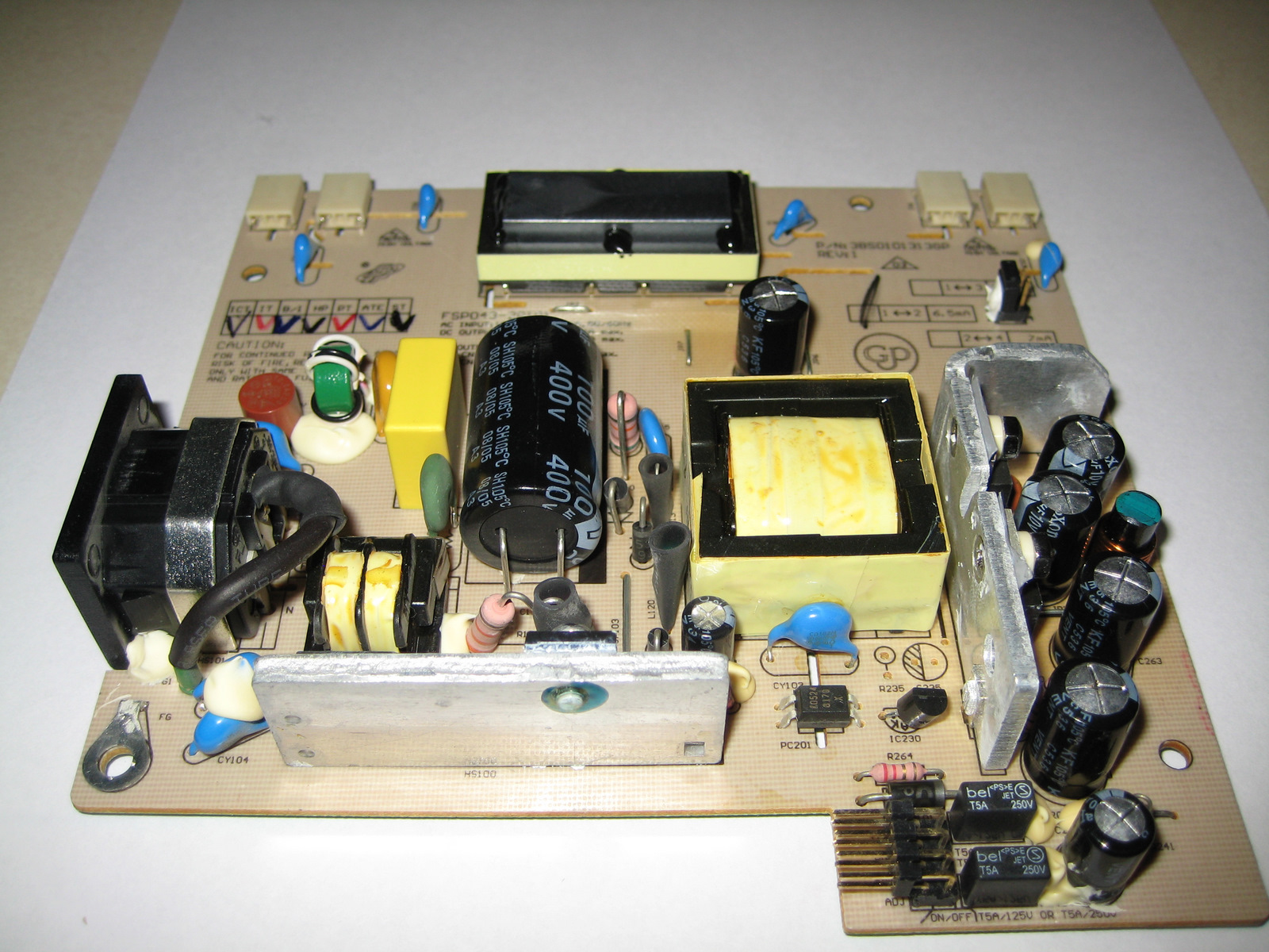

    Hey,
    I found a 'dead' LCD monitor at work that a customer brought in. It has been sitting on the bench for months so I decided to crack it open to see what I could see. When I popped the PSU out, the problem was obvious: 6 swollen CapXon caps.
    There are two on the board that still look fine. One is a 100uF 400V cap and the other is a 22uF 50V cap that is in an awkward spot. I can't tell the brand of either of these two. Should I replace them as well?
    This will be my first attempt at replacing caps, so any help would be appreciated.

    make all the crapxon go away. the only good crapxon is a desoldered one.
    the 22uf one is crucial to the operation of the unit. its probably hosed. replace to be safe. for the 400v one, if its crapxon, nuke it, if not post the brand so we can tell.

      I can't tell what the 400V is, the way it's bent and glued. I'll order one and the 22uF (crapXon I see now) to be safe.
      What is that white glue crap anyway?

          Panasonic FC or FM are considered to be suitable replacements, suggest you check out the 3 fuses on the board before ordering caps as one may have gone down with the caps

            I did find and test the red circular one on the middle left side, not realizing there were two others. I take it they are the two black rectangular ones on the bottom right by the 8-pin connection interface?
            I did a diode check across the red fuse and it was ok. What ohm reading should I see?

              Correct on all three
              Use Multimeter buzzer or lowest Ohms, the buzzer should buzz and lowest Ohms should read 00.0 on all three

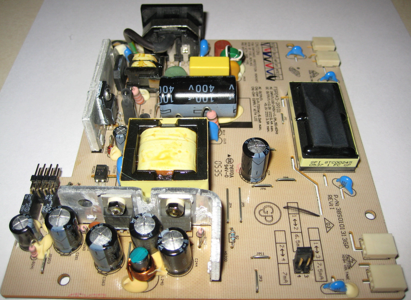

                The Power Board is FSP made ... Can see the transformer part no. SPI.... and PCB no. FSP043-2P101

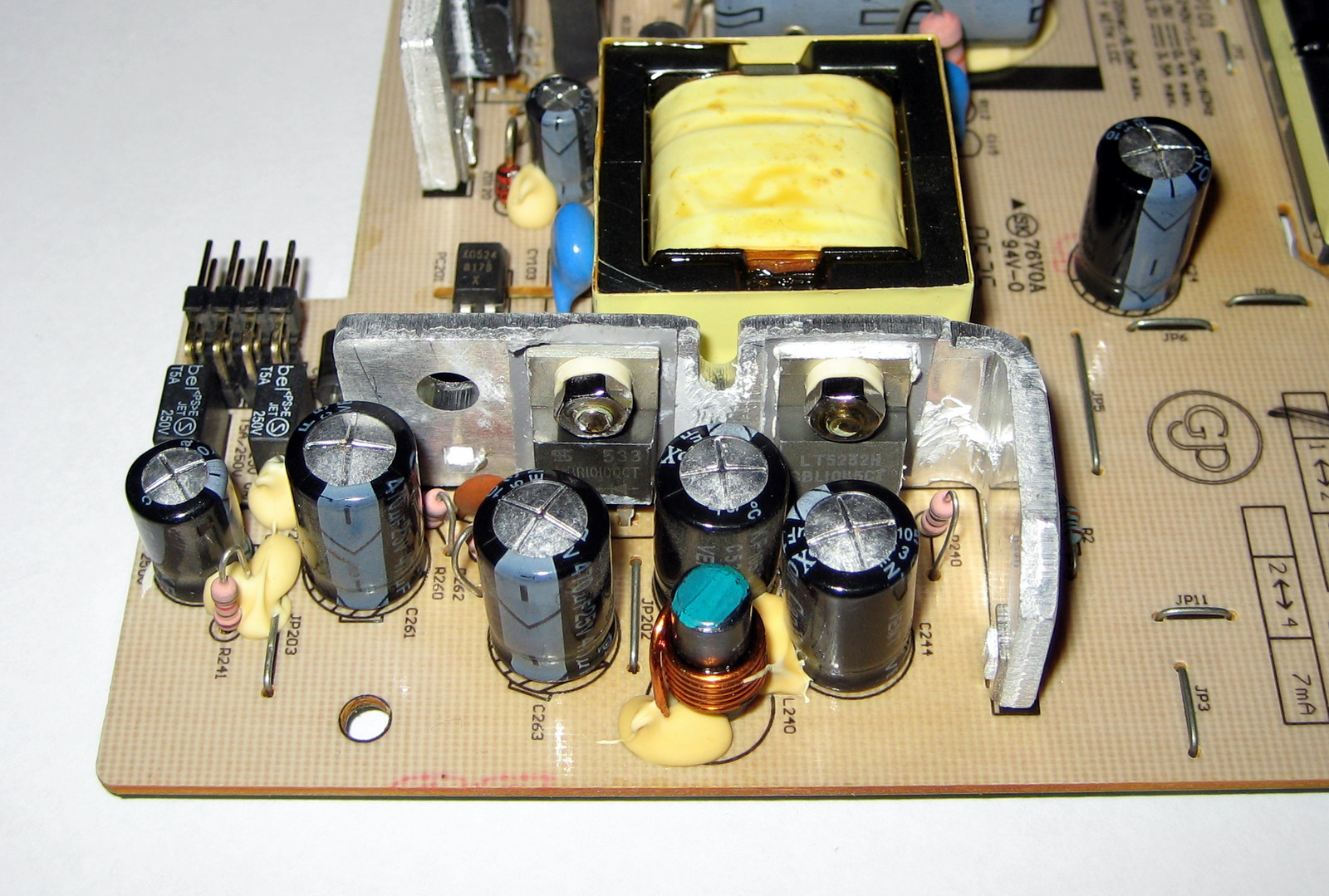

                  Hello Klawsterfobia : I am a new member and have the same board you have off a EN7410 e Envision Monitor , FSP043-2P101 , i replaced all of the capacitors but got carried away and subsituded couple with the wrong Capacitance and Voltage values . I am requesting your help from the pics you took , if you still have the old caps or are able to tell me what are the V's for C244 -C 241 -C263 -C 261- and the one next to F240 , also C24 . thanks for taking time , regards BB333 .

                        C244 = 10v 1000uf
                        C241 = 10v 1000uf
                        C263 = 25v 470uf
                        c261 = 25v 470uf
                        C24 = 25v 470uf

                            Hello Dear Friend; Thanks for a quick reply , the other one that am missing is to the right between the two Black Fuses (F260 & F240 ) If you look on the edge of the board bottom right of the fuse you should see the number F240. I believe is C 242, it was covered with the white glue , so I couldn't make it up. Do you have the schematic for this board FSP043-2P101 - The Monitor am working on is a Envision EN7410 e made in China , you been a great help. Hopefully I can be of some assistance when the time comes , thanks BB333.

                              If its the bottom right-most cap, it's C242 (I had to scrape off some of the glue crap too), which is 10v 470uf.
