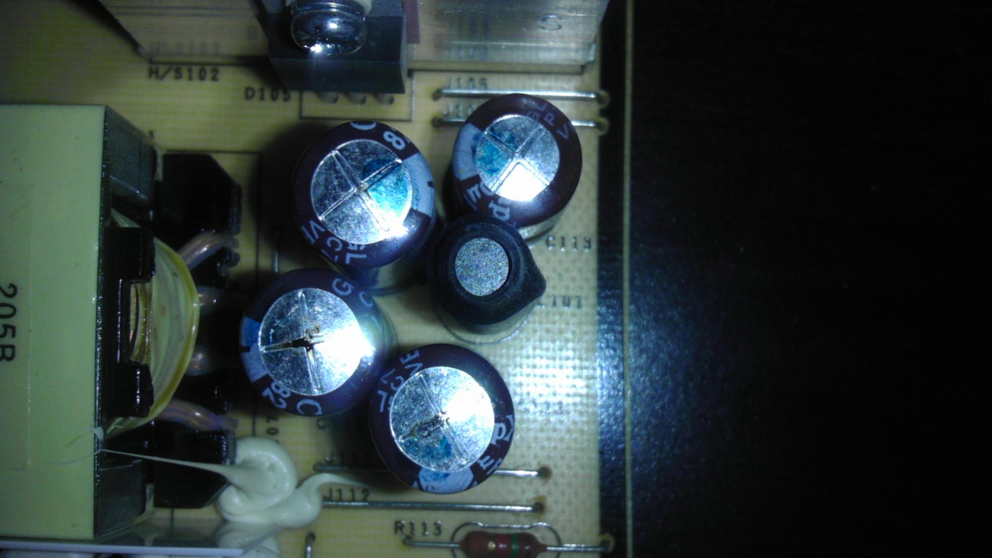

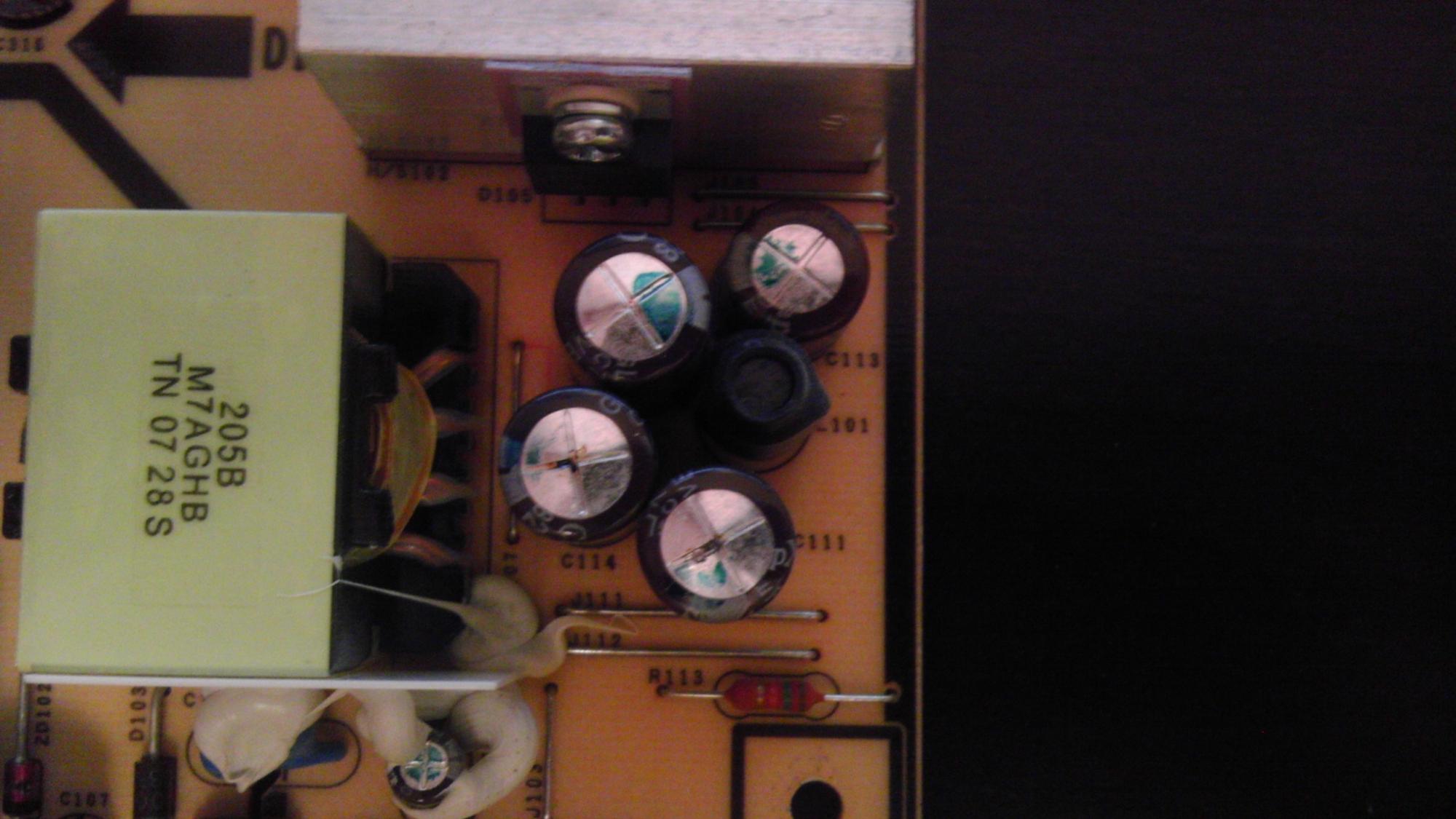

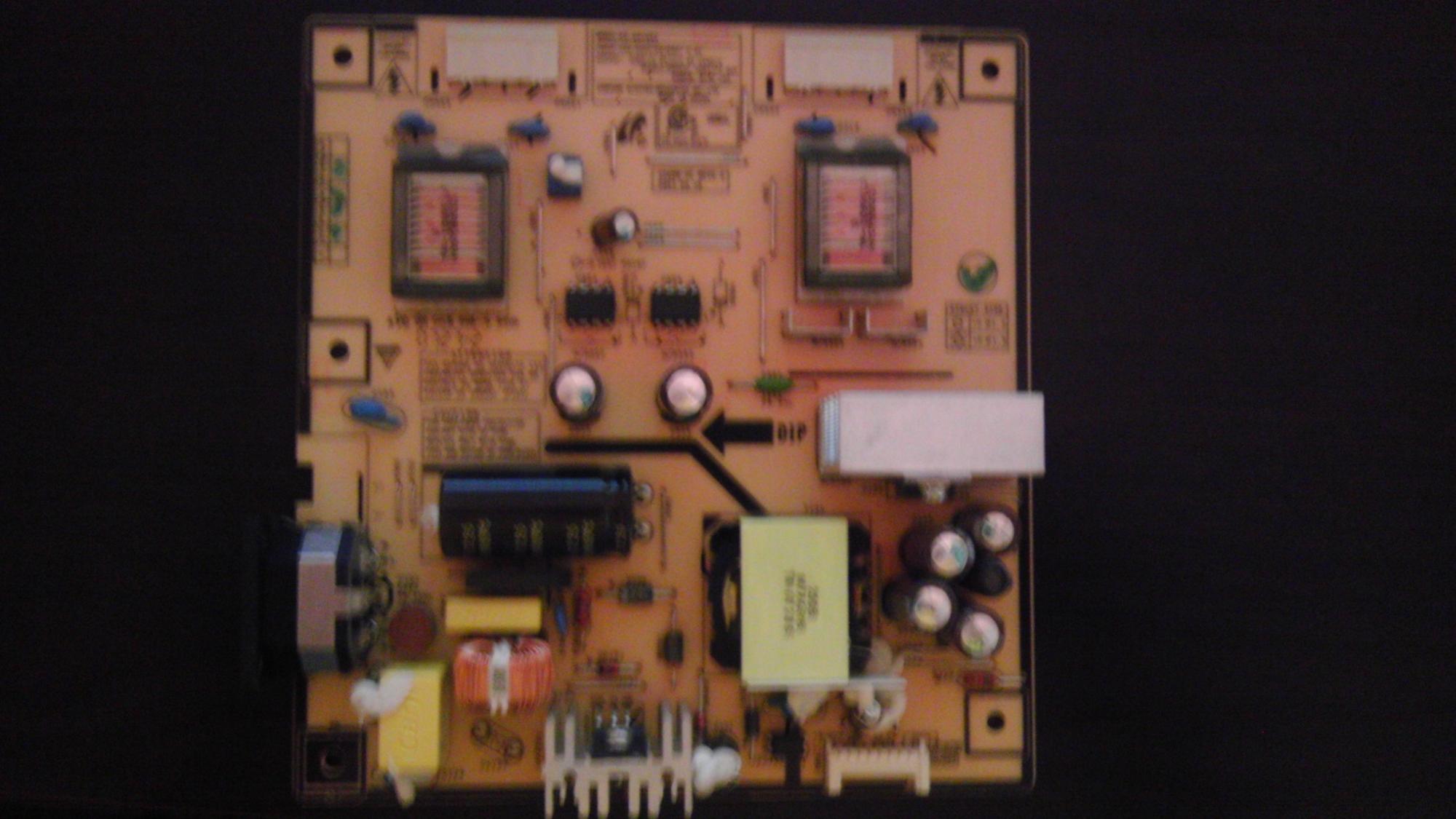

                              Re: Samsung SyncMaster 226BW
                              Hello everyone. I'm new to capacitors and all this fun stuff. I was hoping i could get some help. I need some new capacitors due to some flickering. I have my monitor ripped apart currently. I know someone on this thread named toasty was able to help someone named krickster on page 2 about the same problem with the same capacitors i need. Though his order history from digi key is no longer viewable.
                              The power supply model number is:
                              IP-43130A
                              226BW-VE REV0.0 2007.04.18
                              Monitor type is LTM220MI-L01

                                New capacitors will have the values written on the side of them. If you list them on here then I am sure one of us can point you in the right direction.

                                  #336
                                  Originals are CapXon: 1 - 47/50 KM 6.5 x 10 - n/a / 115mA
                                  1 - 22/50 GL 6.5 x 10 - 1 Ohm / 135mA
                                  1 - 2.2/50 GL 5 x 10 - 2.6 Ohm / 33mA
                                  1 - 330/25 GL 10 x 12.5 - 82mO / 720mA
                                  5 - 820/25 GL 10 x 20 - Size does not exist in current chart - drop down to can size that matches (680uF/25v) - 52mO / 1280mA
                                  ** height to the panel is 25.5mm
                                  I was kind of hoping to just go to radio shack. But anything online will work. Thanks!
                                    Radio Shack will likely NOT have low ESR capacitors which are required in a SMPS power supply. See my standard response at (regulars may skip)
                                    https://www.badcaps.net/forum/showpo...84&postcount=3
                                      Are you going of what you have measured them as or whats written on the side of the caps?
                                      Same comment as above with regards to radio shack. I am sure digikey don't take that long to deliver them out to you and you will save time and money in the long term.

                                        These were the ones that were posted on kricksters post located on page two. I did go to radio shack and yes, they had nothing. I think my answer is actually on page two but It's kind of confusing

                                          Yeah dont just get those ones you need to read the numbers of the sides of your capacitors they will say something like....
                                          1000uf 25v
