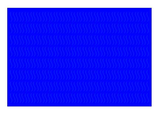

    Hello guys
    Tv picture is in almost perfect condition
    but out of nowhere i noticed a really very faint wavy noise overlay on the screen like the attached graphic picture I attached
    I am sure I never saw this before
    it appear on any video connection, so it has nothing to do with the jacks I believe
    it is almost invisible on whites and blacks
    , it is really faint, the screen has to be static to start noticing it, it also kinda moving from down to up
    what could that be?

        This looks like a bad cap on one of the low voltage supplies, either in the main power supply or the voltages supplied by the flyback.
        C419,C415,C413 or C822 or others
        This is high frequency noise (rilpple) getting into the video signal somwhere, easy to find with a scope.

            I can't see the str causing that type of problem, (or the flyback for that matter) the main power supply runs at a high frequency similar to the horizontal circuit, so if the secondary supplies are not filtered properly that ripple can enter other circuits and when it does it can look like your picture.
            Poor filtering on any of those 78xx or S1117 regulators can also cause this problem. when the regulators are not filtered properly they can oscillate on there own causing this type of interference

                  When I said low voltage supplies I ment the 5 volt or the +/- 14v.

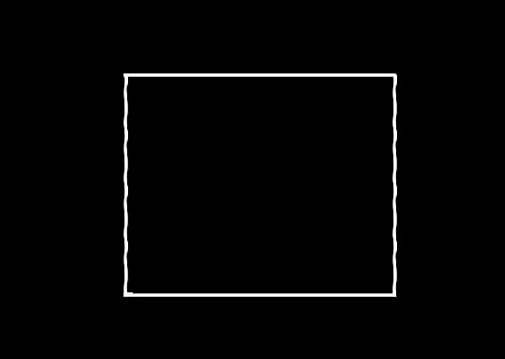

                    what about vertical lines not being straight similar to the attached pic
                    and what to do about it?
                    thanks

                      The sides (vertical) should be straight, The vertical scan is a saw tooth wave and will be linear . something is modulating the vertical scan and causing the bumps you see. Again it could be poor filtering somwhere.

                        yes exactly like u said bumps, it is much less sever than the attached picture, but I want you to get the idea, I think I should replace all caps, I am also sure I was not seeing this defect before
