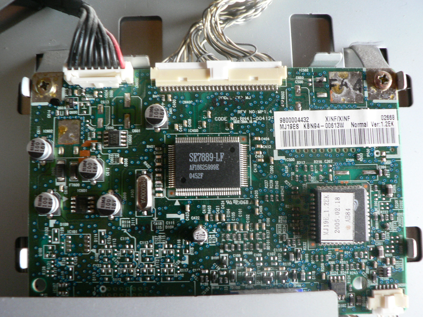

                I'm kinda uncertain about NT68F63L controller. Monitor isn't displaying images but everything else works fine. By pressing menu it says 'Test Good' and when VGA cable is unplugged monitor notices that.
                When i turn on laptop and monitor is plugged, green led light stays on. I think it is some kind sign that monitor is working correctly but for some reason it doesn't display image.
                I didn't find NT68F63L controller from my logic board, might be with different name/code? So, with this info, can you say that my problem is also the dead NT68F63L controller? And only way to fix is by replacing controller with new NT68F63L controller?

                  The NT68F63L is the one with the sticker. The label indicates the firmware revision, which may be specific for the device / panel.
                  The NT68F63L has it`s own EEPROM. You can flash it via COM port.
                  I do not know the cause of your particular problem, but what i do know is that there are a bunch of Syncmasters out there with failing NT68F63L.
                  Usually the obvious symptom is the "out of range" error, but may be there are other symptoms.

                          I managed to replace NT68F63LG to NT68F63L. I realized that it's NT68F63LG and I ordered NT68F63L from eBay (that link which gonzo gave). I do have SyncMaster 913N and you saw the images from the logic board. So is there any differents between NT68F63LG and NT68F63L?
                          I'm asking this because after replacing IC, monitor doesn't work 100%. It does display an image, but its kinda screwed up. Colors aren't right, red is too strong, and it can't be fixed by configuring the color tune from the OSD. There is also gray transparent block on the left side, its about 20-30px wide and height 100%.
                          What could do all this? Wrong IC? Bad soldering? Or something got damaged while replacing IC?

                                I found out that IC NT68F63LG is burnt, Iook like I got to replace this IC. Is it by shorting these 2 terminals by 47 ohm resistor is not good option?

                                  Well IIRC it pulls the 3.3V rail up towards the 5V supply, which "forces" the internal reg. That's not part of what the processor was designed for. When I first read of that scheme I shuddered. It *may* work some_time for some_people, but I wouldn't recommend it.
                                  When it gets to the point of needing to replace a fried processor, I'd be putting that monitor into the parts heap.

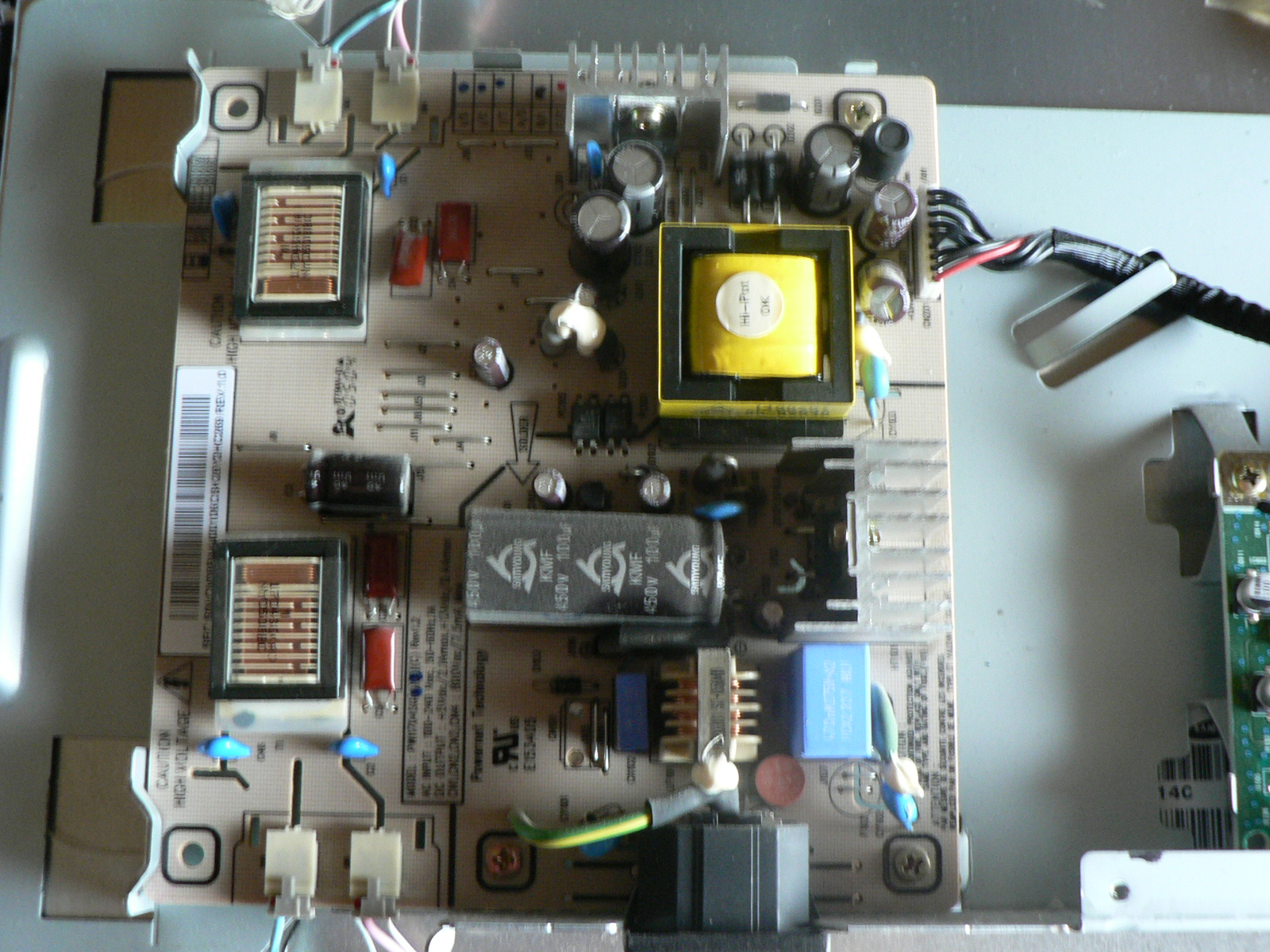

                                    But to be sure i made pics of the circuit board and the logic,videoboard:

                                      I have the 913n as well that has problems with the power supply board, Ive removed it and all the cap look OK and are not swollen, problem is the TOP246YN (Integrated Off-line Switcher) has exploded.
                                      I replaced it with a new one but that done the same, anyone whats next to test on the board

                                          Sorry, here is a pic of the board, the TOP246YN is the top one in the pic bolted to the heatsink
