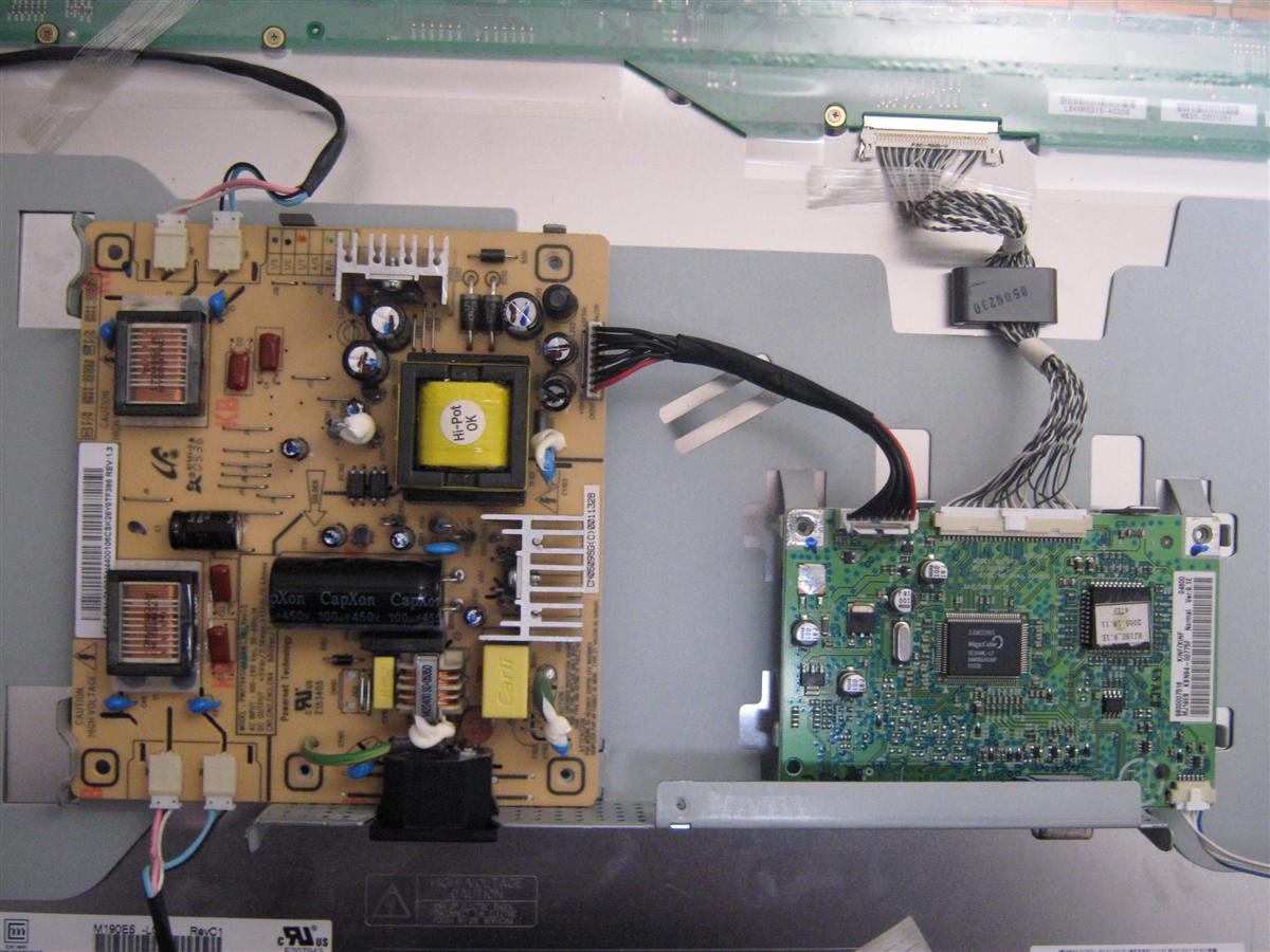

                        Here is a photo of the back of the board. The dark stuff surrounding the solder points is rosin flux from my desoldering braid. I didn't clean it from around the contacts, but I did clean it from the contacts using a q-tip before soldering the new caps into the board.

                          OK, that appears to be a different layout. I can't even see the drivers for the inverter transformers!!
                          I would like pictures of both top and bottom of the board. And from more directly overhead, if you could.
                          I see what might be a picofuse just to the right of the ugly green blob. Check that.

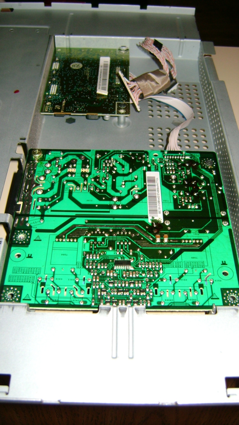

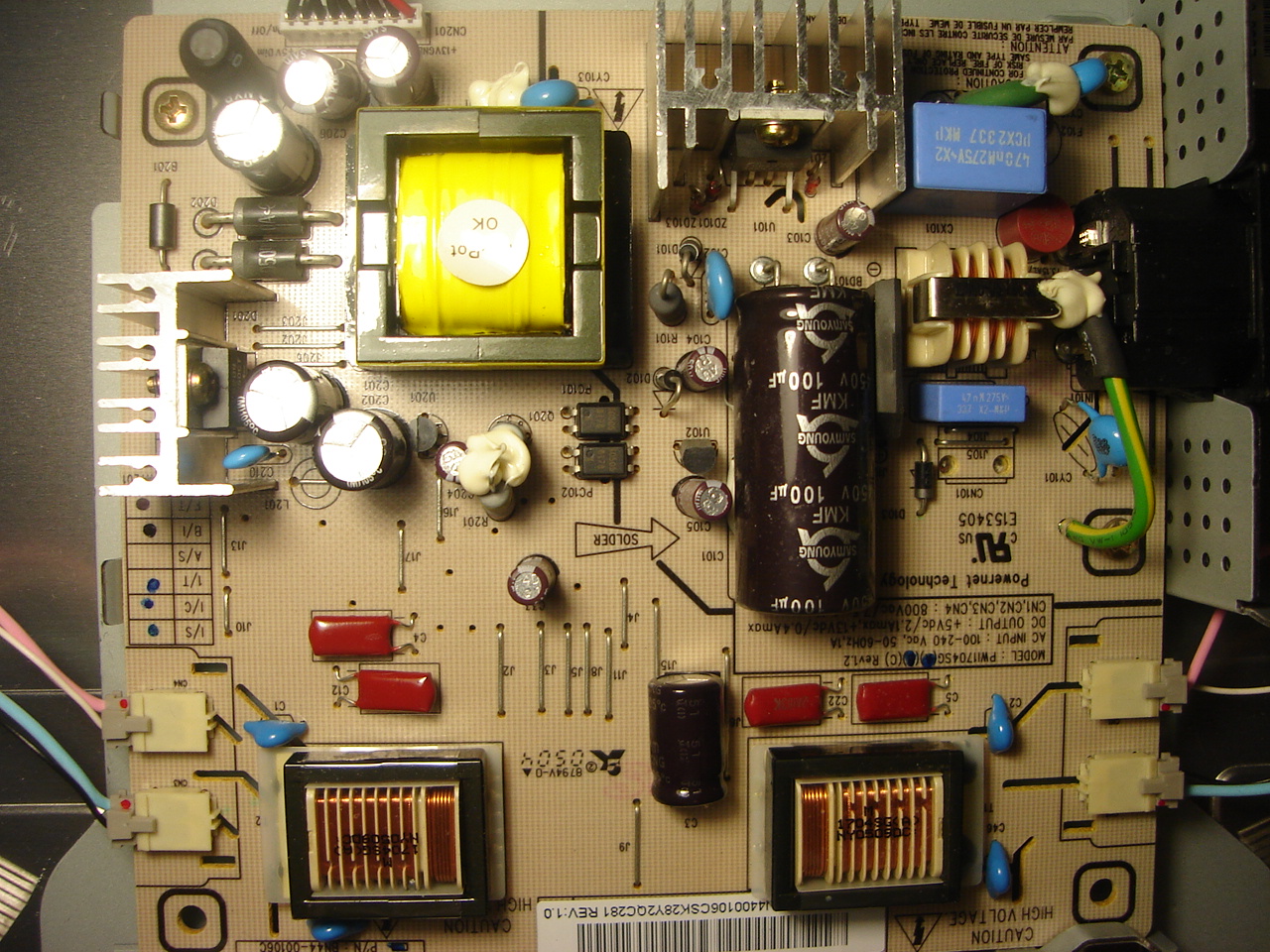

                                    1.- What did you use as replacements. Flashing green may indicate a PSU problem.
                                    2.- Post good size/quality pictures of both PSU/INV and Video/Signal boards

                                      How do I post the pic. I got the pics but when trying to insert the image I only have a big one (last image) displayed on the screen not all three.

                                          Capacitor replace with matching volt, capacitance, temperature electrolytic typeof different brand. Polarity also checked.
                                          Pics attached.
                                          Flashing light only happen when video signal cable is plug (one cable cause it but another cable don't, even when one end is disconnected from PC) as described.
                                          Pic attached.
