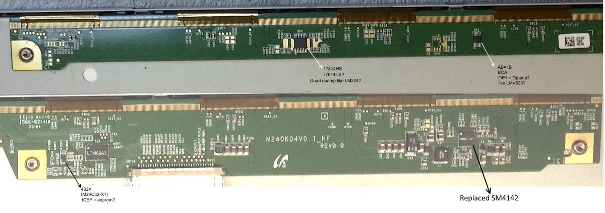

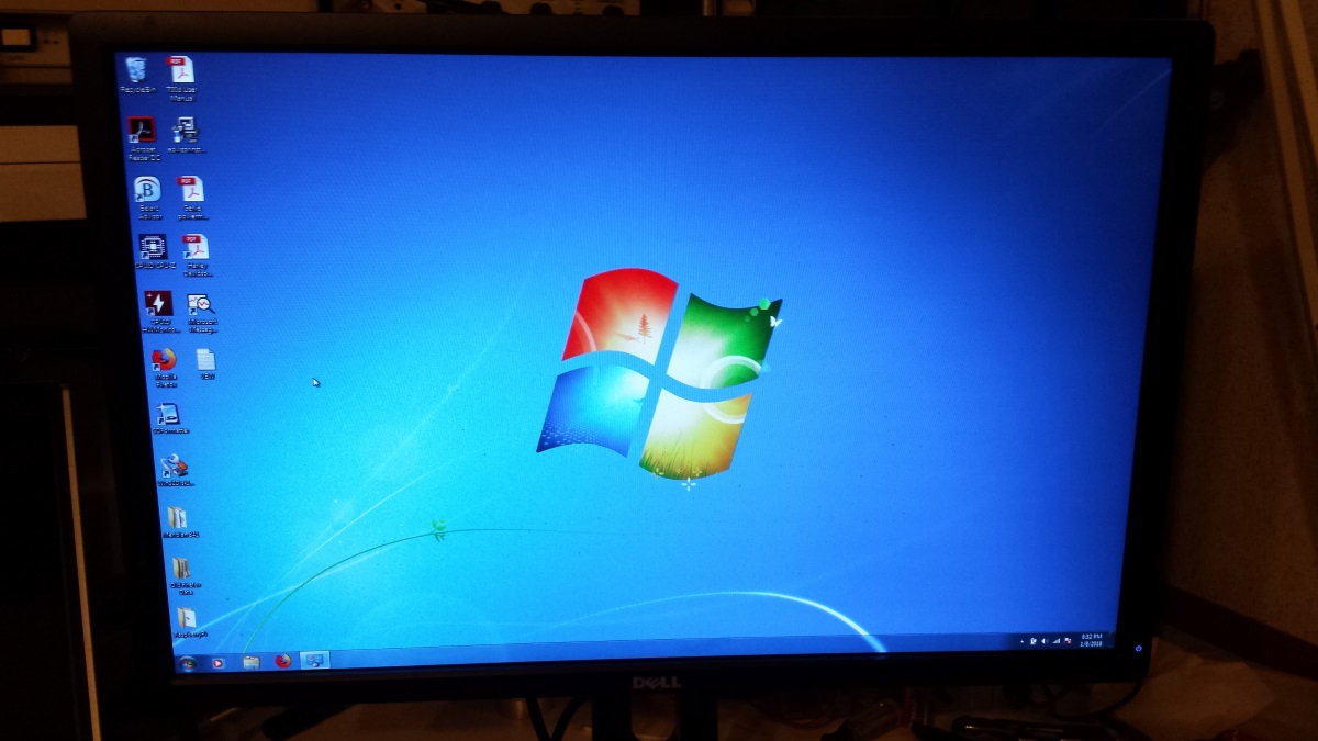

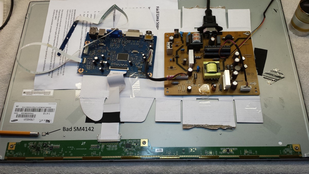

    Hello all,
    I had a blank screen problem with this display that I repaired, and I thought that I would post it here in hopes that it would help someone else down the line.
    Dell U2412Mb Ultrasharp
    Power board: 4H.1GH02.A02
    Main board:4H.1GH01.A10
    Panel:LTM240CL01 by Samsung
    Integrated T-CON: M240K04V0.1_HF
    Problem: On powering on, LED was blue for a couple of minutes, but screen was blank/black. No OSD on screen. LED would then turn amber (sleep).
    I verified that the power board was working and that the backlight was on. You have to confirm before LED goes to amber. I then made sure that the main board was sending the 5V to the integrated T-CON. The data sheet for the Samsung panel is available online if you need the pin out of the LVDS connector.

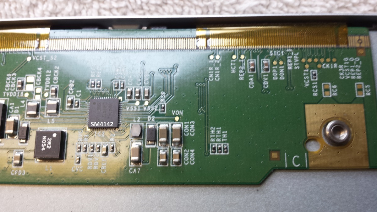

    On the T-CON, I checked the fuse, which was good. I then checked all caps and diodes for shorts to ground. Found nothing there. It turned out to be the
    power management chip SM4142. I could not find a datasheet for the chip to
    check further before replacing, but I have listed below, voltages before and after chip change. The chip is available on Ebay for ~$9 shipped. It is a QFN-48 pin, so you're probably going to need hot air to replace it.
    T-CON voltages before/after SM4142 change
    VON: 4.5V / 25.7V
    VSS1: 150mV / -5.6V
    VSS2: 600mV / -10.1V
    TVDD18: 200mV / 1.8V
    TVDD12: 20mV / 1.2V
    DVDD: 200mV / 1.8V
    AVDD: 4.8V / 10.0V
    VCC: 5.2V / 5.1V
    PVDD: 5.2V / 5.1V
    EVDD: 200mV / 1.8V

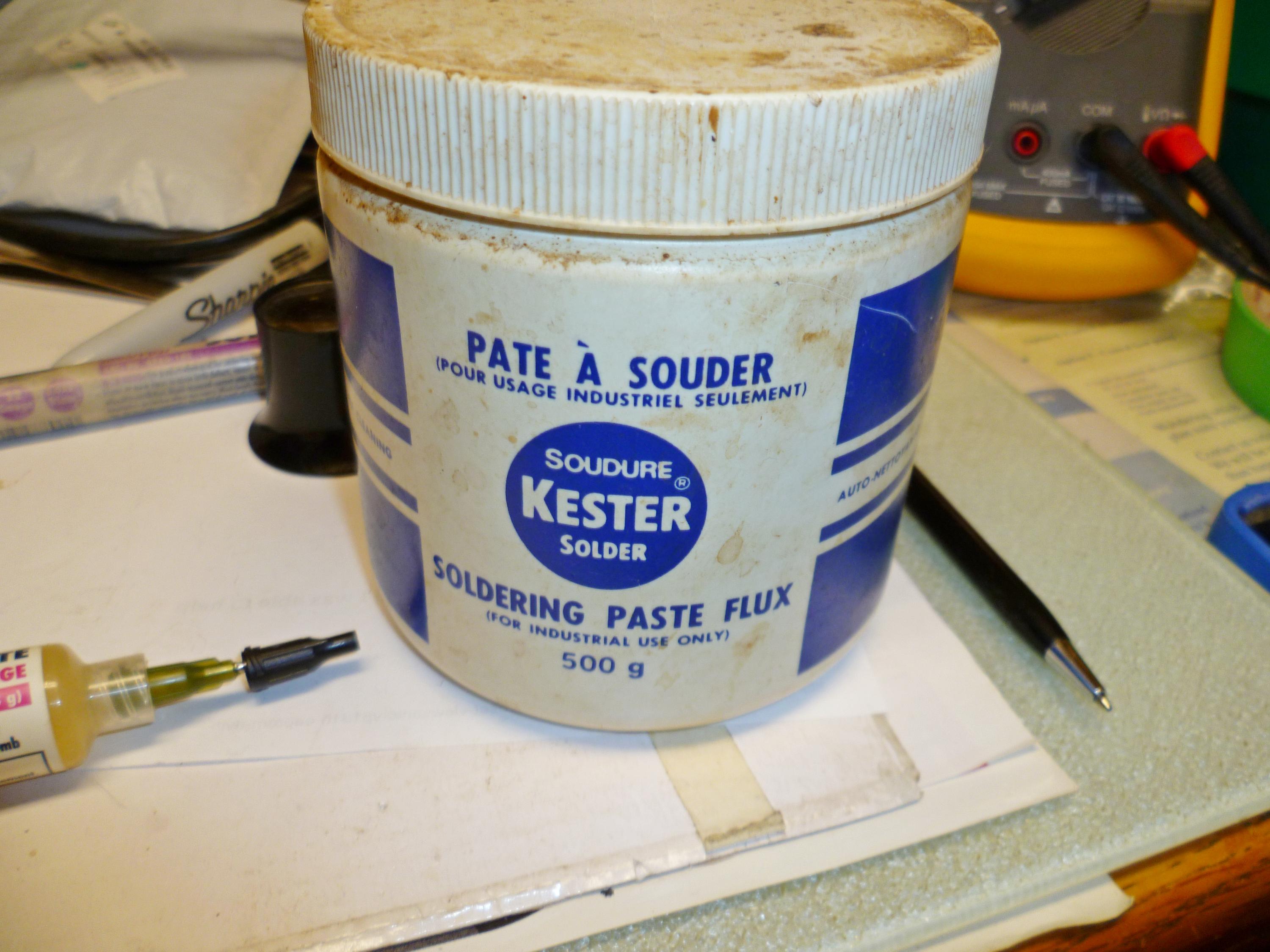

        Will62, when you say solder paste, do you actually mean solder paste or flux or are they the same thing?
        • will62
          • Dec 2016
          • 229
          • usa

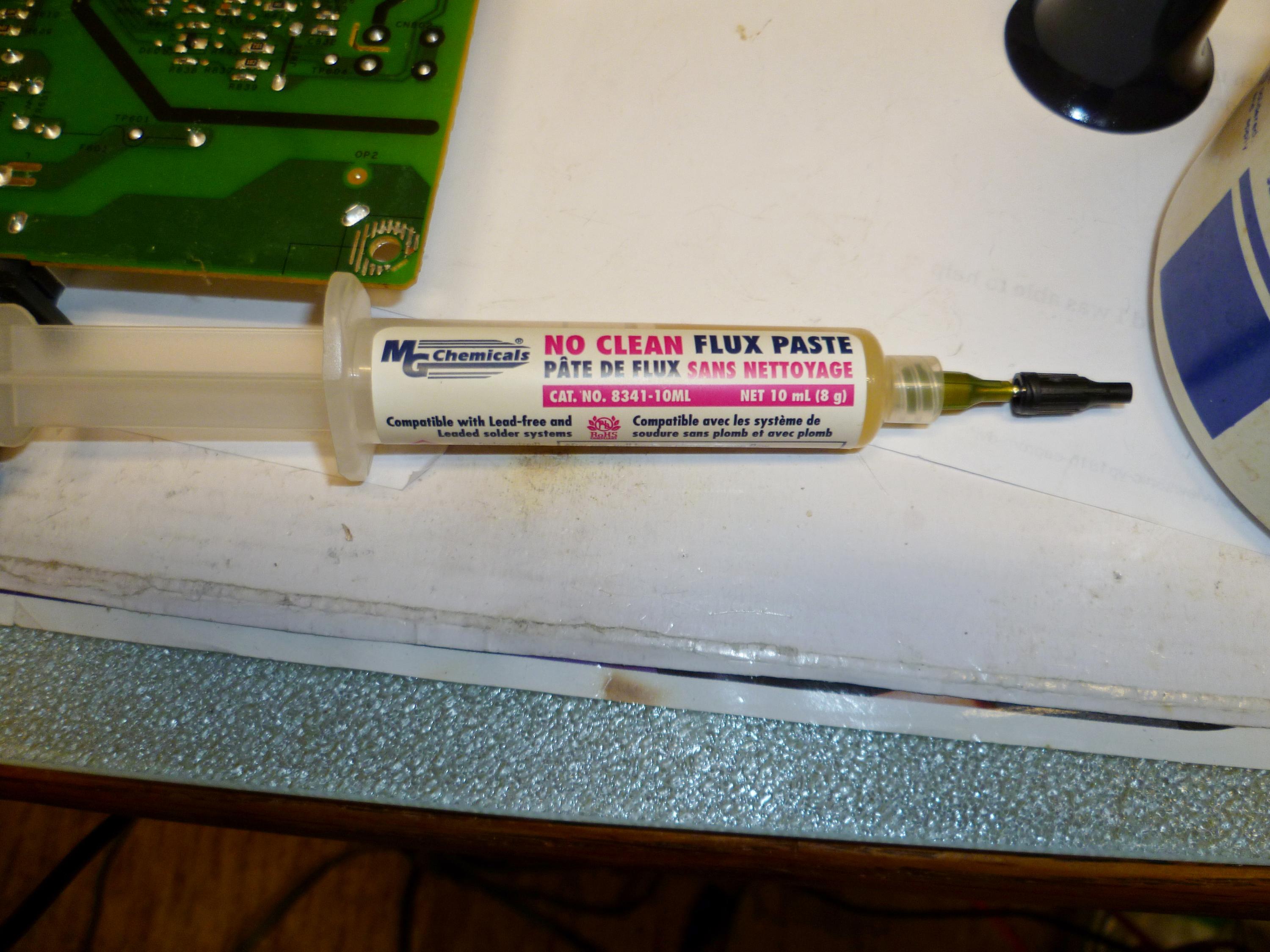

          Re: Dell U2412Mb - Backlight works, blank screen
          They are different, and everyone has their favorites. Whatever you do, don't get the "dab-on" pen style of flux like I did. Get the tacky style in a syringe. Watch a few youtube videos on qfn soldering, and you'll probably see some using paste.
          • rddube
            Aspiring Expert
            • Jun 2013
            • 950
            This is what I have, but both don't have any solder in them. I watched a few youtube videos, and there seems to be a kind with solder in the flux?
            • will62
              • Dec 2016
              • 229
              • usa
              There is flux core solder wire. For an example of solder paste soldering, watch the video below. Dave is pretty chatty, so you may want to skip to about 6:40
