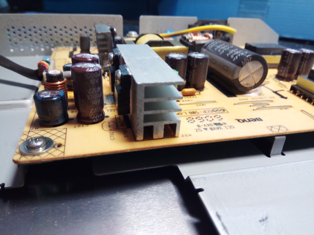

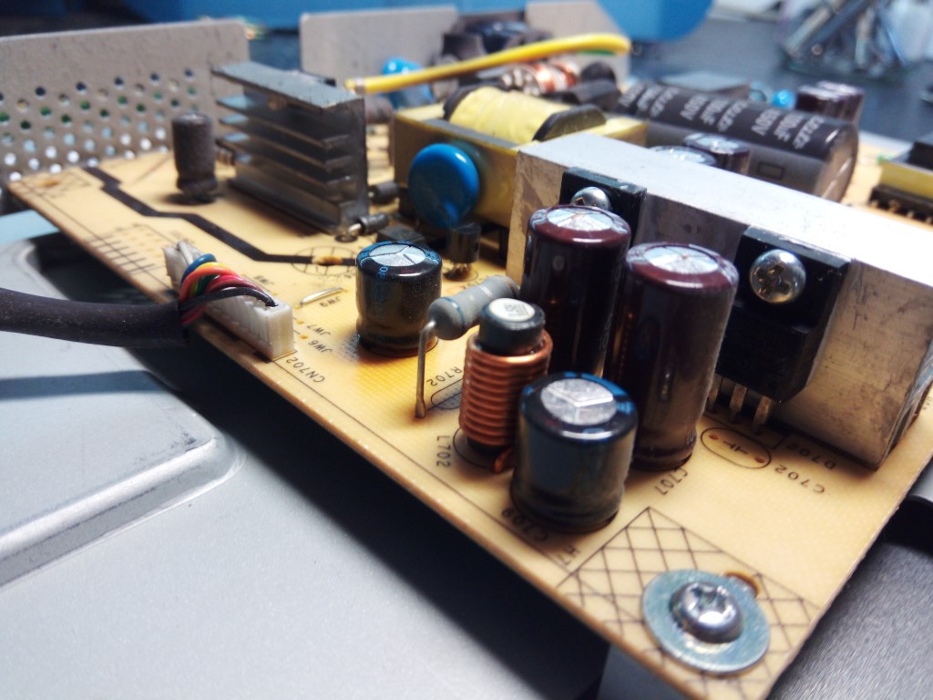

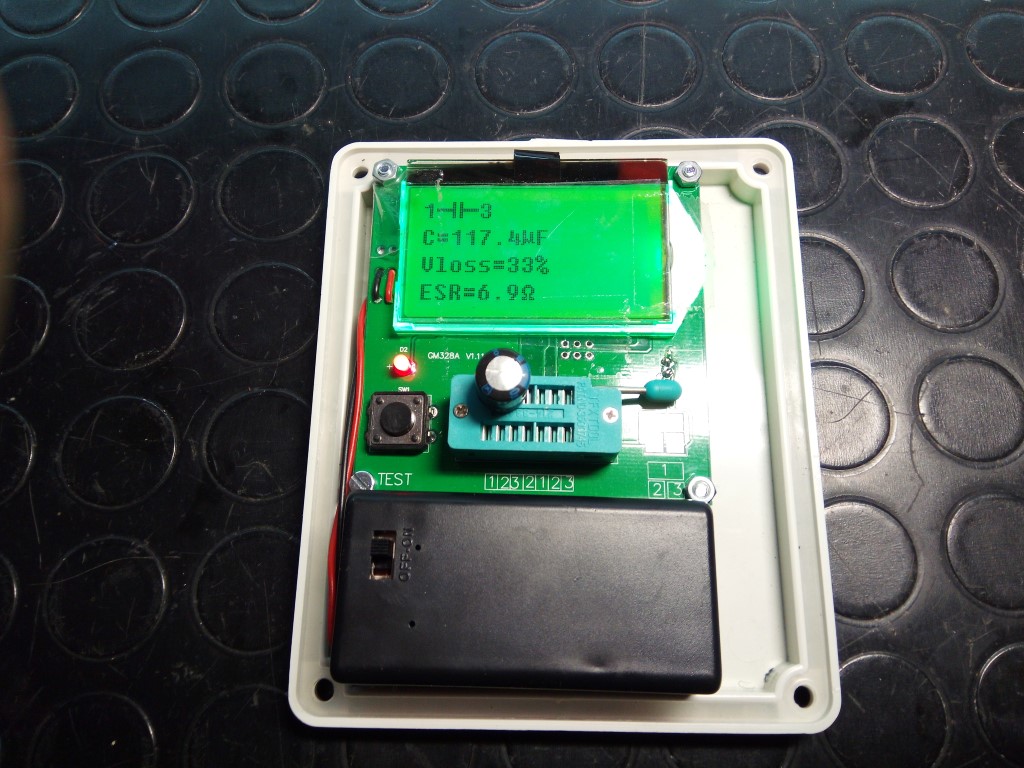

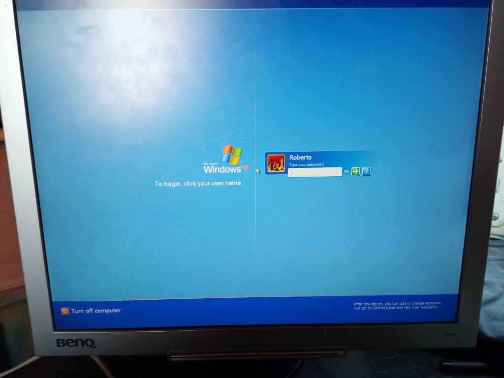

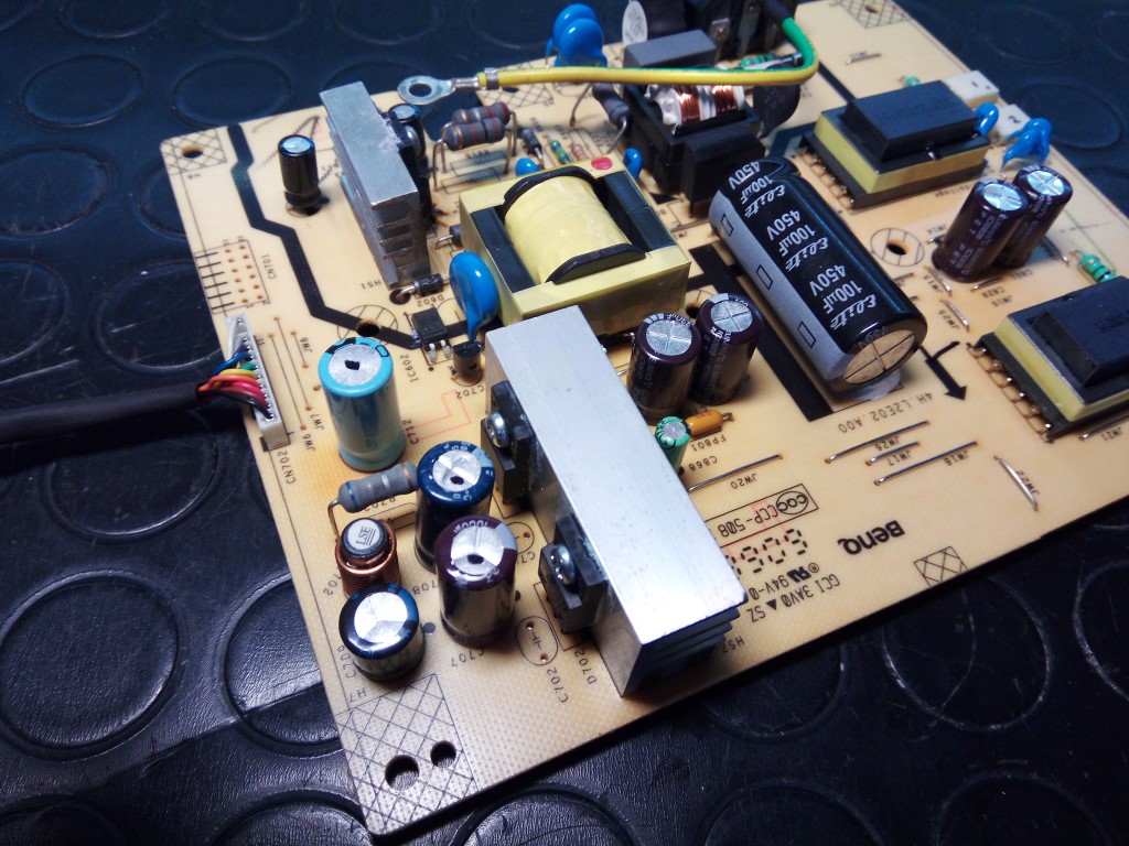

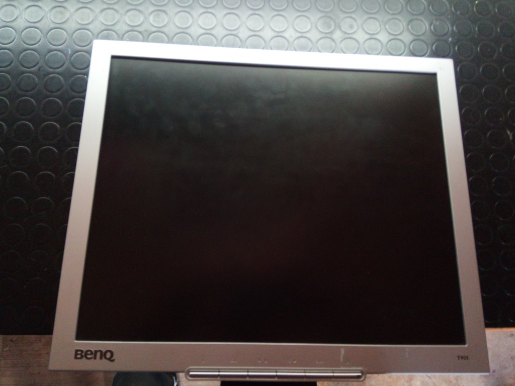

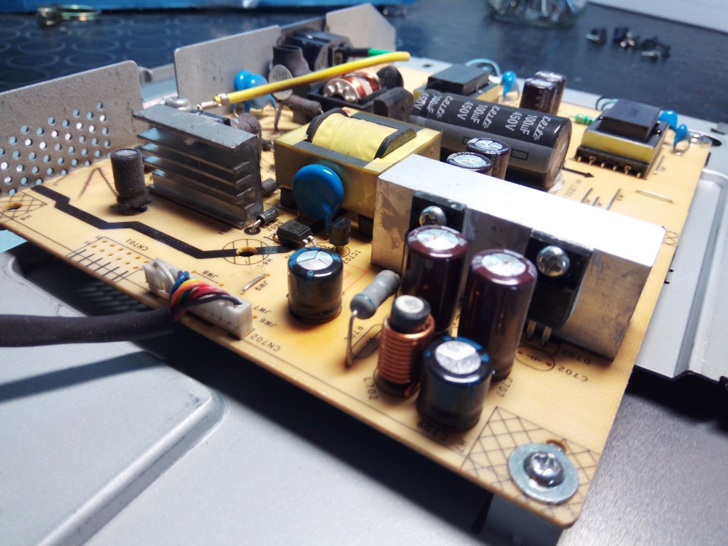

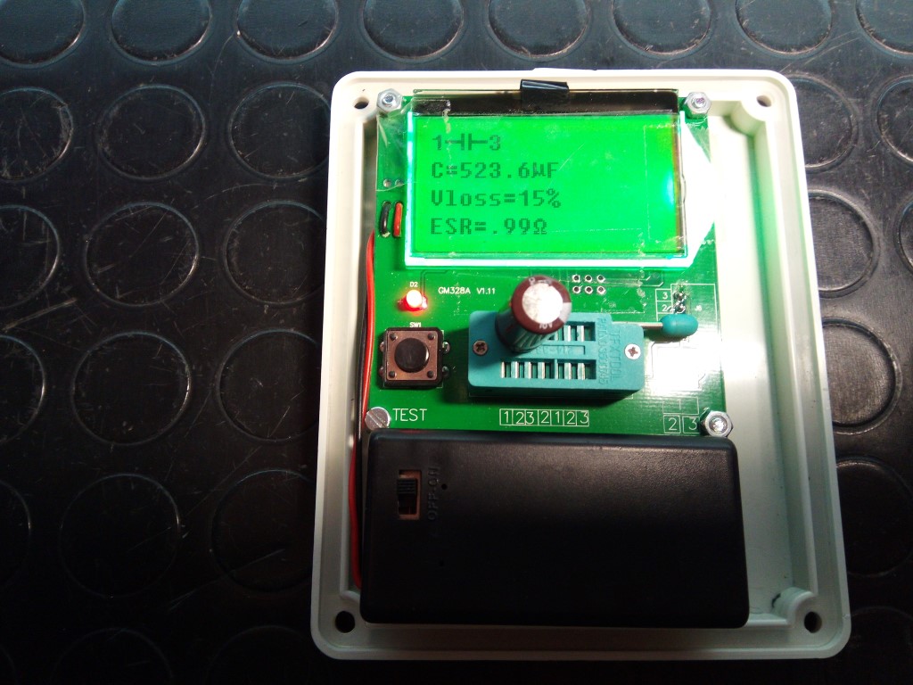

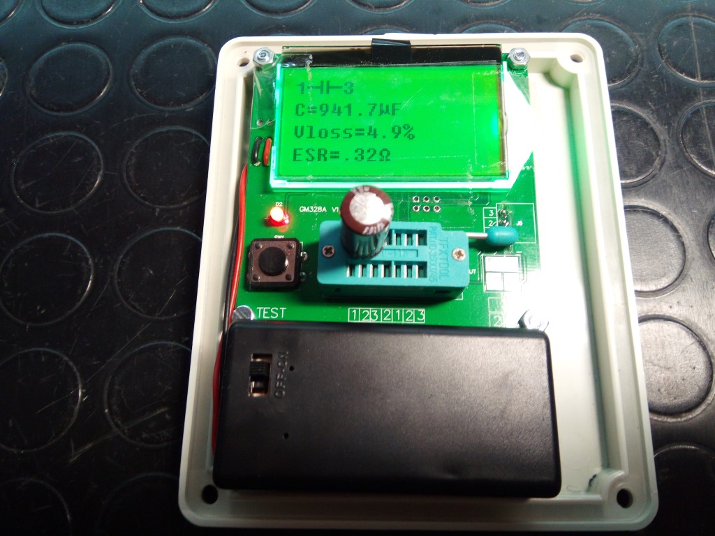

    this time I'm repairing a BenQ T905. This was an easy repair.
    Once again the culprit are bad caps in the power supply.
    We can see the problematic caps on naked eye.
    Check attached pics.
    Regards
