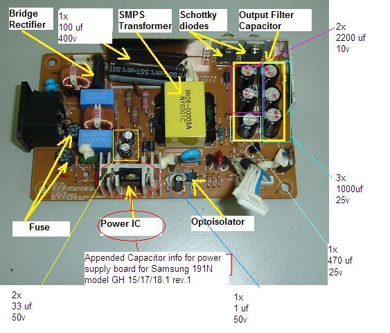

                Amending a previous thread. I am fixing a Samsung 191N LCD monitor (manufacture date 2002) that has intermittent power issues where it takes a long time to power up/glitches.
                I have an ESR meter. The board layout and appearance seems the same as the 191t except no DVI out.
                Problems seem to be on the power supply board. The only lytic showing damage is the big one (figures) which is a 400V 100uf Capacitor (mine was leaking and the seal was bulging a bit).
                AGREE ==>> the ones in the upper left corner are KMs (5 1000 uF 10 V and one 470 uF 25 V),
                below the main thansformer there are two small KMs
                ==> THESE APPEAR TO BE 33UF 50V CAPS
                and, hidden by the right heatsink the last small KM.
                ==> LOOKS TO BE A 1UF 50V CAP
                ESR METER SHOWS ON MY BOARD THAT THE 2 33UF 50V CAPS ARE GOING BAD. THE 400V 100 UF CAP STILL SHOWS GOOD CAPACITANCE BUT BORDERLINE ESR AND VISIBLE ELECTROLYTE LEAKAGE.

                    I replaced the big cap already.
                    the OP wasn't sure what the 50v caps were => 33 uf
                    also, on the 191N; I just pulled them out and the upper left is not all 1000uf 10v, here are 3x 1000 uf 10v and 2x 2200 uf 10v in there.
                    The board looks the same but it looks like they changed capacitance a bit between the power supply board revisions.
                    The 191N has the GH 15/17/18.1 rev.1 power supply board
                    This is the closest threat I could find on the Samsung 191N monitor caps for the PSU.

                      Re: Samsung 191N power supply board
                      Funny, I couldn't edit my own post from earlier tonight.
                      Anyways, just finished repairing my board. I have appended capacitor information in the attached picture.
                      In my case, the large cap was leaking and everything else looked fine. I ended up replacing all the other caps.
                      I was thrown off by the fact that the 5 caps in the upper corner were NOT all 1000uf-25v in the 191N monitor's power supply board.
                      Anyways, the GH15/17/18.1 rev.1 samsung 191n power supply board for the lcd monitor has slightly different capacitors.
                      See the picture for information. I am simply adding to the information base as I did not find any comparable information when searching.
