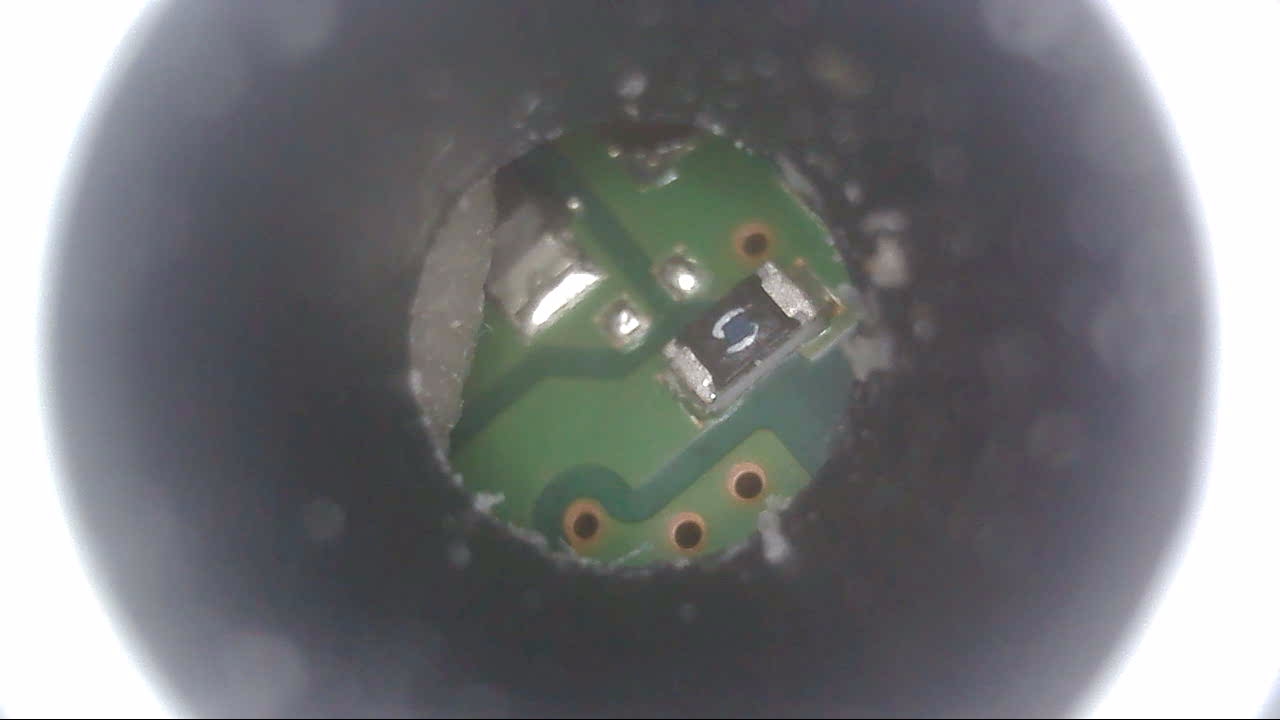

    I have a Fujitsu Lifebook SH/54K with a blown LED backlight fuse. I need help identifying the specs of this fuse so that I can order a replacement. It's a surface mount fuse that's white on the bottom and black on the top. It has/had the letter S on the top. Any help identifying the specs would be appreciated. Thanks.

    I believe `S' is 4 amp
