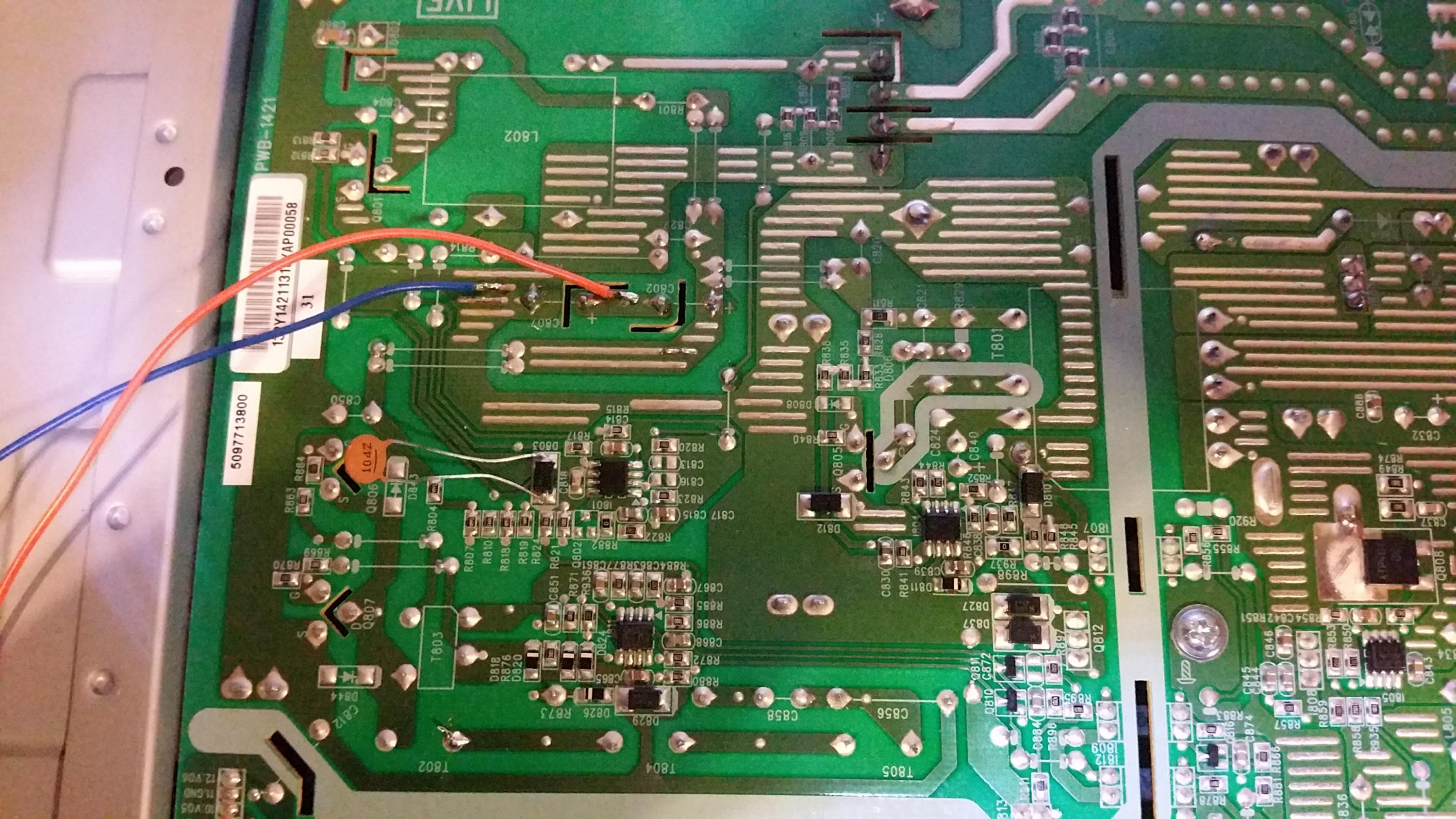

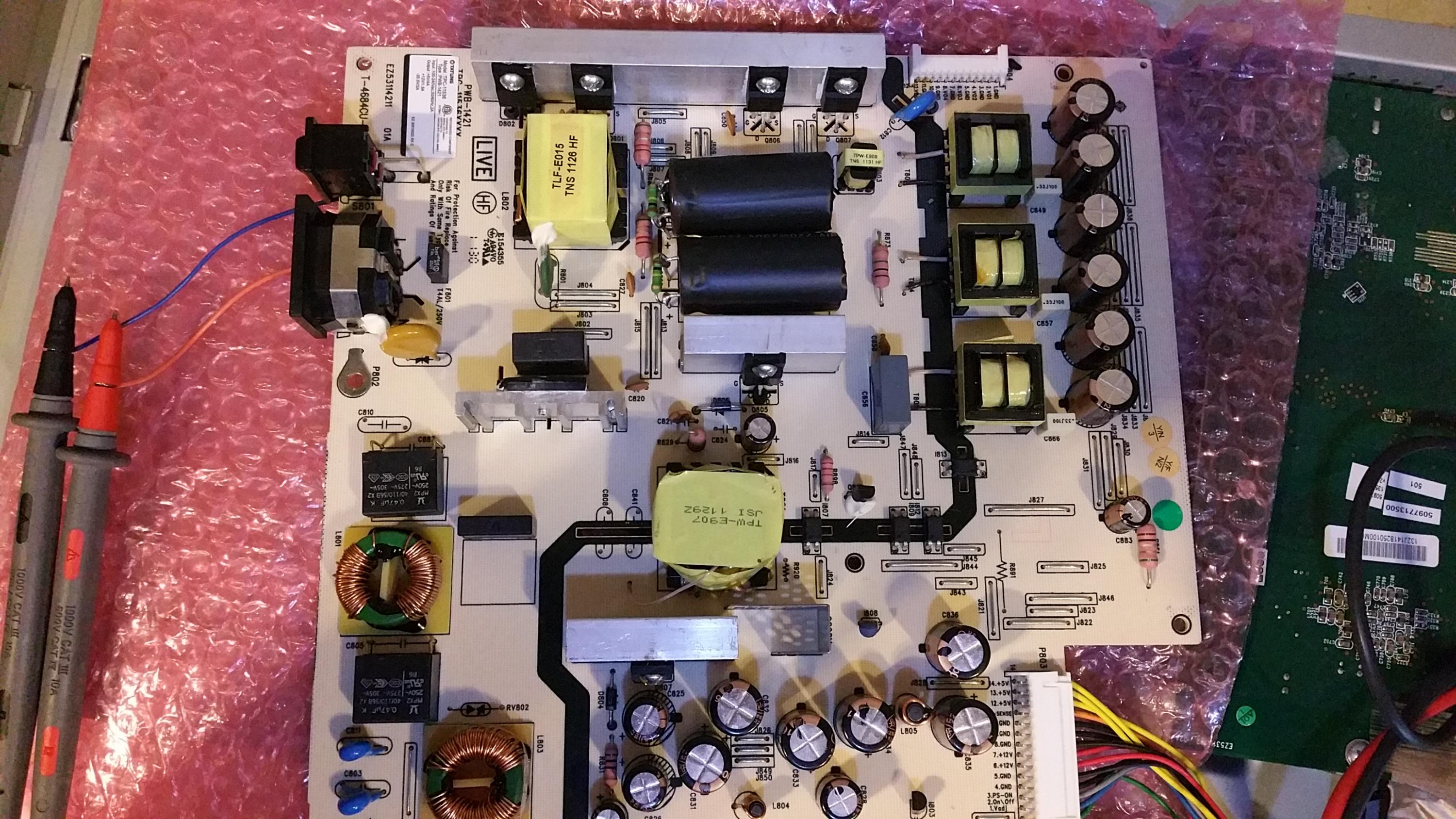

      I've attached a couple of pics of my PSU board. (note:
      - wires soldered over C807 was to measure voltage on meter without holding it.
      - Cap over D803 was because C818 is a bit chipped. This is the VCC decoupling cap for I801. Didn't help.
      - pic shows replacement caps for C802, 807. I put tape on the top because they are wider than the originals and i thought may be close to the chassis. They are nichicon low-ESR ones for switch-mode PSU. 220uF/250V, same as orig.)
      In the PSU circuit I see:
      - the PFC - gives 400VDC regulated. I don't believe this is controlled by the brightness control (?). I801 is the PFC chip.
      - an LED driver circuit on the live side. Presumably chops the 400 VDC again to AC. I811 is the chip for this. Not sure what model of IC this is or how the circuit works.
      - transformers isolating the LEDs T802, T804, T805 followed by rectifiers and smoothing. There are 3 transformers and 6 DC outputs to the LEDs. No further control circuitry on this side of the transformers - just a rectifier.
      What i meant was that I'm not sure how/where the front-panel brightness control adjusts the LED current. The control comes into this board as a voltage level in the range 0-5V - i checked that.

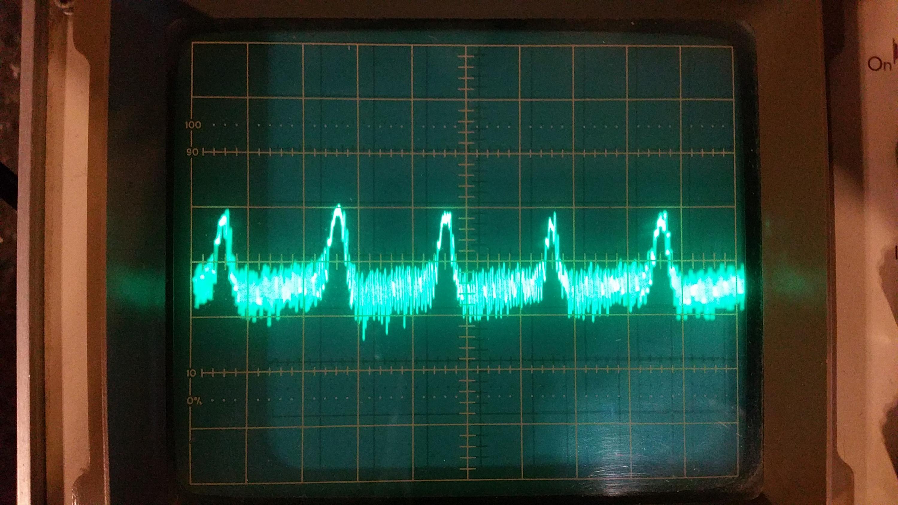

      I have observed the 6 LED strips with a scope and i see that the voltages all oscillate the same. Hence, i thought the problem was further upstream, and not the smoothing in this final stage. See pic for scope trace. It shows the oscillation is a pulsing effect. This is @ 50ms/div so its about 10Hz at the time the pic was taken.

          Firstly i looked at the AC output of the transformers which are driven by the DC-DC converter. When the monitor becomes unstable, the frequency is modulated and ultimately drops out. It starts off at about 150kHz. Because the frequency is unstable my view is that the problem is in the DC-DC converter or its control.
          I traced the control through the Opto-Isolator I812. This in turn is controlled by another TI chip - I810, a Z103WA. This is a dual op-amp with a voltage reference inbuilt. I guess the reference circuit in the datasheet is going to be similar to what is used here.
          The input to the Opto Isolator I812 IS oscillating (i.e. at around 10Hz) when the monitor is unstable.
