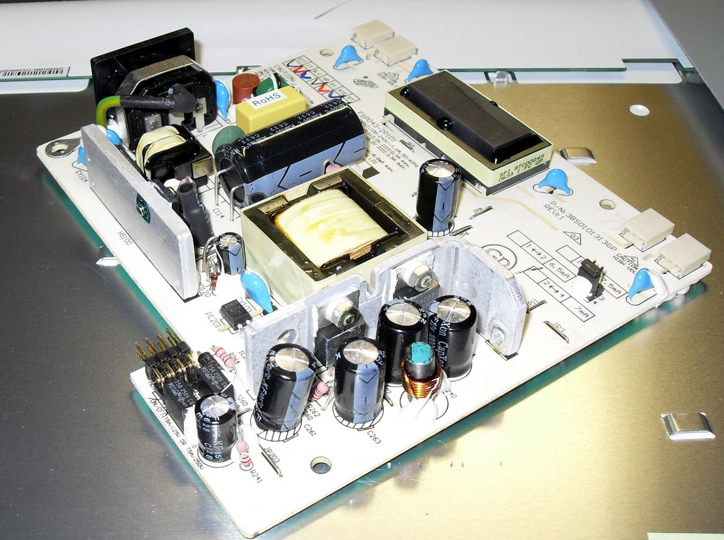

                  I've had about 15 of the AL1706 monitors go bad so far. It's most always the power supply and the same 3 capacitors that have gone bad. Replacing two 1000uf 10v and sometimes the 1000 uf 25v corrects the problem.

                    Re: No image
                    I agree, three 1000uf caps (two 10v and one). I change them all, even the inverter's side one. They are just a few.

                      Re: No image
                      My board looks a little different. I wonder if there are different revisions of the AL 1706.
                      • EGuevarae
                        • Nov 2008
                        • 1336
                        Re: No image
                        I've seen AL170A, AL1706b, AL1706A/Ab and 1706Ab. This board comes from an AL1706A/Ab. Maybe there lies the difference.

                          I've got the same board as djames100. The caps are testing ok on my Blue ESR meter, I'm getting 5v on the output to the processor board on pins 1 and 2. 12v to pin 13 on the inverter IC. But still no power LED and no display or backlights. I found this link from acer and I've been poking through the flow chart, but its a little over my head. I've found a couple resistors that seem to not match their numbers.
                          In circuit:
                          R818 is pretty low 2100-2500 depending on polarity supposed to be 3300
                          R810 is supposed to be 5100ohms and is reading 4100ohm and 2500ohms depending on polarity.
                          R811 is supposed to be 43000ohms and just climbs from 20000 up to ???
                          Any comments from the experts before I go replacing things?
