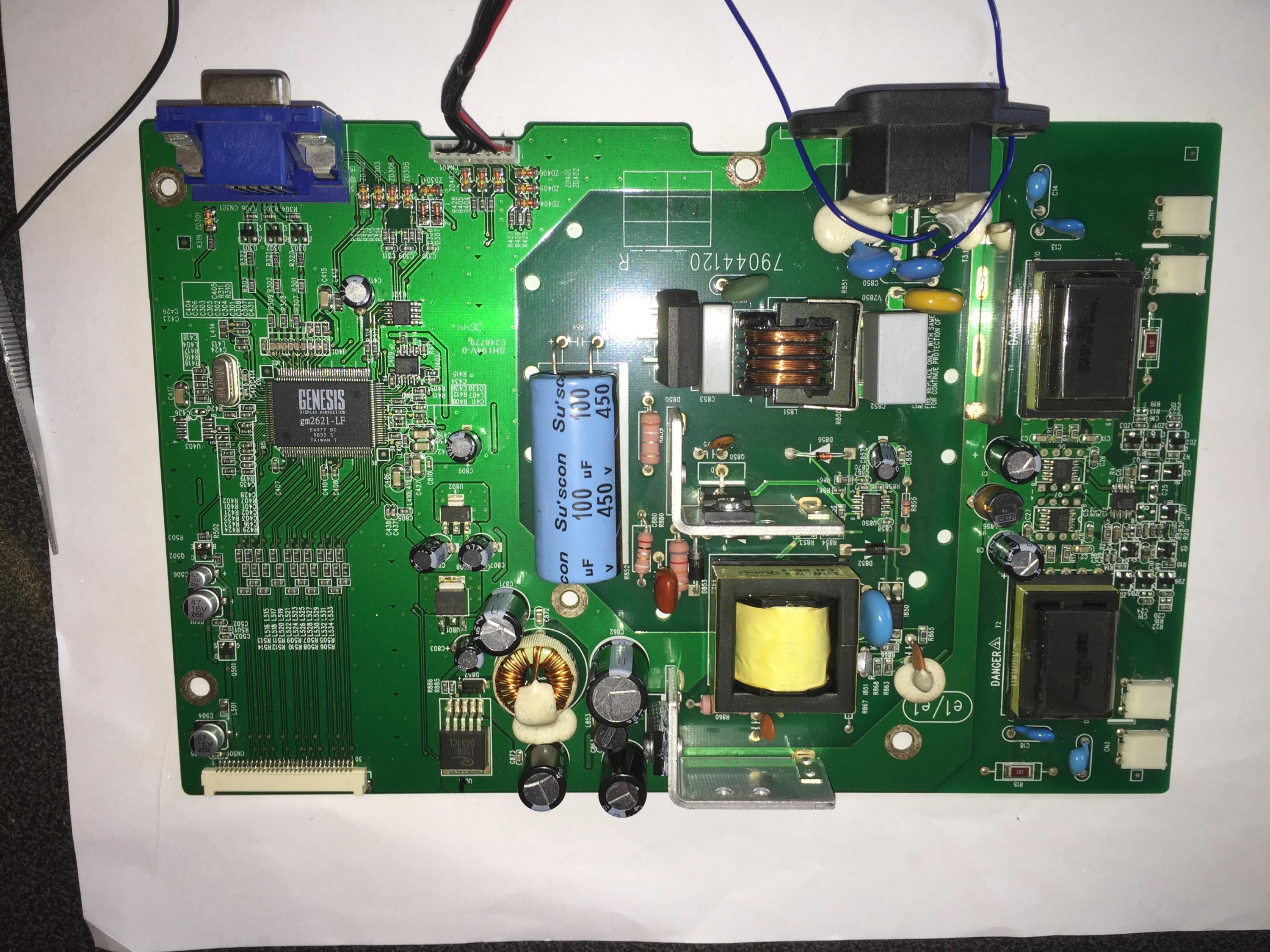

    I have a E197FPf monitor with a squealing transformer that bridges the primary and the secondary denoted as SPW-053.
    I have recapped all electrolytic capacitors with Rubycon low ESR caps, all except the large filter capacitor C854.
    Q850 (MOSFET transistor?) seemed OK when testing following this video but I don't have the values for the forward voltage written down and it is back in circuit now.
    The U850 (power controller?) chip has the following readings using pin 1 with the black probe
    Pin 3 = 15.33v steady
    Pin 7 = 15.11v steady
    The large filter capacitor C854 has 332v.
    When I press and hold the power button there is a tiny voltage increase on pin 3 and pin 7, exactly 0.01v.
    D854 (dual diode?) I don't know how to test, but I think it is fine (can't quite read the part number).
    I850 (octocoupler?) has the following
    Pin 1 = 9.98v steady
    Pin 2 = 8.92v steady
    Pin 3 = -160.5v to -163.6v unsteady
    Pin 4 = -158.8v to -161.6v unsteady
    Probing pin4 changes the sound of the squeal until I remove the probe.

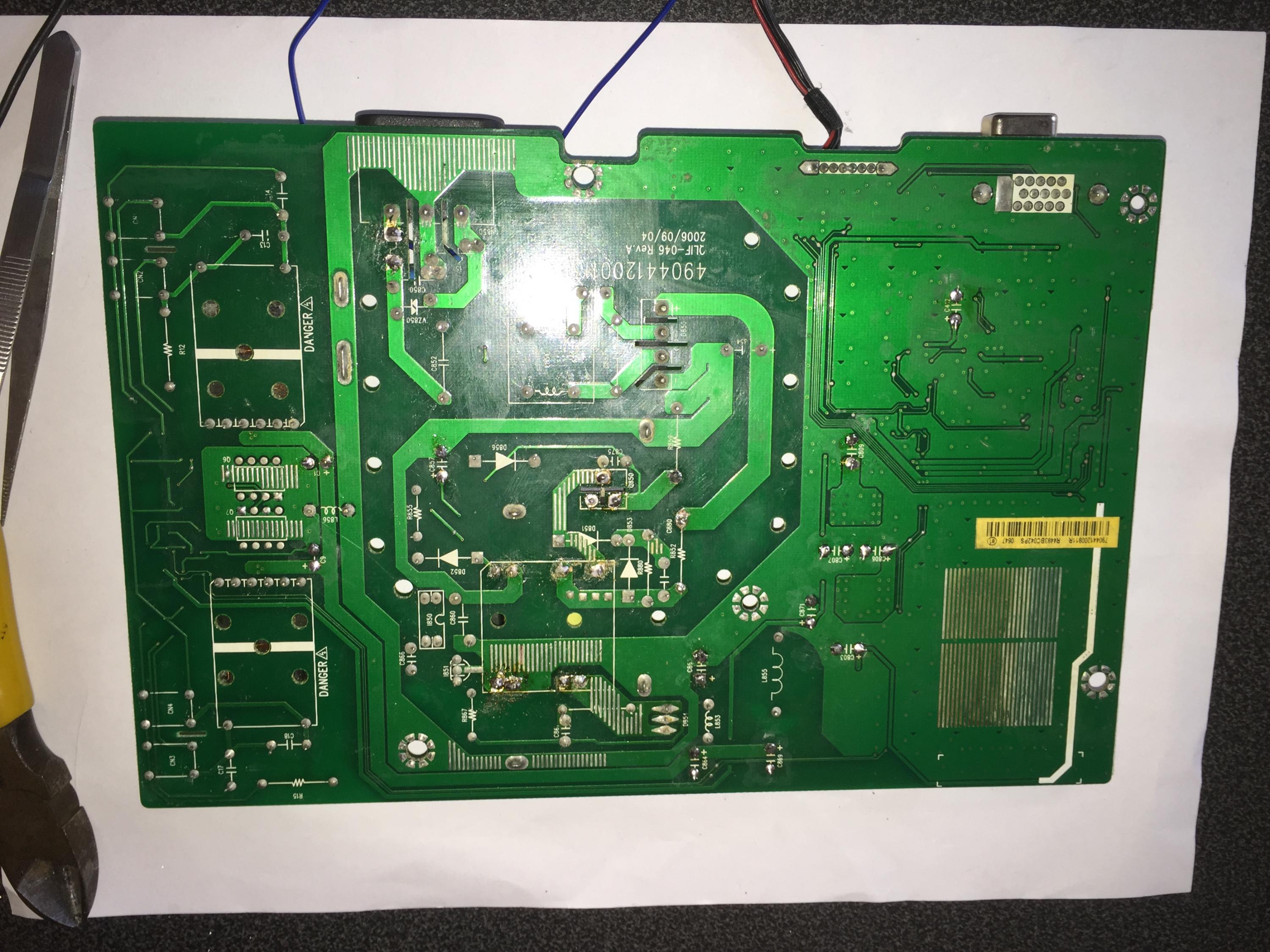

    Transformer testing
    Continuity
    Primary1 - 1+2 - beep
    Primary2 - 3+4 - beep
    Secondary1 - 5+6 - beep
    Secondary2 - 7+8 - beep
    No continuity between primary1 and primary2 (1+2 and 3+4).
    No continuity between primary1 and either secondary1 or secondary2 (1+2 and 7+8 or 1+2 and 5+6)
    No continuity between primary2 and either secondary1 or secondary2 (3+4 and 5+6 or 3+4 and 7+8)
    I have tried testing with an Anatek Blue Ring Tester and I only seem to get a green reading on pins 1+2 of Good/High Q, both sets of pins on the secondary appear to either be dead/shorted (no light) and the primary2 (pins 3+4) show red which indicates Bad/Low Q according to the label on the tester.
    Any clues on what to replace? I was thinking the transformer, and I have removed it and tested it as above, I have put it back in the circuit and it still squeals. I'm unsure of the results of the test and if it isn't receiving what it needs then it's not likely to be the problem part, but I would need more information regarding U850 voltages to be certain that's the place to start.

    Re: Dell E197FPf no power on and squealing transformer - guidance?
    Forgot to mention that those two blue wires are to a fuse 250v 3amp fuse until I have repaired the circuit, I'm not buying the 250v 3.15amp radial fuse. This squeal was present before the fuse blew.
    I have measured U851 (1506 0631cl) as follows
    Pin 1 - 12.10v
    Pin 2 - 5.14v
    Pin 3 - 0v (GROUND)
    Pin 4 - 1.24v
    Pin 5 - 0v
    U850 is SG5841JSZ
    I have a SG5841SZ (not SG5841JSZ) I can buy from eBay and looking for datasheets, these seem to be the same part, but unsure if they have different use/operating modes based on that J letter. The datasheets are identical.
    I started this project about 2 years ago replacing the caps, and didn't know what to do so put it back in storage up in the attic.
    Could someone give me a starting point please?
      I'm not an expert but I would take a look at the 3.3V LDO which is probably U802 (at the left of the main filter cap), I can't read the markings. U801 (just below) may be interesting too.
      Given the measurements of U851, 5V & 12V looks ok, but the 1.24V you get for the buttons seems a bit low to me.
