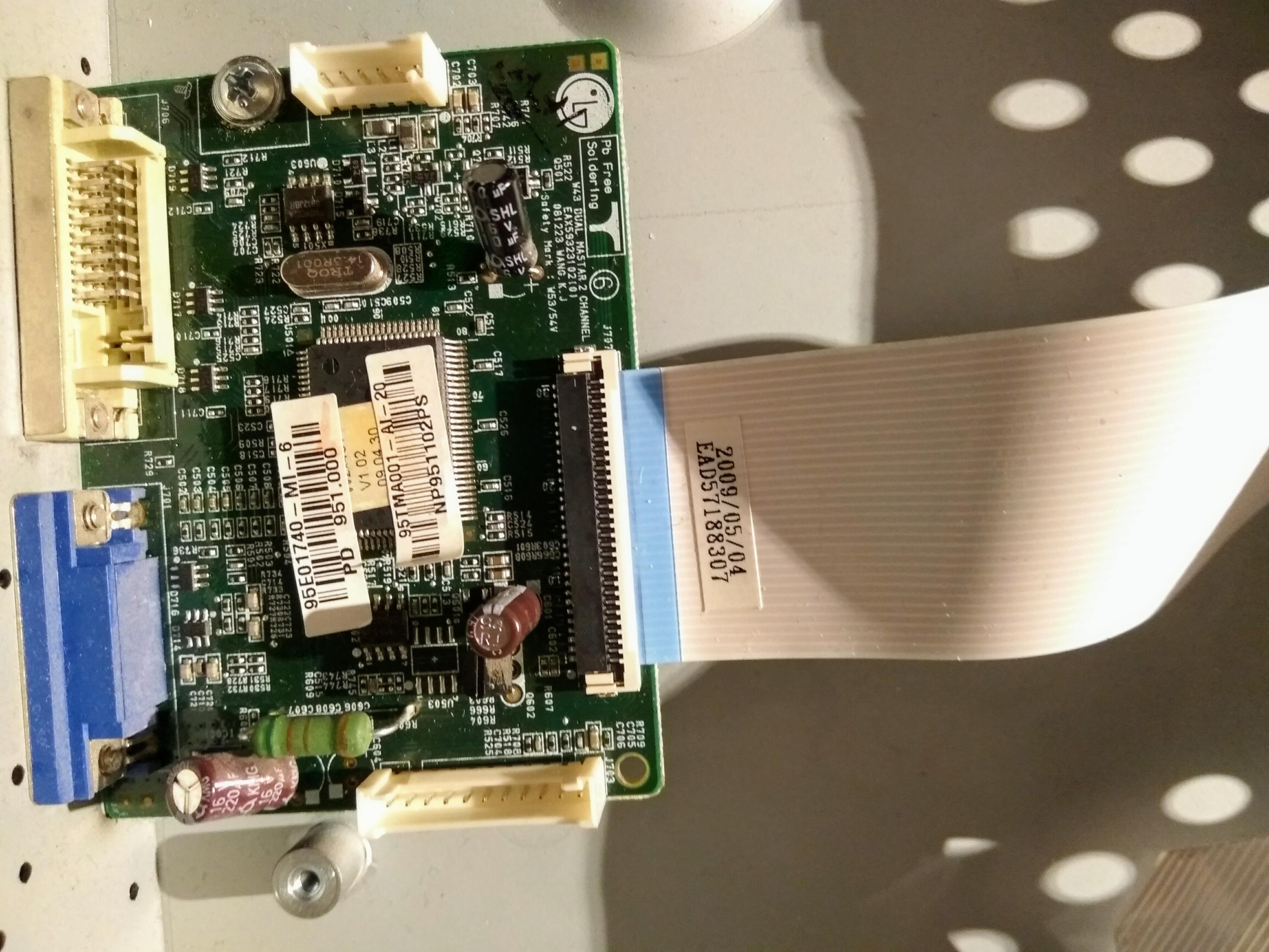

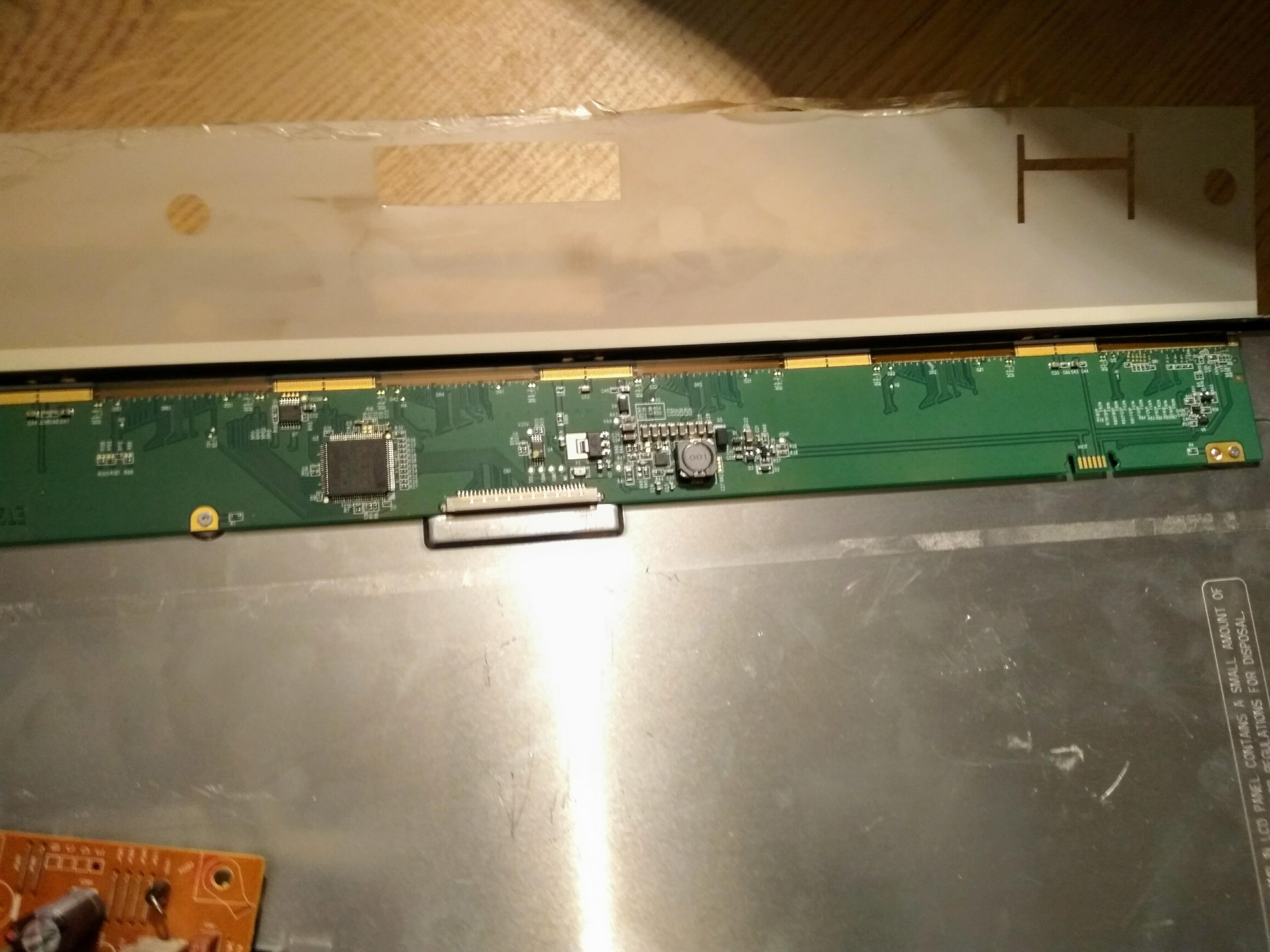

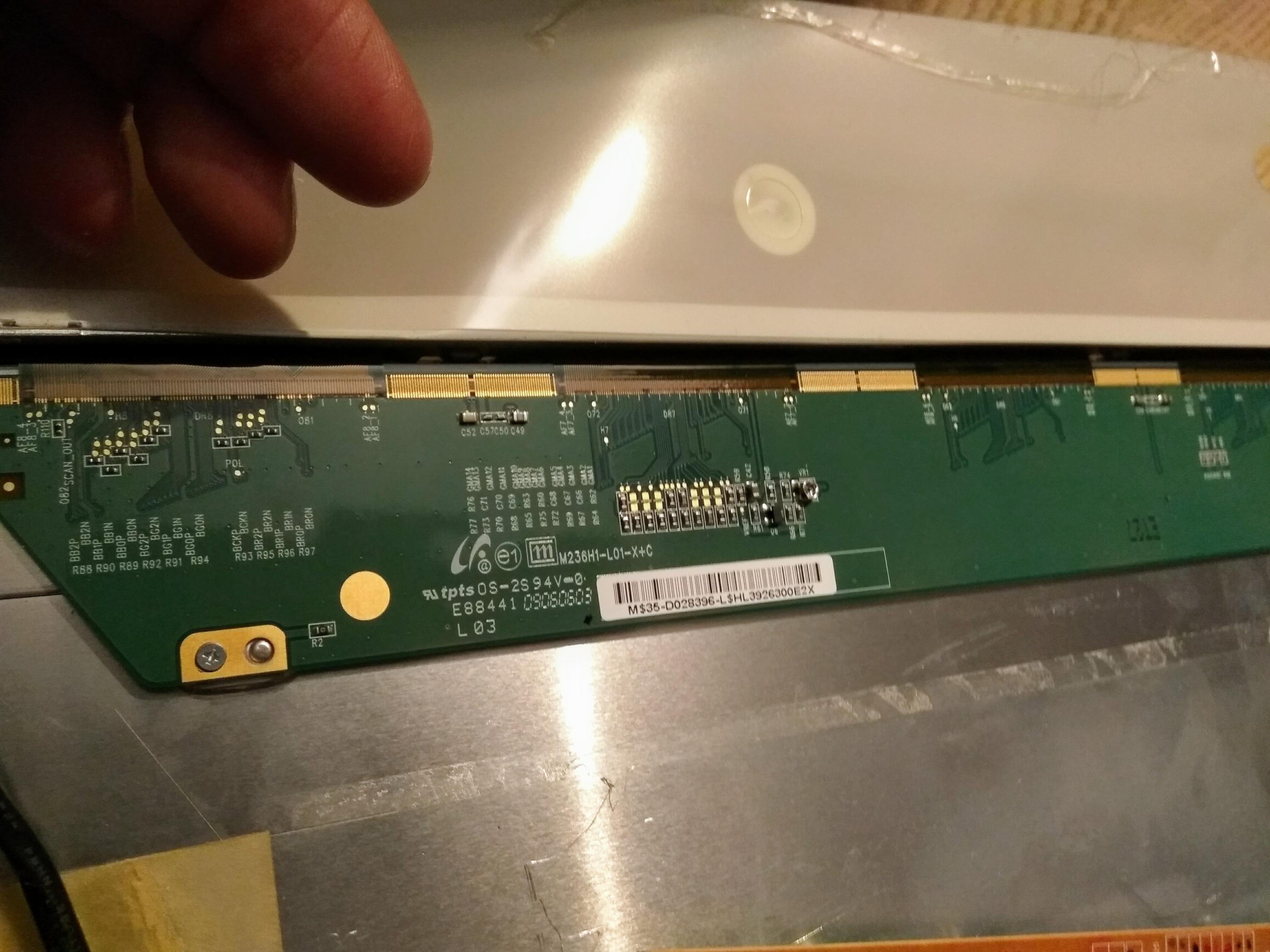

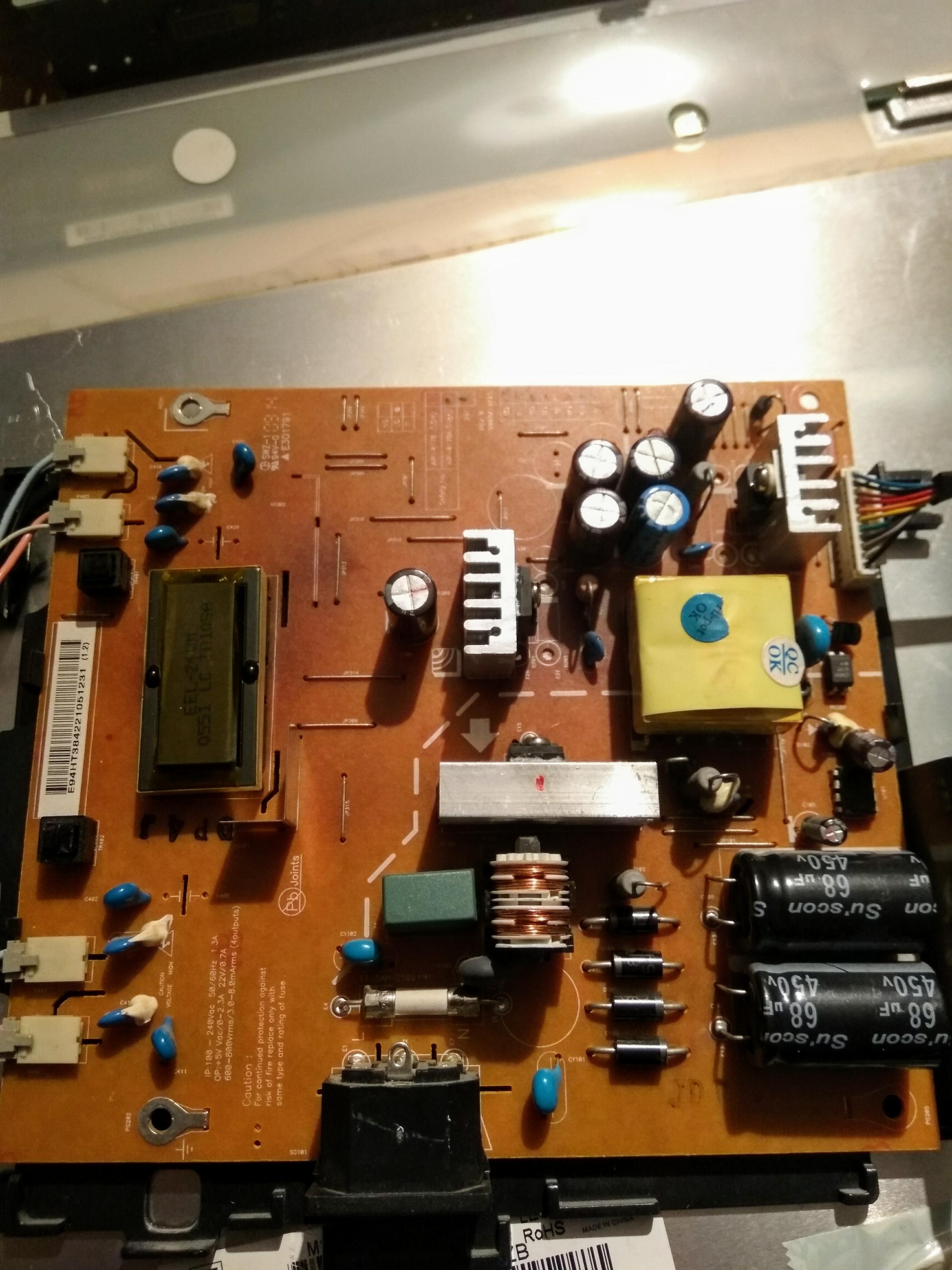

    Hey,
    So this screen in giving me a white screen only and do not respond to anything else. I've checked the white ribbon cable and seems to be alright. I've attached pictures of the logic board, the power board and the LCD panel.
    Any insight? I would hate to throw it away, been a trustworthy companion for many years...
  • 1supertech
    • Apr 2012
    • 384
    Re: LG W2443T White screen
    Just above the ribbon connector their is a fuse test the fuse for continuity
