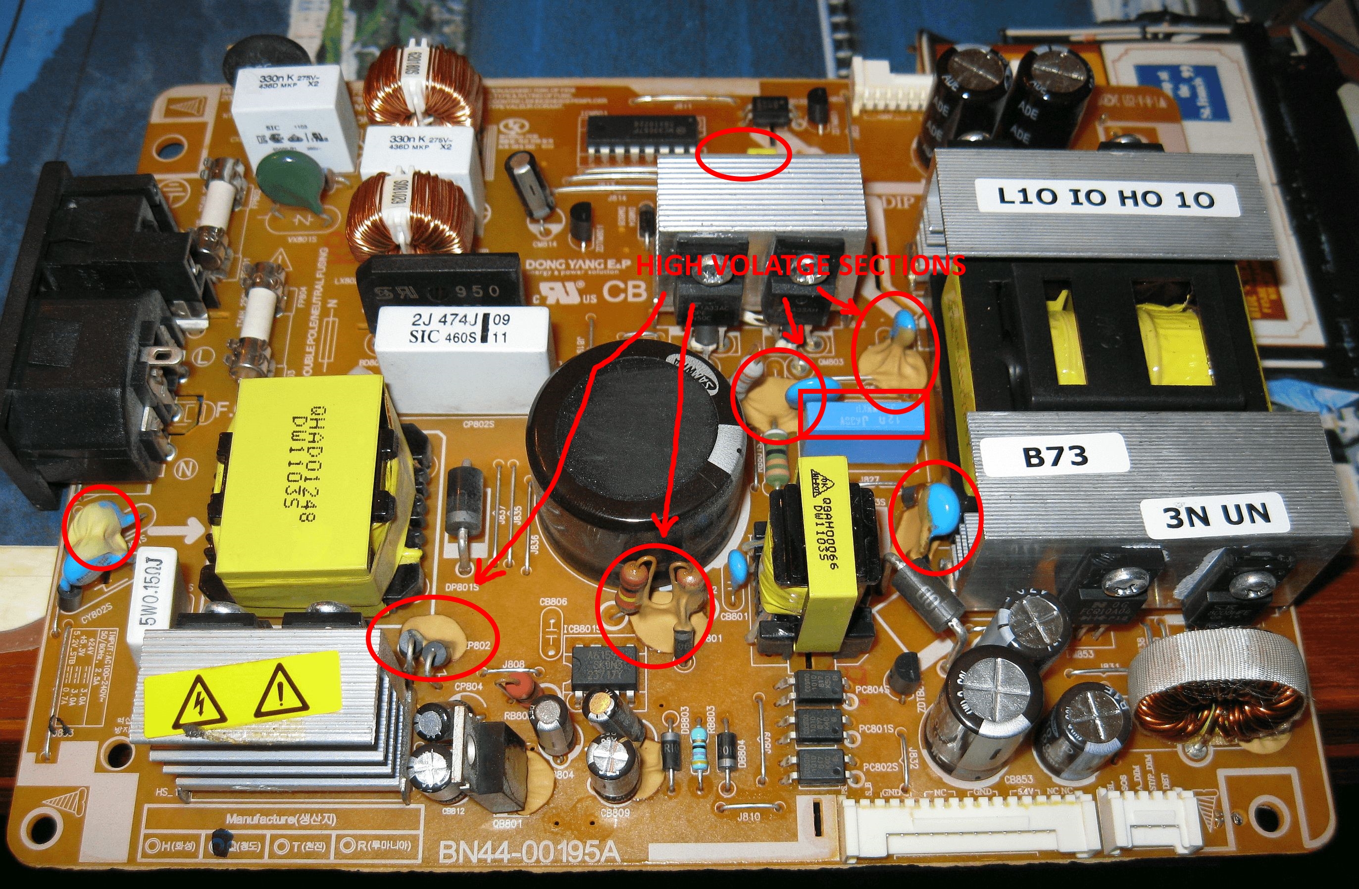

    Sorry to drop a few on you guys at once but here is another I thought potential easy fix I got from Eblag.
    I thought i might be able to get myself a bigger monitor on the cheap.
    So far no luck.
    This Monkey is another samsung(do you see a pattern emerging or is it just me??)
    its a Model?245Bplus or model code LS24hubcbl/edc or type HU24BS
    Set appears to be dead/ no back light etc
    PSu fuses ok not blown, no bulging caps visible, not tappable, a solder up did nothing.
    Any tips/ideas would be great. PSU is a dong yang BN44-00195A
    I have cleaned up the board and scraped off the Brown old glue stuff as suggested in another thread somewhere.
    But the Patient is still flat lining /dead/in a coma.
    Any help would be greatfully received.
    Wondering whether to just blanket swap a load of caps or wondering if its summat else?

          The OP has a 245B Plus monitor with the much dreaded 195A PSU. He might consider buying a used 137A PSU, as they are much easier to fix when failing. On these usually only one of the 3 68R resistors fails (goes open circuit).
          I have successfully fixed several 137A PSU's in the past years, whereas my success rate with fixing 195A's is exactly zero.

            You said no backlights, but do you at least have the standby 5V Voltage?

                What are the numbers on the barcode sticker?
                That is not BN44-00195A.
                BTW, what is that bare wire soldered on the bottom side of the board? It looks like the bottom side soldering works need to be cleaned up and inspected.

                  The wire is just a cap i replaced, as mentioned earlier in post, the print lifted a little so just to be on the safe side i soldered the cap leg to the next cap along on the same rail/track.
                  Yup its not had a clean yet, and will be made to look more pretty/proper job before i put the board back,

                    Serial number sticker as far as I can tell(could hardly read as so small) was/is
                    cn07bn440050ask28d7e2621 the a in ask could be a four as print is smudged.

                      What a jack ass! I posted wrong pics in the wrong posts and i cant seem to edit my above post with the pics.
                      The PSU out of this monitor is in fact this one.

                            You can run the board by itself to check the standby Voltage without having another boards connected to it, just have to be real careful not to touch anything in the primary side with your body/hands.
                              Re: sorry 4 being greedy but... another patient samsung245B plus
                              well just having a quick poke around and seems like ive got nothing on anything on the secondary side just ikkle Mv's. def no 5v or 12v on anything.
                              240 going in, both fuses intact, bridge reccy is fine, thats as far as Im up2 so far.

                                Then we need to find out if we have about 330VDC between the two legs of the main filter cap or not.

                                    if i have the psu switched on live and connected to the main board, and then measure the standby voltage its jumping around mostly around 3- 3.5 v (all over the place really looks for a fraction of a sec its at 5v but its def not stable.
                                      Maybe your main board is taking too much power due a shorted component, check for any overheating component, specially linear regulators, however i would check the PSU without anything connected to it, 5Vsb should be stable in that case.
                                      If you have a lab PSU try to feed 5V on the main board to determine if the board is taking excesive current.

                                        At least we know that you do have DC on the main filter cap otherwise you will not see any DC at the output connector at all. I thought you said you do not have any DC on post #15.
                                        It is confusing when the information is not clear.
                                        Is the 5V steady if you do not have the main board connected it?
