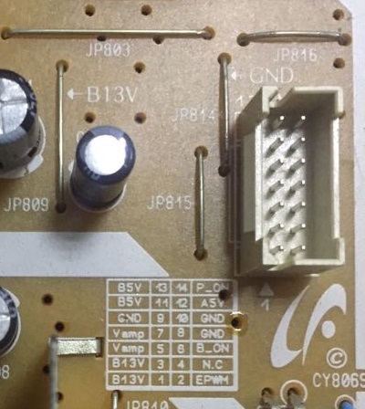

    Hoping you guys might be able to help, I bought a Samsung syncmaster off of a well known auction site with stand and remote for the princely sum of £5.00
    I was hoping it would be an easy fix and Ideally just a solder up job, but alas no.
    The symptoms are that the power LED seems to flash 5 times but set appears to be dead other than that.
    No startup, no pic, no sign of a backlight.
    The tv/monitor is not tappable as in dry joint, doesnt respond to heat and finally didnt like my efforts swapping the 2 caps I had in my stash that matched/fitted.
    I thought the chances of me swapping 2 caps, for ones I just happened to have, was probably going to be slim to no chance, Turns out it was the latter.
    Has anyone Resucitated/revived one of these criters?
    the PSU has 2 lots of markings/possible ID's one 23A0T_CPN but i think it is prob this BN44-00504A.
    There are no visibly blown or bulging caps, no signs of scorching, and presumably because I get the Power led flashing I am guessing its safe to assume I have power (bridge rec not blown) and a quick test after trying showed some residual volts on the main smoothing cap.
    Any help would be greatfully received.

      The procedure is always tha same, TEST PSU FIRST!
      Detached from the rest apart mains plug, use voltmeter on the onboard connector, who usually has values printed on pcb, if there's also a lamp psu on same board, find the diodes that rectifies main trasformer output, then put a dummy load, like 1 or 2 12v bulbs for the 12v->more, a 3ohm 10W RES. on the 5v, it must warm up slowly until hot. if the psu is ok, you must check power voltages on interface board, like linear or sm regulators, then you can try to power up the thing with different combination of keys to find the one that pops up video an service mode, if fails locate if present the settings eeprom then try to reset it with the short on pins 5,6 when plugging mains. if it fails, try to detach lvds ribbon and try to power up to see if led pulses changes... etc etc... eeprom can also be resetted connecting it to a pc with a simple LUDIPIPO interface..
        Re: Samsung T23B350 dead?
        Check the DCV on pin 12 (A5V) of that white connector that goes to the main board to see if it is steady with the board connected to the power supply board, if it is not steady then disconnect the main board and test the Voltage again.
        You also need to report the DCV of the rest of the pins, make sure to put down pin name and follow by the DCV reading.
        BN44-00504 POWER SUPPLY/LED backlights driver board.
                        Main board unplugged / plugged in
                        B13V (Switched 13V): pin1 12.9v / 5.2v
                        E-PWM: pin2 12.9v / 5.2v
                        B13V (Switched 13V): pin3 12.9v / 5.2v
                        N.C.(NO CONNECTION): pin4 12.9v / 5.2v
                        Vamp: pin5 0v / 13v
                        B-ON (Backlighhts ON): pin 6 5v / 13v
                        Vamp (Switched Vamp around 12~13V)): pin 7 5.2v / 13v
                        GND: pin 8 3.2v / 81mv
                        GND: pin 9 5.2v / up=down mv 0--180/200mv ish?
                        GND: pin10 0 / 45mv
                        B5V (Switched 5V): pin11 0 / 0-1.5mv
                        A5V (stby 5V): pin12 4.66 / 0-1.5mv
                        B5V (Switched 5V): pin13 184 ish mv / 5.2v
                        P-ON (PS-ON): pin14 3.3v / 3.5v)
                        You need to retest them again, the readings are not correct at all:
                        You probably count the pins wrong.
                        N.C. (no connection): pin4 12.9v / 5.2v Wrong
                        Vamp (Switched Vamp 12~13V): pin5 0v / 13v
                        B-ON: pin 6 5v / 13v
                        Vamp: pin5 0v / 13v
                        Vamp: pin 7 5.2v / 13v
                        B5V (Swithched 5V): pin11 0 / 0-1.5mv
                        A5V (STBY 5V): pin12 4.66 / 0-1.5mv
                        You cannot have switched output Voltages or Control signals if the A5V (5Vstby) is 1.5mV when boards are connected together.
                        How can you have one pin of B5V pin 11 to be1.5mV but another B5V pin 13 is 5.2V?
                        Same for Vamp:
                        Vamp: pin5 0v / 13v
                        5.2V on the no connection pin 4?
                          OMG!!!
                          Its printed on the board and I didnt see it or couldnt read it.
                          My eyes must be really shot at.
                          I will do again tonight.
                          I didnt read it like that, left to right etc
                          I read the plug like an IC so i thought i started at bottom left as pin1 worked my way up to pin 7 and then went from top right thinking that was pin8 all way down to pin 14.
                          So no wonder the readings dont make sense.
                          Oops/doh!
                            so after a re test voltages are the same plugged in or out (main board)
                            pin1 13v
                            2 =3.3v
                            3=13v
                            4=115mv
                            5=13v
                            6=100 ish mv
                            7=13v
                            8=0
                            9=0
                            10=0
                            11=5v
                            12=100-300mv
                            13=5v
                            14=3.3v
                            So 5v missing off pin12 is my prob presumably?

                              Really? You hafta put the pinout names to the pin out number too. other than that this doesn't mean nothing much and it would tell us right away whats going on instead of fiddling around figuring out what pin out number does what.
                              Sounds like there is something wrong with Pin12 A5V (always on) rail. Unplug the main board and see if it comes up?

                                      It is not being about picky and I don't mind hunting around for stuff if one really has a problem. BUT for something simple problem like this, yeah it does make a difference. If you would help multiple threads a day, this issue becomes annoying real fast. After all this is just a hobby to help here, I suppose I just could ignore this thread too. If you had provided everything the first place, there would be easily 10 posts less in this thread.
                                      Actually there is more problems: The A5V Pin12 off course and Pin6 B_on (back lights) aren't on, while everything else is.
                                      I think the main IC on the main board is toasted. Unplug the main board from the PSU and redo the measurements. With the main board disconnected from the PSU, measure the resistance between A5V Pin12 and GND Pin8 or 9 on the main board. I wonder if that is shorted?
                                      Please upload a clear picture of the main board.
