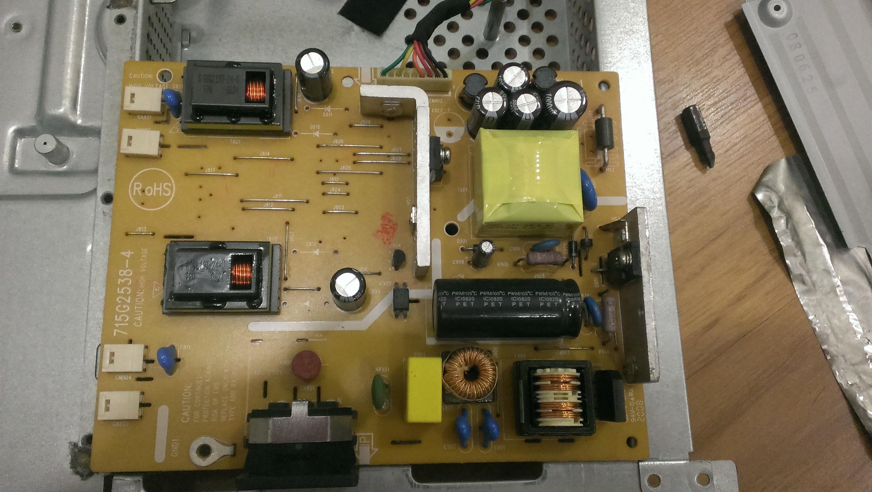

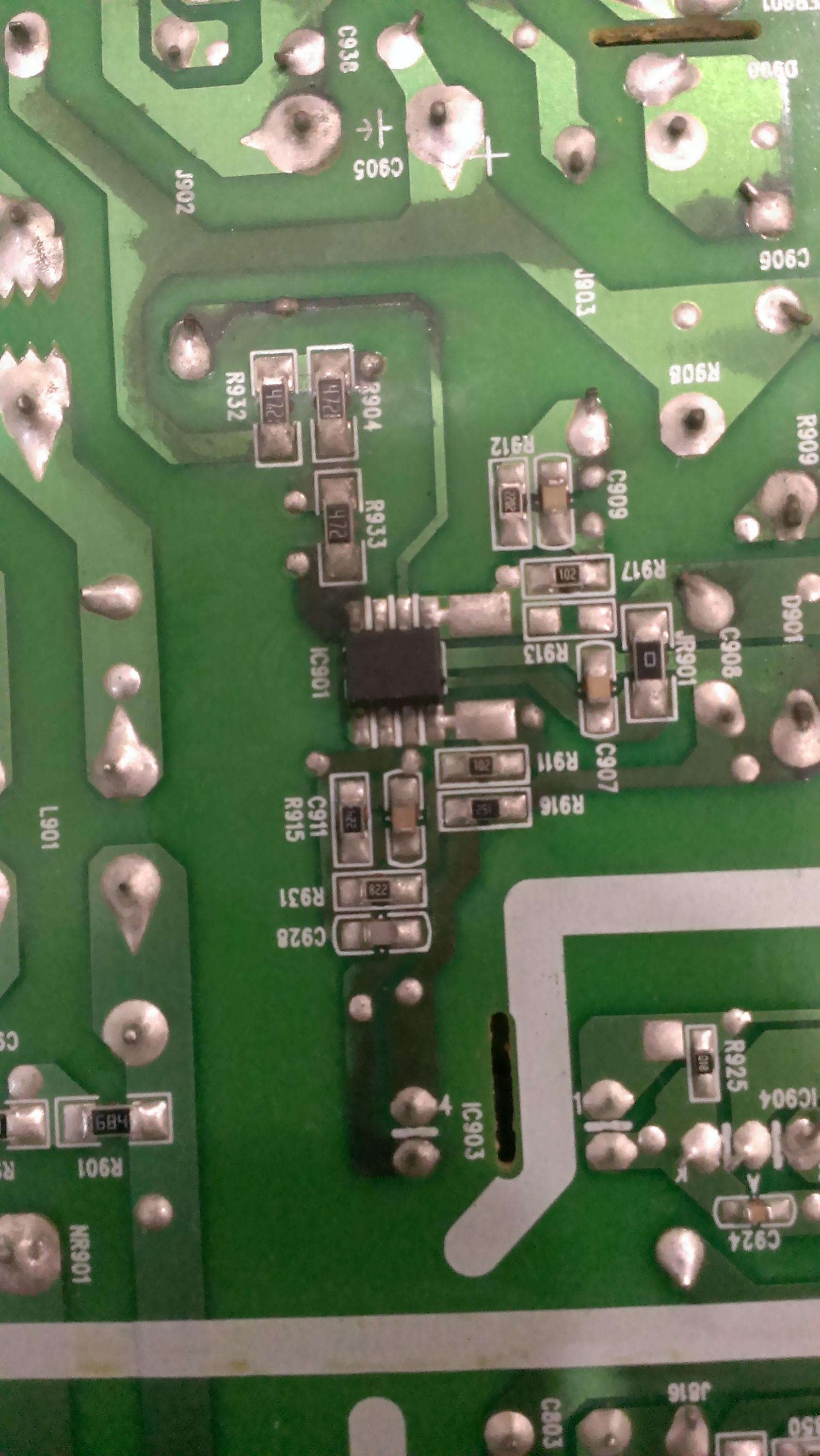

    I got this monitor, BenQ G900WD that does nothing when plugged into the mains, no response, no power whatsoever. So when i cracked the case open, the first thing i notice was a very faint smell of burned electronic smell, however on my initial attempt to power on does not burn, and no smell. On the back side of the power board, i notice there is some "dark" traces nearby the PWM chip (i suppose). On the front of the power supply board there isn't any bad cap based on visual judgement. I have check the power switch on switch with a multimeter and it seems to be fine.
    What do u think ?
    Thanks in advance

    please check main dc voltage after Smps trans.(on electrolyte cap (1000 mf))
