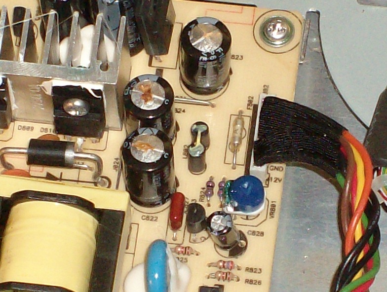

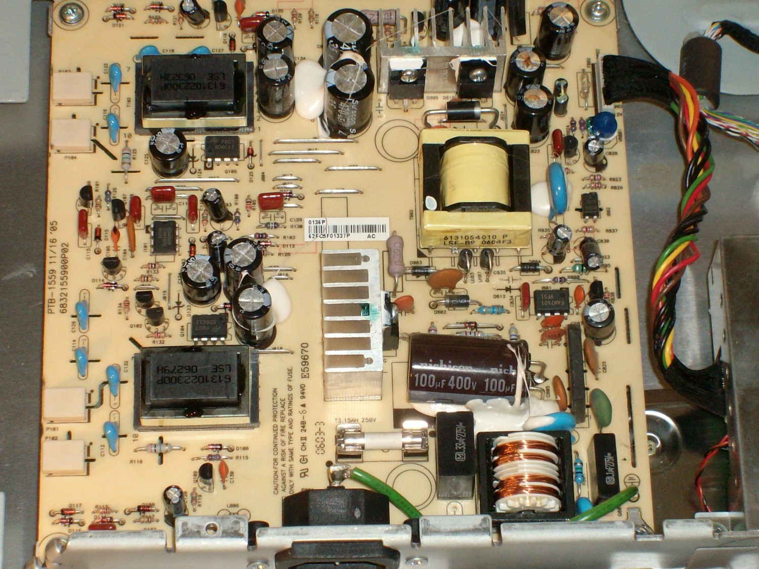

    Went dead, opened her up, saw this.
    Replaced the Crapxcons 1000uf 10vs with 10ZLH1000M8x16s and it works like a charm
    HP vs17es use the same power supply and board, if I remember right.
