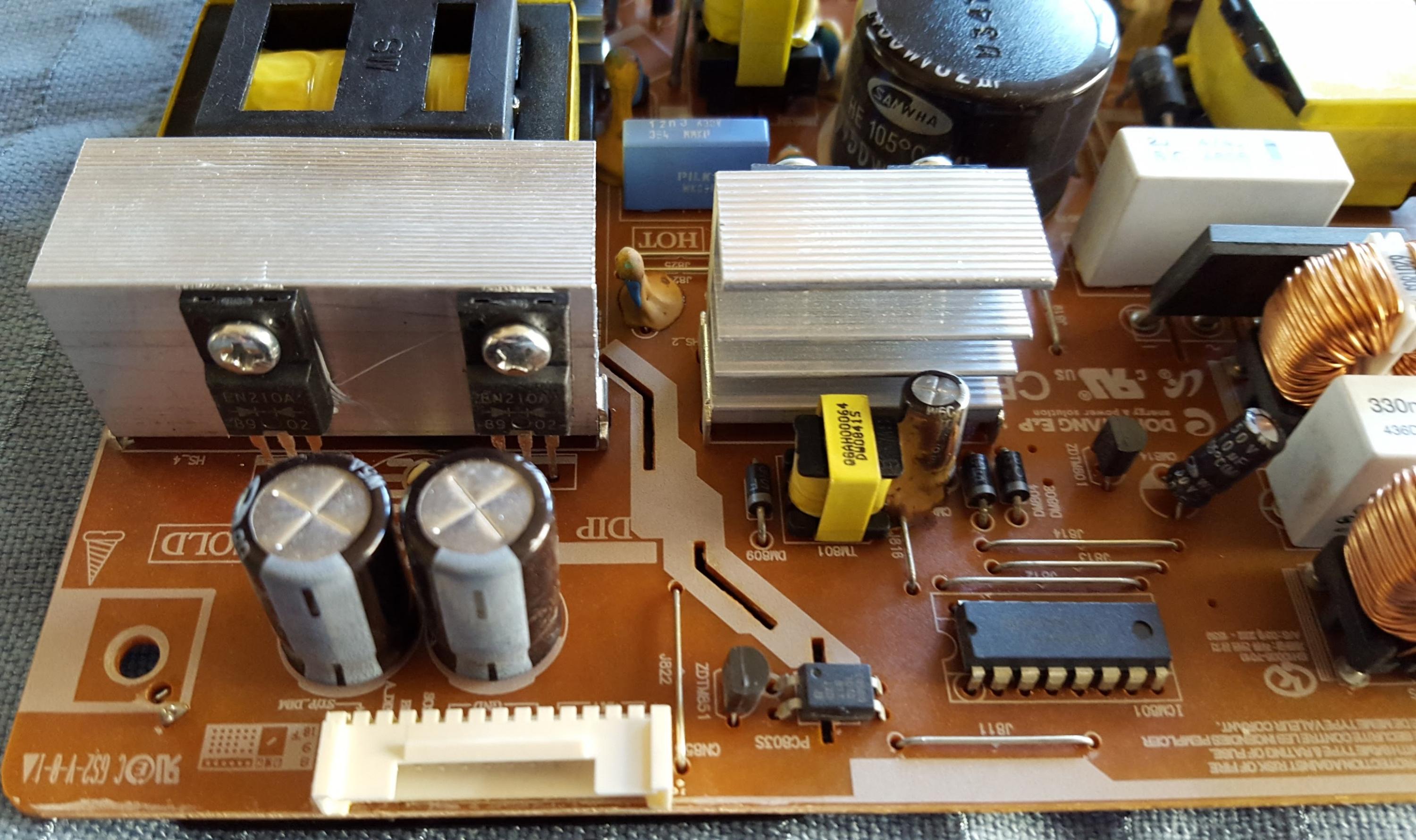

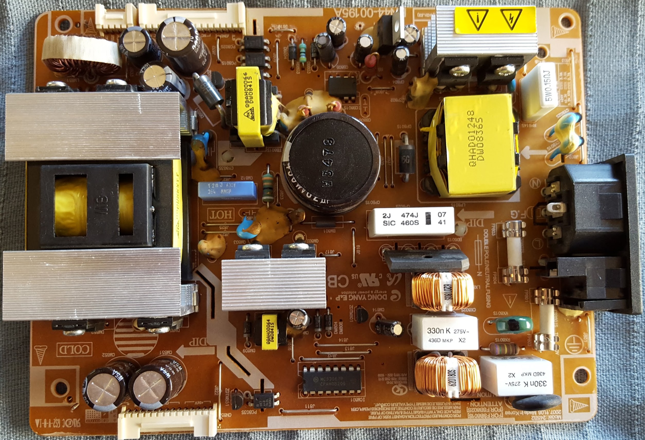

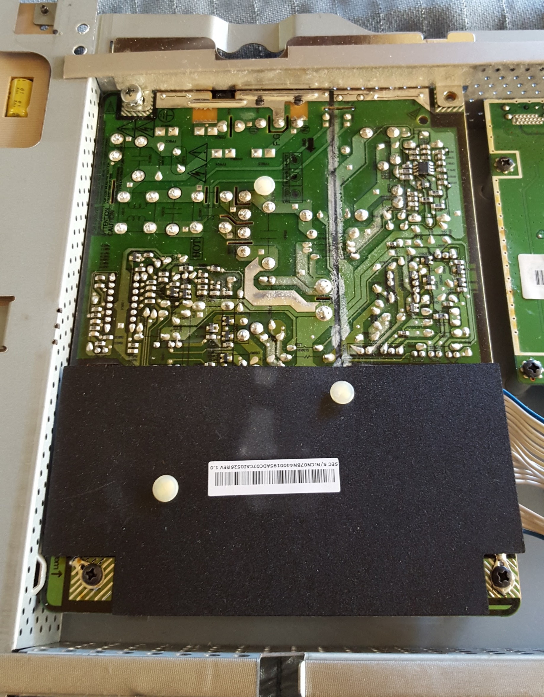

    I have two Samsung SyncMaster 2493HM. One is working just fine but the other monitor started going to a black screen for a few seconds over the past 2 weeks. Yesterday it wen't completely black with the blue LED power light on. I unplugged it and left it off overnight. I powered it back on and it worked for 15 minutes.
    I found a thread on Badcaps that said replacing the capacitors may fix it. I took my monitor apart but do not see any busted capacitors. I've never done this before so I am probably over looking something. Can someone check out the pictures I've attached? Would you recommend me changing all the capacitors out? Do you see something else I should try?

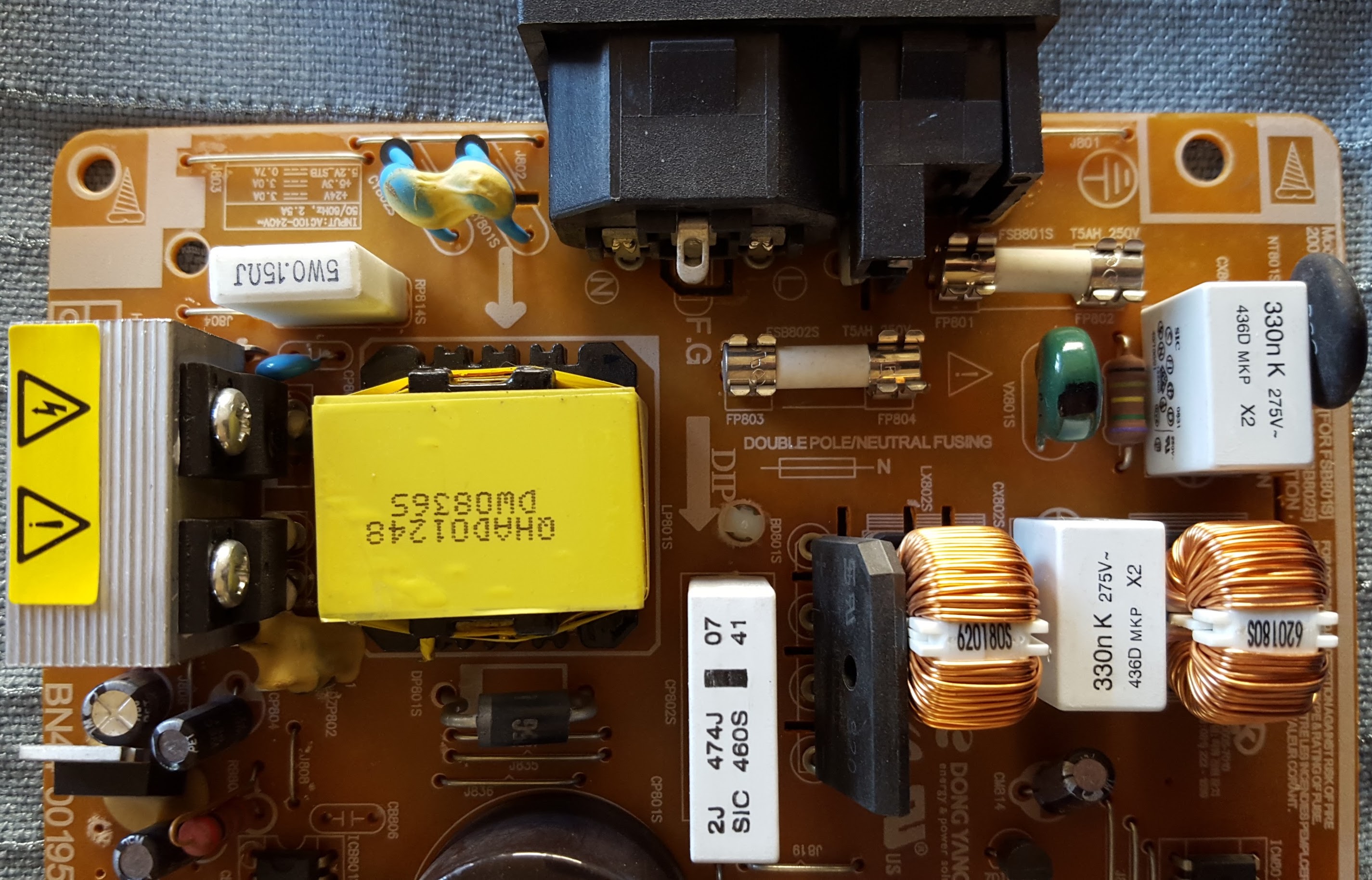

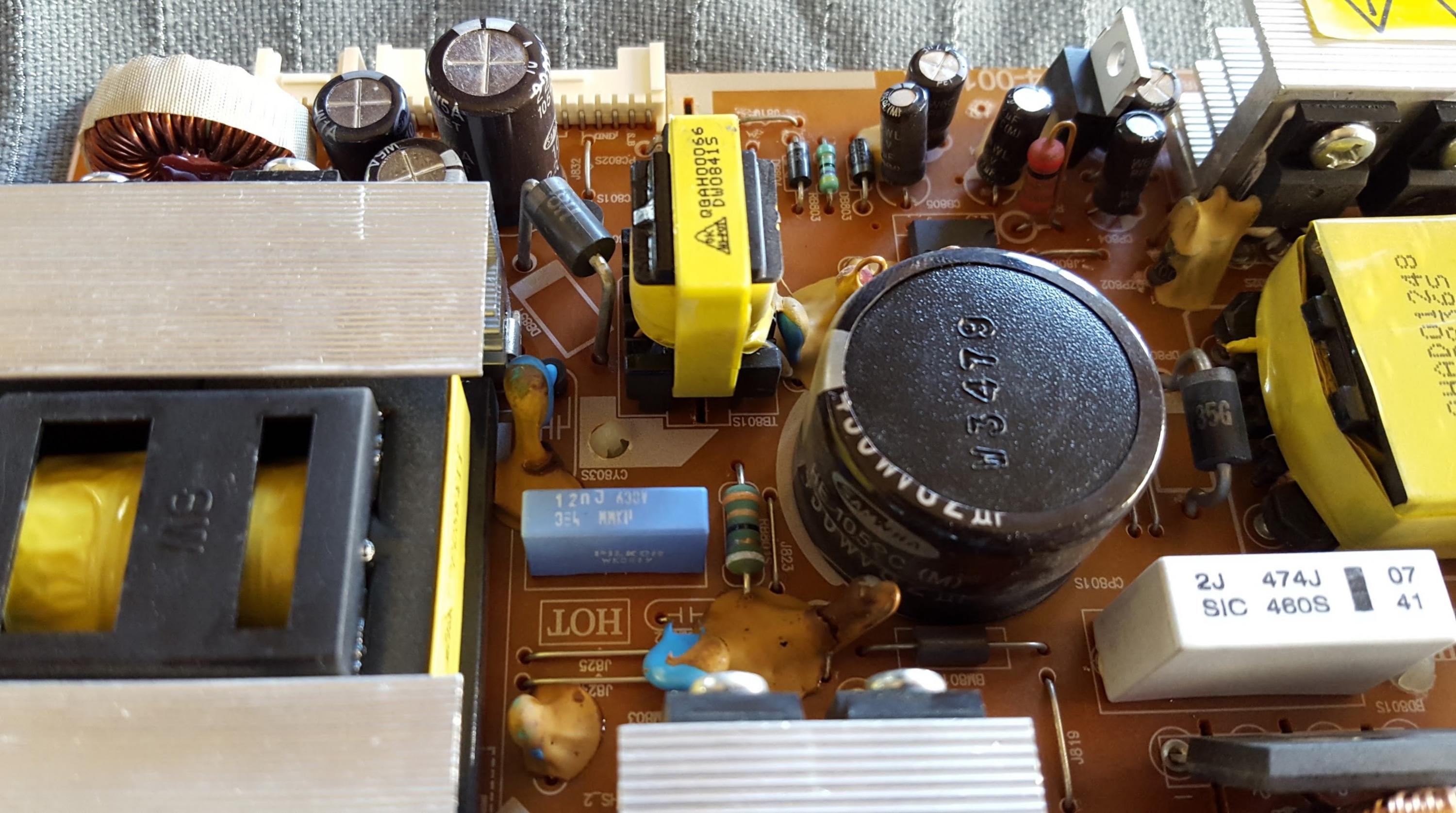

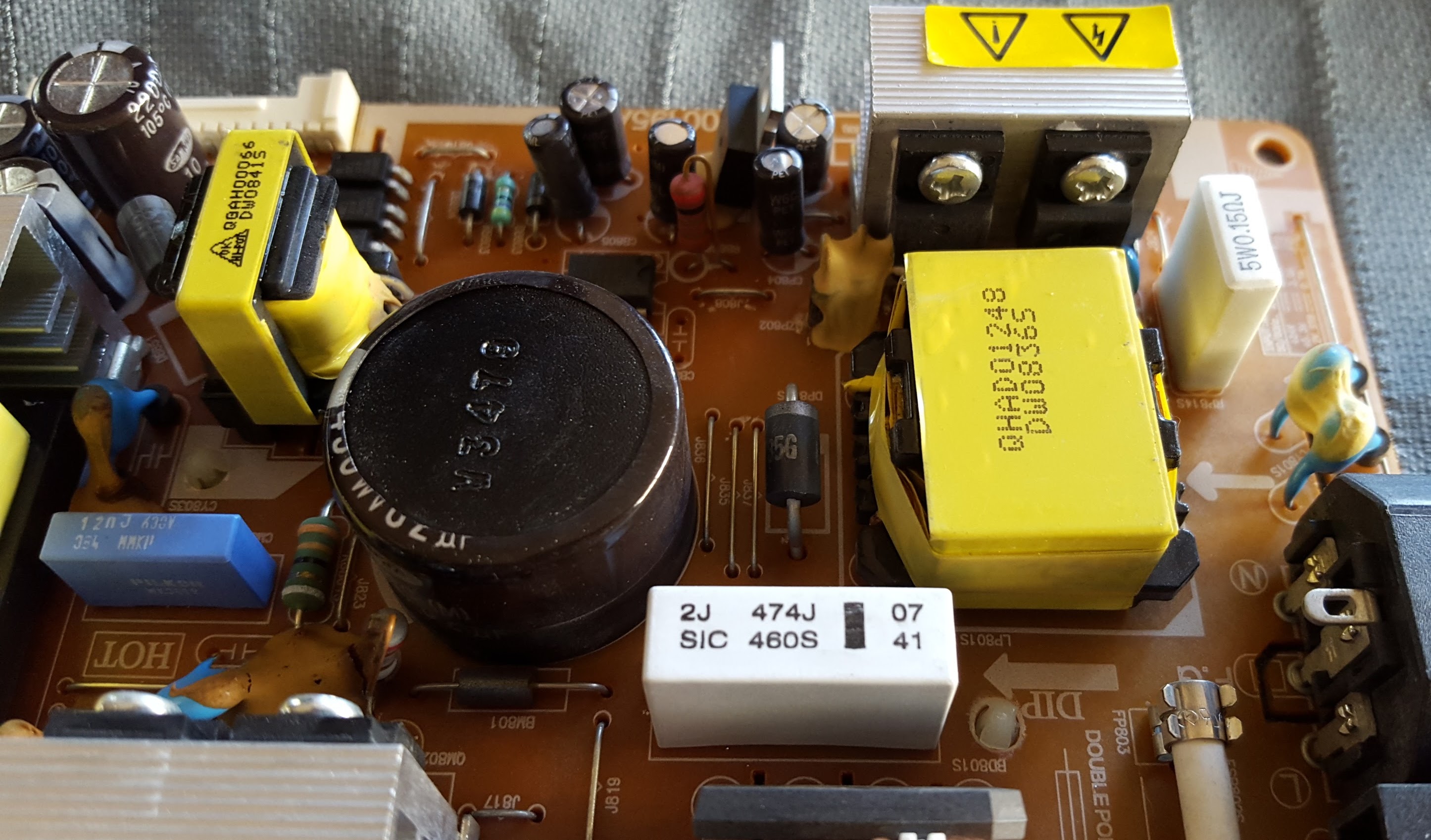

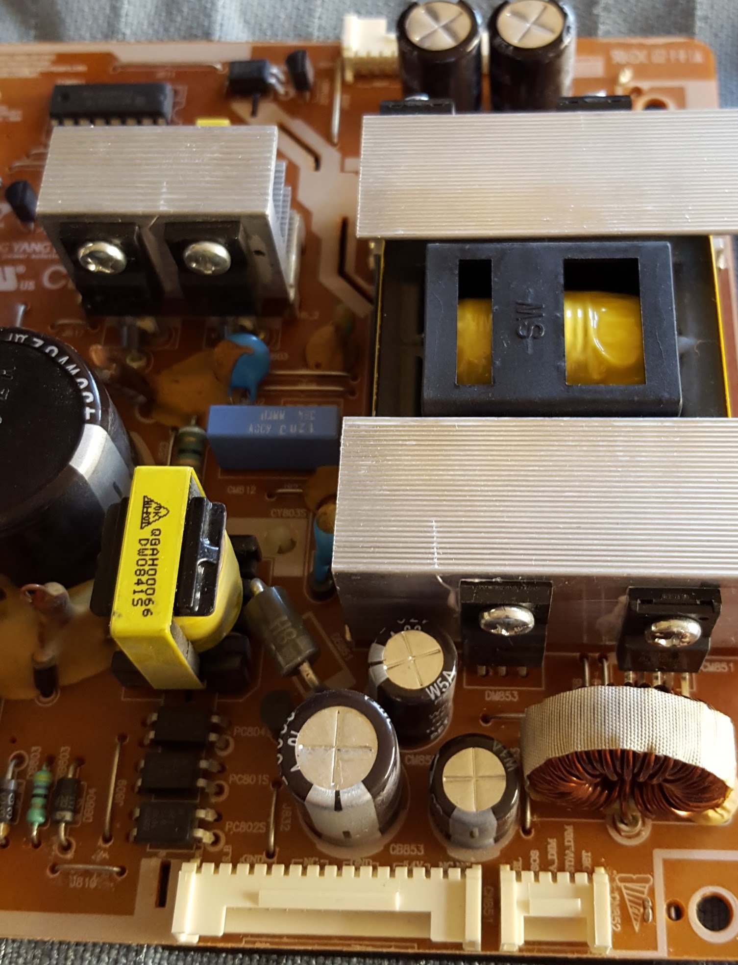

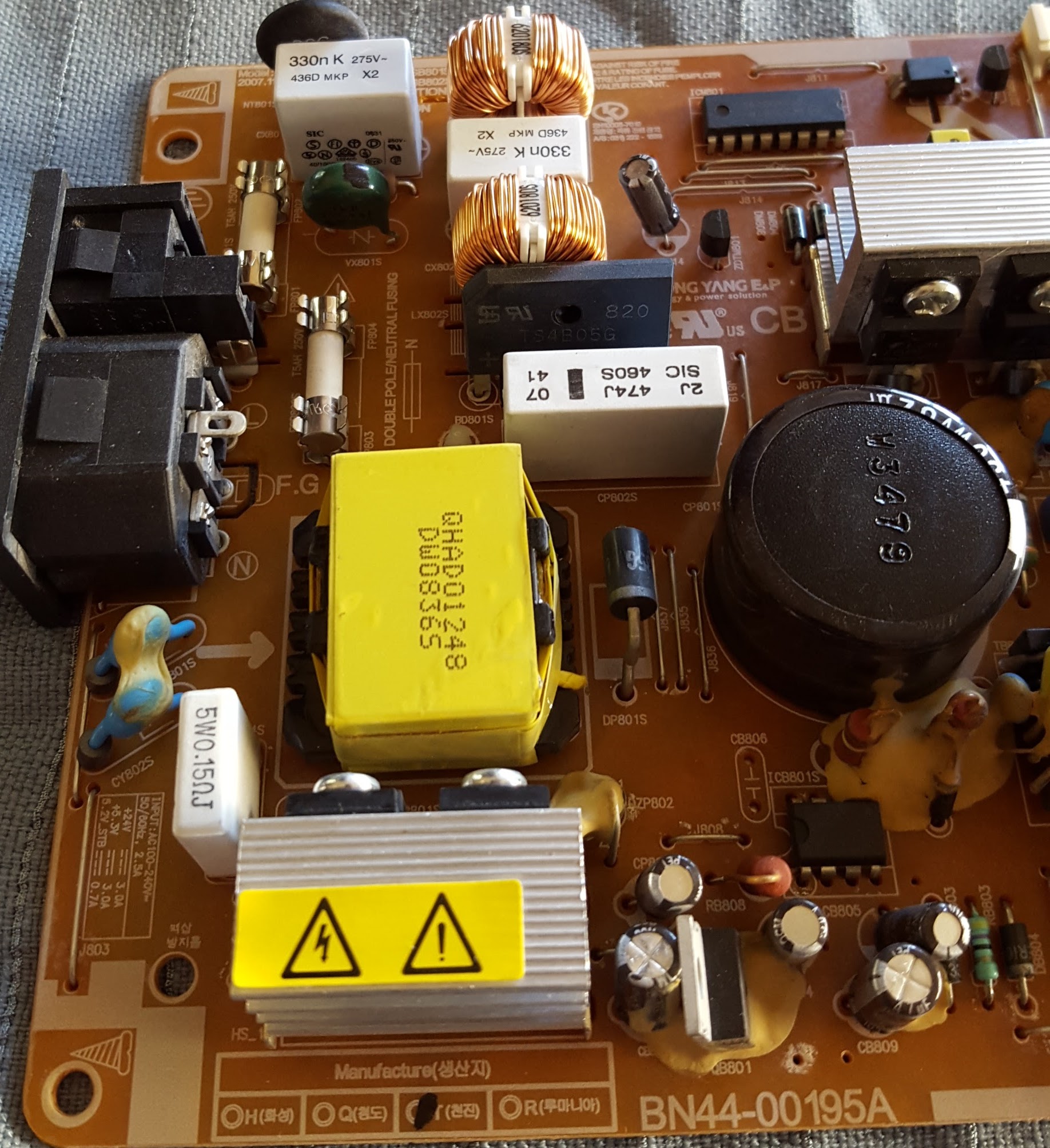

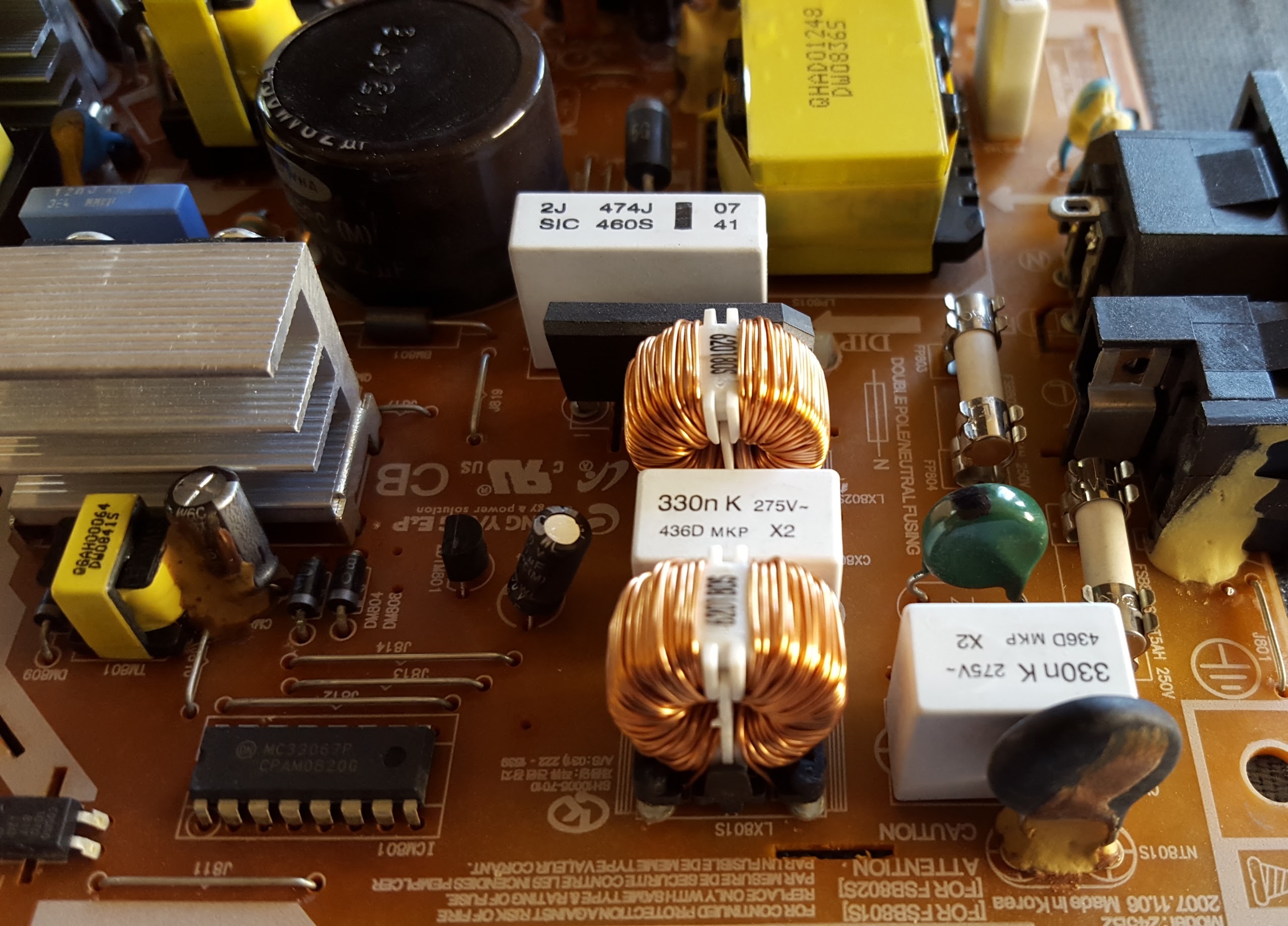

    First, you will need to remove ALL those glues, I can see one of the small disc cap by the MOSFET QM802 is burnt, the small transformer with DW0841S may also be damged by the glue.
    Those glues become corrosive and also conductive.
    BTW, you should also check the capacitance of the white rectangular cap with 474J SIC 460S printed on top to see if it still has the correct capacitance.
    This is what bad glues can do to the boards.

      What is the best way to remove the glue from the board? Once I remove it do I need to put anything back on?
      I am trying to find the small disc cap by the MOSFET QM802. Can you tell me where it is? lol Sorry so many things in these screenshots.
      Could removing the glue fix the possible damage done to DW0841S?
      Do you know what the correct capacitance is for the rectangular cap?
