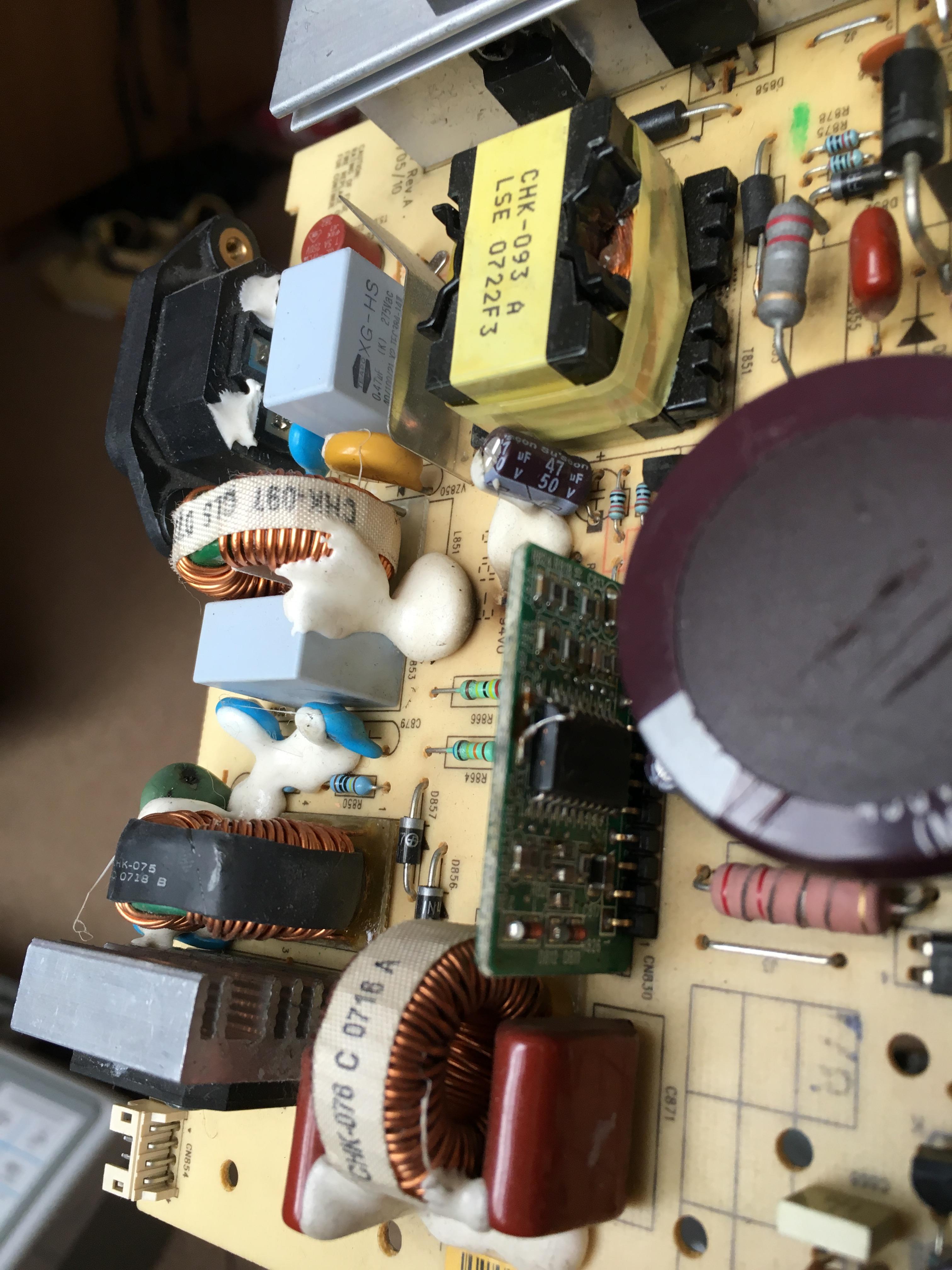

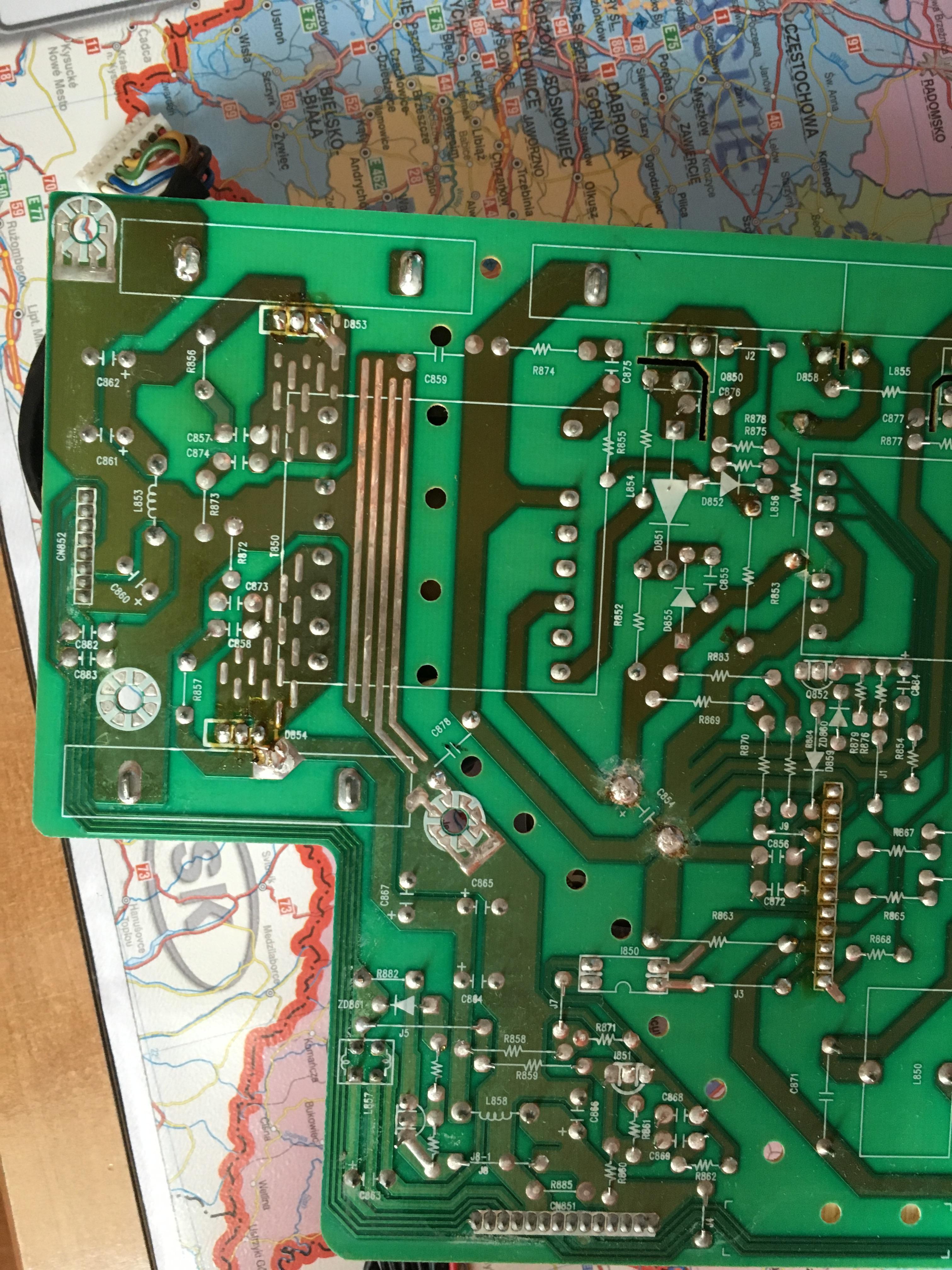

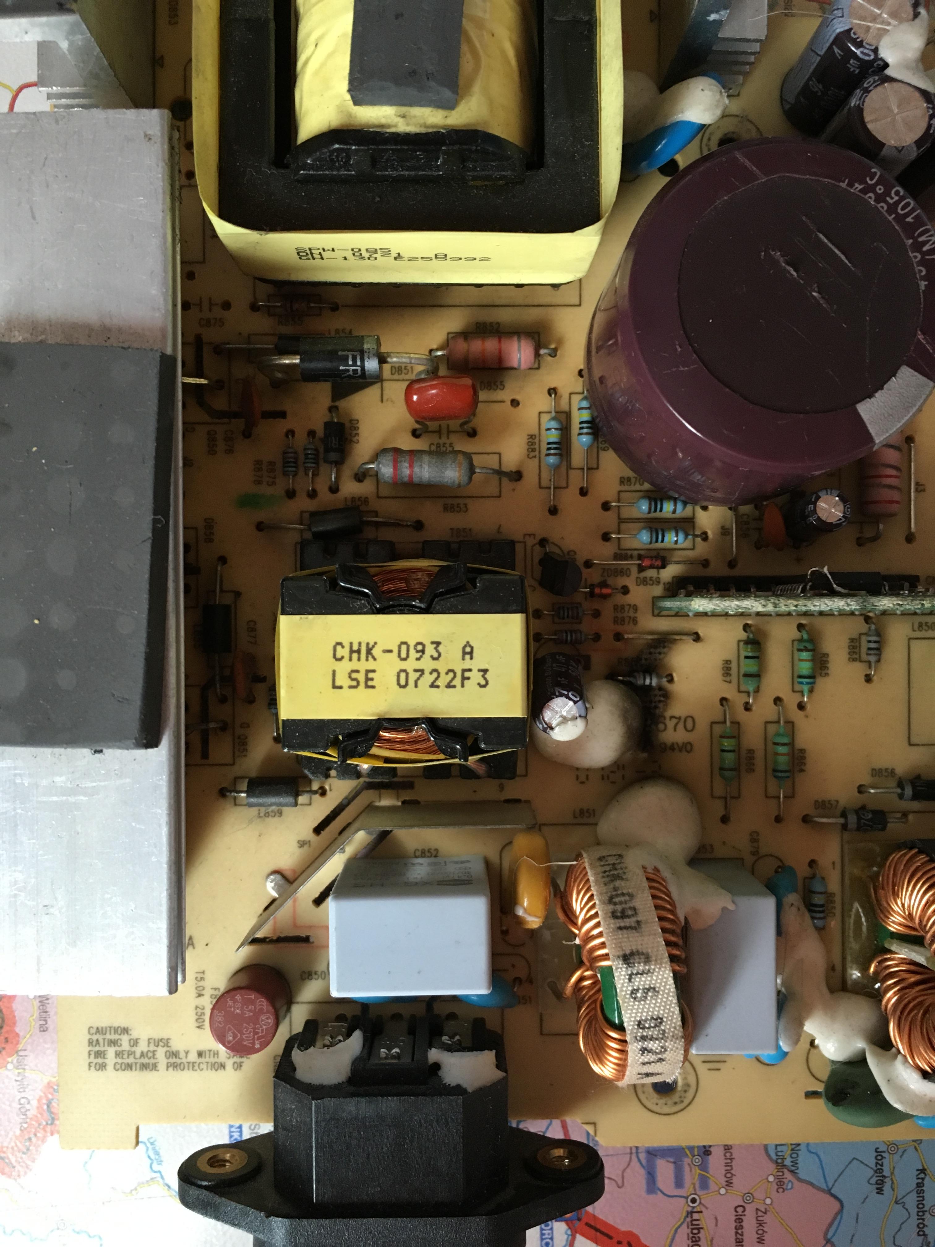

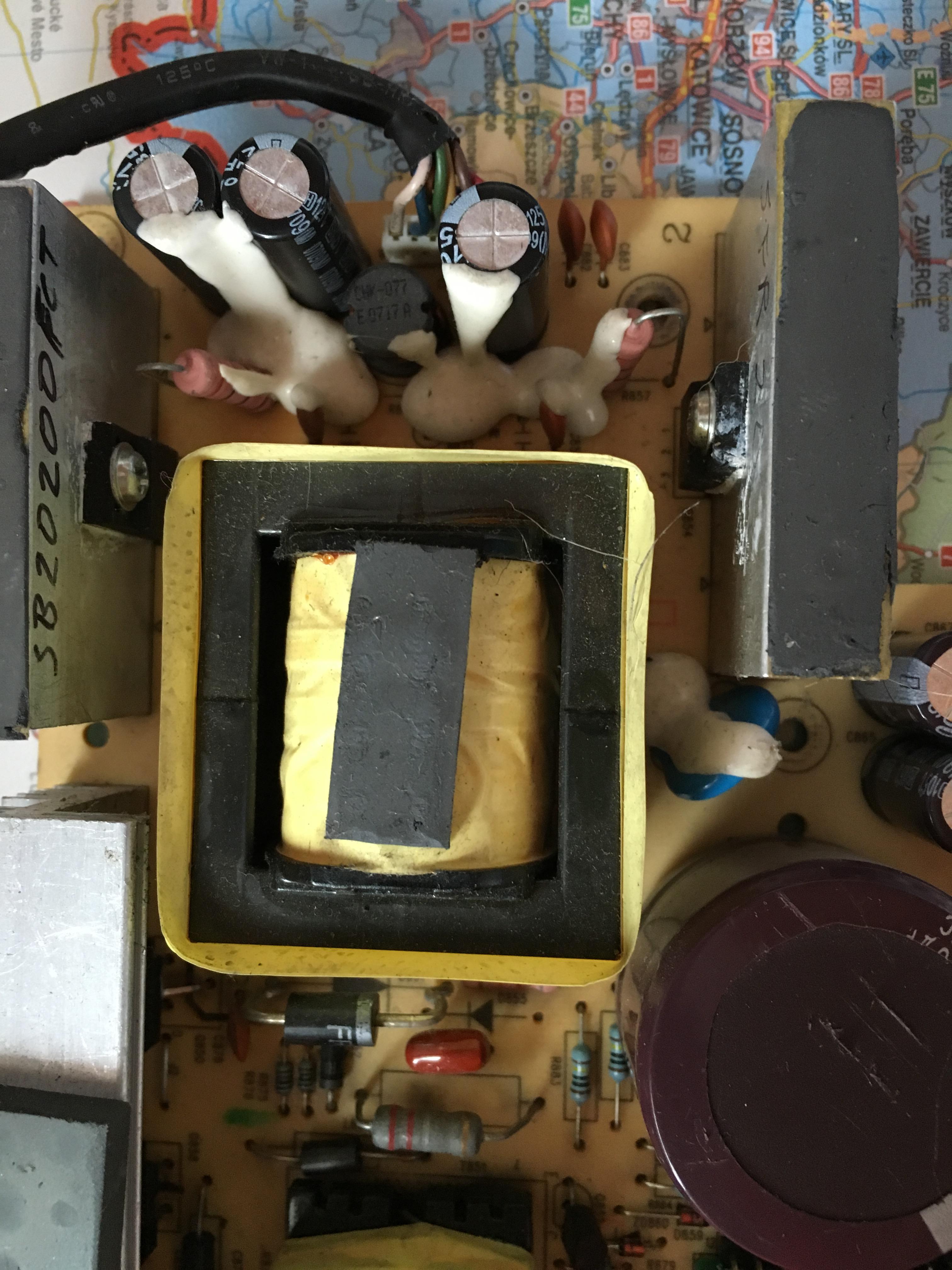

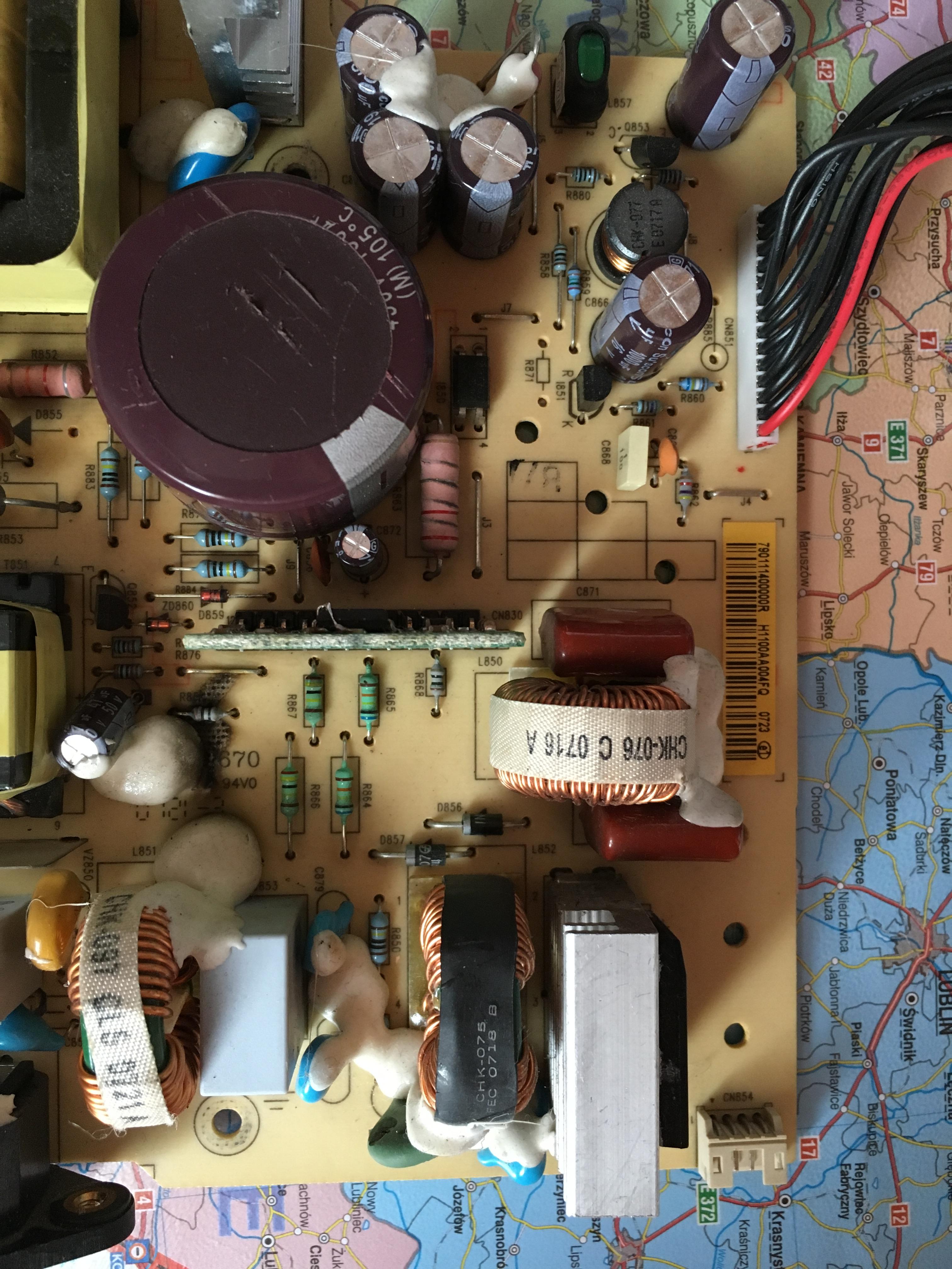

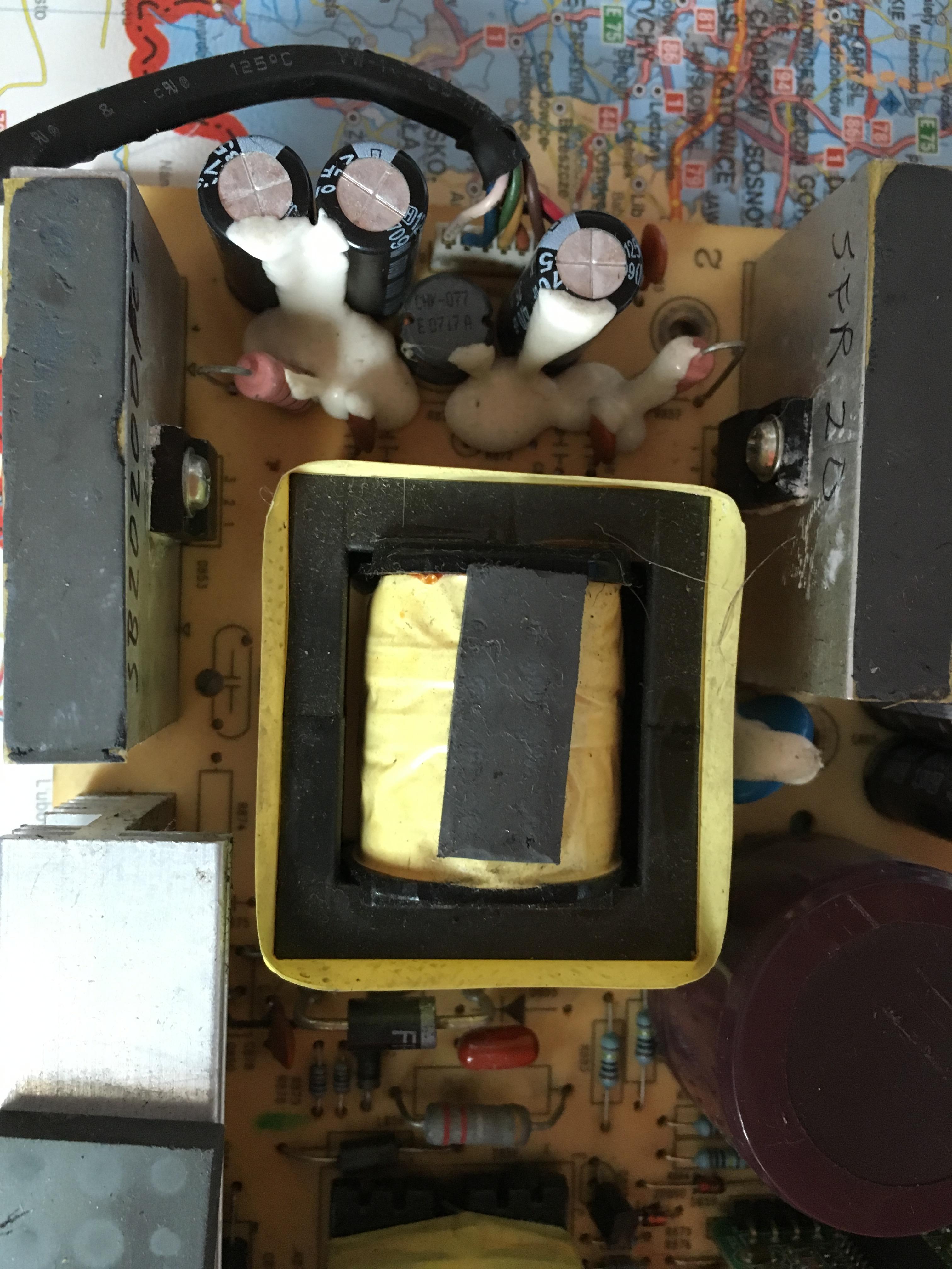

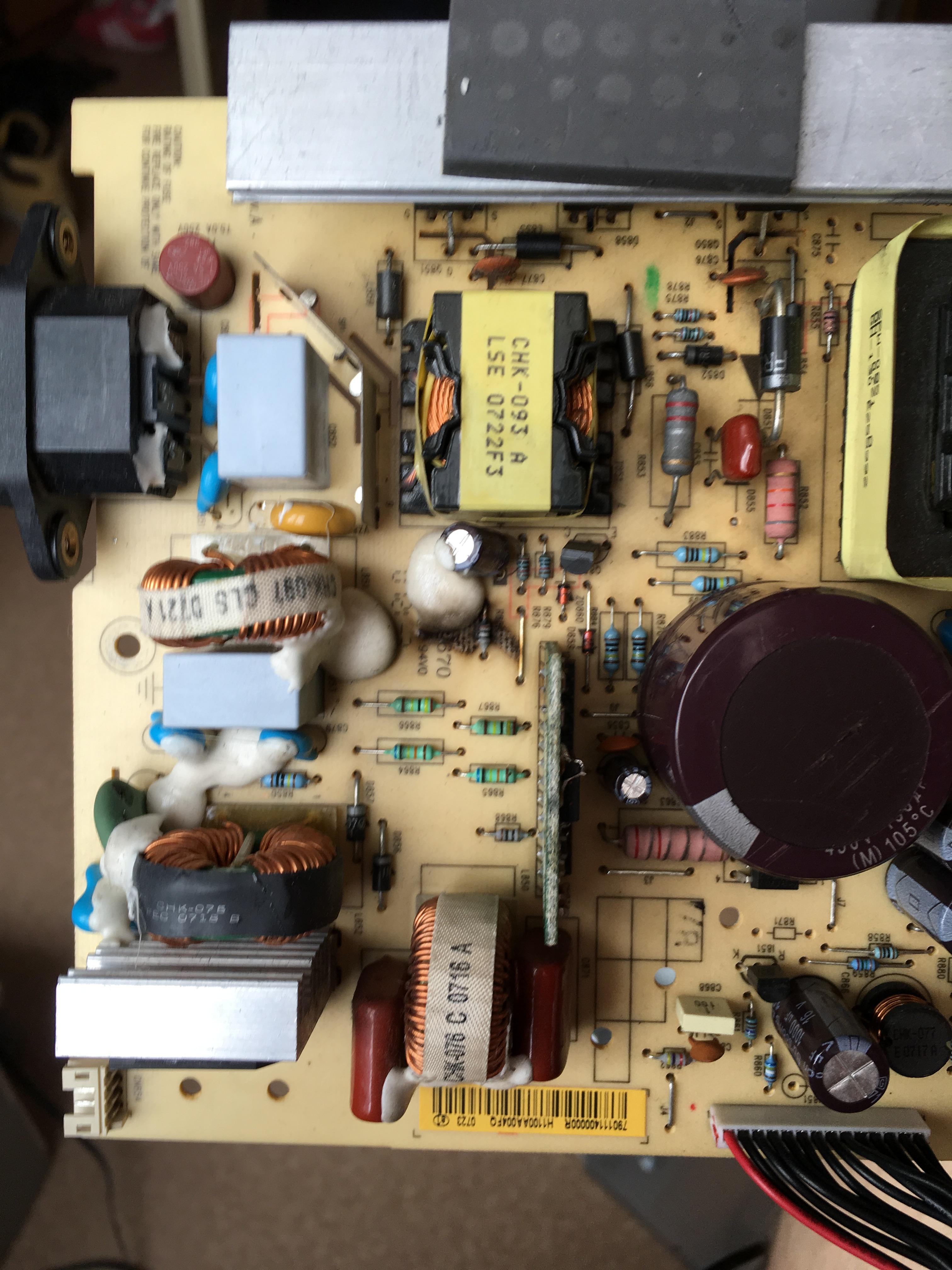

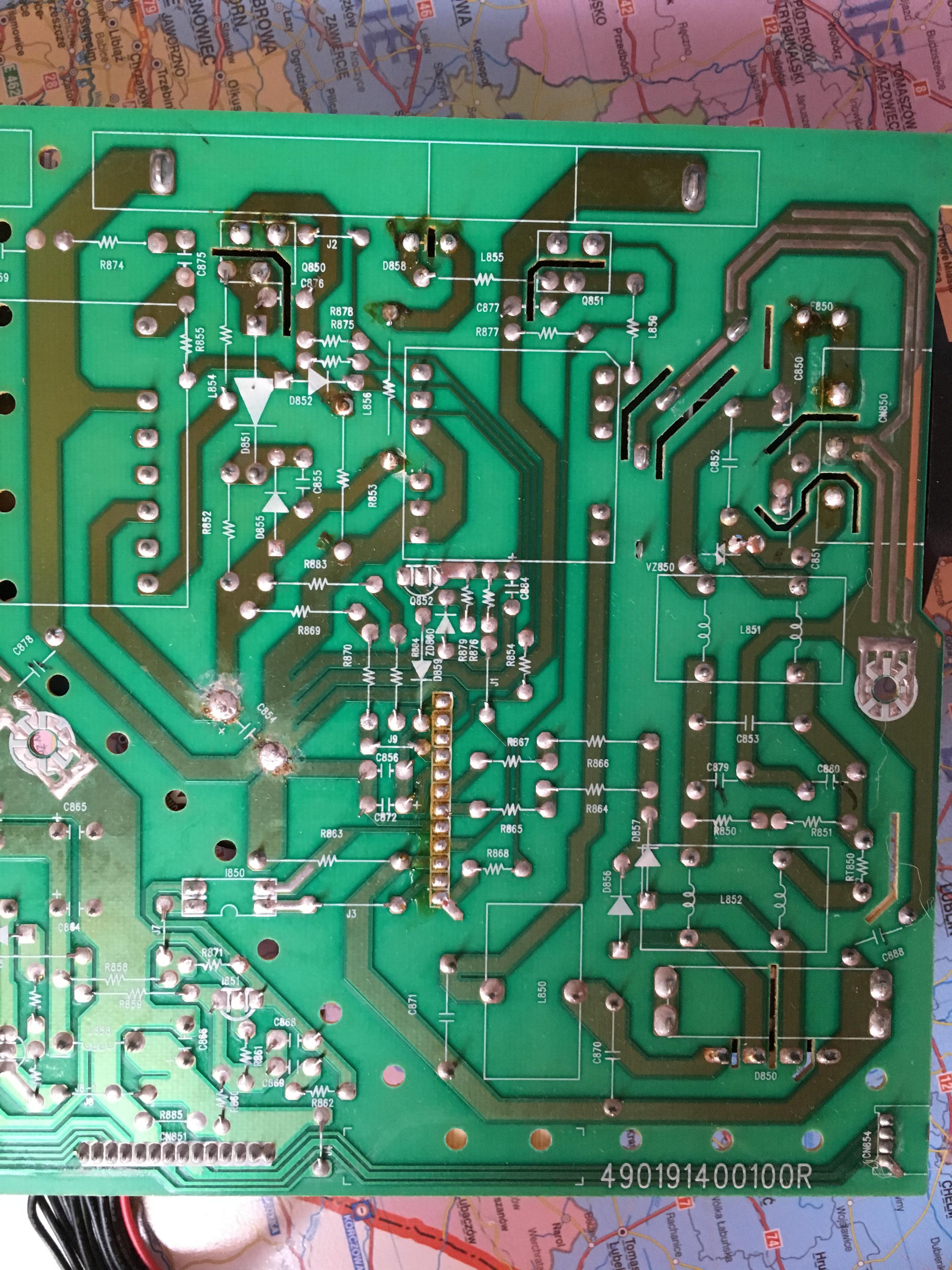

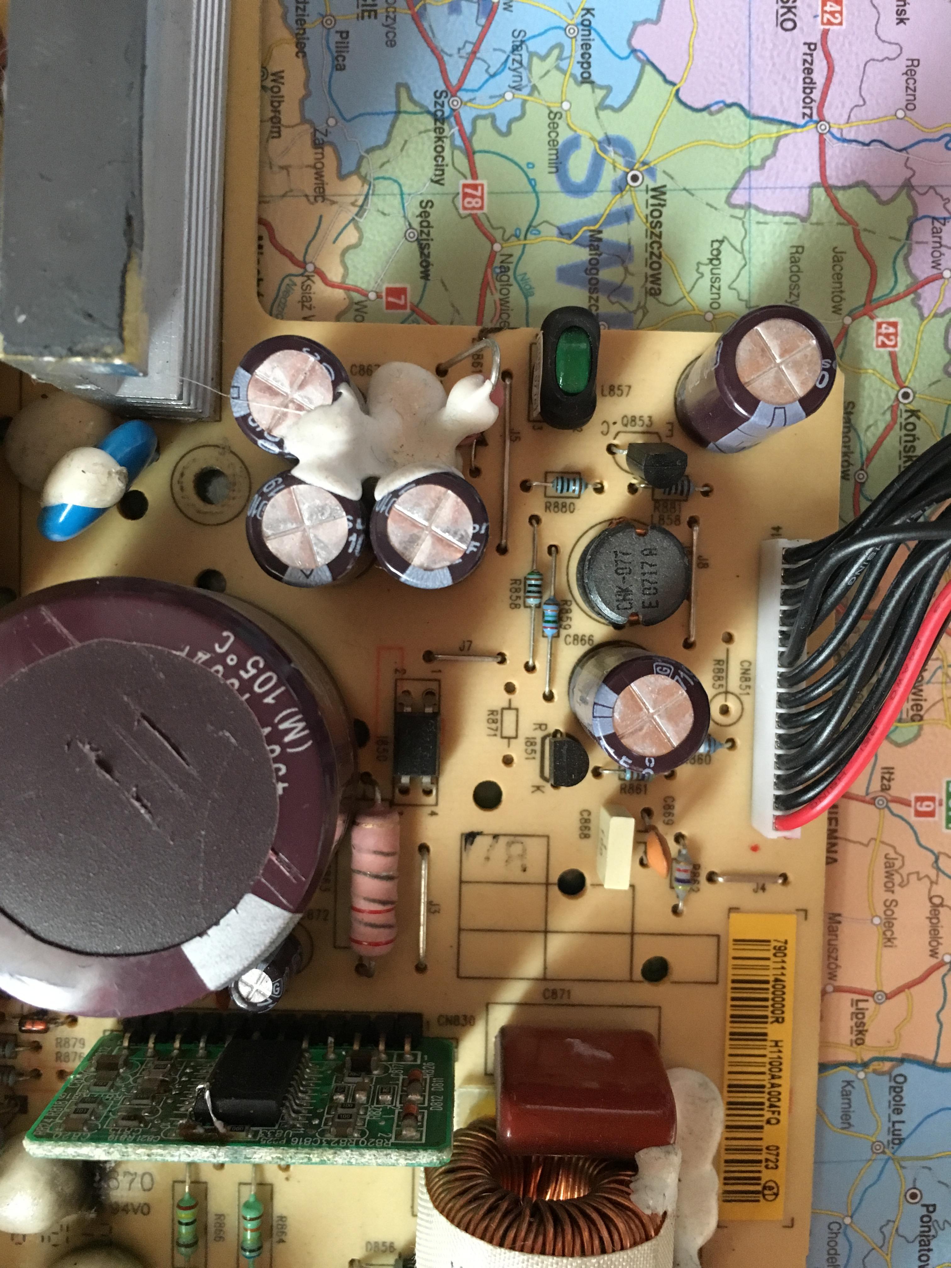

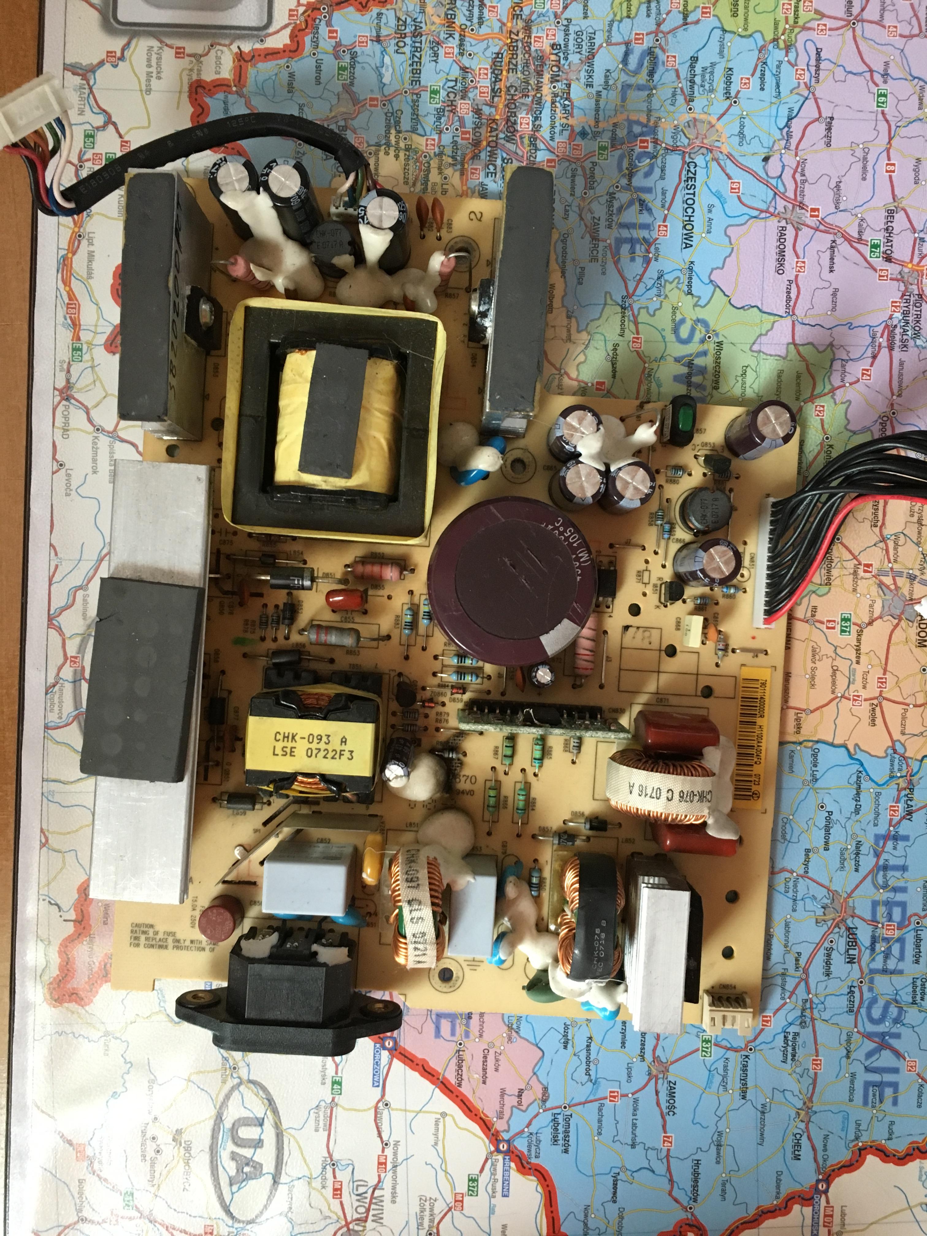

    Hi everyone, at the beginning I apologize for my language - I'm Polish.

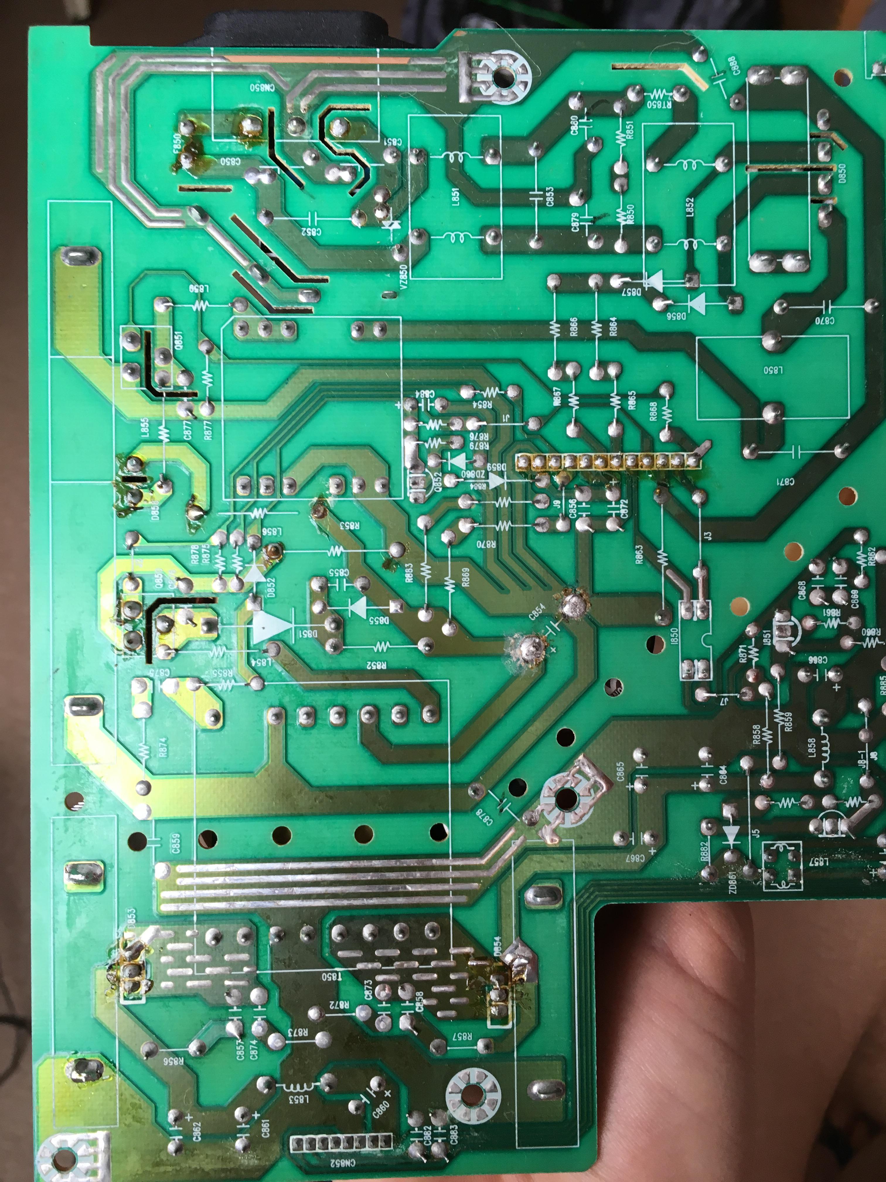

    I got the monitor from a friend. When using the monitor went blank. No LED blink, no reaction. He carried to the site, and he heard only "PSU is broken".
    Technician tried to fix something - I see flux.
    I not picked up the elements (i don't have now solder - was in the house)

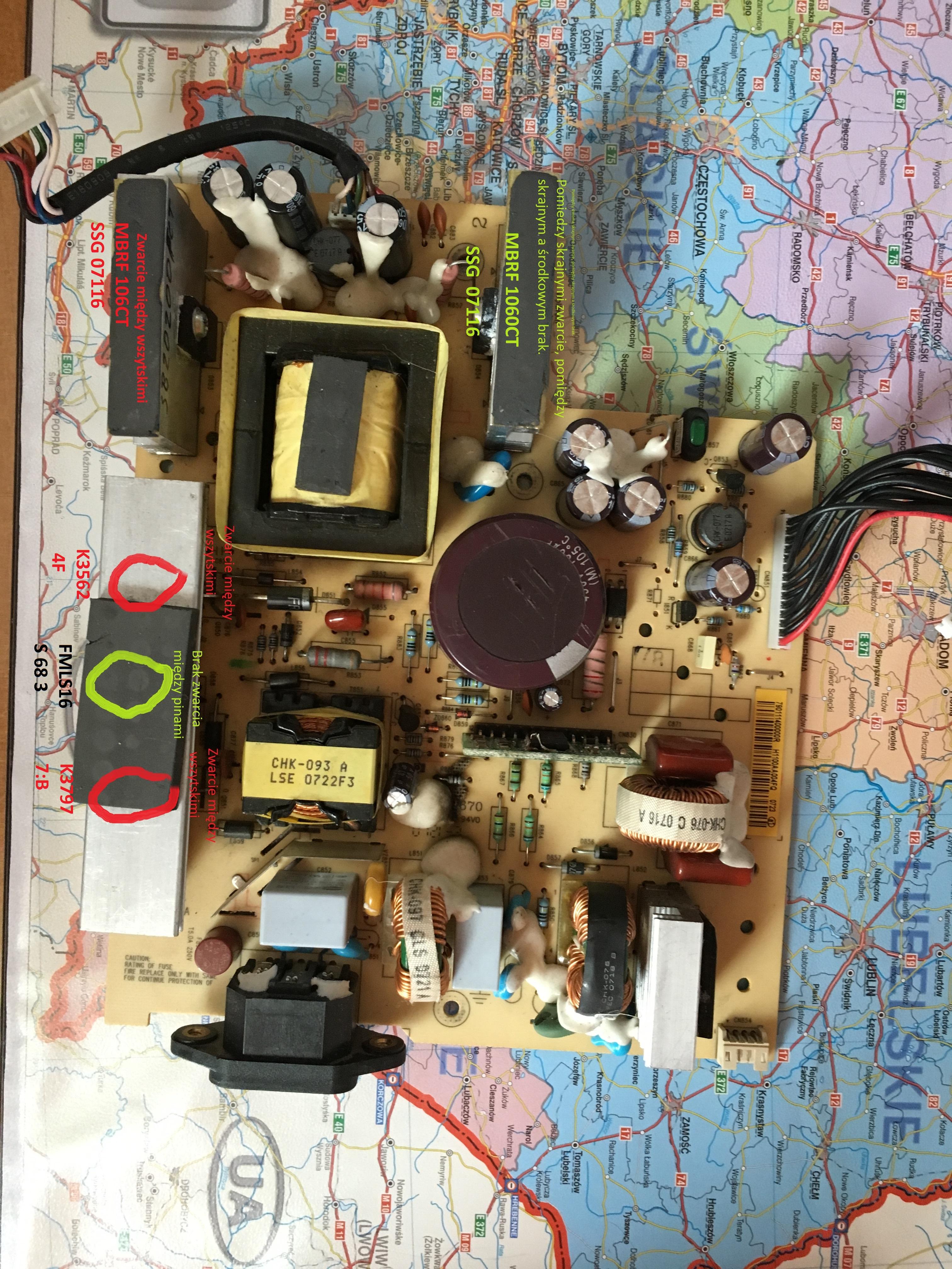

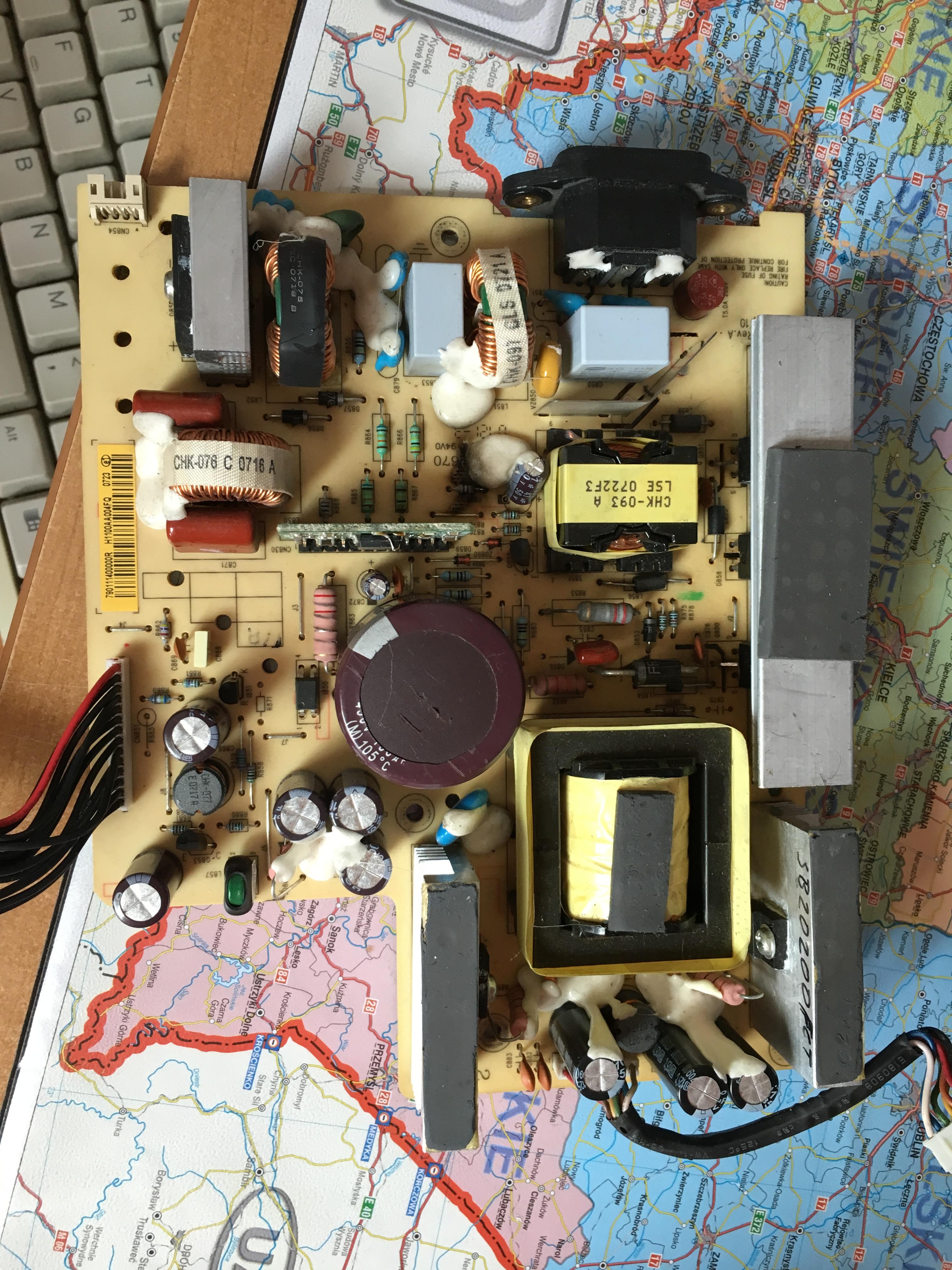

    I opened the monitor and took pictures. I measured transistors. For me - 3 have shorts. (Red on the foto have shorts between all three pins). Green don't have shorts.
    Diode bridge is short (+ and -). I think, i musst first pick up diode bridge and on the table check whether diode bridge have short or no.

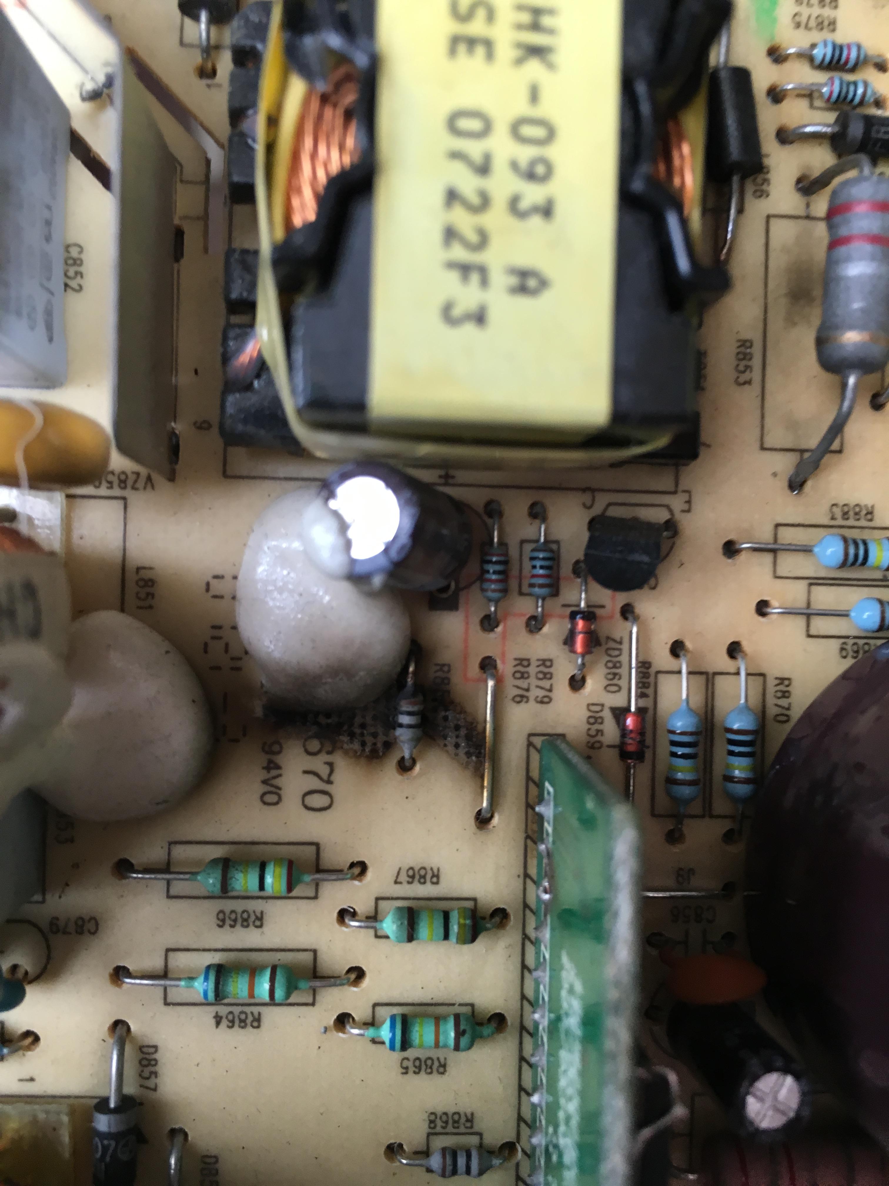

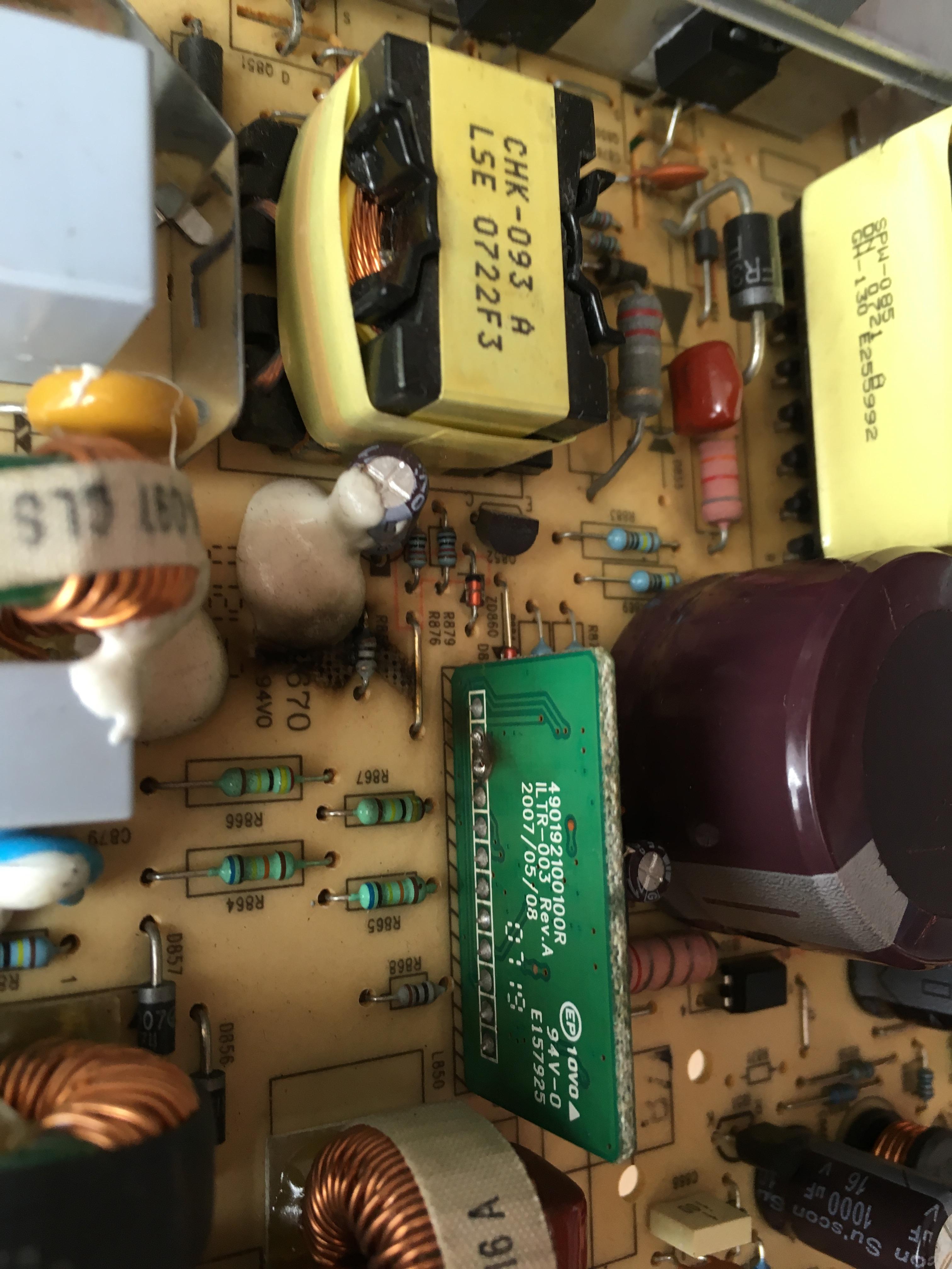

    I checked - fuse is broken (5A). At the picture we can see scorched resistor ( R85_ - I can't read). Here is list of red and grean elements:
    -MBRF 1060CT SSG 07116 (x2)
    -K3797 7:B
    -FMLS16 S 68 3
    -K3562 4F
    PSU: ILP-004 Rev A
    Panel: lm240wu3
    Inwerter: QLI-002 Rev B
    MB: ILIF-035 Rev A
    Caps visually they are ok.
    Please suggestions how to fix it.

    you have more problems than the 3 burned tranzistors you also have more badly burned stuff on the psu take a look at the attachament i have circled them in red

      Re: HP W2408 - no live, no reaction
      Thank you for your answer!
      I've seen these places. What could be the reason?
      I would like to fix PSU. Next week I peak up transistor, diode bridge and
      I'll check. What else should I check? Whether the cause could be the capacitor next - its capacity has decreased and sailed a higher current?

        You can add photos with "manage attachments" button - how to do that is shown here: https://www.badcaps.net/forum/showthread.php?t=1868
        dragos2009 is right, the burnt area by that glue and R8xx? is bad too. You will need to cleanup and replace that resistor at least.
        Also those 2 pins on CN830 board maybe damaged, you need to check them.
        If the main bridge is shorted it probably blew the MOSFETs. When they blew they probably took out the controller on the daughter-board at CN830. It looks like someone tried to repair a trace to one of the IC pins but the controller itself may be blown.
        I think you're going to need a schematic to fix this one, but I can't find one.

            If you can clean up those resistor under the glue with alcohol you maybe can read the code. You will need to clean up the soot from the board too in case of electrical leakage.
            If the resistor is burnt and open circuit, and the markings are too damaged, see https://cdn.badcaps-static.com/pdfs/...69b55c45bf.pdf for ideas on how to find out what value it was.

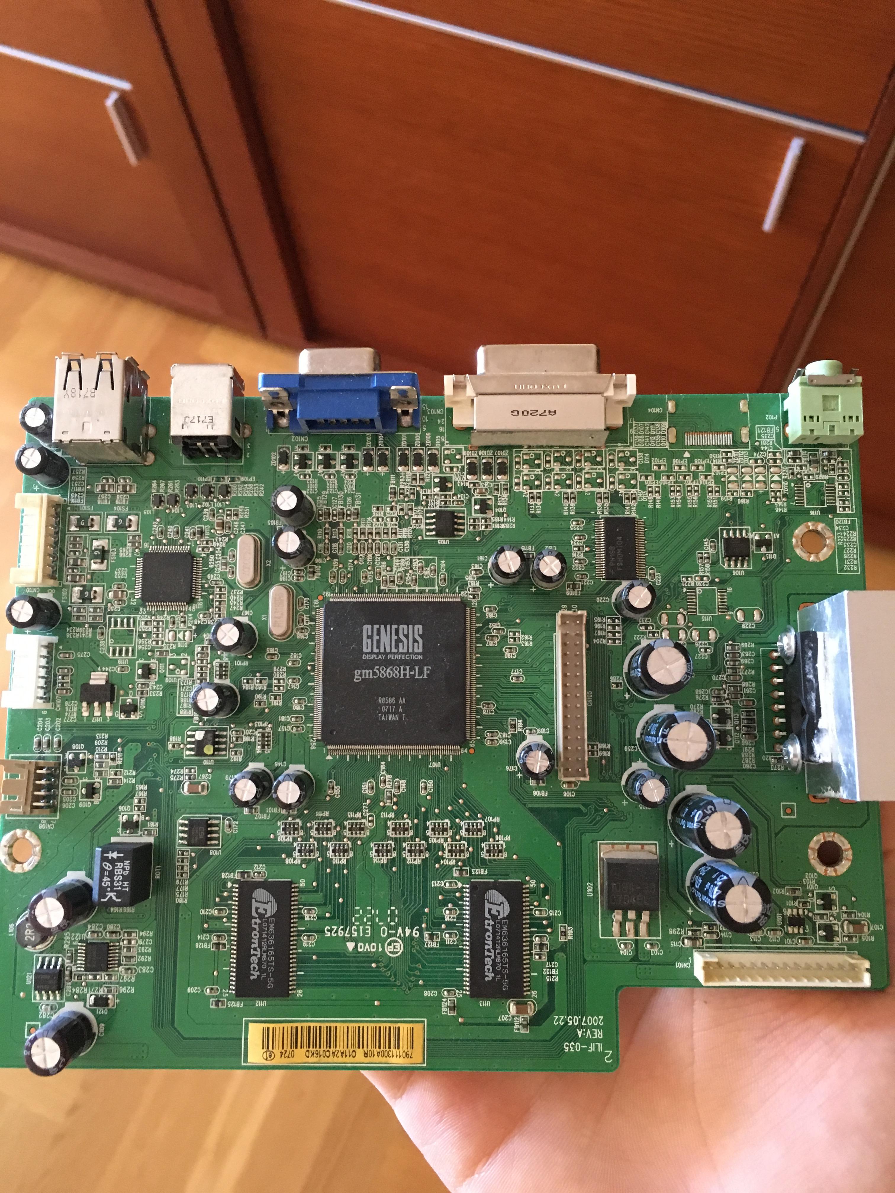

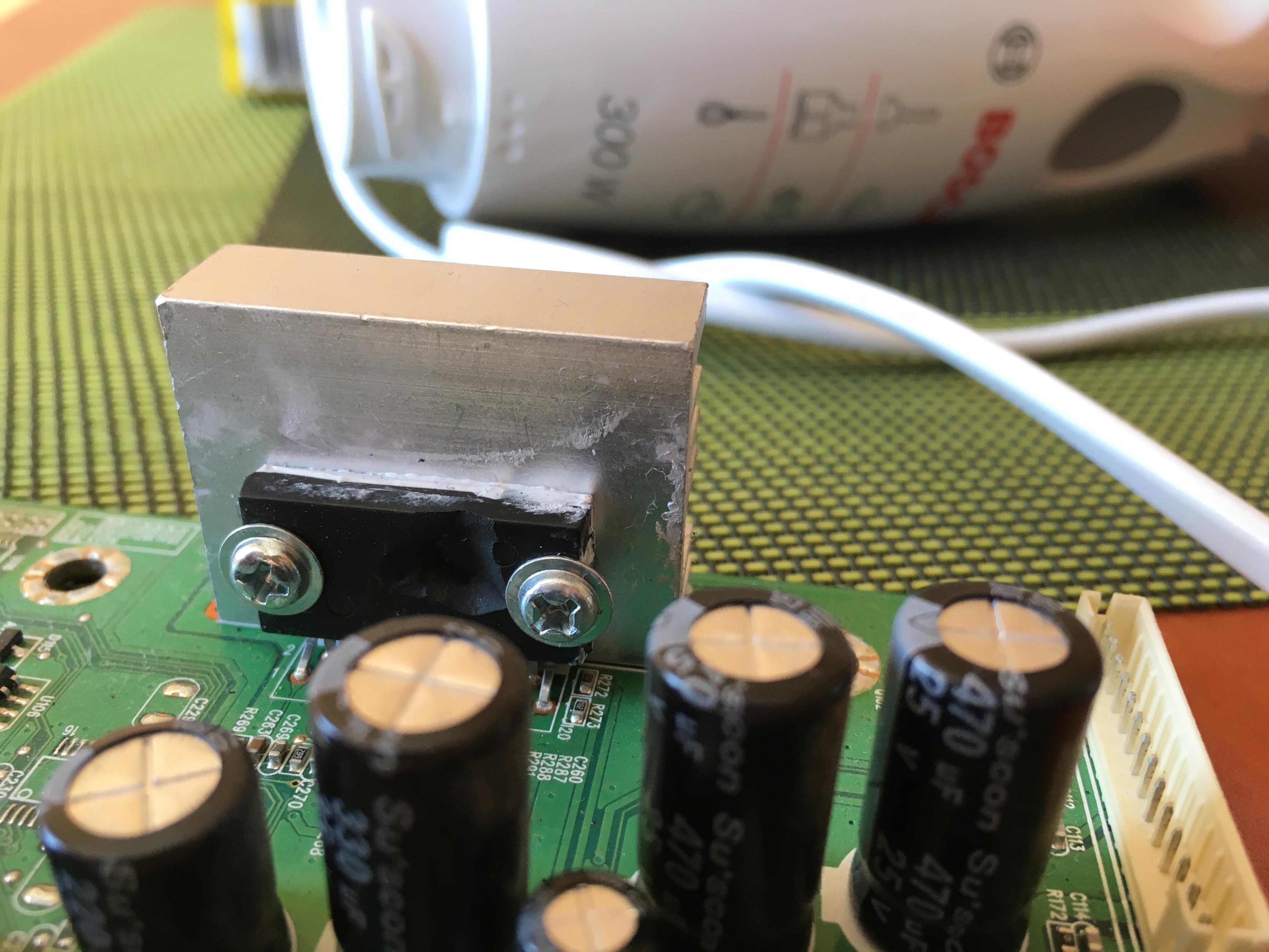

              Hi everyone. I buy new PSU. Anddddd.... it dosn't work. When i turn on i hear "boom" and i fast turn off. Here we are...
              http://obrazki.elektroda.pl/4393234400_1473245665.jpg
              http://obrazki.elektroda.pl/9850086500_1473245671.jpg
              On the main board damaged the chip. Unfortunately, I do not know markings chip
              I do not know why it happened. short-circuit was not .
              if anyone knows indication of this chip ? I read only TD ( A ) ....
                Ok i know it's TDA 8496L. Can I unsolder chip and turn on screen witout TDA? Why chip expolde? Ehh...

                  It's just the audio amplifier chip, so probably not critical for operation. You can probably remove it and test without it.
                  Perhaps when the old PSU failed, it damaged the chip, now when you test with a new PSU it blew up as it was shorted from damage already?
