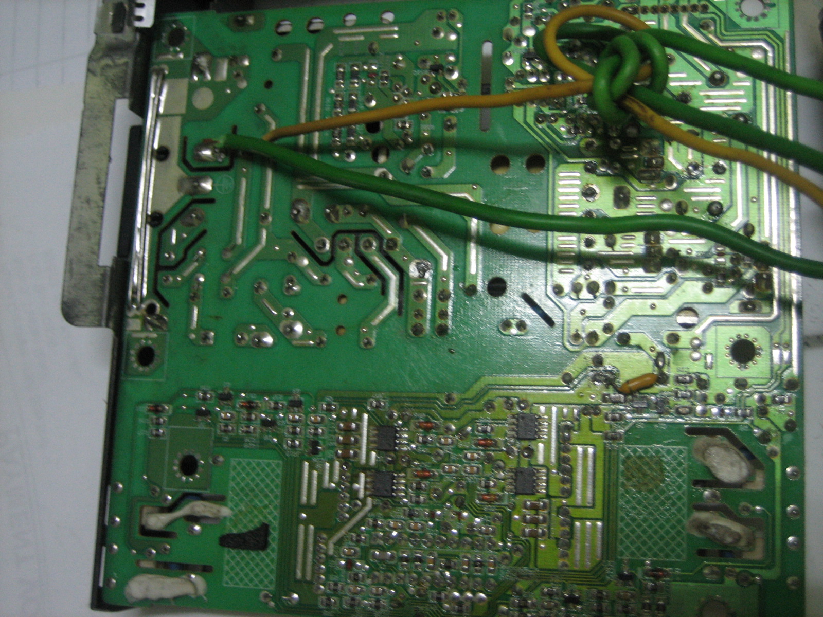

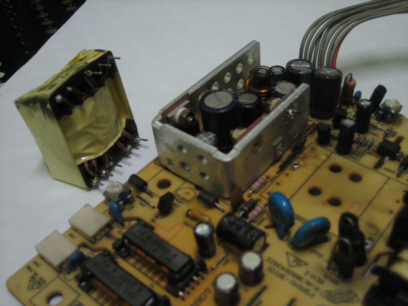

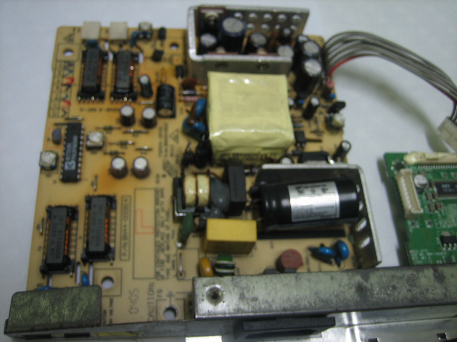

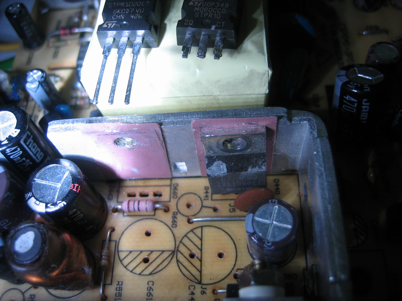

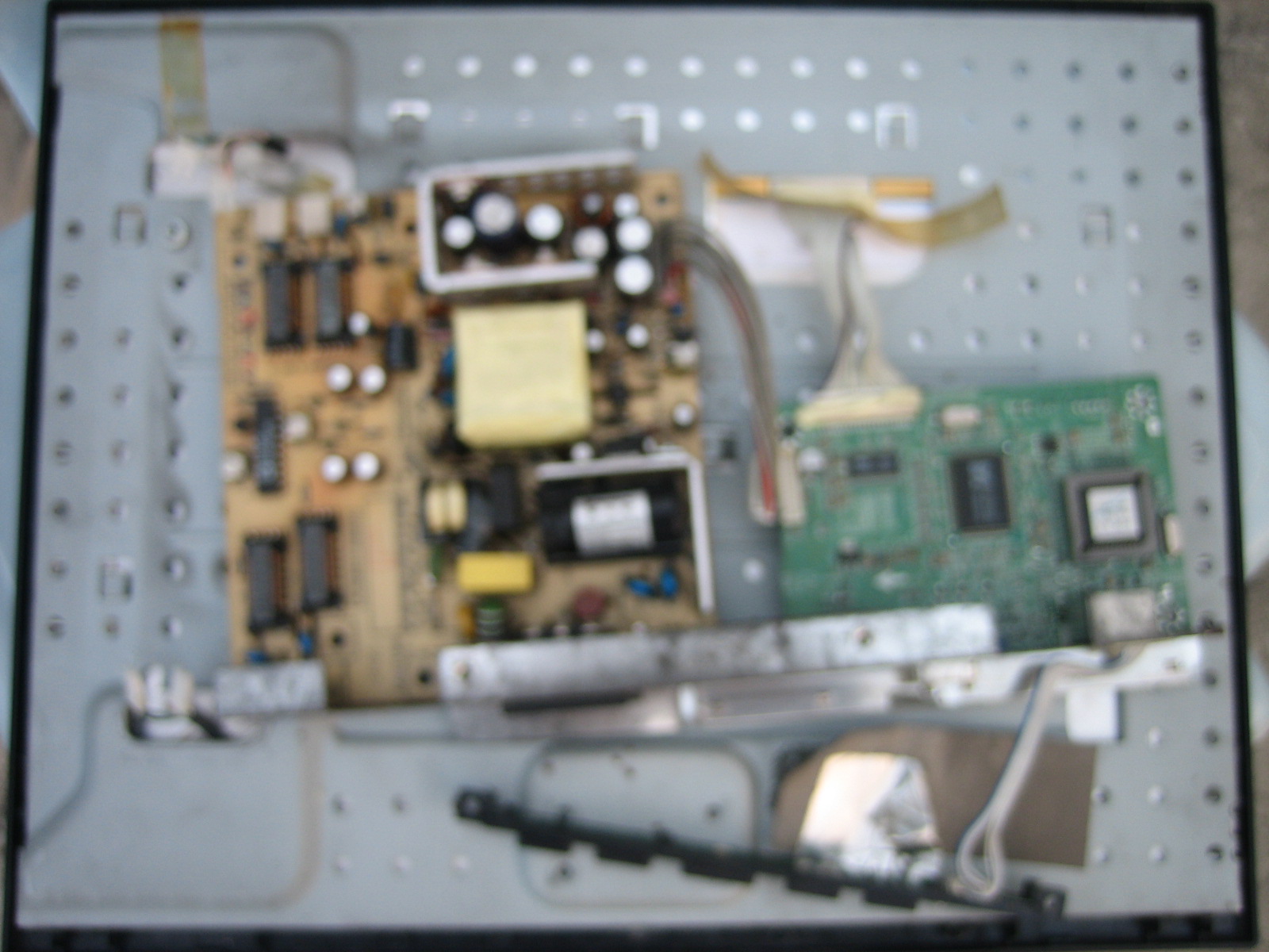

    A friend sent me this old Samsung Syncmaster 153V LCD monitor to repair. The problem is no power,completely dead no light whatsoever. He had sent to a shop for repair before and the monitor came back to life for a short while, later he kept it aside as spare unit but later found out the unit is non working.
    I had some basic skills in repairing dead monitor with a soldering iron,solder pump,a digital multimeter (DMM), and a digital capacitor meter. After opening up the plastic case, I see no bulging caps or burnt marks and try search online for a service manual/schematic but none found.

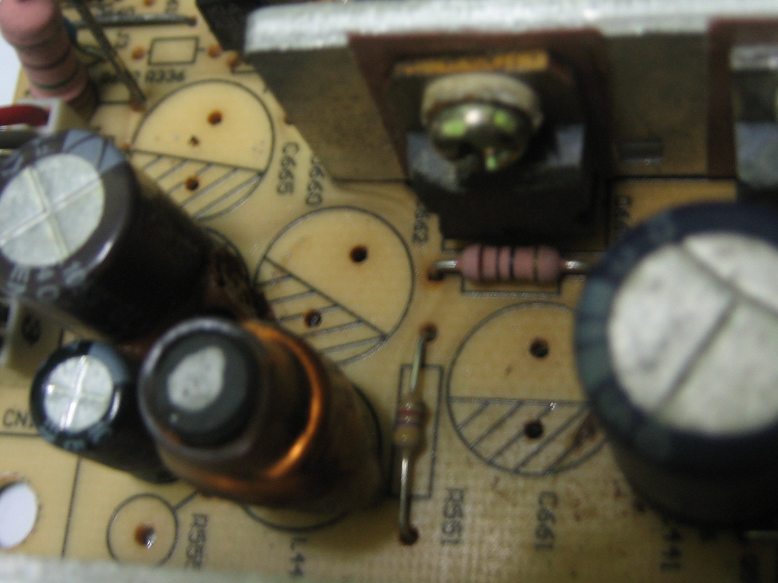

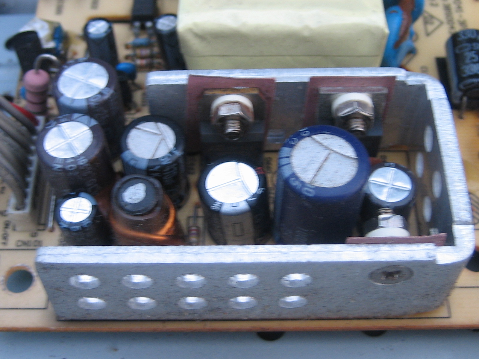

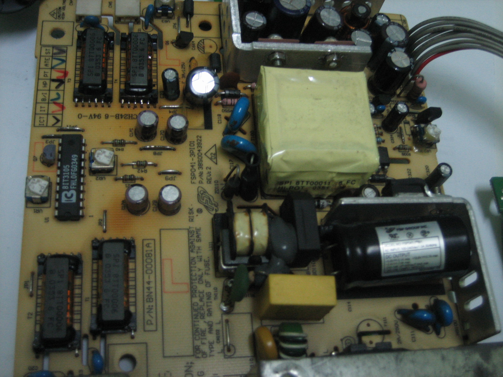

    Testing at component level on the power supply board at position D660=Schottky Diode STPR10 is open, failed diode test.
    Also at position D440=LT 350 SBL1040CT Schottky Rectifier Diode is open and failed diode test. (refer image 1450) The new parts will arrived in about 2-3 weeks from now. I have the following questions:
    1) What are other components that are likely failed and needs checking?
    2) How do I removed the two faulty diodes(refer image 1450) which are placed in a tight spot, my philips screwdriver can 't reach the screw as they are blocked by the yellow square transformer.
    3) How do I use light bulb series to limit the current going to the power board
    after putting in new parts?

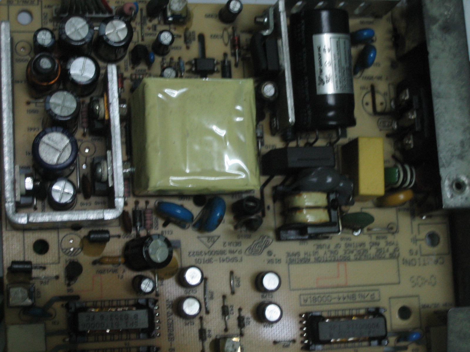

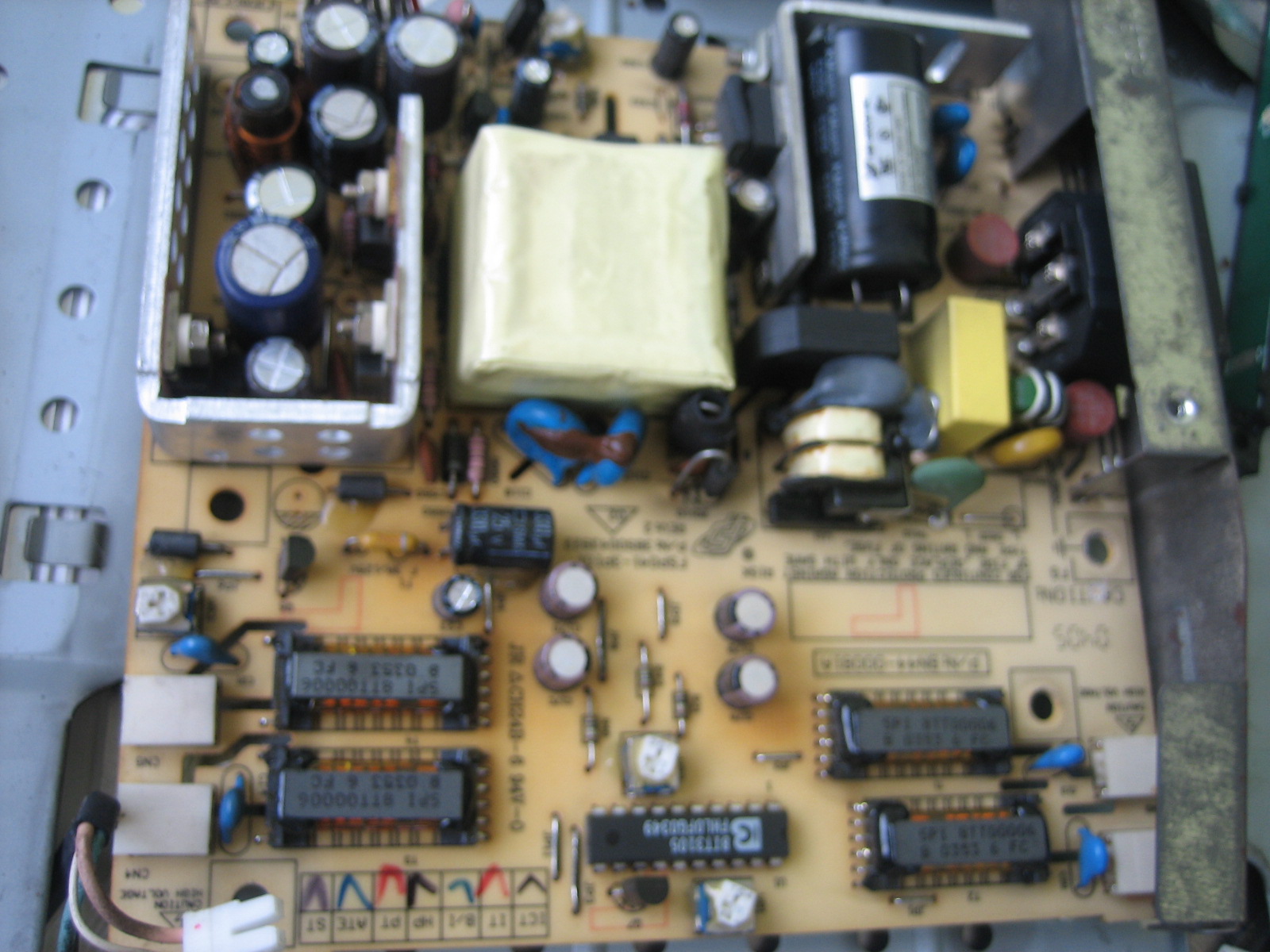

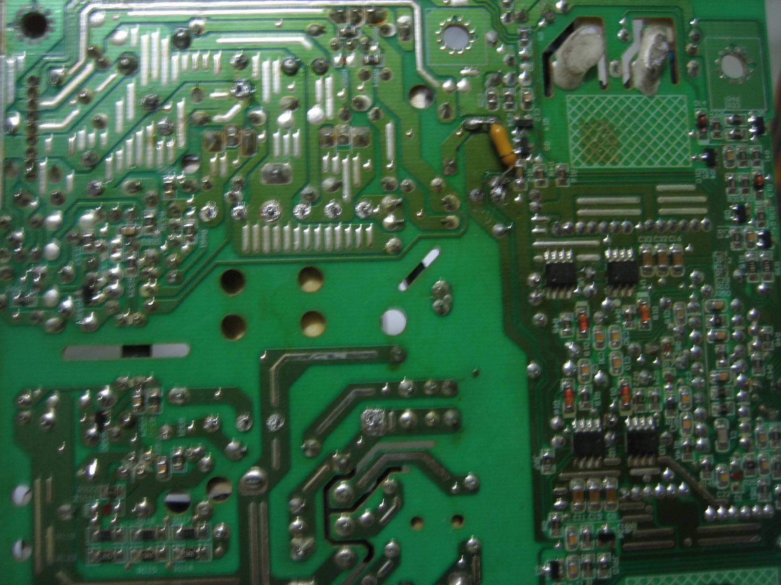

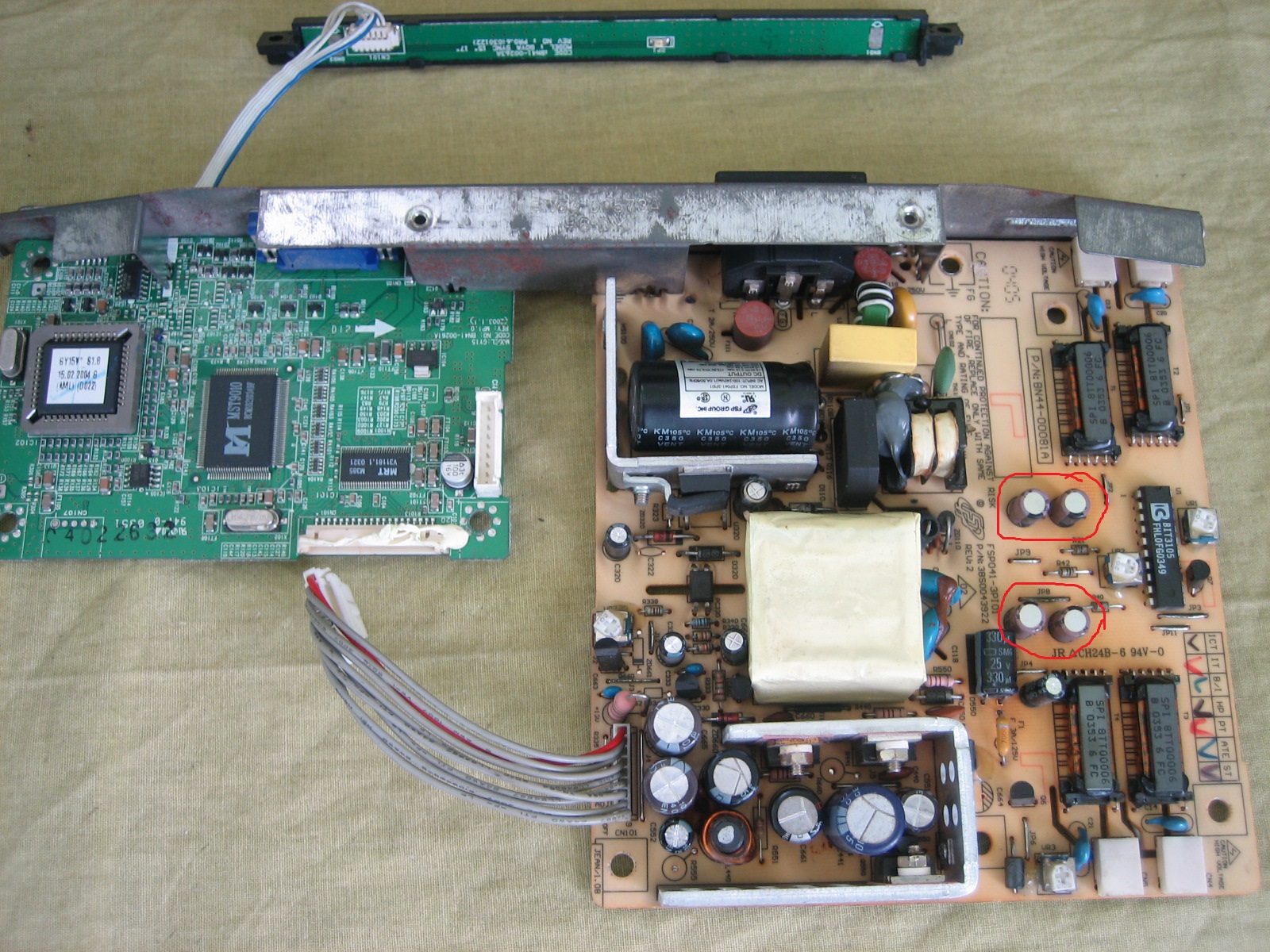

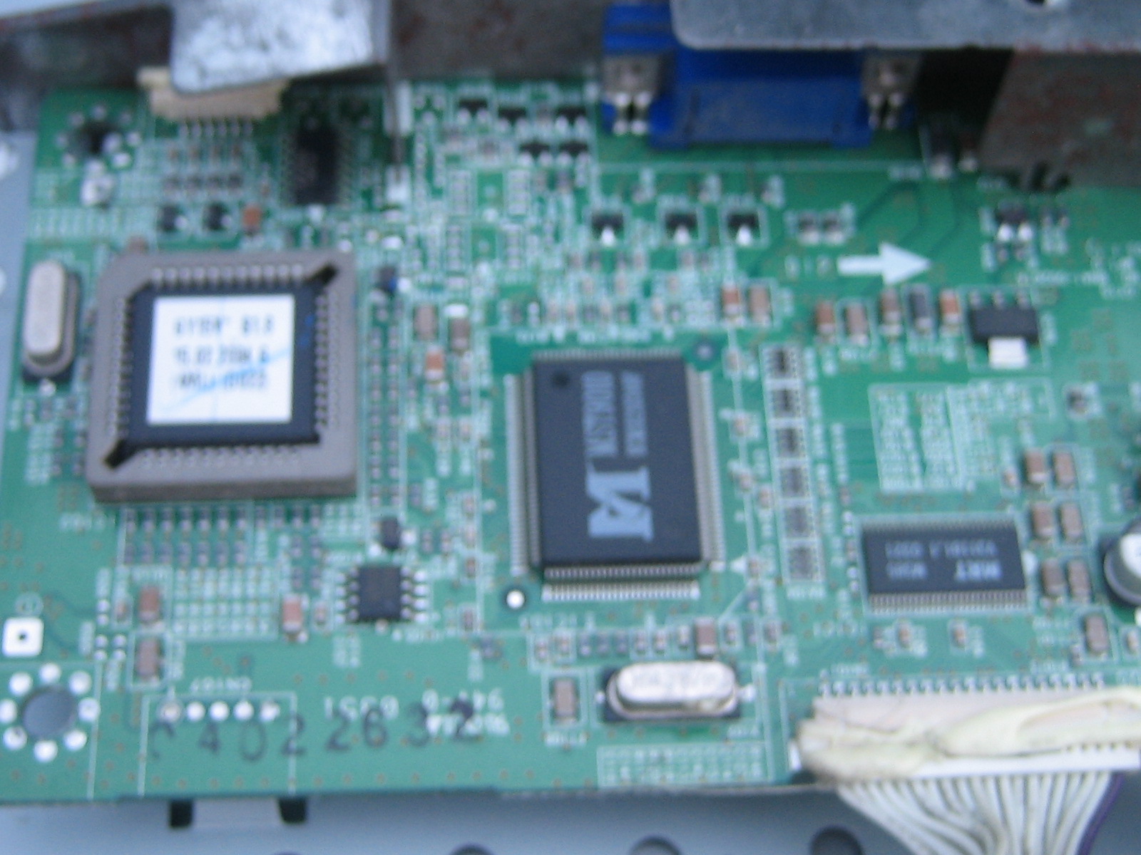

    Attached image 1411 as board top picture,image 1440 as power &VGA board
    and image 1456 as VGA board.
    Appreciate for any help or suggestions.Thanking in advance.

    Re: Need help diagnose Samsung Syncmaster 153V
    ouch.
    firstly remove the transformer to get your screwdriver in,
    you need to resolder all the transformers anyway.
    second, the 4 caps in the enter with a pink tint are done, they are for the invertor function.
    given the age and heat i would just do a full recap.
    the lamp thing, you make up a power cable with a 60w lamp inline with the live so it acts a bit like a fuse.

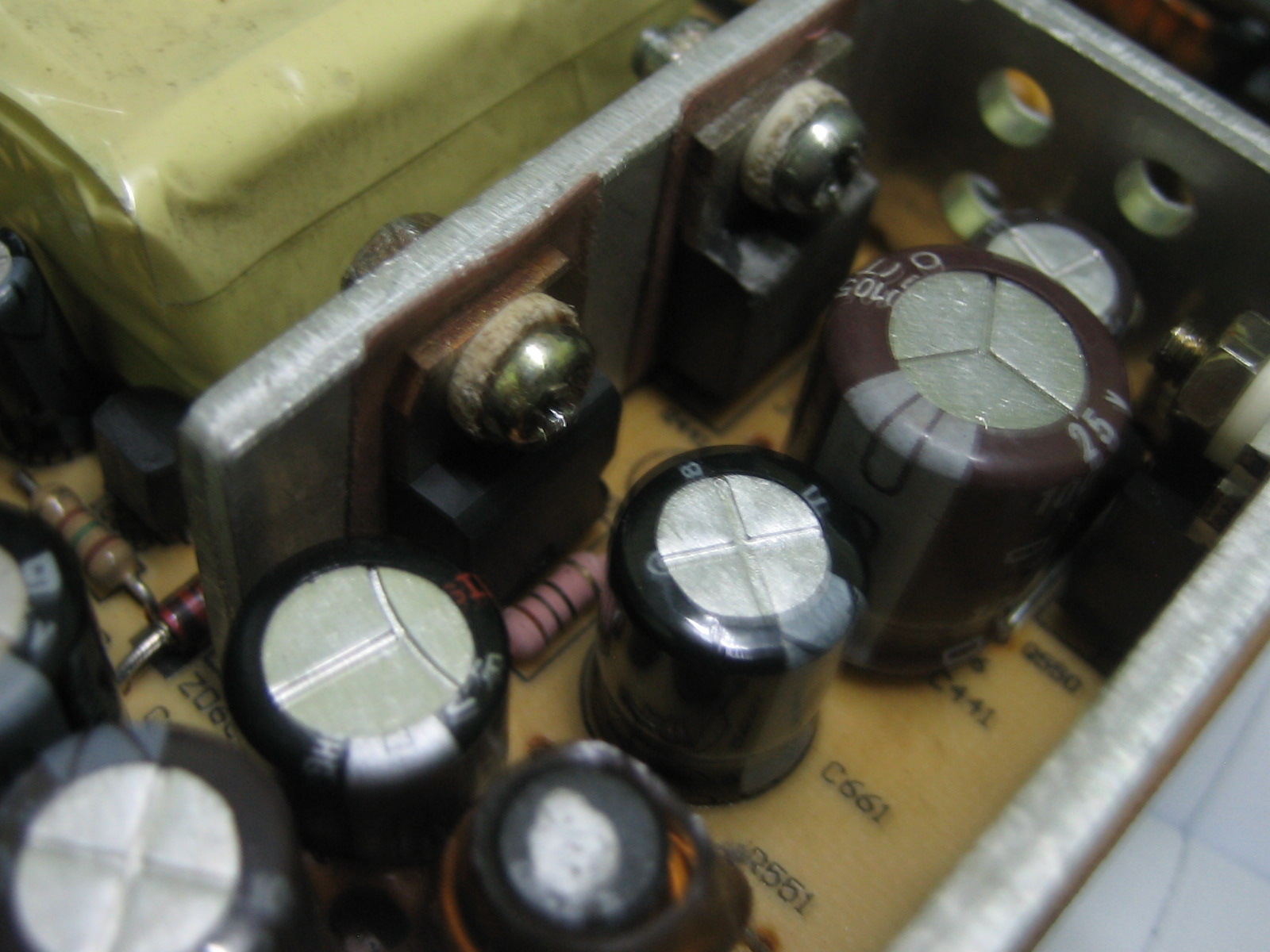

      The 4 caps you mentioned in the center with pink tint, is it the image 1465 which
      i circled in red on the right side of yellow transformer. Those are 47uf caps which
      I will recap.

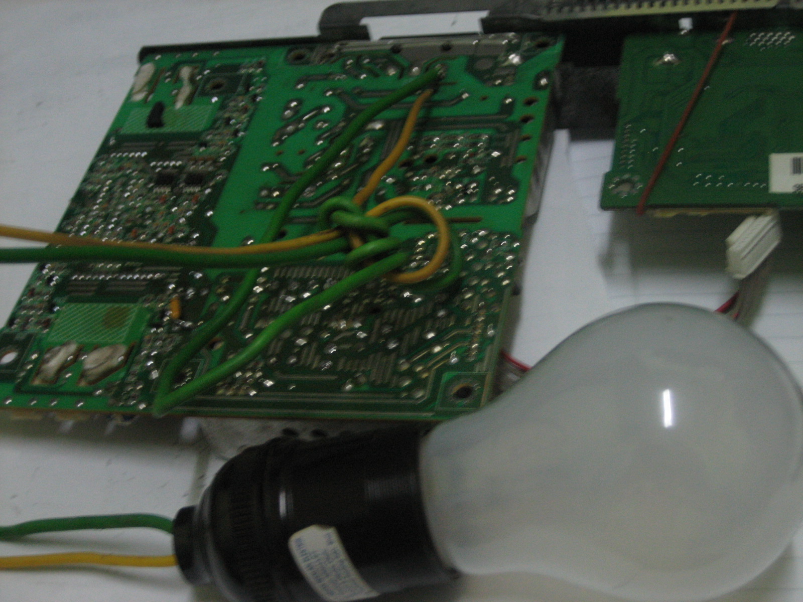

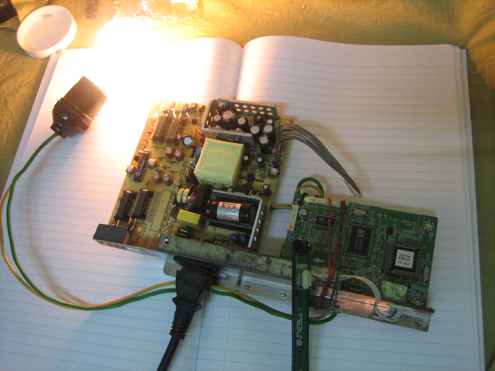

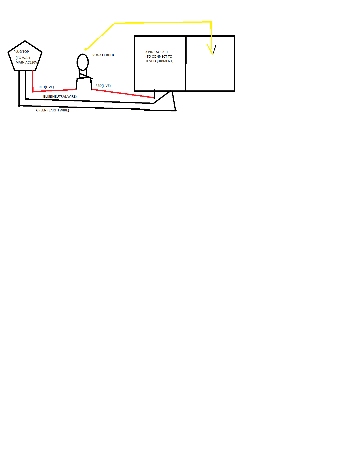

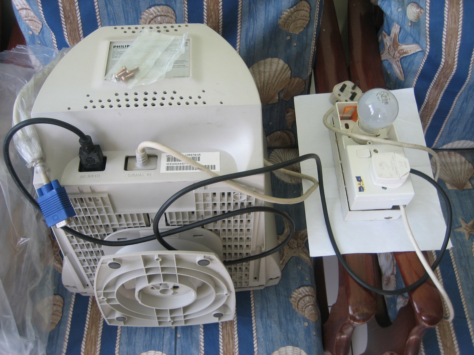

      I ghetto work a Light bulb tester as per image 1463, diagram is per attached. Is this
      the right way to assemble ? I tested on a faulty crt monitor, the light bulb gives an
      initial bright, then shuts off after about 2 second. Is this meaning the test equipment as in the crt monitor is operating normal?
      Eager to know and hope for any suggestions and answer. Thank you.
        • 31159
        yes, that's all correct.
        some stuff wont work properly with the lamp, but your only using it to make sure the psu wont explode when you power it up.
        if the lamp goes full-bright and stays that way - you just saved yourself a fuse & other stuff!

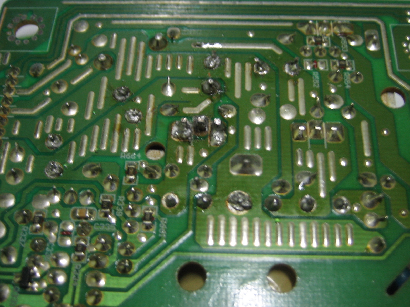

          I resolder the transformer (image 1609), and some 3 pieces 470uF25V caps at position
          C665,C662 &C661, also remove a 330uf25V cap at C17 and the 4 small caps (each is 47uF25V). Tested using my only capacitor meter & Replaced those 470uF that reads less
          than 10% off scale (like 425uF)..... surprisingly the 4 small caps (47uF25V) in the center
          still reads within range, so i didn't replaced them.
          Tested continuity of transformer with an analogue multimeter, it shows continuity; so i put it back. After replacing some problem caps, I desolder the round pink fuse near the main cap, and connect to a 60w light bulb (as a series current limiter). Switched on 220AC main without connecting to LCD panel or vga board, the light bulb light on a second then lights off, followed by flickering(oscillating siren like) light bulb. This indicate somewhere there is still a fault. Also I noticed some buzzing/hissing noise near the yellow transformer area.
          Any idea where to check now. I really appreciate any help or suggestion.

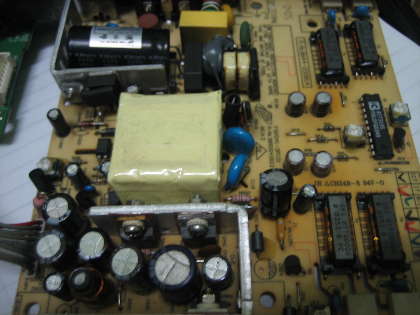

            The switching mosfet on the heatsink is gone.
            Why you put out the transformer...
            Change it and if you have a noise check the x capasitor and the two suppression caps.

              What Charis sad is likely to be true.
              That is a 3-legged component bolted on the heat-sink. The one that got yellow-ish colour on pics looks like it failed, but can't tell for sure.
              Google on how to test it. If those are OK, check for short on graetz, and so on

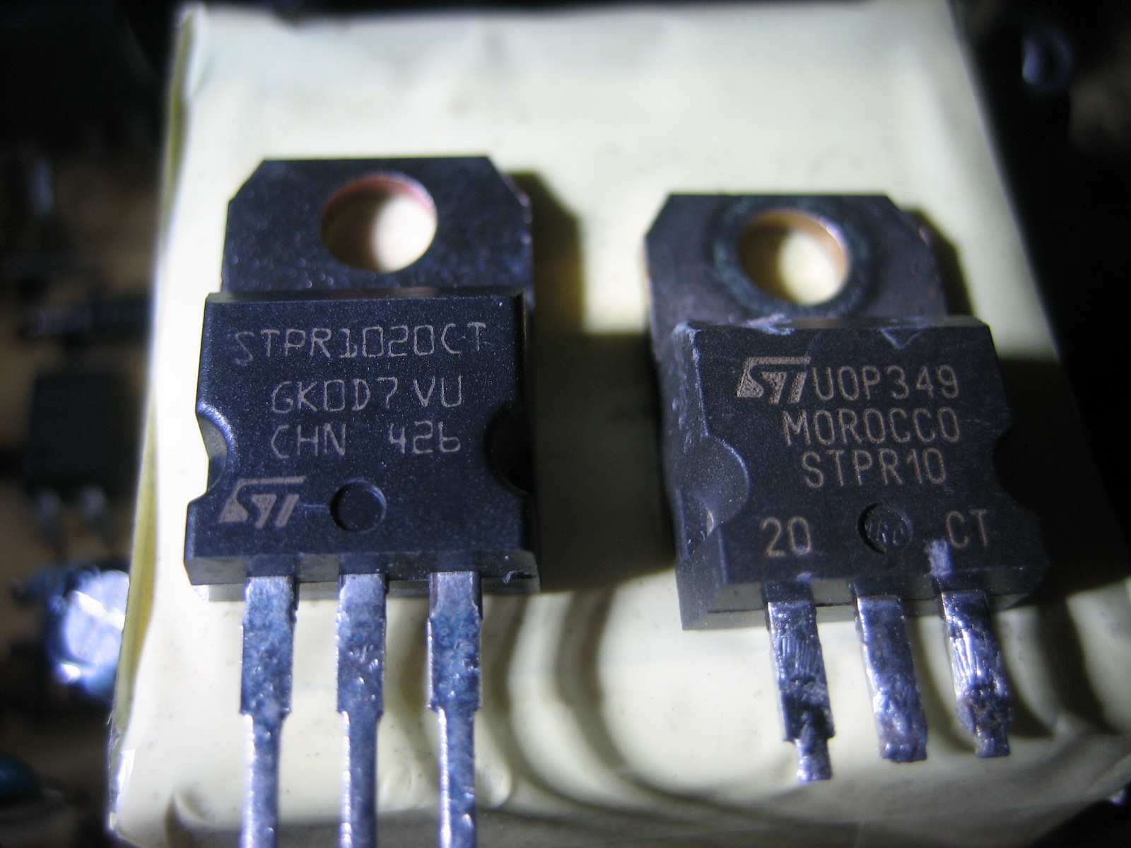

                  I desolder the switching mosfet STPR10, off circuit tested ok, but anyway I replaced
                  with STPR1020CT. Also i replaced new 470UF 25V & 1000UF 25V caps at C661&C441 just in front of the new mosfet.

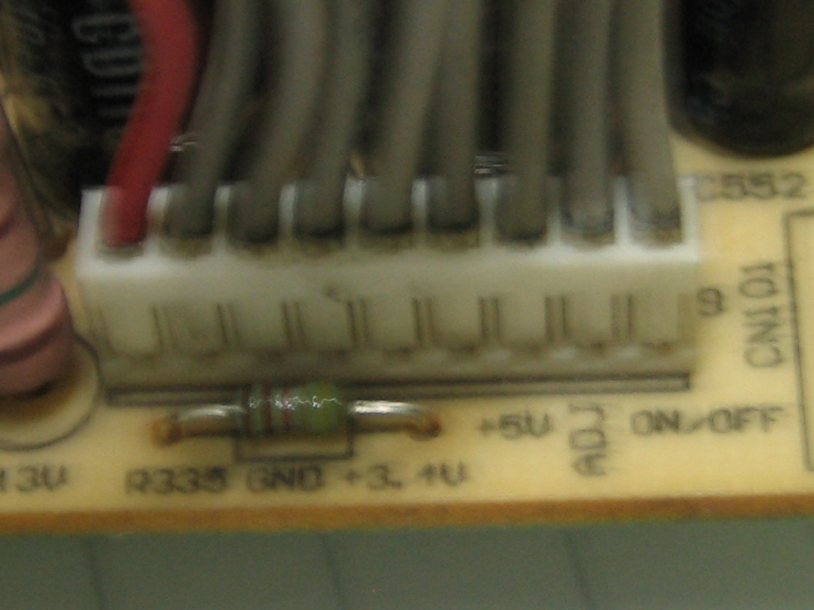

                  Charis mentioned about noise check on x cap, is it the yellow square one near the main cap? where is the two suppression caps, sorry i got no clue. I use cap meter to check the yellow square x cap, reading is 0.33UF as printed on the cap.
                  How do I check output DC voltage on the white connector ? Do i put positive probe to third wire from right side marked +5v? then negative probe to screw hole ? sorry can't upload photo yet.
                  Thank you for any help.

                      Sorry my mistake, the original STPR10 is a 10A 100V Silicon rectifier diode,
                      but my supplier do not have this stock. So I no choice have to use STPR1020CT as nearest substitute. Off circuit, I had tested the diode with diode test on DMM, is tested ok. Earlier I was referring to charis on post No.6 " The switching mosfet on the heatsink is gone."
                      But sadly after replace this diode, the light bulb in series still lit brightly flickering.
                      Something else is shorted. The next diode is SBL1040 which I use diode test on DMM, also tested good. So I run out of idea, maybe someone can guide me on voltage test on output.
                      Thanks.

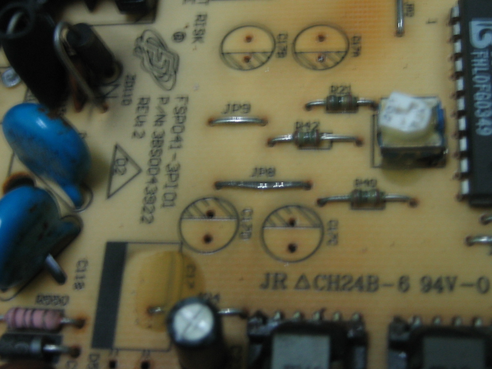

                        Uploaded some more photos after replacing the original diode STPR10 with STPR1020CT, and changed a new 470uF 25V & a new 1000uF25V cap.
                        Refer image 1683,how do i test for DC output voltage at the square white connector? Do I just put red DMM probe to third right wire labelled +5V,and black probe to cold ground?
                        Feeling stumped and not sure where to look for fault in this power supply since after I switched on AC main, the light bulb series lighted a second and off, then 2 seconds later flicker brightly. This indicate there is still a short circuit. Or do I need to connect to main vga board and connect to the 4 ccfl lamps as load for testing?
