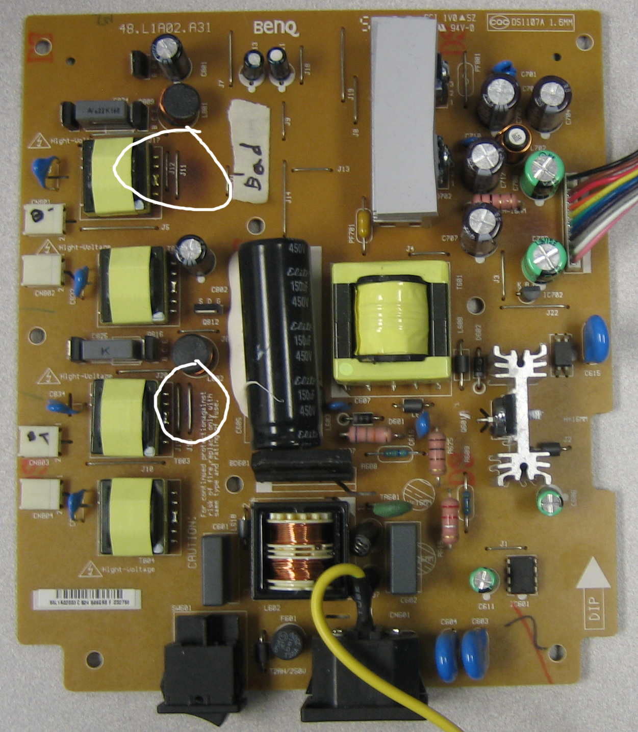

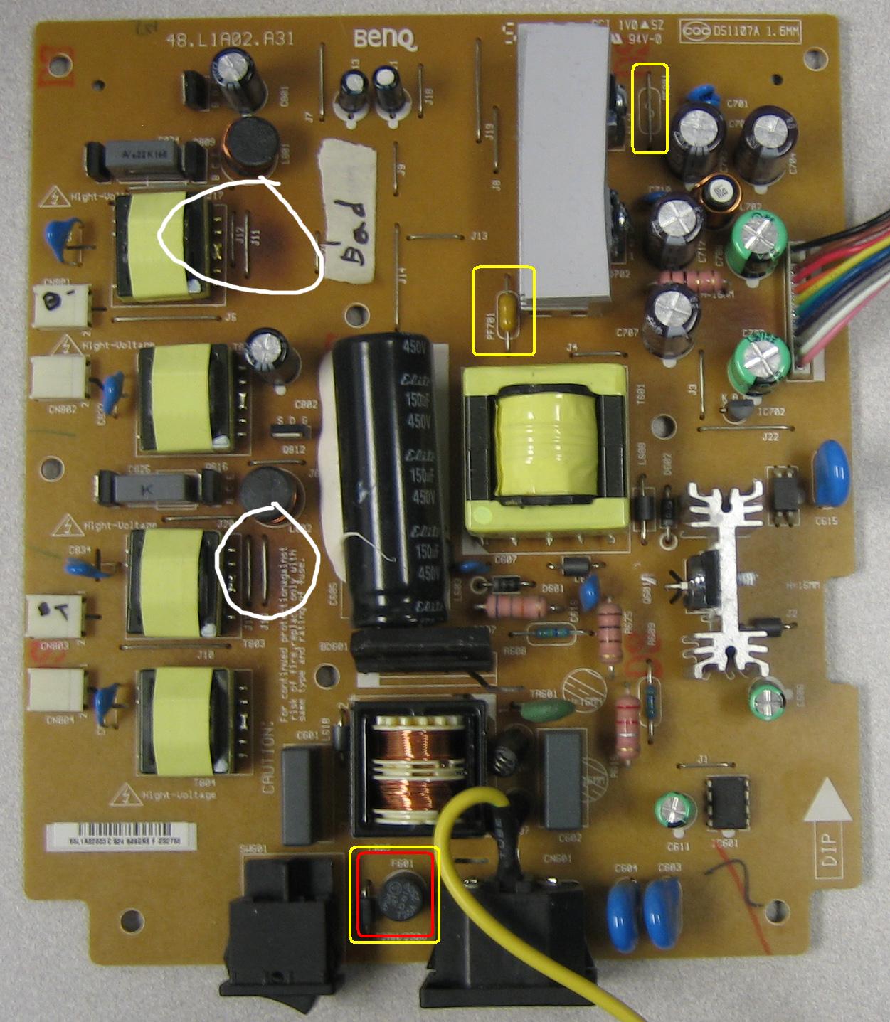

        I have the exact same problem with my BenQ-built HP 1955 Power Inverter Board. The monitor does not power on at all.
        Below are two pictures of my board. Notice the two burned marks on the board that I've circled in white.
        I've done a bit of research on this forum already and have come across a few threads that are helpful:

        My biggest question is, you say you've never come across a board like this that can't be fixed, but can this type of problem really be fixed without having to do any work on the under side of the board?
        It seems like replacing anything on the back of the board is impossible since the parts are so small and practically "printed" onto the board.
        Same thing goes for the PCB's themselves. What if there is a problem INSIDE the printed circuit board?
        Lastly, can someone show me (by circling on my picture) what exactly would need to be replaced? A picture speaks a thousand words. Thanks so much in advance,

          Looks like you have been overlooked here Maverick, dont know why,
          Post and let us know if you havent fixed problem, you probably wont have to touch those small components on underside of board to fix this one

            I still haven't fixed the problem; I haven't touched the board since I received no posts. That is encouraging that you think I won't have to touch the back of the board, but I'm still not positive where to begin.

              Well, there's not a single cap bulged in the picture (as far as I can see), so either you replaced them already, they are OK, or at least they LOOK ok.
              First thing first : Are you getting any AC input (fuse in the yellow/red square is not open)
              Also, check if you can get voltage readings in the pico fuse (yellow) and in the bridge that should have been a pico fuse too. If the caps are all the originally installed, post the info on them, just so the info can be referred too for later reference.

                      I'd like to help, but need more information. First of all, a picture of the back of the board would be helpful. I'd like to see what caused those two hot spots on the board.
                      The second piece of information is what is your level of experience? And what equipment do you have available? A DVM, soldering iron, and wire cutters are the minimum tools required.
                      A first step is to use a DVM and Carefully! check the voltage across C605 with the power cord plugged in and the power switch on.

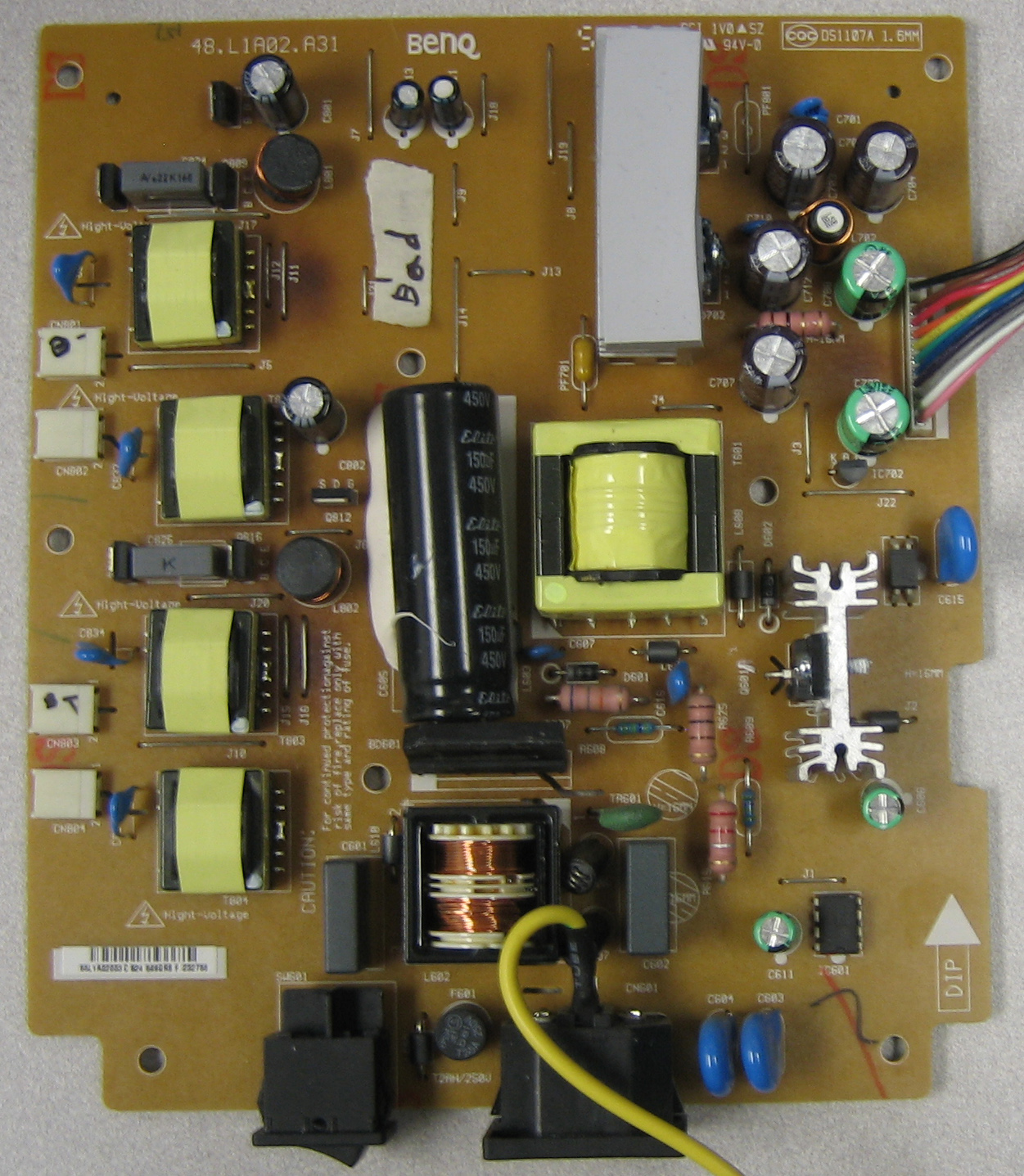

                          Here are the caps on this HP 1955 benQ power board, generally from left to right:
                          2x 220uF black 35V Elite
                          2x 33uF 50v TK?
                          1x 150uF 450V Elite (big black one)
                          4x 1000uF 16V Elite (brown)
                          2x 1000uF 10v Lelon (green)
                          2x 47uF 50v green Lelon (smaller, bottom of board)

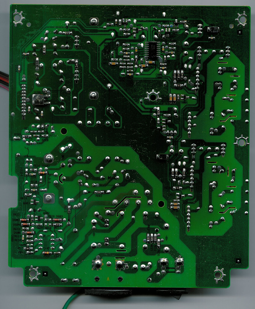

                            Here's a picture of the back of the board. I can't see any burns on this side of the board, but this should help to see what might have caused the burns on the front side.
                            PlainBill
                            I'm new at this, but really want to learn. I'm ok with messing up a few boards in the pursuit of learning how to fix these. I have access to a DVM, soldering iron (I need to get a hotter iron, and a better tip--any suggs where to go?) and wire cutters, yes.

                              Huh!!! It looks like the heat was caused by the smd resistors in that area.
                              You might take a look at IC701 on the back; that doesn't look healthy. And as an item of curiosity, what are the numbers on the 16 pin IC on the back of the board?

                                You're right, that IC701 doesn't look healthy--half of it has a shiny luster and the other half doesn't. Then again, most of the larger ICs on the back look that way, although not as bad.
                                The 16 pin IC on the top of the back of the board says:
                                5ICLZVK
                                TL1451A
                                It looks like the burn marks correspond to these little tiny resistors? on the back that say "471" on them. They're so tiny though, I better not have to replace them!

                                  Ok, I'm still trying to locate all of the possible bad parts mentioned:
                                  I've labeled the C5707s and the TRANSFORMERS and FUSE (is this correct?)
                                  Can someone please circle where the MOSFET or TRANSISTORS would be on this board?
                                  I just want to make sure I'm looking at the right parts, and my terminology is correct; remember, I'm new at this.

                                    Your labels are accurate, but incomplete. I'm going to walk you through this board; I'll be skipping a few parts. Feel free to ask questions if you need more information.
                                    AC power comes in through the power connector, goes through the switch and the fuse, F601. L602 and the caps on either side are there to block surges. TR?601 (the green blob ) is there to reduce inrush current when the power is turned on. Directly above L602 is a bridge rectifier; it converts the AC to DC. 120 VAC in gives about 165 VDC across the legs of C605 - the 150 uF, 450V capacitor. One of the first steps is to measure the voltage across C605 With everything hooked up and the power switched on. If it's around 165 volts F601 is good.
                                    The next item of interest is IC601 in the blue circle. That controls the conversion of 165 VDC to 12 VDC and 5 VDC. Immediately to the left of IC601 is C611; above IC601 and slightly to the right is another capacitor, C608? Those are important because they form the power supply for IC601.
                                    The power mosfet is the device in the green circle. That switches the power to T601. If F601 is open odds are either the bridge (BR601?) or the power mosfet are shorted.
                                    The output of T601 is converted to DC by the diodes mounted on the heatsink I marked with a brown X. To the right of them in the brown circle are 6 capacitors that filter the output from the diodes. And next to that is the cable connected too the logic board.
                                    In the white circle to the left of the heat sink is another fuse, PF701. That is in the power supply to the inverter.
                                    I prefer a 'divide and conquer' troubleshooting approach. If you get 165 volts across C605 we know the AC input side is good. The next step would be to measure the voltages on the cable to the logic board. If several of them read 5V and 12V we know the power supply is working. If not, suspect C611 and C608?.
                                    If the power supply seems to be working, check the voltage on both sides of PF701 (or check it's resistance with the power off).
