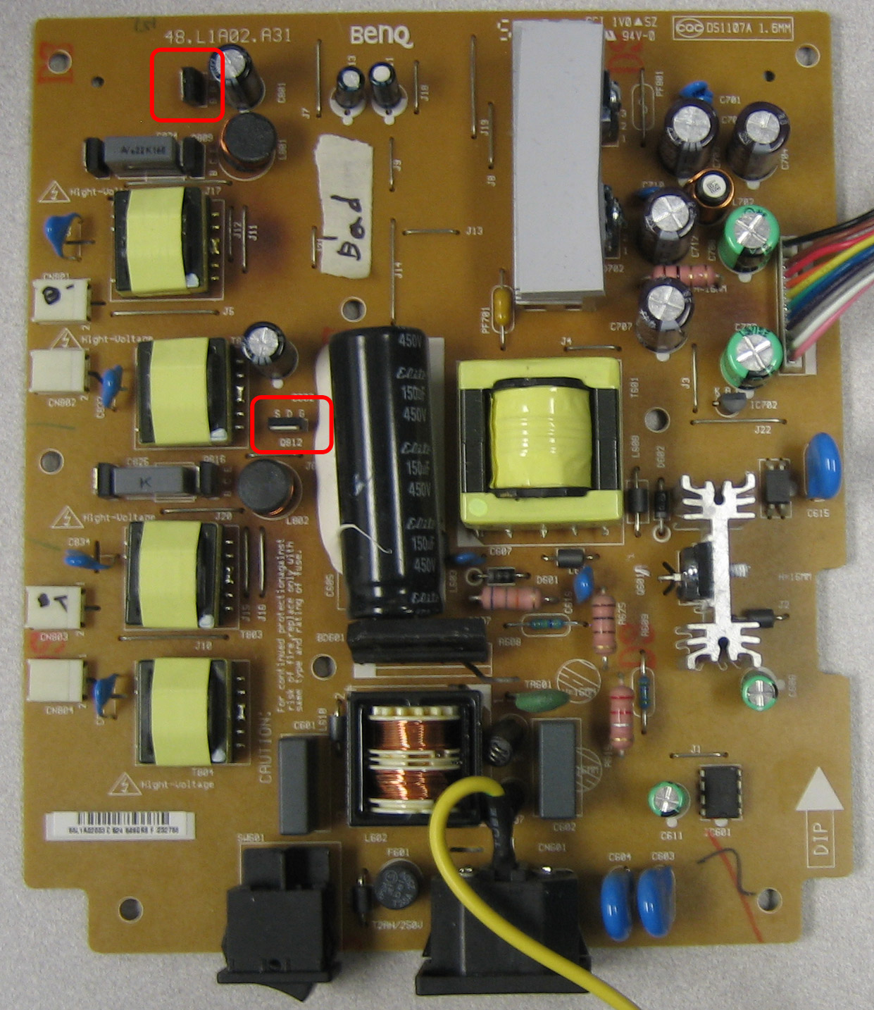

          I finally replaced a pair of C5707s, the 5A pico fuse, and resoldered all transformer solder joints, and now the board powers up and displays an image!
          However, now the backlights stay on-- always. They're on immediately when you turn on the monitor (before you even hit the front power button), and stay on, even when the monitor goes into power saving mode (and the front LED turns from green to amber).
          What would cause the back lighting to remain on and how can this be fixed?
            Probably one of the FU9024Ns, they are known problem when the B/Light stays on, or bad solder joints to them possibily

                I'm not familiar with FU9024N. I don't see any on my board.
                I found 2 x J598s near the inverter side of the board, as circled. Do these perform the same function as the FU9024Ns?
                If not, can someone please show me where they'd be located?
                Also, if so, does anyone know how to test them? The PCB labels the leads as "G D S" on these J598s.
                  Yep those are the ones
                  G D S = gate, drain, source
                  you are checking for shorts, also check out the solder joints on the good one.

                        Ok I measured the J598 that corresponded to the top half of the inverter circuitry where I already replaced the C5707s and I measured from source (S) to drain (D) and sure enough, it was shorted (0.0 on diode reading) in both directions. Good call, gentlemen.
                        I will buy new J598s and replace the bad one. The other one seemed ok and I'd rather not have to replace it if I don't have to considering how expensive these are. I'll let you know how it goes.

                            I couldn't wait and so I desoldered the remaining good J598 from one board, and soldered it onto the other (I had 2 bad boards remember), and now the LCD back lighting turns off when it's supposed to! Thanks everyone for all your help!

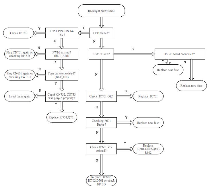

                                        • chotzeny
                                          • 2
                                          #60
                                          Re: Benq FP767 PS caps
                                          Image of trouble shhoting the Power Board
                                          and concept of replace parts...
