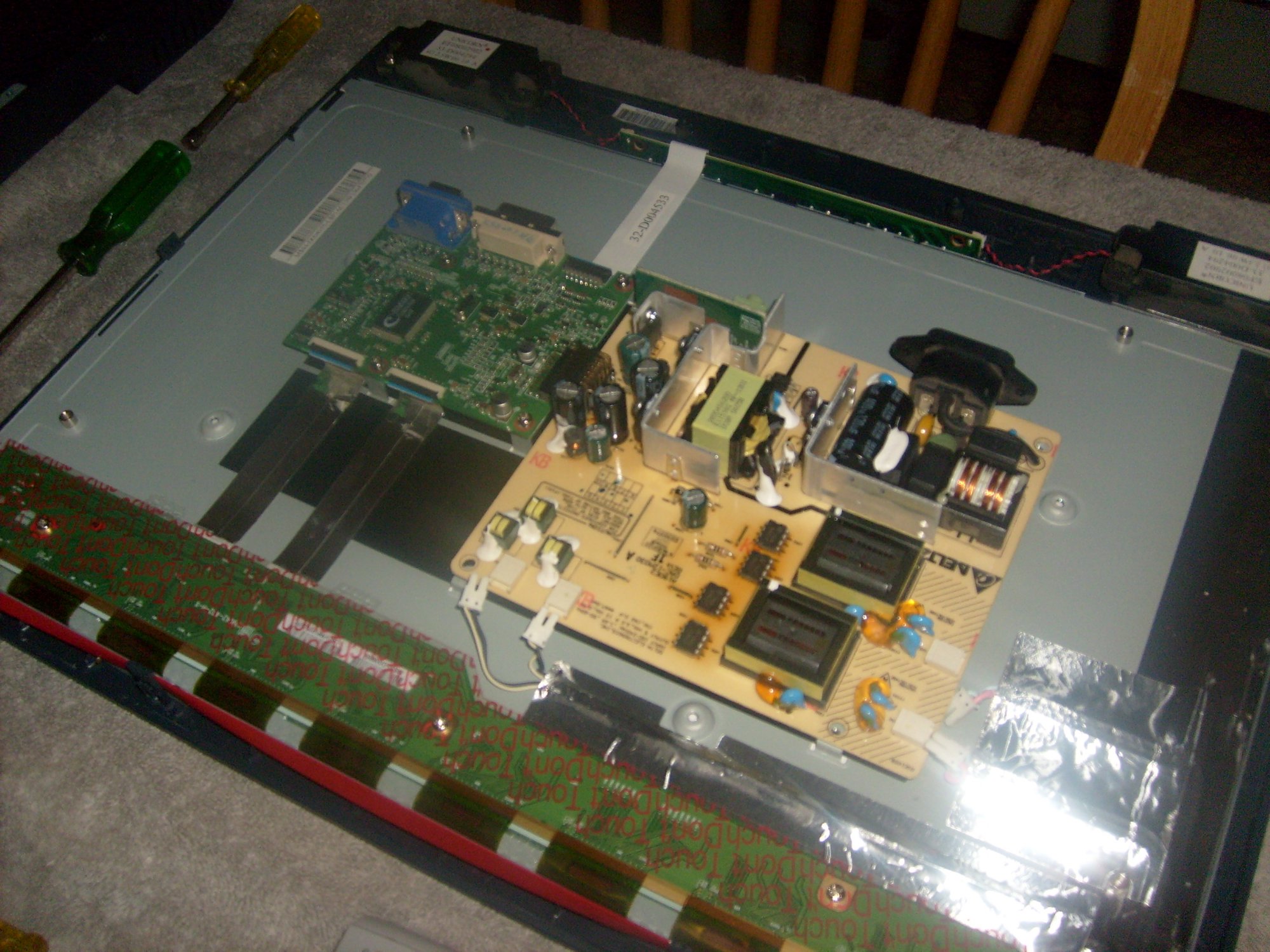

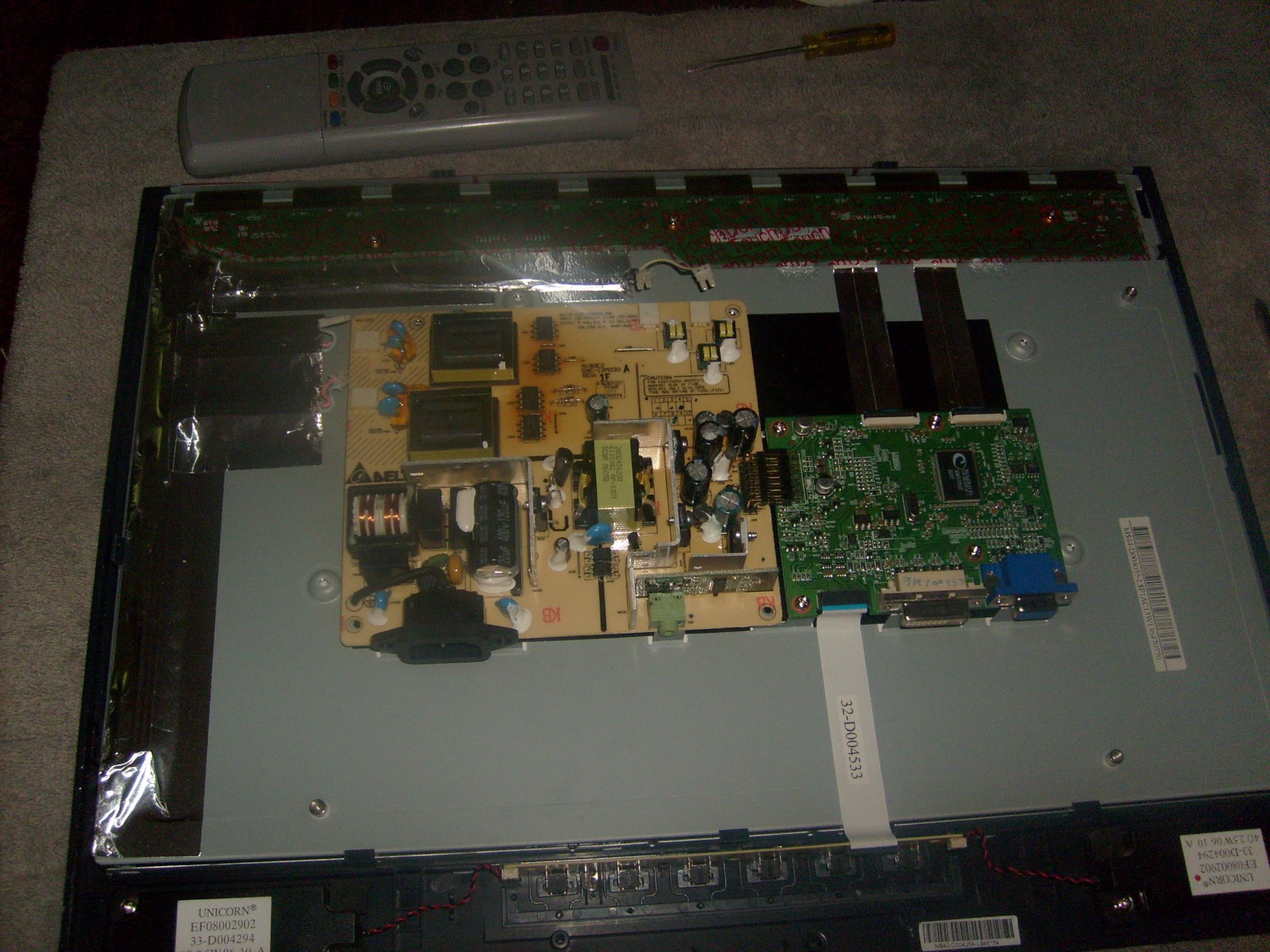

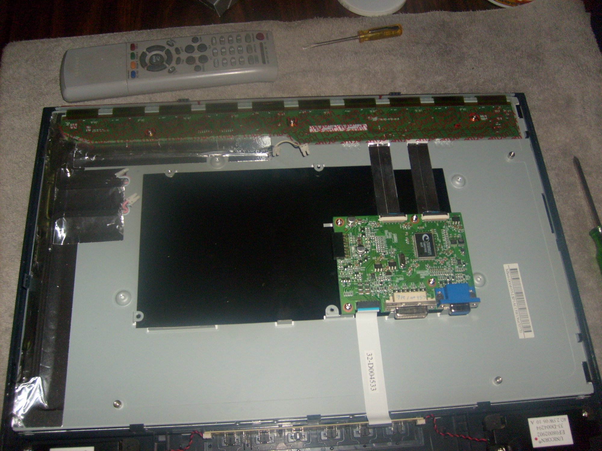

    Viewsonic lcd VA1912wb
    I was given the VA1912wb cause the green power light flashes off about every two secs. Screen is completely black. Checked with torch and see no image. Hooked to laptop and the os recognizes the monitor. Removed back cover and a 220uf,25v, 105c cap had the bottom blown out. Replaced all caps and checked solder joints on board. Soldered suspicious looking joints. When power applied the monitor exibits same problem as before. The fuse on the inverter board checks o.k. Any suggestions?
  • elbtax
    • Apr 2008
    • 59
    Re: Viewsonic lcd VA1912wb
    Forgot to add pics....

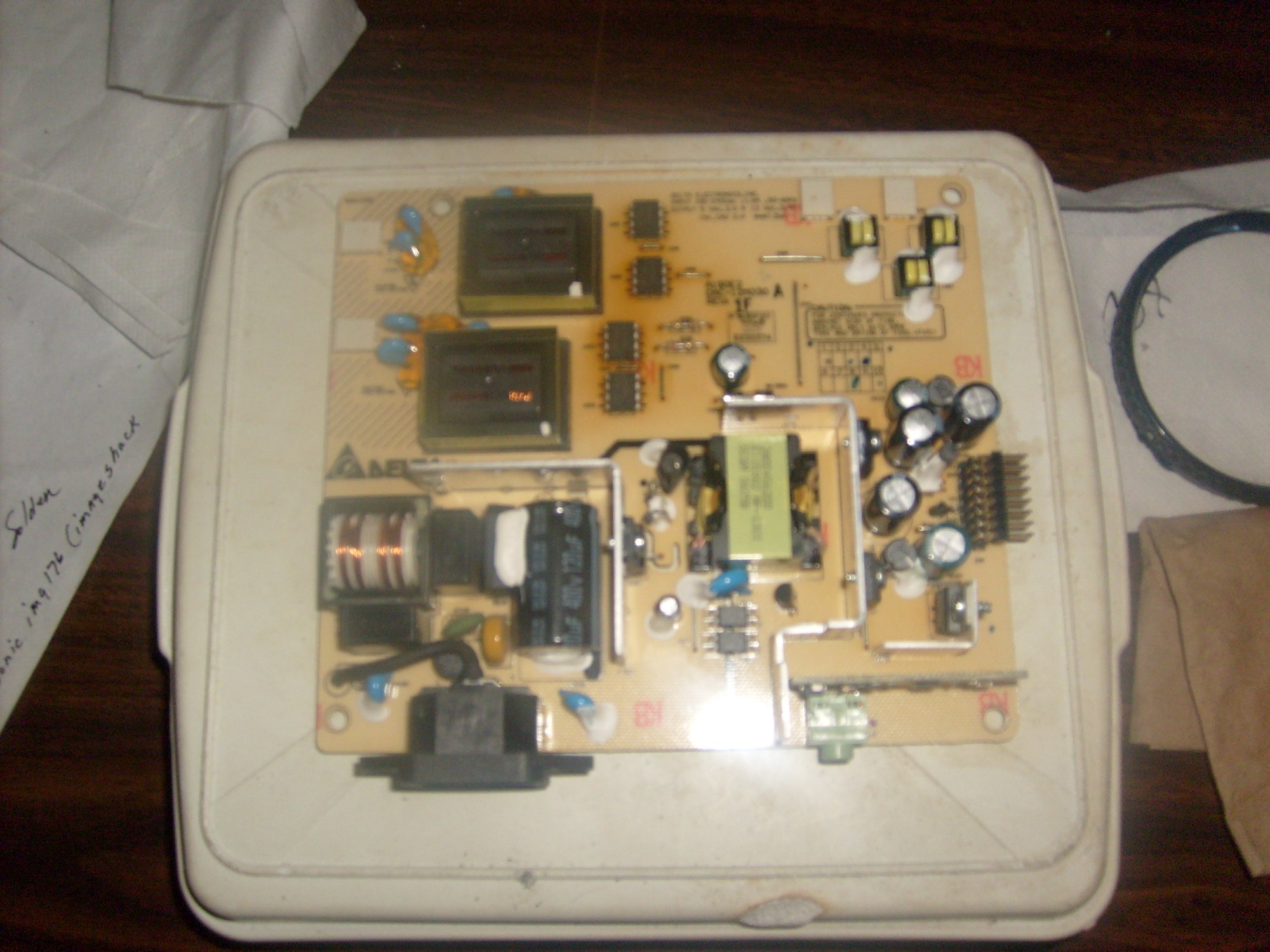

      I'm guessing the pictures are from before you recapped the board since there are 3 caps definately bulging. The 4 chips near the transformers seem to have undergone a fair bit of thermal activity. One or more might be toast.
        Thanks for the reply tiggerific. These pics are before the recap as you surmised. I started re-capping about a month ago. Someone gave me a 19" Gateway tft fpd1960 that the screen flashed with the Win logo and went off. The power light stayed green. Replaced caps & put a "touch" of solder around inductor joints. Works fine now. Also recapped an Acer S58m mobo. Works fine now. Anyway, can't do a lot with only a solder iron and a Dig MM.
          I second to check those IC packages.
          They are probably driver transistors in a DIP package.
          Go to alldatasheet.com enter the part number on them and get the pinouts.
          Using the diode checker of your DMM should reveal any open shorts in the transistors.
                I have been searching on this inverter board and can find nothing. It is a Delta board,A190E2, DAC-12M030A, Rev1F. Have found 12M030 - disc & 12M030B Rev 0F. This must be a newer type inverter..
                • tiggerific
                  • Apr 2008
                  • 21
                  Believe I found them - P605 => http://pdf1.alldatasheet.com/datashe...D/AOP605L.html
                  CE mode mosfets (1xN & 1xP) in each package so it's quite possible they have gone bad.

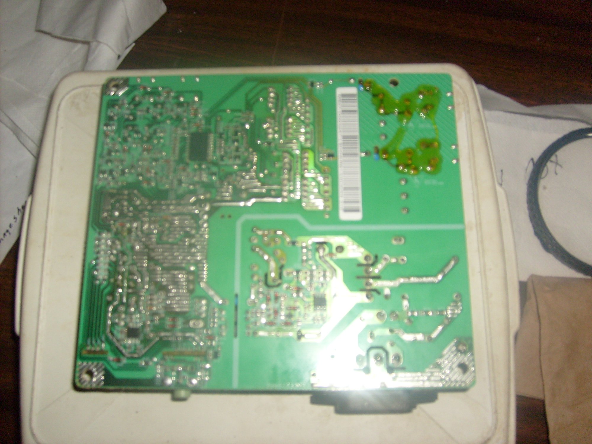

                    Thanks Tiggerific,
                    Had to take a break for awhile. Went fishing. Caught some nice bass & bream.
                    I had pulled up the P605 but didn't get to the right one. This datasheet looks just like the chips. Thanks again. BTW, i found some more bad joints with my magnifier. Wouldn't cut off with the switch before. Will now. I think progress is being made.
                      checked the pin-outs on the chips and found no shorts. (IF i did the test correctly.) There is a fuse ,5a,250v, in front of the small cap near the chips., F200, but it checks o.k. On the board there is a notation to replace with correct fuse type and rating. (F101). Is this the type fuse are is there another fuse somewhere? Went over the board with magnifier and can't find another fuse...Looked for a pico fuse & found nothing. I know i am not getting power to the x-formers. Any more suggestions?
                              After extensive research and testing - two of the dip switches are toast...These are the AOP605 chips. Checked with Mouser. No comparable chip. Does anyone know where i can get these chips besides HK, China, or Taiwan? Maybe Fairfield? Will keep checking. Thanks for all of your input.
                                  The ones that are in the "dark" area of the board that is in posting #2. They are the dips that give power to the x-formers. They are actuall mosfets. Alpha Omega P605 w/N&P channels.
                                    UPDATE: After searching Digi-Key, Mouser, Fairchild, etc. on the web, i finally found the mosfets at Blue Star International at $6.99 each. Not cheap. Ordered and will be here soon. Coming from Huntington, N.Y.
