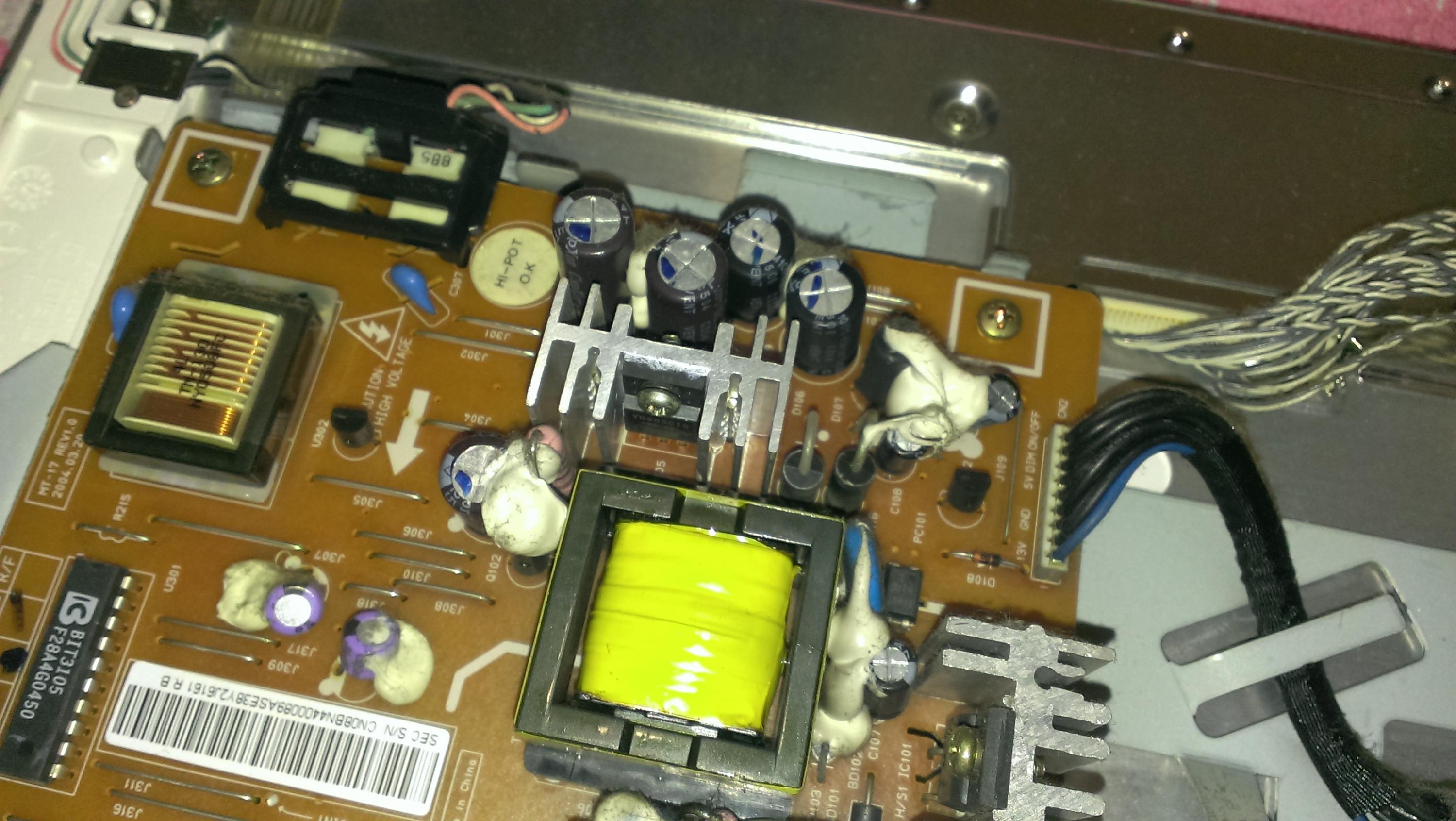

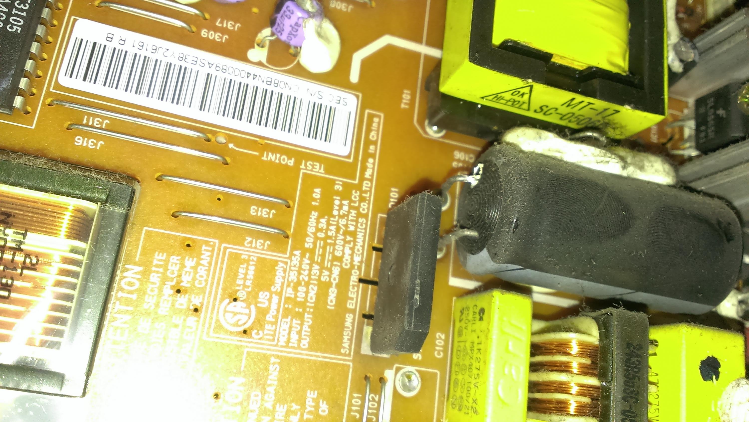

    I got this monitor with hissing noise as soon as the LCD is lit, I thought it was well... u know when things age they gives out all kinds of noise. I had been using it as my mobo testing monitor for awhile now, it was all fine until one day it decided to on/off or going into standby looping mode due to VGA signal (not quite sure). Then I just keep the monitor away and swap out another monitor, thinking that it was just some super crazy cheapo VGA cable I use causing it to lost signal therefore making the standby loop. Until... I bring out the monitor to use on my workstation as dual monitor set up. It was all fine for 24hr, until just now the on/off start looping again... Then I decided to crack the case open and saw the bulging cap on the primary input section. Does this bad cap has any relation to the hissing noise I heard and the on off loop ?
    Other small caps on the secondary side looks fine, at least visually. But ESR I not sure, might gonna replace all of them as well.

    Yes the big filter capacitor is shot you might as well replace all the capacitors
    Hissing noise is gasses escaping from main filter cap

          After replacing the bad caps, now my monitor working fine once again. No more hissing / buzzing noise. That bad cap was so bad that literally one of the legs just come right out as i sucked away the solder when the cap drop to the ground, and the legs still stays in the hole on the PCB.
            Re: Samsung SyncMaster 710N Badcap
            Nice, was the original a CapXon KM by any chance?
            You left the small caps alone I guess?

                  Yup, due to I don't have enuf time and urgently need the monitor back in service, so I left the small caps alone. And yes, your guess is right, the CapXon XM series .
                  Actually this is by far one of the easiest monitor that I had ever torn down. So I don't mind to replace those small ones other times around.
                  Yup, those those good quality low ESR capacitors are hard to get in my country nowadays. There a shopping complex in my country where it is specialized in selling electronics components. Back then I can get Nichicon HM(M) / Sanyo WG / Chemicon KZE / Panasonic FL. But now, all the shops carry whatever crap brand that i never ever heard of, like MaxCap brand ??
                  Sometime i will just go ahead and salvage some good quality and series of caps from mobo that I found in scrape collection.

                            I guess the fault on the primary cap is quite common for this video; I got 3 Samsung 710N LCD's with the same symptom (LED and image on screen for a fraction of a second, then both LED and image turn off, then on again -> loop) and changing the 400V cap on the primary did the job for all 3.
                            I'm happy because they represent the first successful repairs I've done so far. Thanks to all the pros that post here in this wonderful forum!
