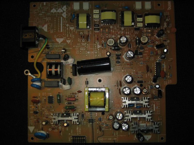

    hi, i'm new here, but did a bit of searching and found many others with the same problem I have.
    The backlight on the monitor seems to be busted ( I can see a faint image if I shine a flashlight to it).
    So everyone seemed to narrow it down to either the 4 (Q740/Q739/Q759/Q760) 2SC5707 transistors or the pf751 fuse 3amp.
    When I was taking the board out, I accidently ripped out a leg on the item circled in red, it's labelled "L603", can anyone tell me where I can source (or the name of it) another part out??
    I'm familiar with soldering (audio cables), but not PCB soldering. So what reading am I looking for when I test the transistors/fuse of the board to see if it's fried or not? And since there are 3 legs/pins on the transistor, which is which
    thanks for your time
    PS: these transistors will work 'just as well' as the originals? http://cgi.ebay.com/MJE3055T-MJE3055...2em118Q2el1247

    I just bought some 2sc5707 from this guy. On the transistors, your more than likely looking for a short between 2 of the legs. The legs are labeled E C B on the board. The fuse just check for continuity.
    I cant see any red circle.

      hi oops, i reuploaded the pic

        You can get 2sc5707 in Australia for A$1.75 ea. Won't be far different in value in C$'s. L303 just seems to be a wire wound thru 3 times and exiting as 2 leads. Should be easy fix unless you have damaged the ferrite 'casing'.

                Fixed it.
                I replaced the four 2SC5707 transistors and PF751 and it works now. I am amazed since the mounting of the transistors was entirely emprovised. I ordered them from RS Components and they arrived with the middle leg very short (like on a VRM MOSFET), so I used wires to connect to the pins on two of them and was able to mount the other two on the underside of the PCB. I also damaged a couple of the pads, so I joined the wires to the other parts in the circuit.

                      Ran a continuity test on the fuse and it was .5 ohms on my cheapie old needle type multimeter.
                      Since only the capacitor showed visible signs of a problem I was going to replace them first before replacing the transistors and fuse.
                      Sound like the right approach??
                      The fuse is good.
                      You can test the transistor for shorts using your analog multimeter. Just set it to ohms and test 1-2, 1-3, 2-3 on c5707. If it reads fine and the fuse reads fine, replace the caps and try the monitor.
                      On this board you may also find a FU9024. Check these for shorts too.
                      PS. Make sure to resolder ALL the transformer pins before turning on the monitor. They have reputation for being bad due to cold/dry/bad solder joints.
