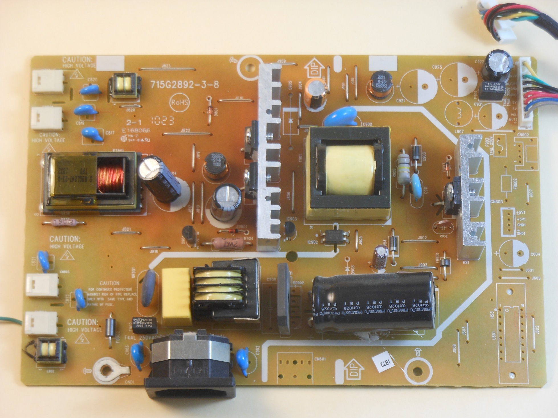

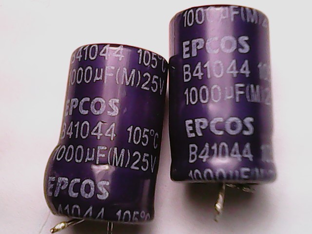

    Hi, I'm a newbee, first time fixing a monitor. I have some knowledge of basic electronics, and I'm learning quickly from this terrific forum.
    This monitor went black. I didn't test it with a flashlight, though. Upon disassembly, there were two bulging caps on the power board (photo is of caps after removal, 1000uF 25V). I acquired two replacements from Scott at LCDalternatives and replaced them.

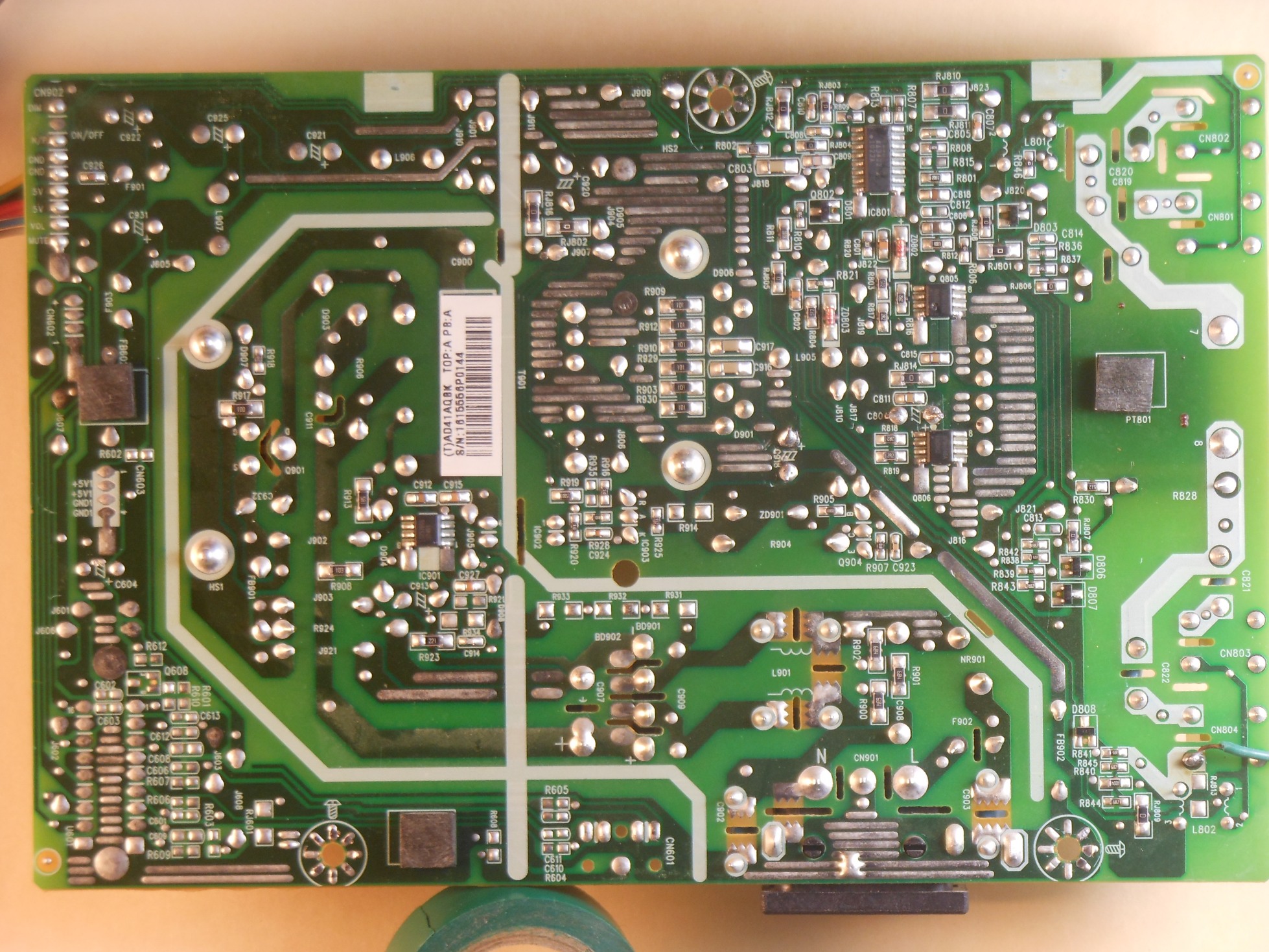

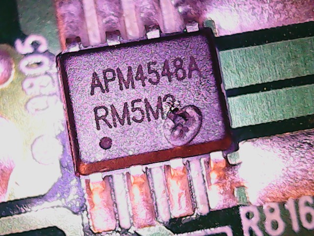

    When I tested the monitor, it still didn't work except power light, and after 30 seconds there was a small pop and whiff of smoke. I am attaching photos of the power board front & back. On the back there is a component (google says it's a logic gate, APM4548A) with a small melted hole in it. (photo also attached)
    Yes, I probably should have replaced all six caps before testing.
    Should I spend some more time fiddling with this, or throw in the towel?

    Re: emachines E230H monitor - worth fixing?
    It's an Anpec APM4548AK, dual complementary MOSFET. It has one N-channel and one P-channel MOSFET in a single SOIC-8N package. Typical from CCFL inverter. You'll easily find its datasheet. You can replace by same part OR another SOIC-8N (or SOP-8) complementary mosfet with same ampers/voltatge characteristics.
    Worth repairing? You have the answer. If you're concerned with electronics waste plague, and if this monitor was satisfactory before failing, then definitively it's worth repairing.
    On the other hand, it will depend on your tools, skills and resources. You can always order the parts and they will be quite cheap.
        I wouldn't care about other capacitors at this moment. I'd focus on replacing the dual mosfet and checking for short diodes. After this, if you do this right, the worst problem you can encounter is that some CCFL is bad or needs refurbishing. After mosfet replacing, try to power on with unplugged lamps. If nothing burns again, then try again with lamps.
        You don't need to replace APM4548AK with same part, if you can't find it. Any SOP-8 complementary mosfet with ±30V / +7A / -6A will do the same. Some that I have found in other monitors:
        P2103NVG Niko Semiconductor
        MDS9651 Magna Chip
        AO4600 Alpha & Omega (only -5A on P-channel, but will work anyway)
        FDS8962C Fairchild
        FDS8958A Fairchild
        FDS8858CZ Fairchild

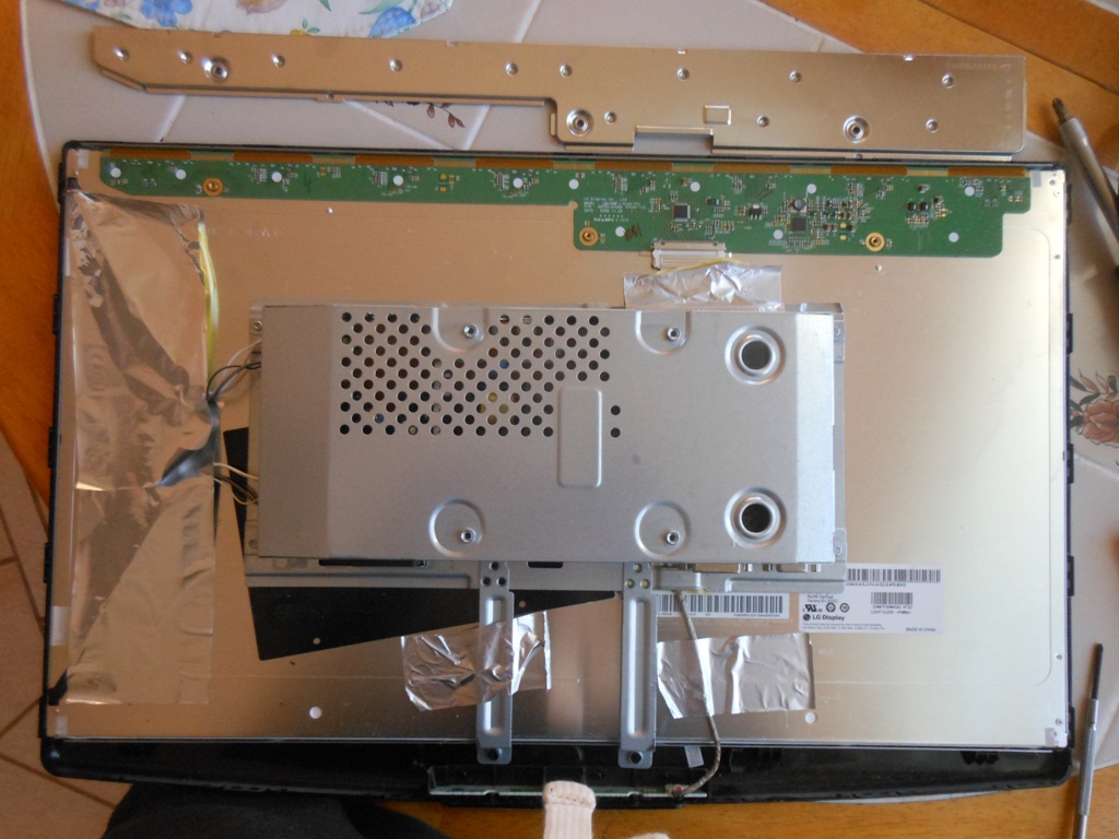

                  I was pretty careful handling the panel. There is an extra metal cover on the top PCB of the panel, see photo, I removed it initially, then replaced it before I continued.
                  So, I re-seated the ribbon connector at the top, and nothing changed. Is that the LVDS cable?
                  The monitor was still warmed up, so the image is still just grainy and shaky.
                  I haven't replaced the rear plastic cover yet.
                  What now?

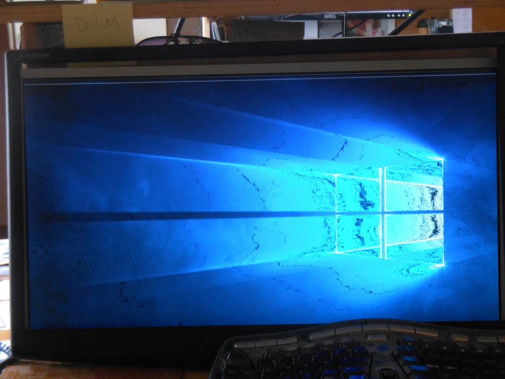

                      I re-checked the connections and let the monitor cool off so I could eat lunch.
                      When I powered up again, the image was really poor at first with most of the screen black and a few blinking horizontal streaks. After it warmed up, the streaks mostly disappeared, and just the graininess and jittering up & down remained. Then I took a photo.
                      Notice the black specks all over the Windows 10 logo. Also, there is a white streak at the top of the screen. The image was jittering.

                      When I initially took apart the monitor, there were a few foil tapes holding wires in place. Are they important, like for shielding?
                      Also, there was a rubbery pad between the PCBs and the display, you can see in the previous photo where it had slipped out of place. It looks like a refrigerator magnet material. Where does it belong?
                        Aluminium foils are recommended for improving shielding, but should not be harmful if removed.
                        Black plastic sheet is intended for preventing any accidental contact between the boards and LCD panel. Must be placed again in the same position.
                        Effect on screen indicates two different problems related to panel. Top horizontal white line (plus image shake up-down from that line to bottom) means to me faulty gate driver, generally unrepairable. But the dark zones indicate a global color/gamma processing fault, related to T-CON. Since this panel doesn’t have detachable T-CON, it’s a no-win game. Let’s see if someone else has another opinion.
                        Can you tell panel model? It’s on the sticker that says "LG Display".
