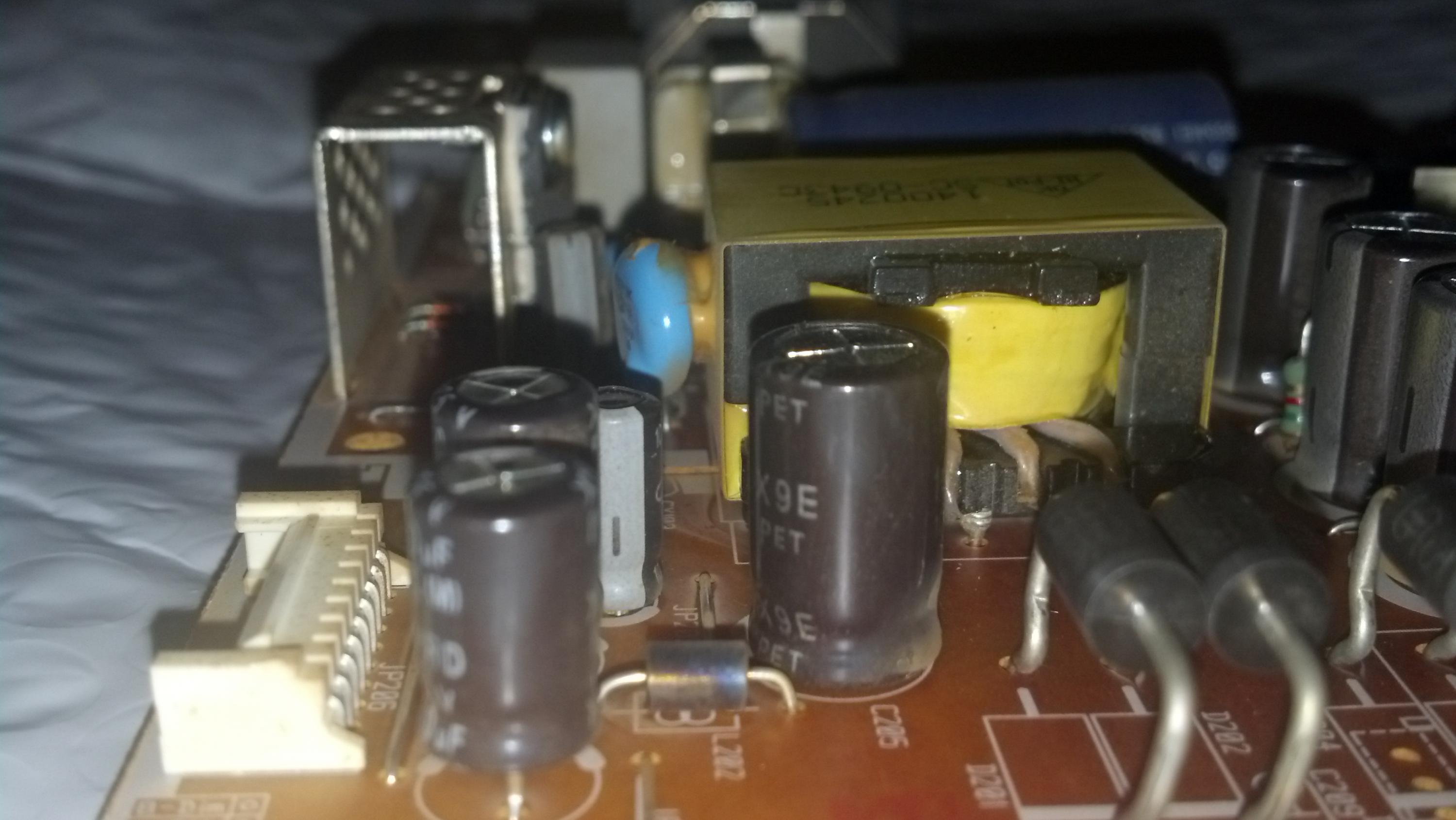

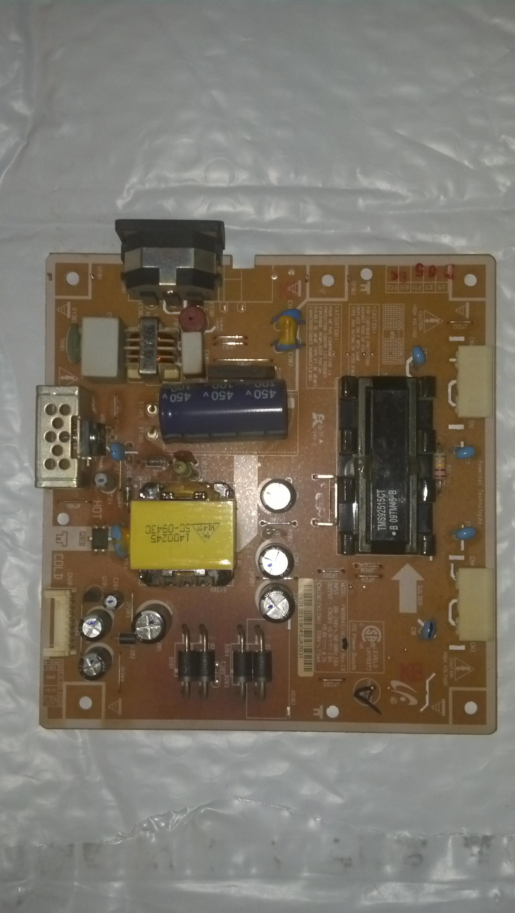

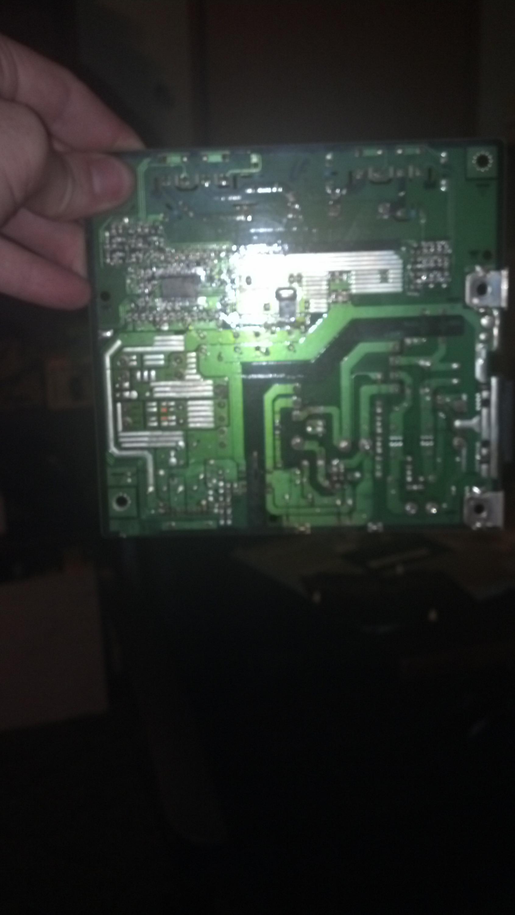

    So, I woke up this morning, and my monitor won't turn on. This caused a horrible start to my day, as I had a lot of work to do. I use a three monitor set-up, but for what all I do, it's barely enough as it is, so having even one go out can be disastrous for me. I'll try and lay out exactly what happened, in hopes that someone is able to help me figure out if it's salvageable.
    My PC is always running, but I turn my monitors off via the power button each night before bed (still plugged in though, of course), and then switch them back off when I get up. Well, I woke up this morning, and it seems my PC was actually OFF, so not sure what happened there.. But I'm fairly sure it wasn't a power outage, since my microwave time didn't get reset. So it was either shut-down by a windows update, or by a power surge in my room. (The monitor in question, WAS hooked up to a surge protector, though.)
    So I went to turn my PC back on, and then hit the power button on each of my monitors. My far left monitor though, did NOT come back on. There is no indication of it receiving power whatsoever, and I've even tried different outlets. The power button doesn't flash at all, even when unplugging/plugging it back in.
    Monitor: Samsung 941BW
    I've taken it apart as well, just to check and see if a cap had went bad, but it "looks" as if they are all fine. I know kind of what to look for to know if one was bad, but I know sometimes you can't tell by just looks. Either way though, I thought I'd ask here since I'm not an expert on the topic. Just trying to figure out what went wrong, so I can order the part(s) needed to get it fixed. I've also included some pics of the board as well.
    Please let me know if there is any other information that you need to know, in order to offer advice about this. Or if there is anything in particular that I can try. Thank you ahead of time, I will be checking back very frequently.

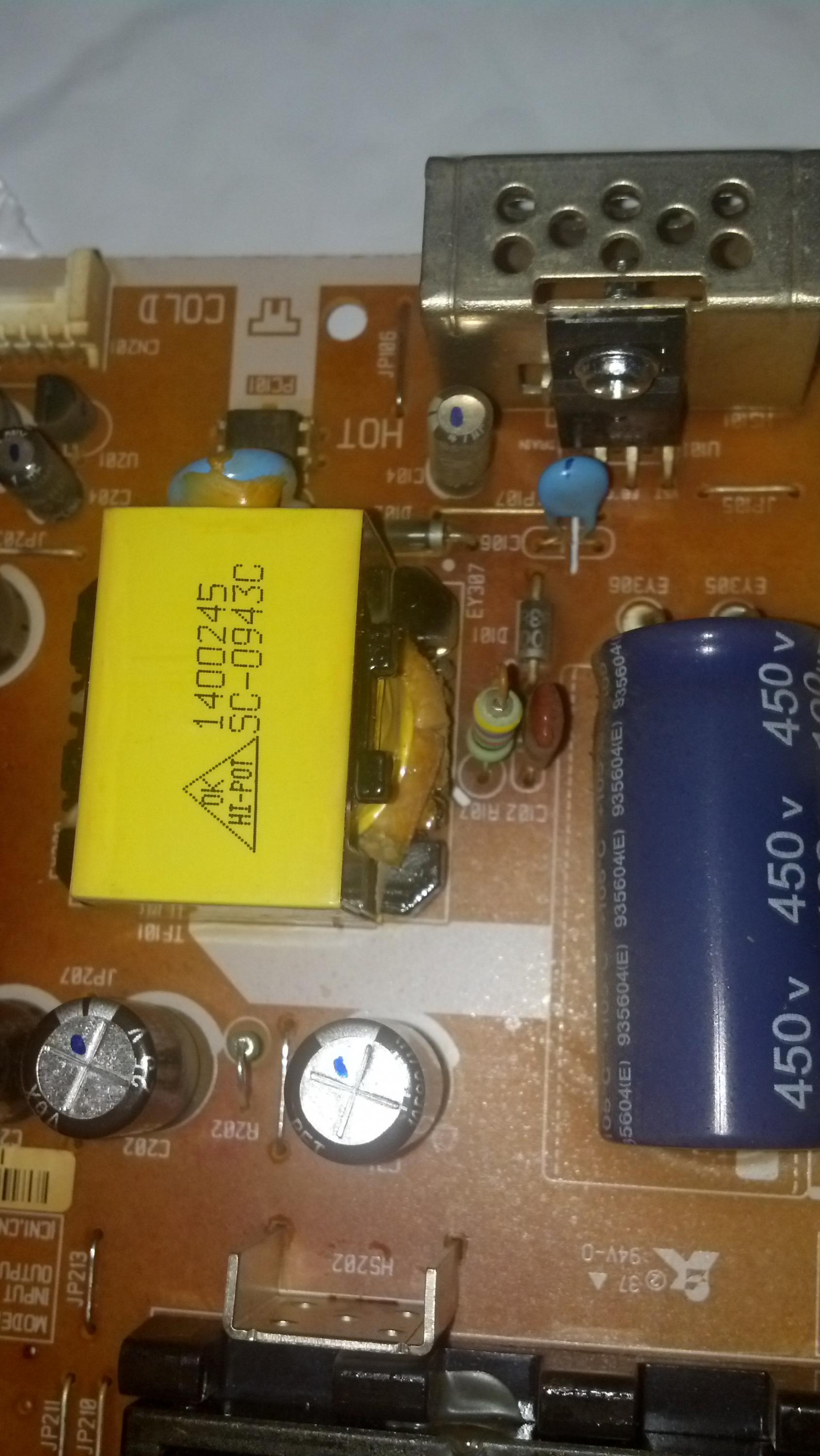

    First you have to check if the PSU puts out STBY voltage 5V, which is always there. That goes to the main board. When you press the power button, the main board returns a PSon signal to the PSU and the PSU turns fully on.
    Unfortunately I am not able to read the pin out on the PSU. Anyhow, this will get the ball rolling to determent what board is at fault.

      Your monitor probably wont have V+ on the connector, and most likely main power board is down.
      Take care all the time, that big cap can hurt. I am not sure if it has a bleeding resistor...
      Maybe someone else will see it.
      Check:
      -Fuse (If blown should be replaced with 20-30W bulb in series for now, that's good practice for us beginners)
      -NTC (Varistor)
      -Both sides of graetz bridge for short (outer legs are output inner are input)
      -Test graetz out of circuit
      -Test switching transistor (U101 it seems)
      -Good luck
        I have someone bringing a multi-meter later, so hopefully I can find out then, thanks! Is there any good guides here for testing different components with one, though? I've only had to use a multi-meter a few times, and never on anything this complex. Just want to make sure I get it done right, obviously. I always like to be as knowledgeable as possible about things I'm trying to fix though, although I guess that's a good thing haha!
        And also, there is a darker spot on the board as well, but I'm not sure if it's a burn mark, or just a stain of some sort. Any ideas?
                Many components get hot during normal operation, and heat will darken the board as in your case. Sometimes it indicates overheated component... My guess is those diodes are OK in your case. Of course, when in doubt, you have to test component to be sure. In this case, leave them be for now.
                And, if you find that fuse is open circuit, resist the temptation to replace it and power on the monitor. Just report back here.

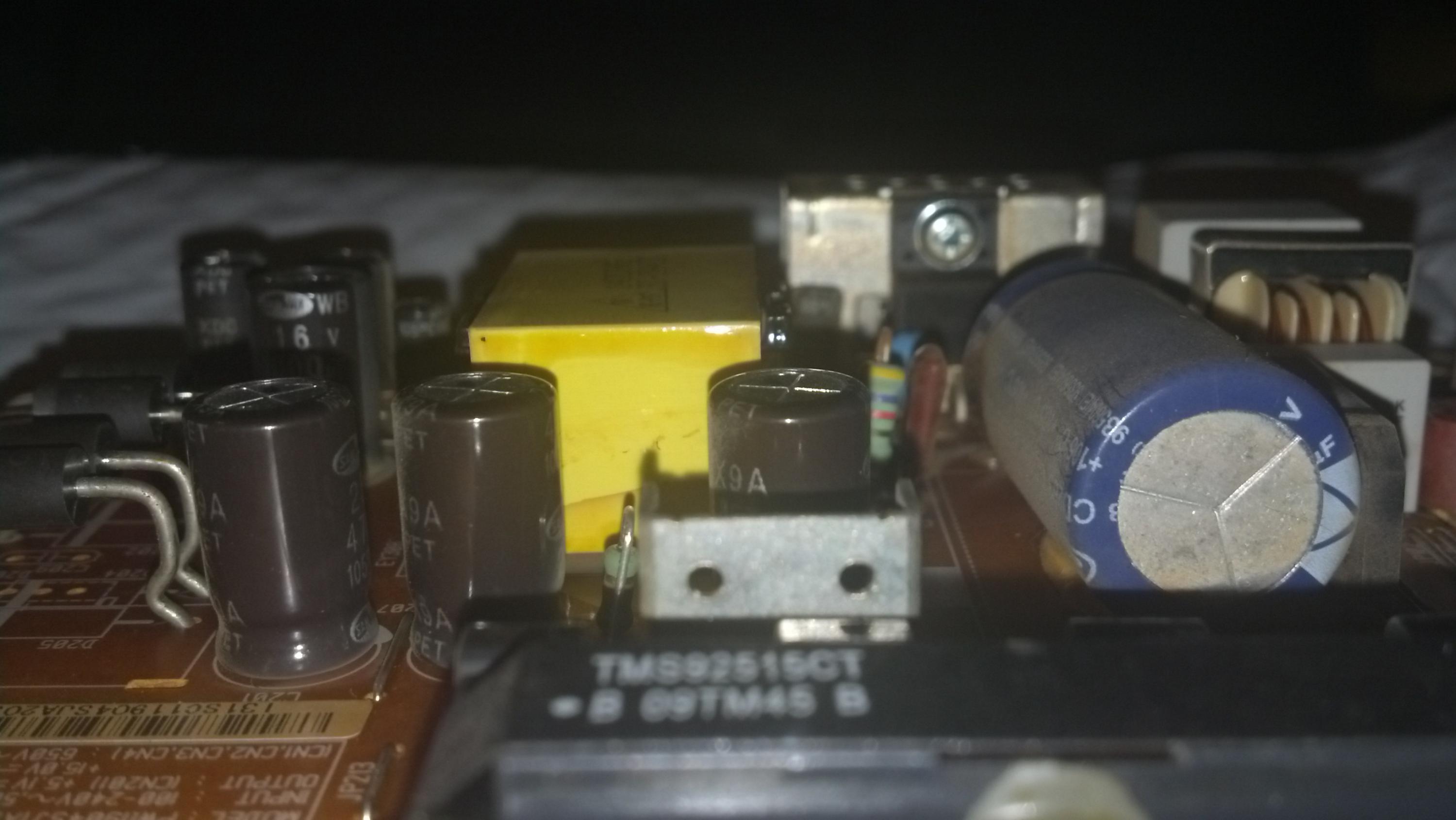

                                    I can't think of anything to check. Perhaps look at the joints on the white power connector first (the one that is used to give power to the logic/video board). If it looks good, then I guess it is time for a recap.
                                    Sometimes, the voltages may appear correct, but the caps could still be bad and letting excessive ripple through. I had a Gateway monitor behave in a very strange manner, even though all voltages from its power supply appeared normal. After doing a recap, all problems went away suddenly.
                                    Just because the caps aren't bulged doesn't mean they aren't bad or starting to go bad . So next stop for you will be Digikey, Mouser, or some other place to get reputable caps (avoid eBay for now - too many counterfeit caps to sort through. If you don't have the eyes for it, you will likely get burned there.) You don't need to replace the big, high voltage cap on the board, but the other electrolytic caps need to go.
                                    If you need help picking the right replacements, please provide some info on the existing caps, such as:
                                    brand, series (usually or or three letters), voltage rating, capacitance rating, diameter (in mm), and height (also in mm).

                                      the heat from those hot diodes (where the PCB is darkened) has probably shrotened the lives of the caps quite a bit (even if they are still in spec). So it is a good idea to change the caps anyways.
                                      Now if you are feeling a bit adventurous, you should also replace those hot diodes with something better, like STPS1545D or MBR1060G. You will only need two.
