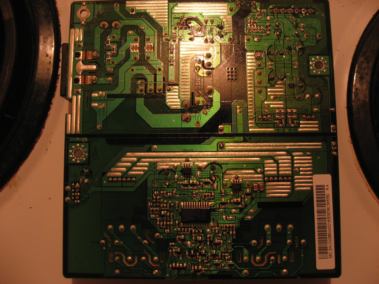

    Hi, this is my first post.
    I repaired a few LCD as a hobby before.
    But this Samsung is a difficult one.
    I replace all the caps (10) and still nothing on the screen.
    All I have is the blue power led.
    I test the diodes and they check ok.
    What could it be?
    I can hear a small squeal when I put my ears close
    to the board. The squeal appears to come from the 2 transformers ?
    And when I turn on the monitor the squeal goes away.
    Thanks.
    Frank.

    Any good clear pictures of the bottom side of the board?
    Did you check green fuse next to one of the inverter transformer?

              The original green fuse has blown for reason, more likely that you have bad power MOSFETs (the two 8-pin SMD on the bottom side of the board) which drive the inverter transformer.

                        Re: Samsung 2253BW inverter problem.
                        The MOSFETs that you need to check are those two SMD one, the fuse feeds those two MOSFETS so the problem is not in the main power supply section. If you remove that fuse you just install then you should have your power LED back on.
                          Thanks, you mean the 2 8 legs chip under the board right?
                          Label STM8309 ?
                          I don`t think I can solder this , it`s to small.
                          Frank.
                            • 30977
                            you can,
                            put some solder across the pins on one side,
                            slide the iron up and down the pins while gently levering it up from the side wih a blade.
                            once it lifts a bit, remove the solder wih some braid and do the other side the same way.
                                    You can check the resistance between S pins and the D pins of the MOSFETs with Ohm meter to see if they show low Ohms readings.
                                      Ugh, sorry if I confused you, Frank.
                                      I promise I won't post anymore while leaving to work
                                      So, using the datasheet that budm neatly attached, locate (S)ource and (D)rain pins. Normally, Ohm resistance between those is infinite. If shorted (low Ohms), MOSFET is gone.
                                      Also, I have developed a habit of resoldering inverter transformer pins on every board I get to. It's generally good idea to carefully examine solder joints on all components and check for cracked or insufficient solder joints.
                                        Hi, thanks , I check to the MOSFET and one shows 0.06 between the S and D pins
                                        The other Mosfet shows 123 between the pins, So I guess this one is gone?
